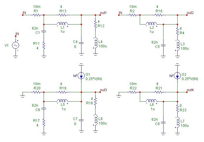

Hi Eva,
Whether it's not the best location depends on the envisioned purpose. Remember that Zobel networks serves two purposes: not only correcting the misbehavior of the speaker impedance at HF, but also blocking RFI from outside.
I agree with you that an external inductance (not a capacitance, btw) forms a (damped) resonator with that parallel cap. The point is does it matter? Also, how well performs the alternative circuit?
In the following examples of the two alternative topologies, I've put a 100uH inductor in series with load, representing the voice coil inductance of an average tweeter.
Below the schematics and next post the response.
And here are the various responses. The first graphs show the output voltage as function of the input voltage. Observe that the circuit with the cap across the speaker terminals (green curve) peaks a bit, 3dB at 600kHz.
The second graphs show the impedances at the input side. Indeed, the thing peaks at 64kHz and the impedance rises to 205 Ohm. But the other circuit does exactly the same!
The last graphs show the relative susceptibility to RFI ingress. Notice that the circuit with RC at the input (red curve) does almost nothing above 1MHz, while the other circuit performs as intended.
Edmond.

AndrewT said:
Hi Edmond,
could you add outputs 5 & 6, the interference signal delivered via the feedback path to the inverting input?
Hi Andrew,
Of course I can do that, but with which amplifier?
(not now, perhaps tomorrow)
How about combining both types to form a Pi filter?
I've tried that, but with limited success. When I also put 4 Ohm and 62nF in series across the input (just as in the other circuit), the impedance peak drops from 205 to 94 Ohms at 45kHz instead of 64kHz.
Edmond.
