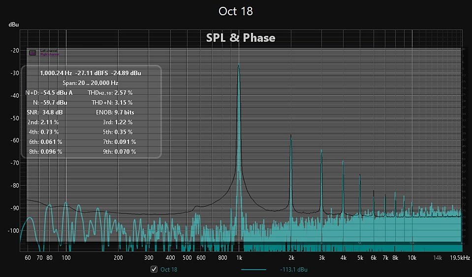

0.3mv at 3.54cm/sec, simply means (5.0/3.54)*0.3mV = 0.42mV at 5cm/sec.
Playing the 1Khz track with 60dB gain should give 0.42V or -7.5dB, not the -27.11dB in your picture, unless you have attenuated the signal by 20dB with a volume pot ?
But overlaying the above image with the .wav file you sent me, the ratios between all harmonics are the same !
So simple, thanks!
For the rest, at the moment I have no explanation. I also always get the same tdh ratio whatever gain or preamp I select.
This ortofon lp also gives lower sound level when played through speakers and listened by ears. Signal was surely not autenated, as there is no potentiometer in measurement signal path.
For reference there is real music record I sent you, that peaks all over. Suspecting that test record is actually crap.
Nevertheless the tdh and noise level of this LP played with chart is consistently and comparably measured horrible (noise of empty tracks not so bad actually).
Yet music played through this system and real records has (subjectively) so much space, depth and presence of music being inside the room than any digital recording... Before this exercise I was not aware how misterious this is

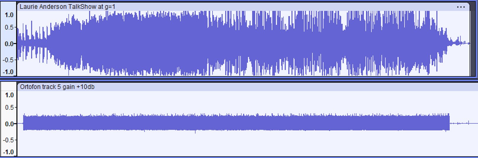

I compared your music fragment to the 1Khz test tone.
When I got you correct, the 1Khz test tone was amplified by +10dB additionally to the already available 60dB.
However the Music was amplified by just 60dB.
So, I attenuated the 1Khz by 10dB, to make it directly comparable in level to your music fragment.
Quite obvious is that the music fragment is much louder and clips all the time, so much for extra headroom for overload !
Hans
Hi Hans,
Now you see what I see too, you did not have to reduce 10db at 1khz signal, it would still be quieter than music... That's my head scratching about ortofon record.
Music record is clipping, sure, I also see that. But consider that recording gear (soundcard input and ADC) has only few volts DC of PS to deal with that signal.
Preamp has anything between +-12 and 18V to deal with it, they should not clip I think... What we see on these tracks is soundcard input clipping. I'm sorry I have no ADC gear to record say 12 V peak to peak....

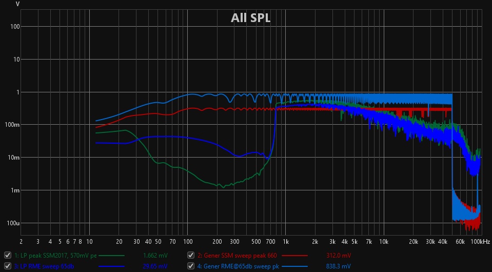

These are 4 sweeps, legend of which is in bottom, fluke measurements were about double the value shown on Y axis:
Light blue is generated sweep amplified by RME mic amp set @65db.
Red is same generated signal through my preamp, showing that or RME preamp is more than 65db, or my preamp is 60 and not 66db.
Now confusing, From LP :
Green is sweep peak from my preamp
Blue is same through RME preramp, this time RME mic preamp has slightly less gain, opposite than with generated signals.....???

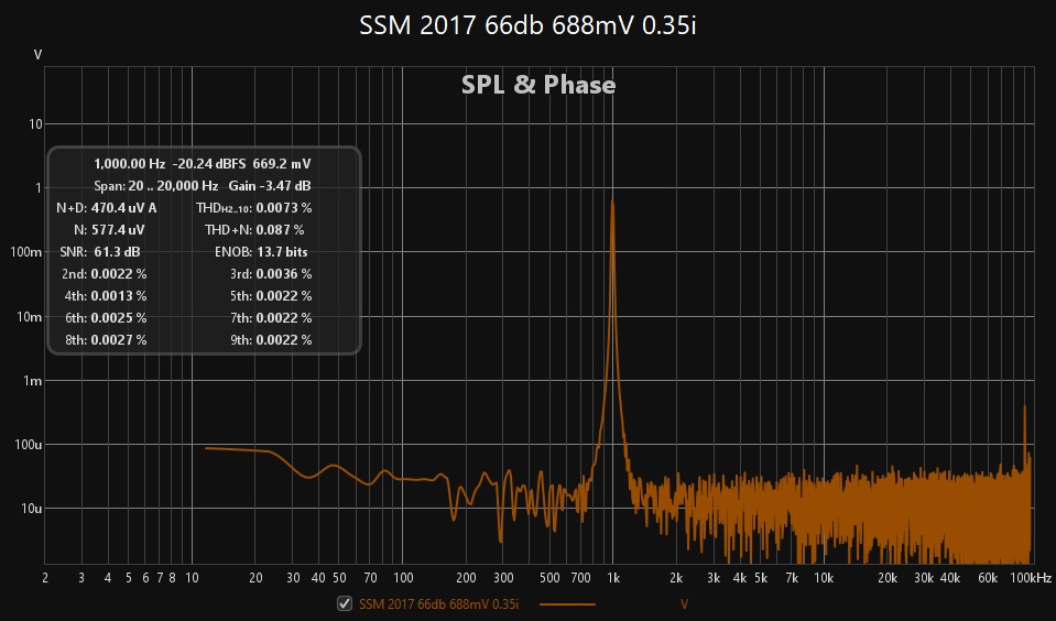

Now 1kHz, same inputs, same outputs:
Generated signal feed to my 66db preamp. Fluke measurement of the input is almost exactly the same as indicated on Y: 688mV

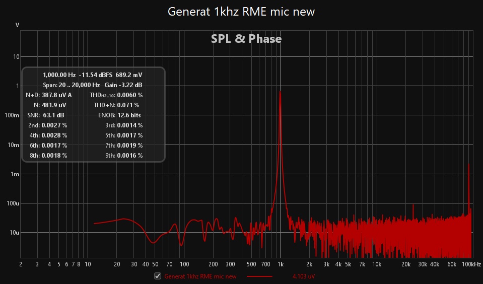

Same input, but this time through RME mic preamp @ 65db . Gain is apparently higher than from my preamp... BUt mine shows bit better noise and THD

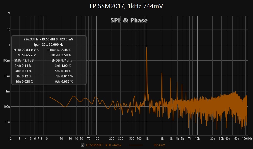

Than my preamp from ortofon LP test tone 1kHz

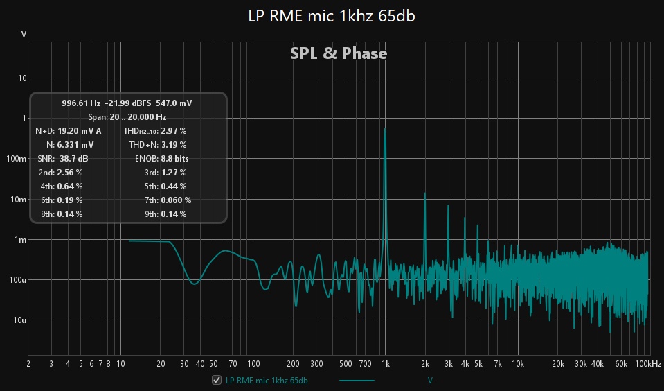

And same LP track via RME mic preamp @65db:
Note, Ortofon LP has 4 left channel 1khz tracks, what I show is the best one, on others I get up to 6% THD and SNR in low 30's
Confusion is that when using generated tone RME mic preamp has more gain, when playing from LP and cartridge, my preamp has more gain.... About this one Im not sure whats going on.
But otherwise, I think numbers are consistent....

There is definitely something very wrong in your test setup.
1) Playing the 1Khz tone from the LP with 66dB gain gives 723mV, meaning that your Cart produces 0.36mV at 5cm/sec@1Khz (image 4), seems o.k.
2) Measuring through the Mic input shows 547mV, meaning that with 0.36mV from the LP, gain from the Mic input is 63.3dB (Image 5)
3) Now generating a 0.351mV 1Khz tone from your soundcard through the 66dB SSM should give 702mV out, but it is 669mv in image 2, so effectively the input seems to be not 1Veff but 0.95V.
4) So, using this same 0.95Volt via the same divider into the 63.3dB gain Mic input should give 488mV, but your image 3 shows 1.818Volt or 3.7 times as much and also the noise has gone up with the same amount.
As long as you don't get these figures in harmony, no measurement can be trusted.

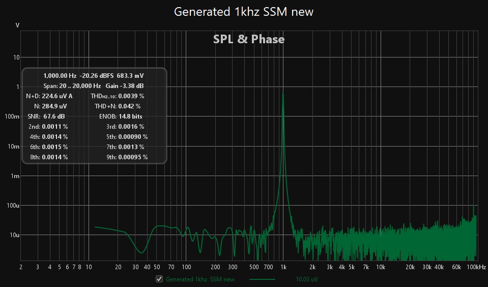

Line input on RME via my preamp - Preamp in measured by instrument 998mV, preamp output 688mV
Through RME mic preamp @65db, input same, output cant measure by instrument as is inside RME:
HAve no idea what it was..... but restarting made it logical again...
