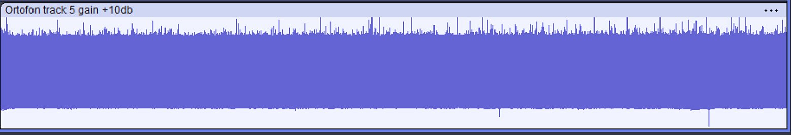

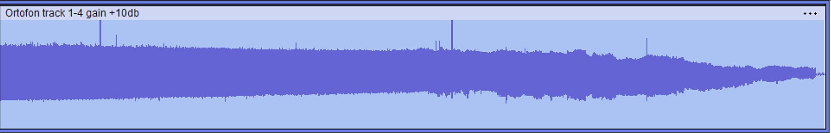

2) Could you make a single .wav file in one go all the way from track 1 to 4 even when you can't record in stereo.
3) To make a THD plot of your cart at 1Khz@5cm/sec, a second .wav file from track 5 would be interesting.

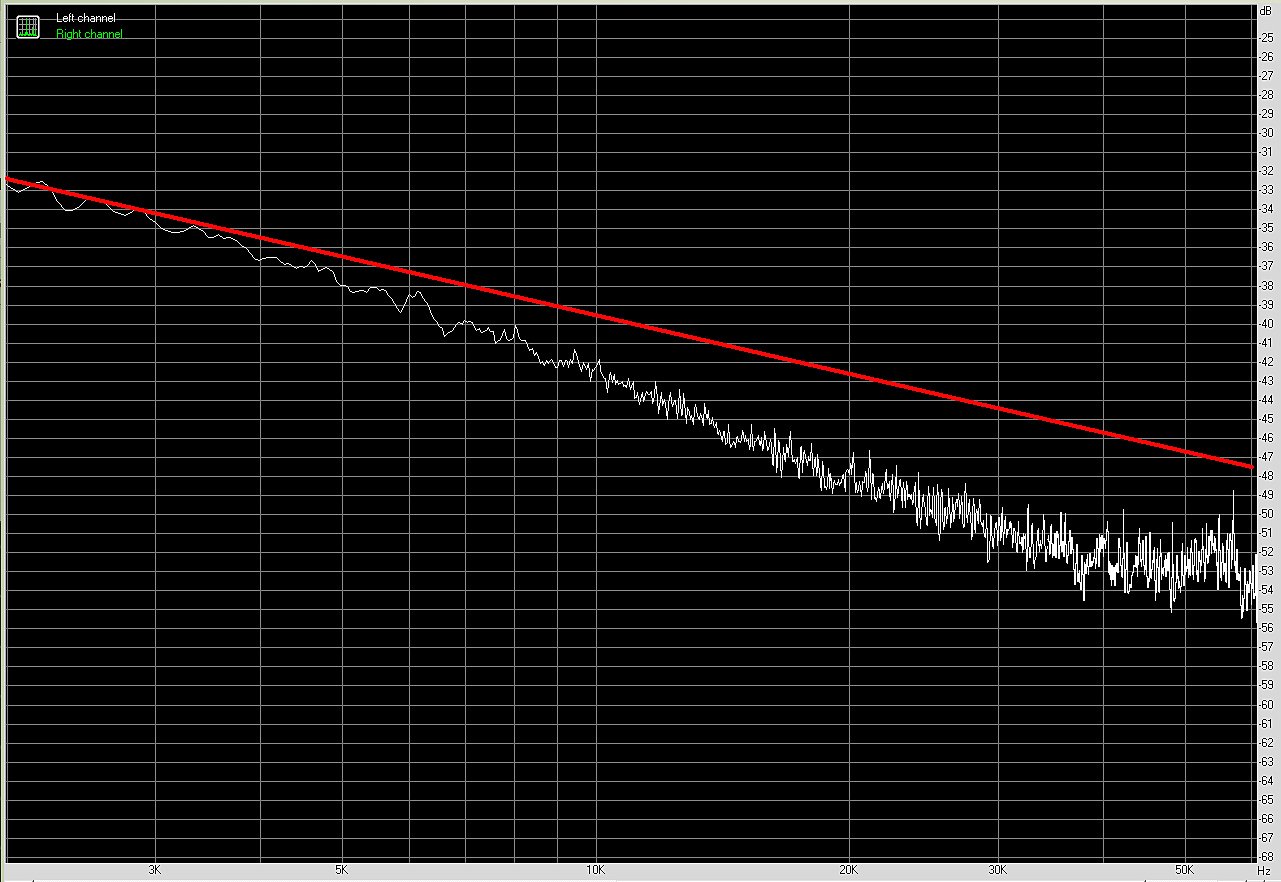

This is what I have now.
It is not going with the -10dB/dec as it should go, see the red line.
Hans

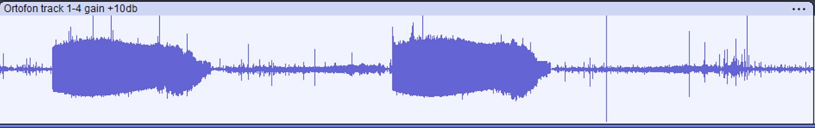

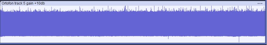

Dear Hans,
First, thank you so much for all your time, it is great help!
I just sent you 2 files as requested. For these recordings Im not using REW at all, but recording directly to Audacy without REW. Also with REW i removed octave and set spectrum, in post #436 there is picture of spectrum of sweep created digitaly by soundcard, bins are easily visible and they are in equal frequency pots.
I have no idea why my record has higher slope, I am 100% sure that this is nothing to do with preamp, cart or recording as otherwise this would be very observable with music, and it is not... Only thing I can think off is that Ortofon changed something, even less and less I see the purpose of this test LP...
Sorry, one more thing. For some reason Audacy records are much reduced in volume after exporting (in contrary to hardware measured VRMS and Audacy peak meter while recording)). For last 2 files I increased gain on card input by 10db so it is easier to watch details.

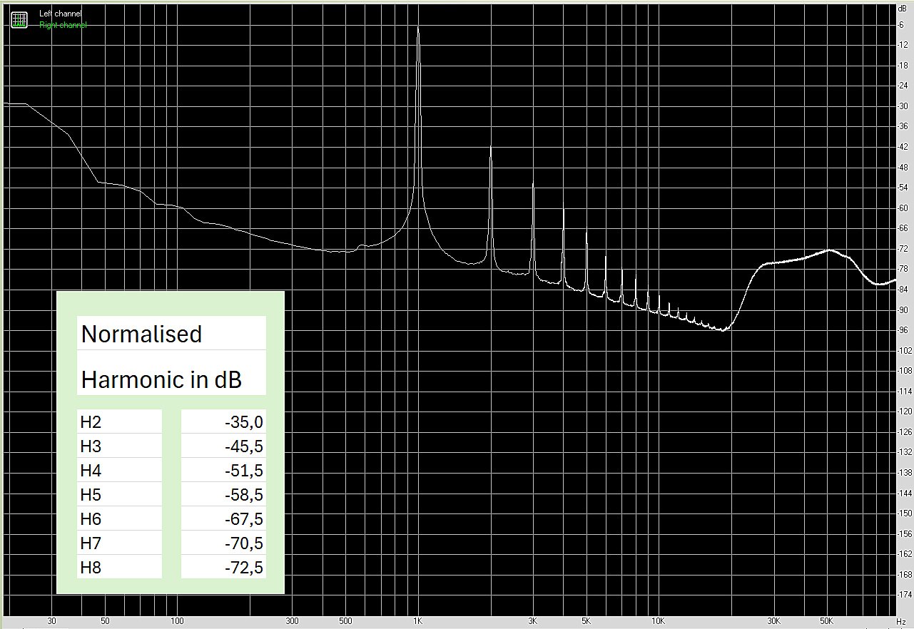

I just sent you also recording of Laurie Anderson talkshow, quite dynamic song especially in HF region, before RIAA. On Audacy screen I can see clipping points on many places, but that is soundcard limitations with its single +9V PS. The preamp with +-18V supply should have no clipping, even I cannot record these dynamics due to recording equipment limits....

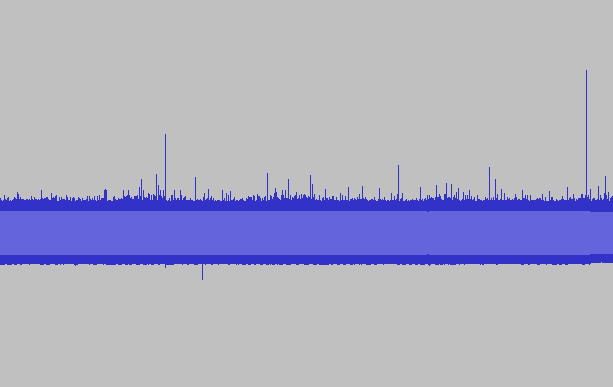

What puzzles me also is that when looking in Audacity to your 1Khz recording, is that the upper halve of the sine wave has a lot of "grass" that frequently even clips.
This has nothing to do with FFT setting or filtering, but it could be that your anti skating is not set correctly.
It may also affect the measured distortion, so better not to add the extra 10dB.
Hans
P.S. the -35dB H2 before Riaa makes sense, because Riaa is almost flat between 1KJhz and 2Khz.

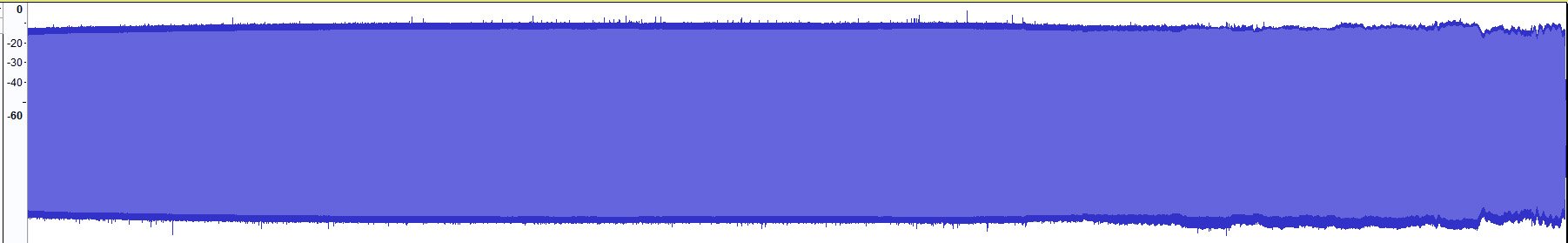

And also the sweep signal doesn't look that nice.
What you can see is that the signal in time does not have a constant amplitude as it should have up to ca 40Khz.
This fully explains why the FFT does not have a -10dB/dec slope.
As a reference I include a plot how the signal looks from 2Khz to 50Khz on my system.
Hans
P.S. I have just added your time signal zoomed out from 2Khz to 50Khz

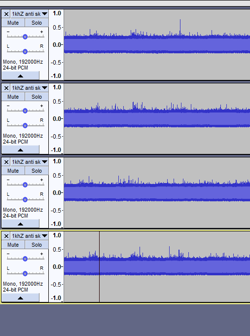

Hi, so good to sit at desks at the same time.
Antiskating seems not to be reason for grass, here is picture, from top to bottom: no antiskate, antiskate low, high and max

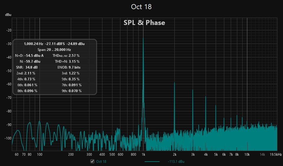

Here I post 1kHz chart on ortofon amplified 60db by RME mic amp. Or my chart is half dead (doesn't seems as when playing music it is all ok) or this LP is reject... or I don't know yet 🤔
