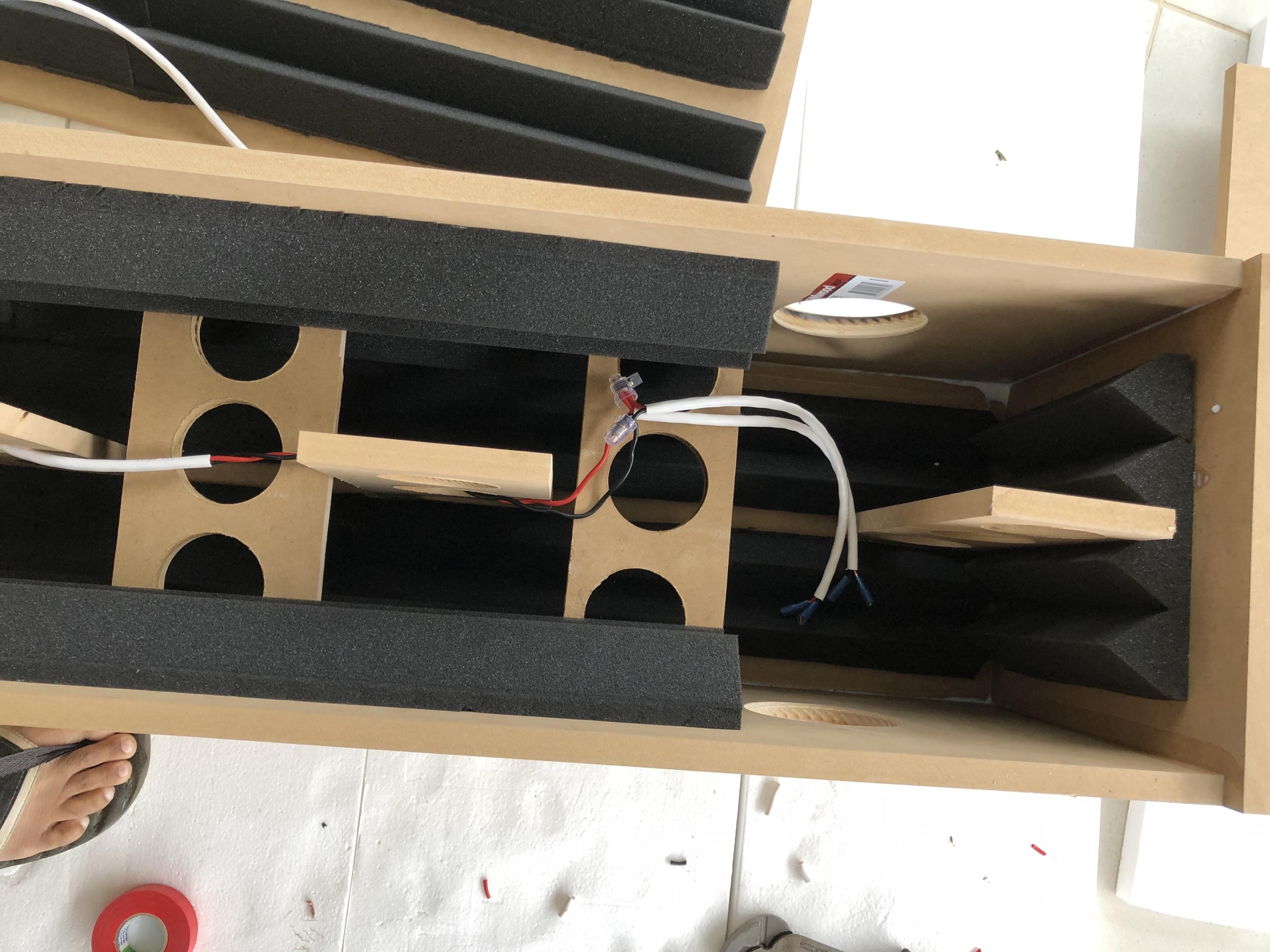

After couple of weeks of waiting, I have finally received the Pluvia 7 drivers. I went ahead and installed the new drivers in the cabinet. So far so, they are good, I do need to break them with few hours of use.
To your question Dave, I am currently using Pioneer VSX-324 AVR as the stereo amp.
For now, I have wired them in Series. This should mean two 8ohms drivers would result in 16ohms. I am not really sure, if I should go for 16ohms or 4ohms. Which would be better?
Depends on your amp. Each brings different compromises.

I think I will go ahead and build the second cabinet now and wire that for 4 ohms load, that way I can compare between 4 and 16ohms.

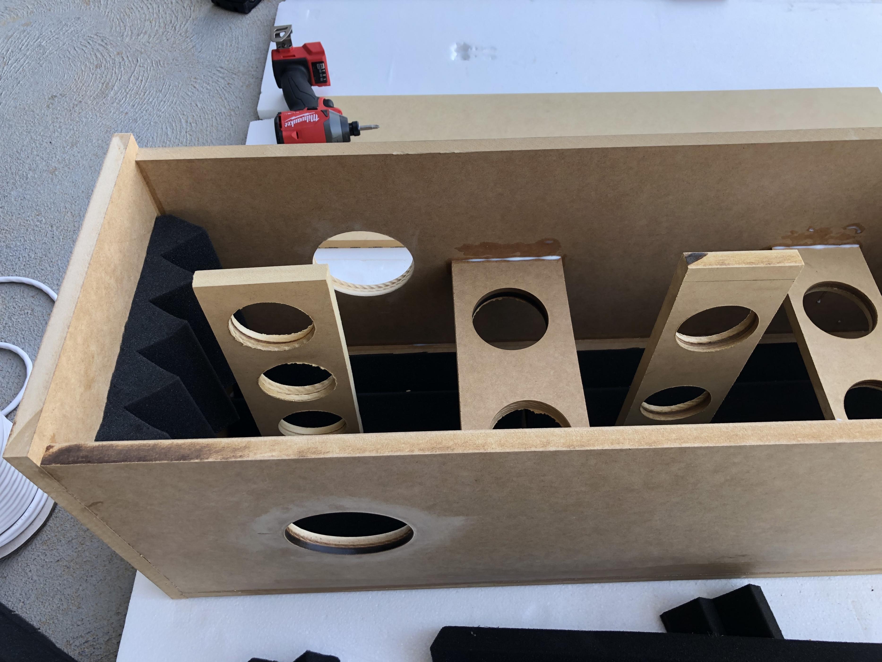

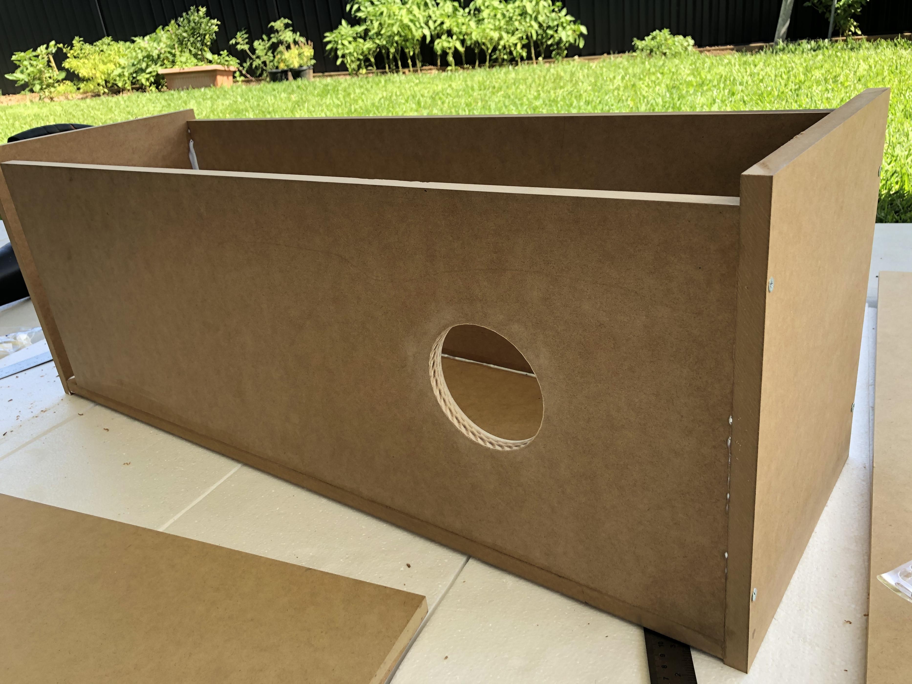

I managed to build the second cabinet yesterday and completed the setup.
Although, I only realised after the second cabinet was done, that the first cabinet port size measurements were off when cutting the wood. And also the panels were slightly different in size by 5mm 🙁.
As a result the first cabinet bass output is bit boomy. I may work around a way to make that port size littler smaller.
Anyway both cabinets are built, and I ended up going the 4ohms route, since they sounded punchy and tight vs the 16ohms which sounded more loose but with more frequency response. The difference was very minimal.
I installed the drivers only yesterday, so have not had a chance to break in, but my God, it is a huge improvement to previous Dayton audio drivers I had in them.
Thank you Dave, Scott, Chris and others for your help and suggestions. So far so, I am finding difficult to leave these speakers alone, but with everyone at home due to lockdown it is hard to turn up the volume to truly enjoy them.

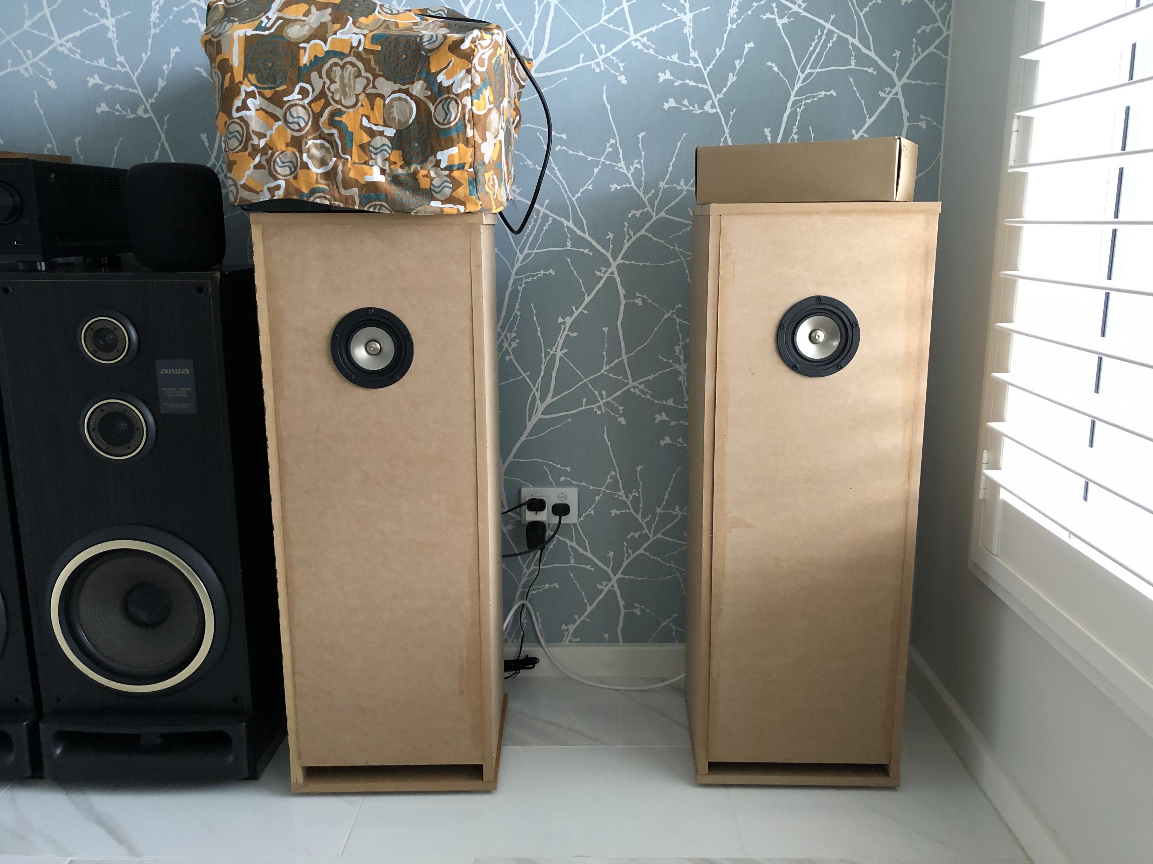

Question in regards to placement. How far away from wall would you recommend for speaker placement. Given the port is located in front, I doubt it will impact the bass output but due to bipole nature the other frequencies may be impacted depending where they are placed.

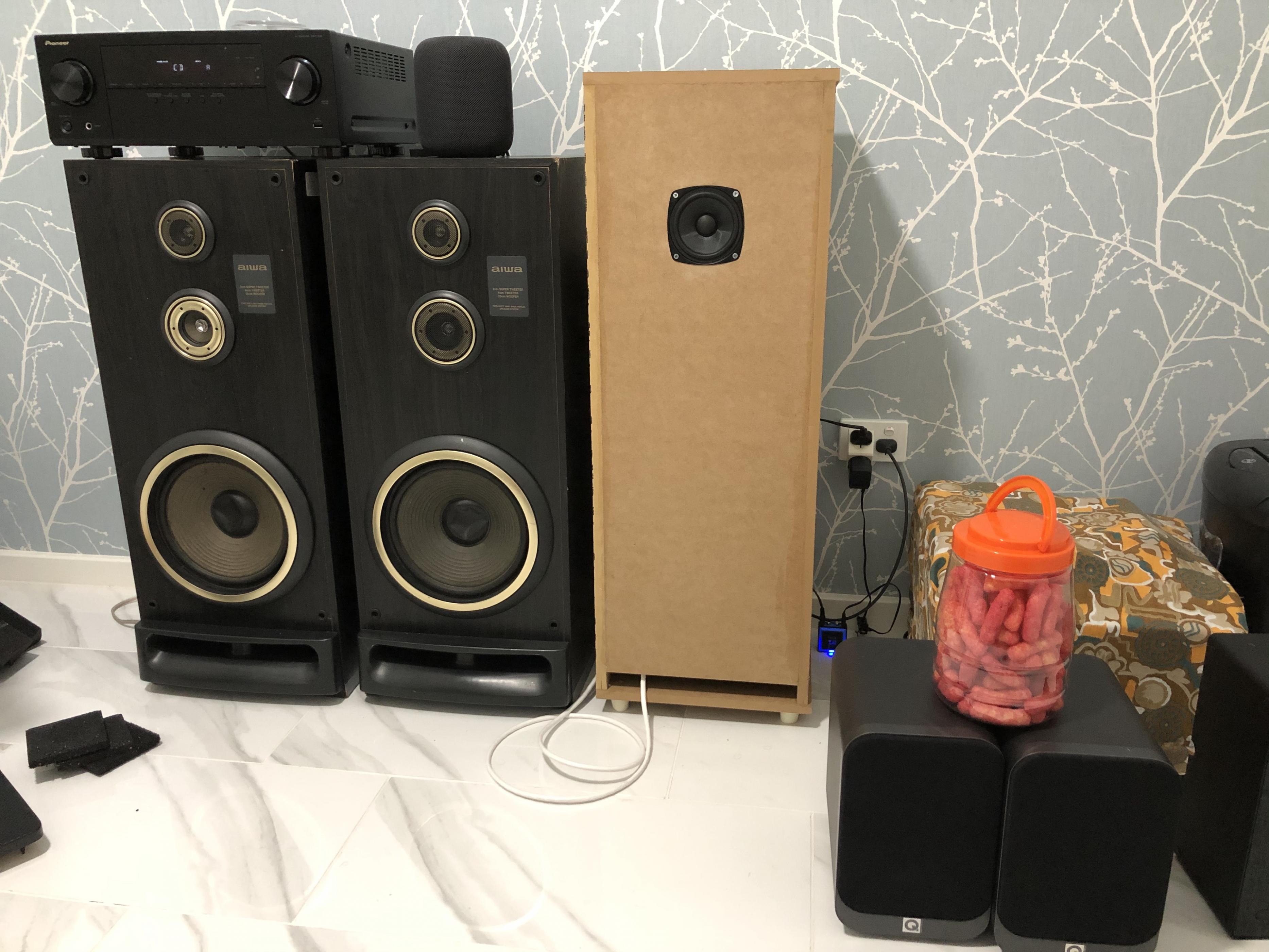

They should certainly be out more than in this picture:
When you get some time to play (after break-in) start pullin gthem out little by little and see where you like them. There may well need to be a compromise between best for sonics and best for living in the room.

The “acoustic” foam might not be giving you as much damping as you hope, and bipoles definitely need more breathing space to back/ side walls than apparent in photos. I’d start at around 1/2 metre and play from there; and splashing the rear drivers’ reflections with few degrees of toe-in (5-10dg?) could add spaciousness to image.

Not sure if I understand your question Dave, Those 3-ways are Awia vintage speakers, good but with poor cabinet construction and cheap drivers.
The covered bit on top of new speaker is just a laser printer, I have it covered as it is not used daily and can accumulate dust.

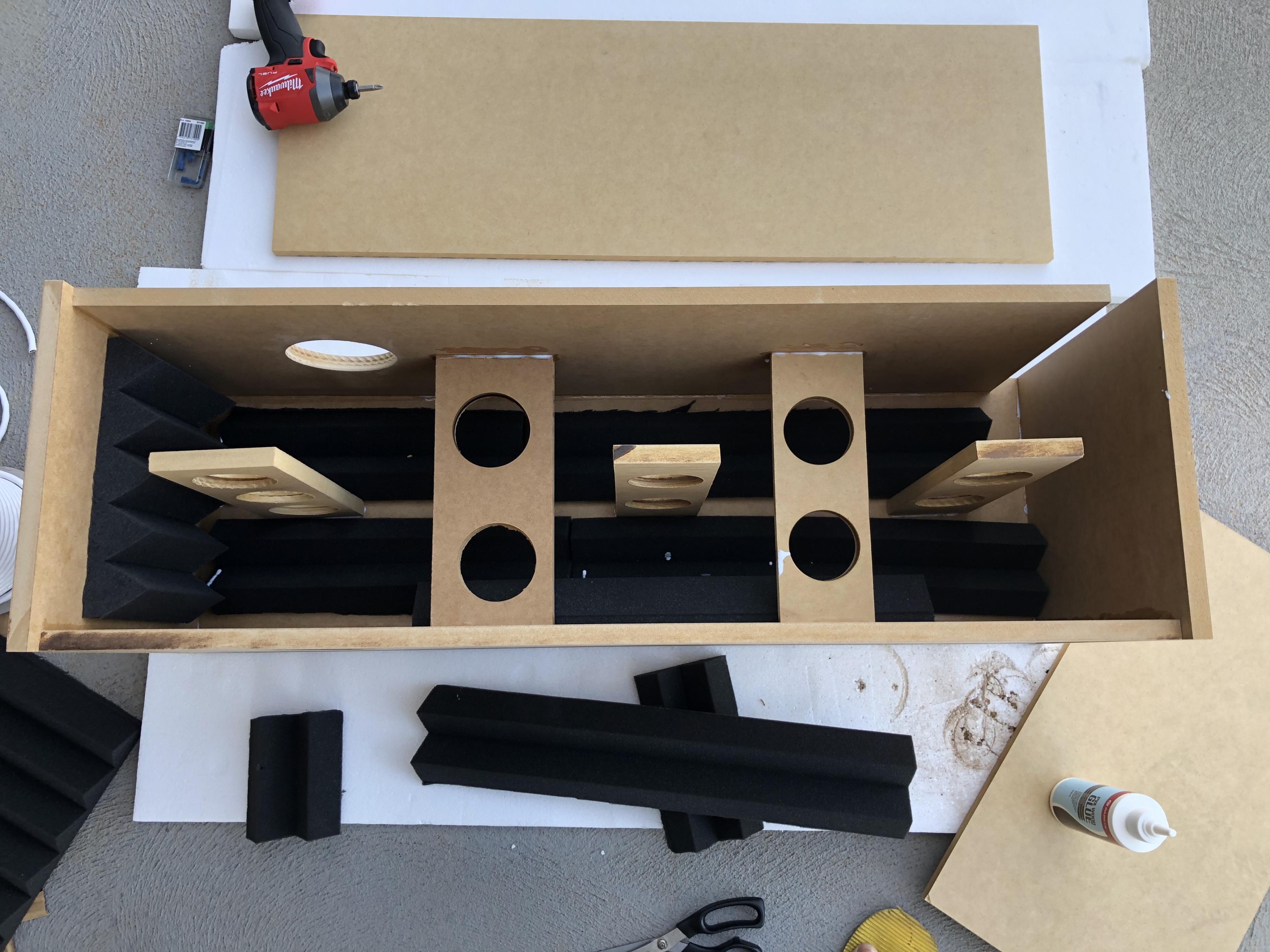

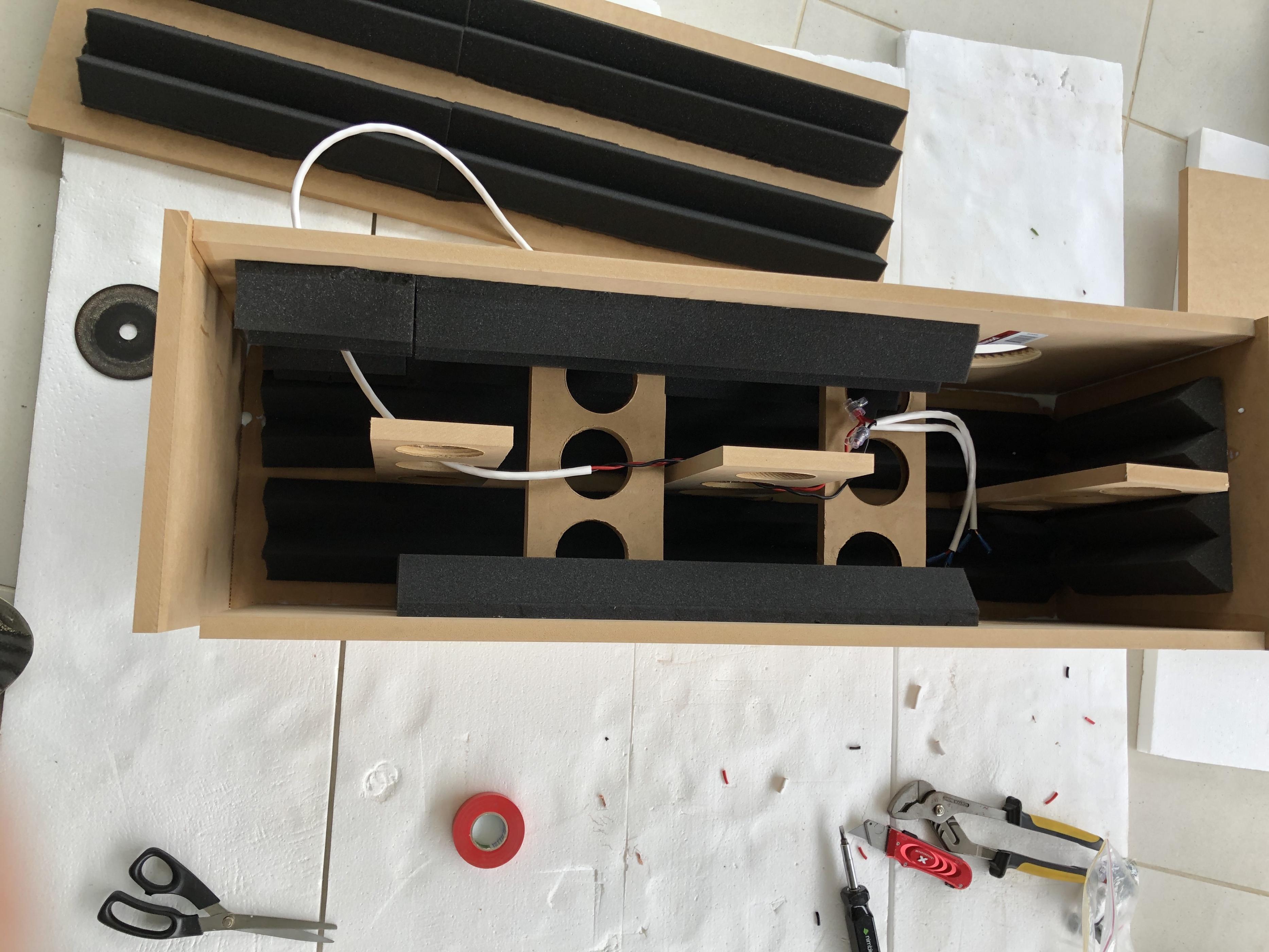

Ok, these are bit boomy to my taste.
Where should I put the stuffing? behind the drivers, near up top or near the port at bottom?
By the way, any tips for keeping the stuffing up top without them falling down and coming out of the port.
Since my woodworking skills aren't great, I was not able to make the cabinet with removable panel to adjust the stuffing, they are glued shut. But I can still add the stuffing after removing the driver.
Someone with skinny arms thru the driver cutout?
I would use acoustastuff or similar (well teased — that takes some time), it gets fluffy enuff that it tends to stay in place by itself. If the bass is boomy the damping should fill the whole line.

Yes, thats exactly how I intend to do it. I will be using the polyester fill from an old pillow.
