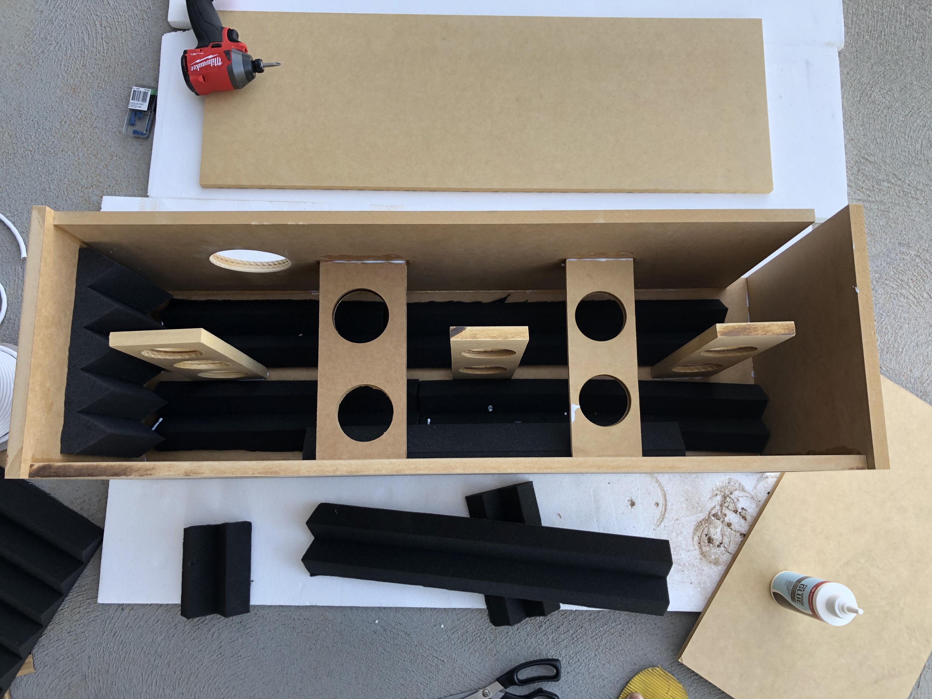

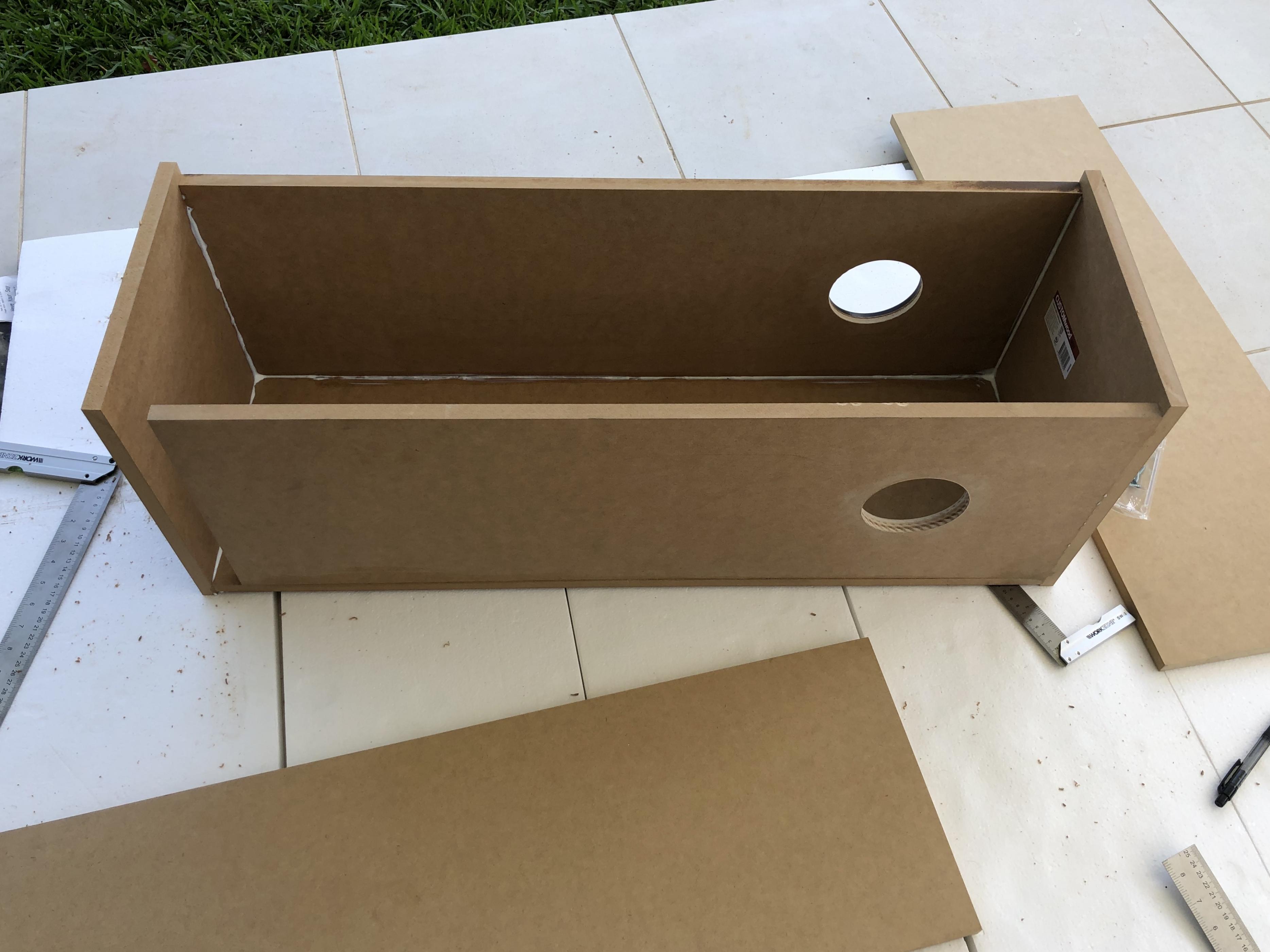

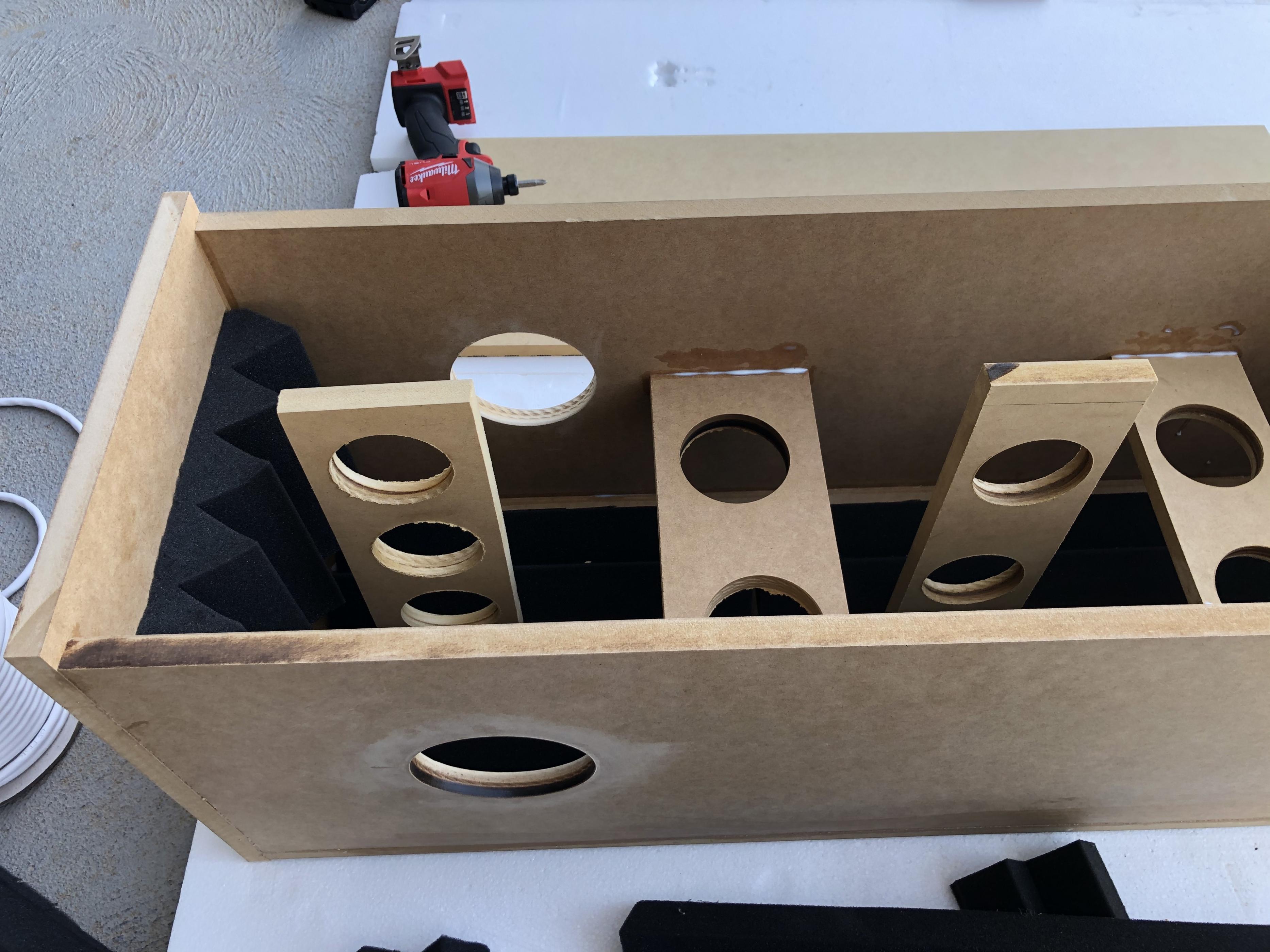

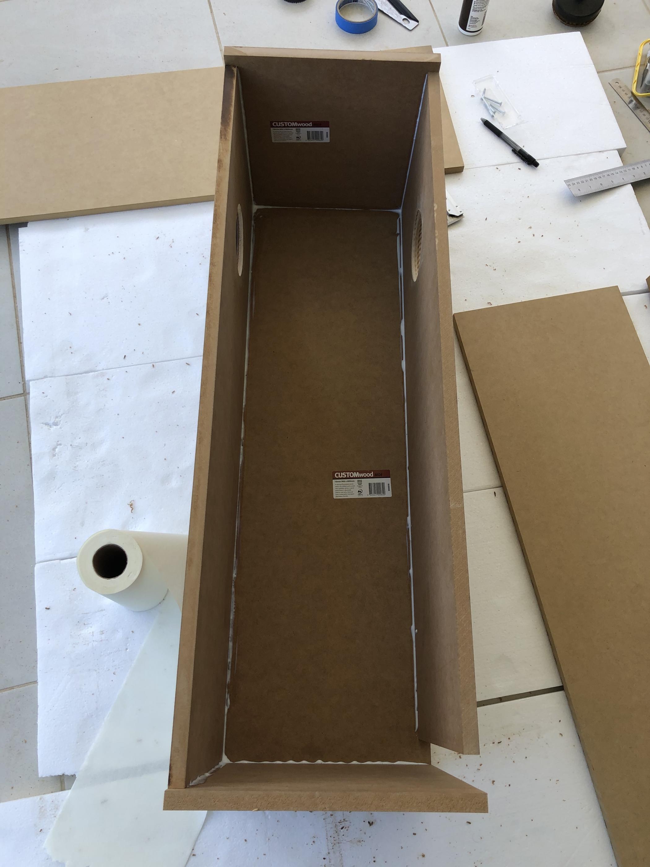

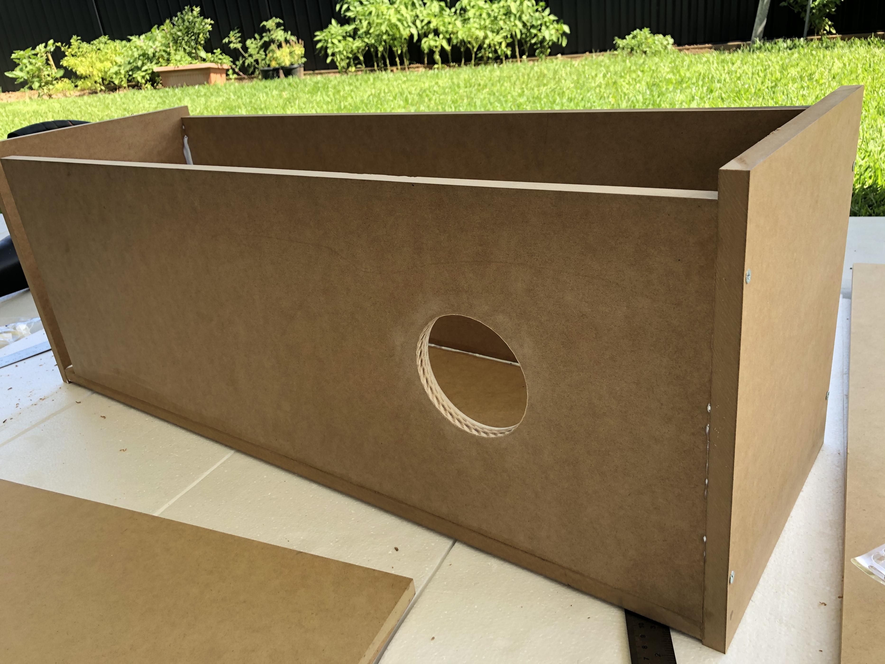

Despite the advise from Chris, I ended up building one speaker cabinet from the measurement Dave provided. For now, I have only built one to test and learn, and reused the Dayton drivers that I had from previous build, and will replace these once, I am able to get the Pluvia 7.
Given the current situation, I cannot get the MA Pluvia 7 drivers, but that didn't stop me building the cabinet for it. After all, what else is there to do, when you are trying to isolate your self from world.
By the way, I went with MDF as plywood at local store was quite a bit expensive for 19mm sheet at $88, and I would need two sheets for one cabinet. Also the MDF is 16mm thick, as that was the thickest I could get from that store.

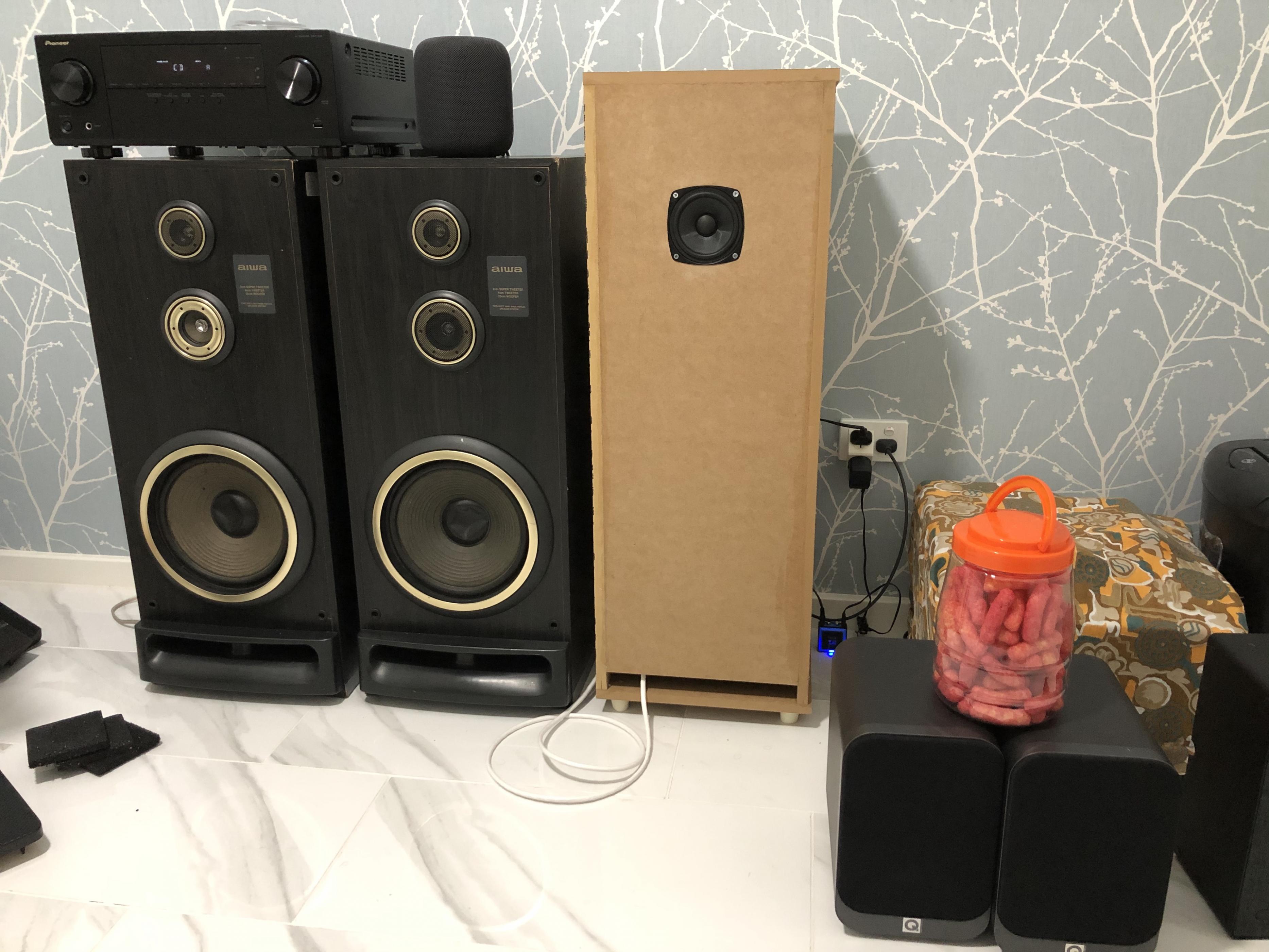

It ended up great. Even with the Dayton's driver the bass has improved a lot and does sound big. It is a bipole speaker with one driver in front and second one in the back. Once I get the drivers, I will work to build a second cabinet and then decide if I want to stack them and use it as quadruple or separate them and use it as stereo left and right.
Here are some pictures of the build.

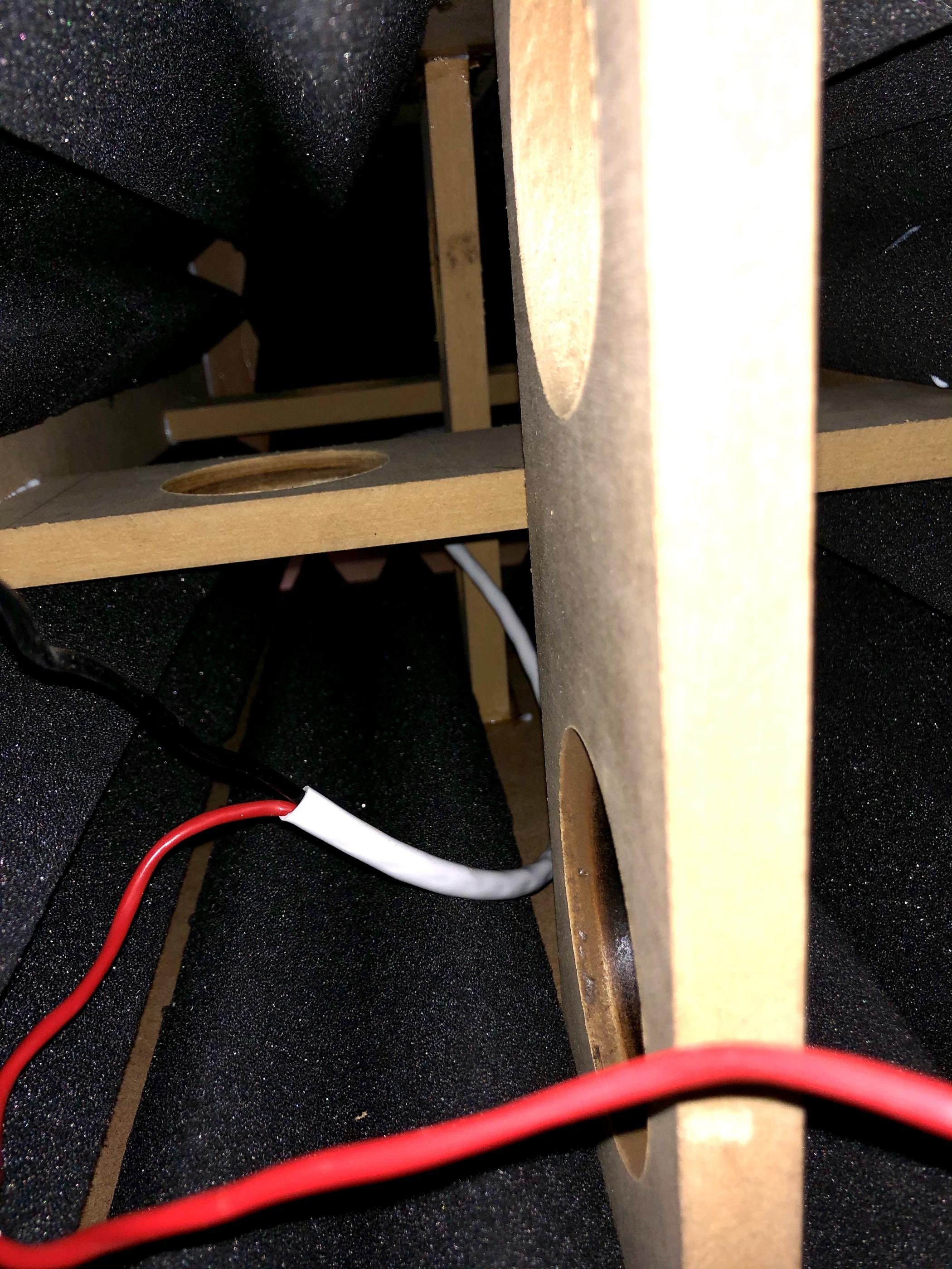

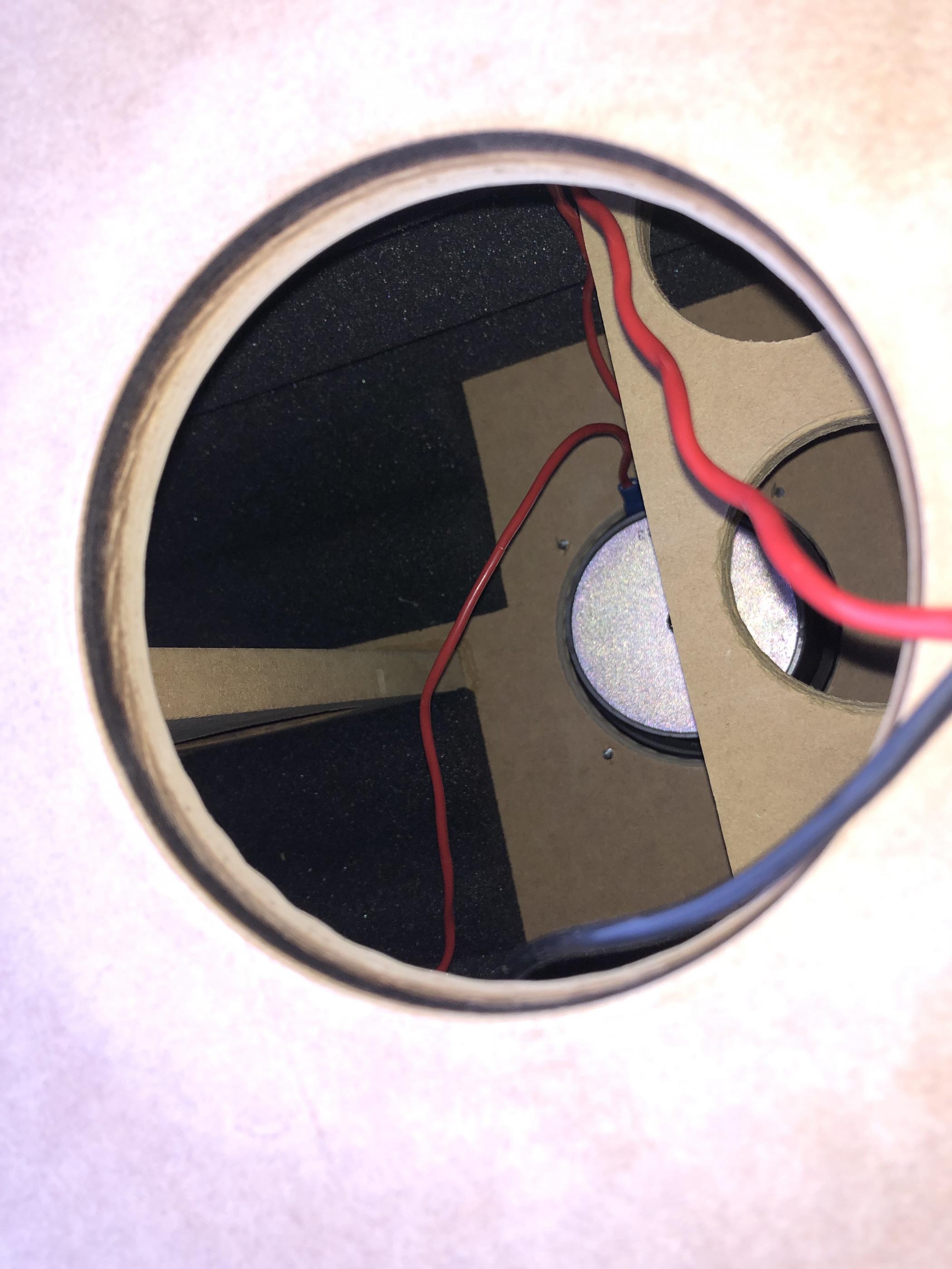

I ended up using acoustic foam to line the cabinet walls, as I had few to spare instead of polyfill. As for the braces, I cut 5 pieces of MDF and cut couple of holes using holesaw and glued them wall to wall in the middle.

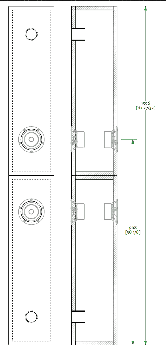

Needs to pass thru QC. Considering it a further optimization of the miniTower. The top driver could come down some 24 mm by making it monolithic and making it out of 15mm (more than adequate — with drivers well coupled 12mm would be sufficient. A 7” (inside) square prism 30” tall.
attachment.php
dave
Looks good. :) If a quadrupole was wanted, then absolutely, just make it a monolithic single enclosure; that will immediately chop 12mm - 15mm off the height as only a single solid internal divider would be necessary. Edit* This is design on the fly as it were; I've been able to adjust the tap location to get the upper drivers a little lower when run as a quadrupole. The sound you hear is Dave preparing one of his inventory of personal ICBMs for a strike on my house.
As I put in my email to Dave, my thinking on this one was that the lower section would have the lateral-radiating driver pair, the upper the front-rear radiating pair to place the direct radiation from the front unit nearer a typical ear-height.
Quadrupoles are unusual variation on the near-omni theme; EPI's are the only relatively successful commercial example that I'm relatively familiar with notwithstanding the HF units on, say, Infinity's Holosonic.
