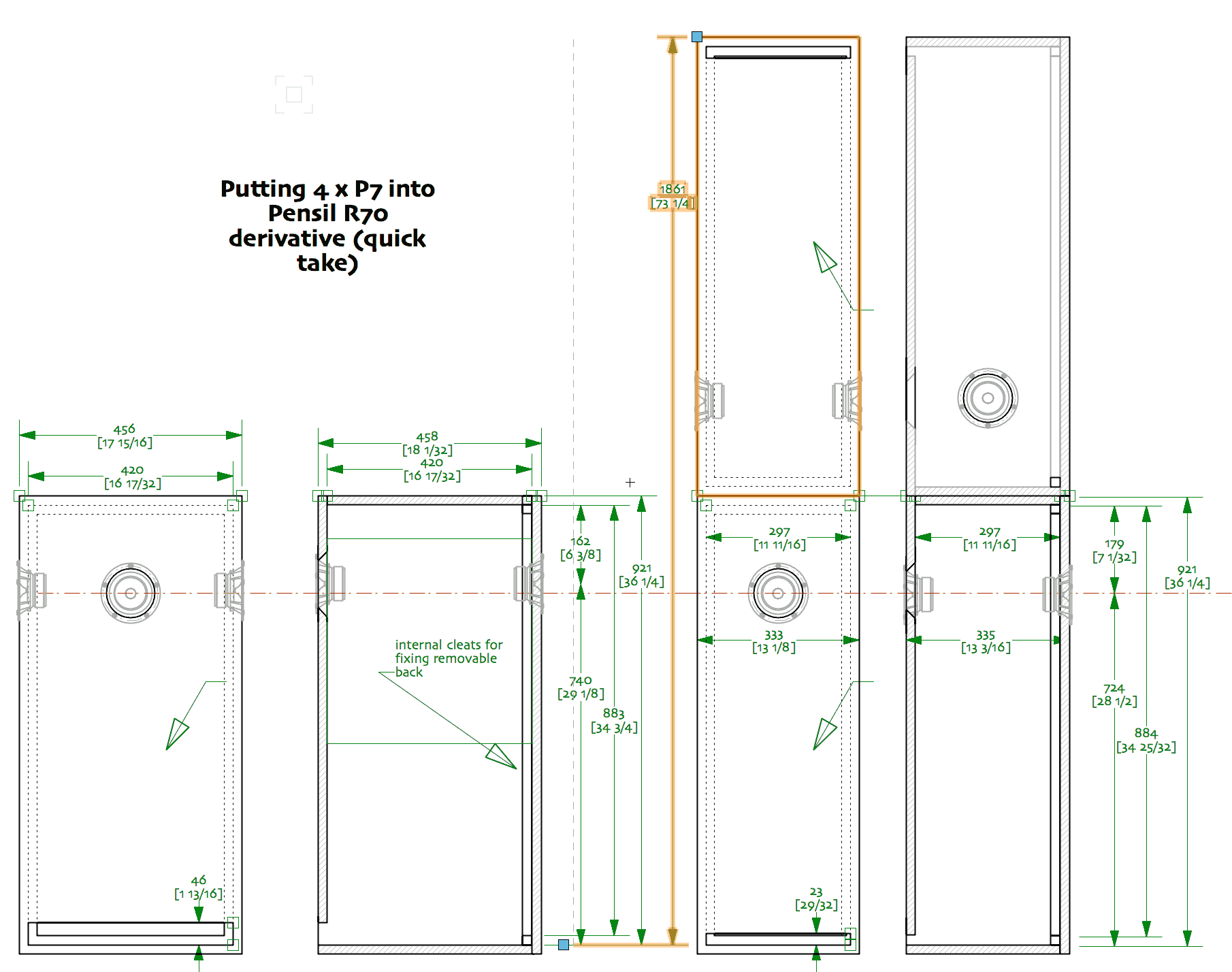

This is the Pensil for it, which gives the most options for arranging 4 drivers. 4 drivers are gonna move some air. And it will be big. Either fat or tall.
https://frugal-phile.com/boxlib/pensils/PensilsS70.pdf

Nominally quadruple the CSA and vent. Given the proportions, the pensils are not an ideal basis for multiples as they're designed from the outset as acoustically large alignments and as the CSA grows, due to the necessary proportions things start to become a bit more problematic than with more highly forced alignments with a smaller starting Vb. Not trying to discourage the principle or adapting, just noting that the pensils are awkward for this particular use & others may be a better starting point (or dedicated as I'm working on -will let you know).

4 in a single enclosure would be small freezer size, or a near 1/2 m square prism 6+ ft tall. Why i brought Scott to the thread to see if a slimmed down variation could be developed.

In the 1st Quad Pensil (the squat one) the back driver could be placed up top, and the wxd dimensions manipulated. The square one allows you to play with front+back or all 4 sides.

I am starting to realise this is going to be a huge speaker set. Perhaps, I should focus on two drivers per speaker instead of 4 drivers in each.
Just to be clear, are the measurements in mm?
Drawn in metric (yes mm) with the software adding imerial units.
If you want 4 drivers and a smaller box both a driver that gets away with a smaller box and an alignment that allows for a smaller box. For instance the P11 can get away with a smaller box than teh (smaller) P7. And the Pensil alignment needs a big box.

Drivers with powerful motors and low Vas can make smaller enclosures. Something like a 3FE22 has a 2.25L Vas. You could make a quad driver speaker and box is only 9L. Not very big if made a tall MLTL.
You could unwrap this into a straight tall box. Increase cross sectional area by 4. Increase the vent area by 4. Mount 2 drivers front and 2 drivers on the back. One above 1/3rd from top line and the other just below it.

Bass costs space. P11 or even more so P7 in an MLTL will go at least an octave lower. Not to mention the air they move.

The Pensils for the P7 illustrate a big ML-TL to go low and have a solid midbass punch. At the other end the microTower (same tuning as the EL70) gives a very compact ML-TL.
(from before 2012). You will note the tall ones (1 set on top of the other) for 4 or 8 drivers, and the fat quad which could have one of the drivers on the top.
