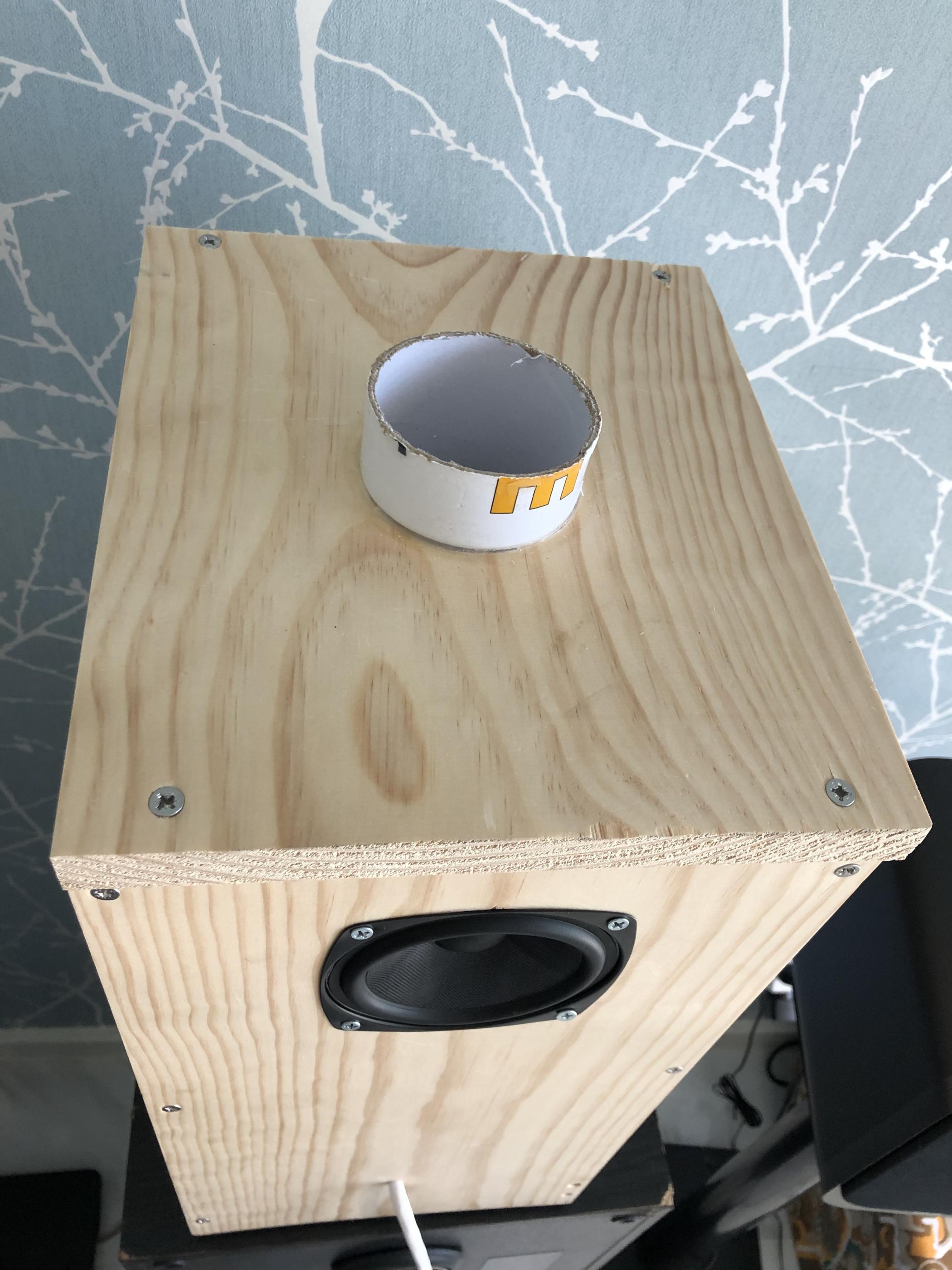

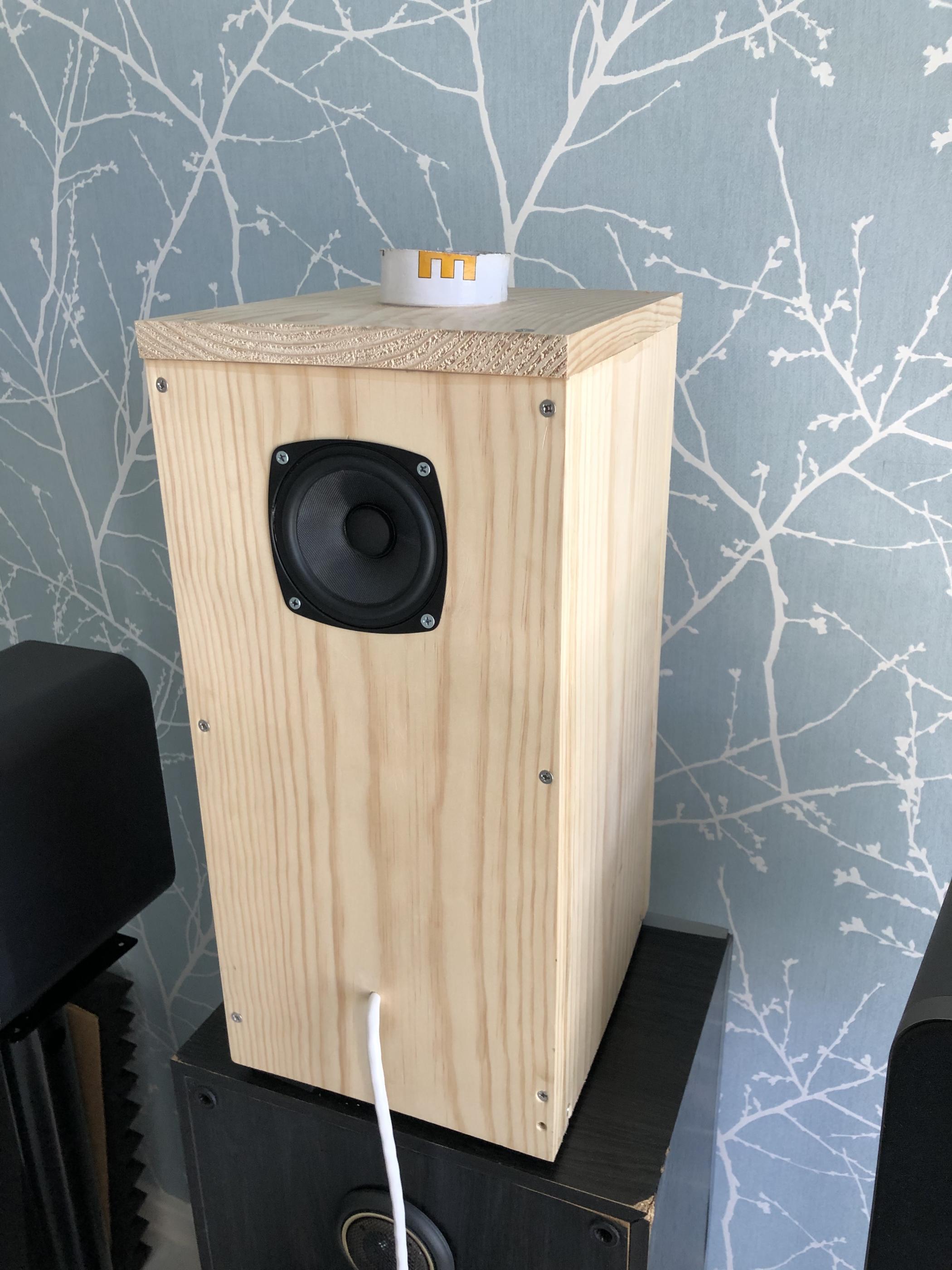

Here is the one I build. As I have mentioned, no measurements or calculations were used, I just built it with available wood and was impressed so much so that I stopped listening to my Q Acoustics 3020 bookshelf speaker. Oh! also I only built one for test and currently listening in Mono.
Your design is exactly how I want to build mine, but with transmission line port. Reading that post, I saw lot of talks went into to determine the size of the cabinet and port tuning.

attachment.php
Is that the vent out the top?
dave
Oh yes, that is the port up top. 😀
Initially, I had no plan and no right tools to do the build. You will see I used the screws to secure the cabinet, no wooden glue, but I did have silicone seal laying around and used that to make it secure and airtight. By the time I decided to drill a hole for port, it was too late to take it apart and the bottom was filled with poly fill so instead of risking the poly fill to leak out from port at bottom or sides, I decided to port it up top. This was just a try anyway, I didn't care for looks.
As for the port tube, I had some cylinder cardboard packaging around for some papers, so I drilled the hole to that size and stick that in and put silicone seal around to secure it.
