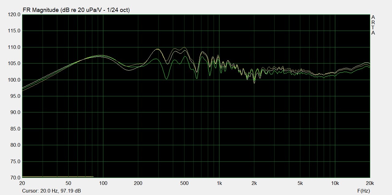

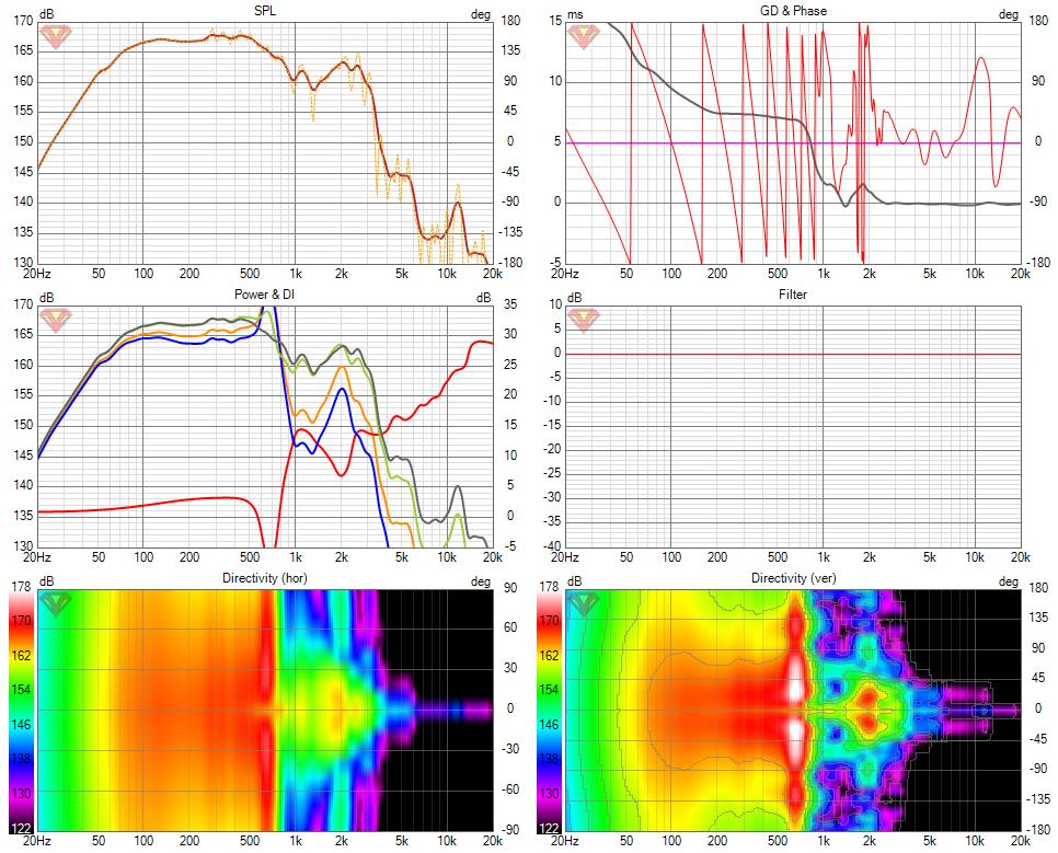

Yes, this mid is misbehaving when it comes to directivity and FR, remember the cardboard tests earlier in the thread? I actually have a pair of dust caps on the way that I want to try to stick on to see what happens. As it is now, any EQ I apply on the mid just seems like a bad compromise, so I might be better off without all the EQ attempts, that's why I want to try the simplistic approach too. Come to think of it, I should measure the second mid and compare them..
The waveguided tweeter is better, some bundling, but good enough for me I think.
Actual final listening position will be within a couple of degrees from 0, so whatever my ears can make of the last octave should be there
From earlier experiments, I think my preference was lower order slopes with moderate amount of linearization to the drivers responses before the XO slopes were applied. However, back then I was only measuring on axis, and a few occasional off axis measurements as a 'sanity check'.
My measurements might not be the best.. I measured the mid box separately, so there could be some influence from the bass box when it's sitting on it. I did however make two sets of measurements on separate occasions, and they did seem to match pretty well. I should however run some simple measurements on the complete speaker with filters applied to see that it is similar to the sim.

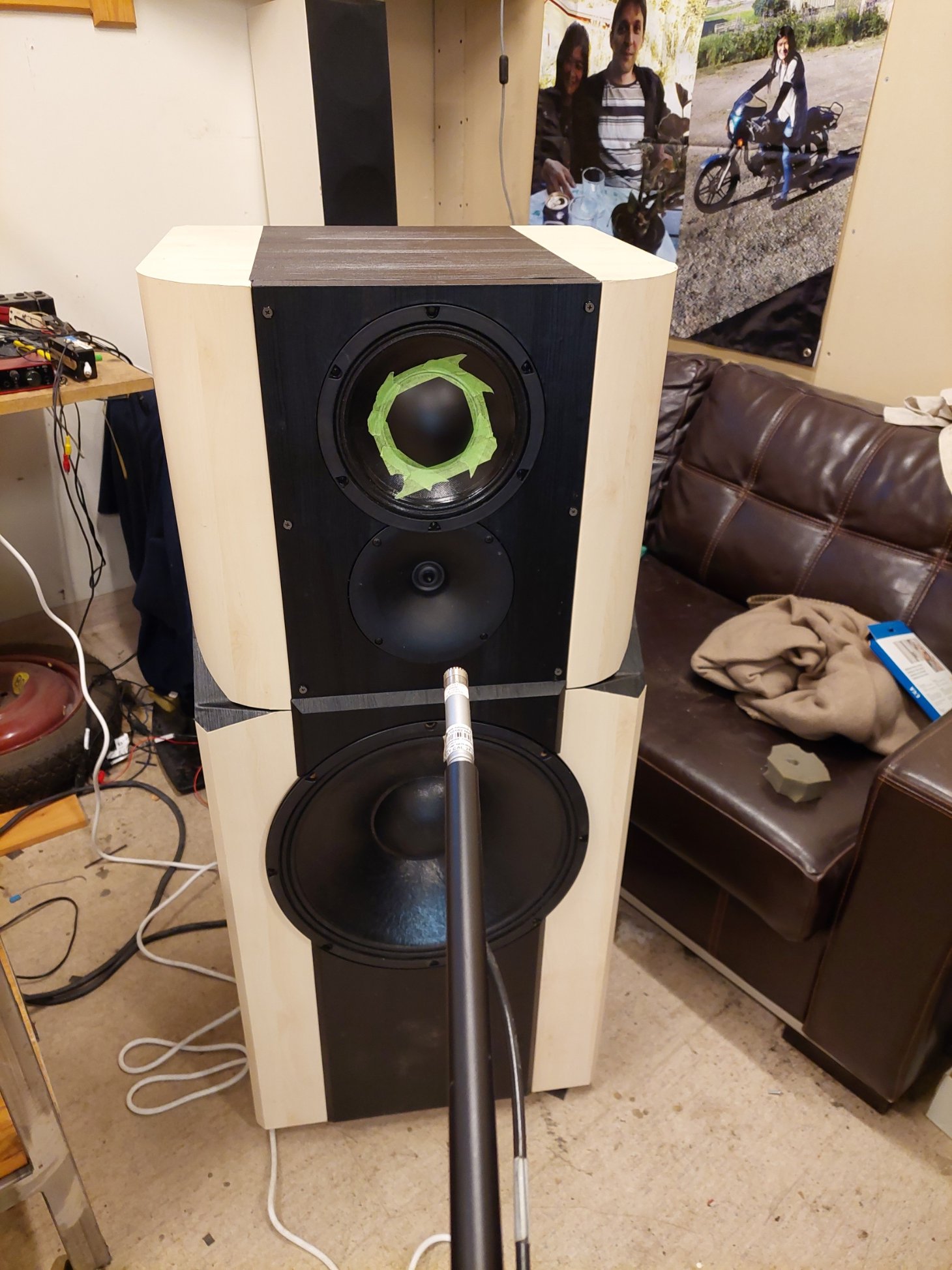

I did the offset/delay checks, and mid to tweeter was close to sim/measurements. Mid to woofer puzzled me for many reasons, I ended up doing it by looking at the impulse response to find the delay (mic placed halfway between drivers). Delays are now 0.55ms mid/woofer, and 0.03 mid/tweeter.
Another confusing thing was that I had to use different polarity between woofer and mid to get summation with LR4, and that does not seem right to me? Maybe there is something going on with cables or amps, I have not investigated everything yet, but I could see a null around XO when they were the same polarity in minidsp. Mid/tweet LR4 is summing well with same polarity.
Had a friend visit in the garage, and he thought they sounded big, and I guess he's right. The LR4 version sounds pretty good now, but I need to add some slope to the FR, pretty close to flat as it is. It gets hard to prioritize when I want to tinker/measure and listen to music from the speakers at the same time..

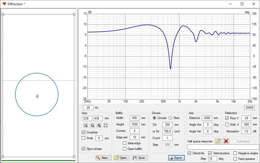

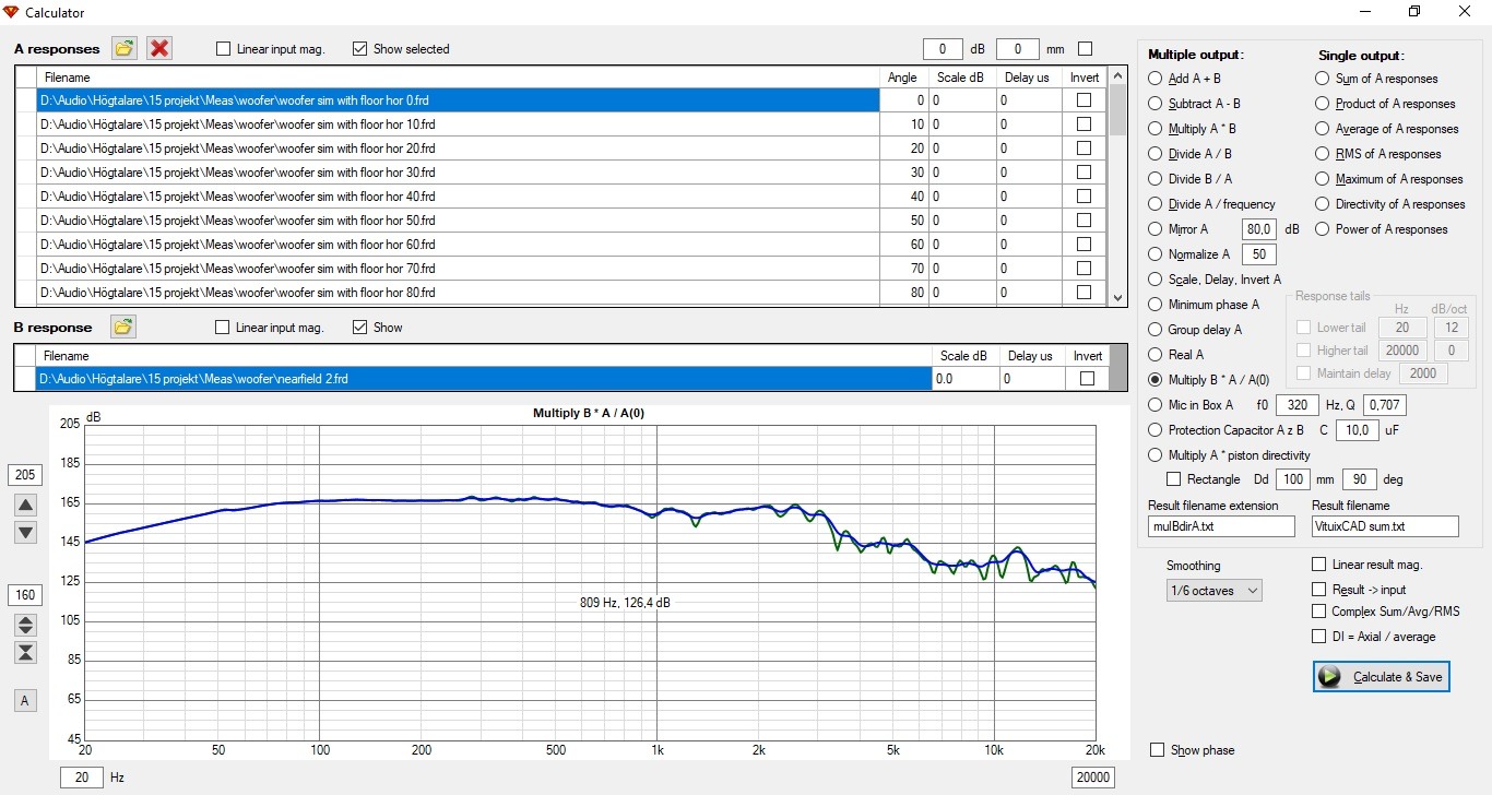

I have been looking at the calculated far field response, and it was not any good. After reading the manual I realized I did it wrong by adding baffle step response to the near field response (A+B), so I have been trying per the manual:
Multiply B * A / A(0)
Creates off-axis responses for measured or captured axial response B with directivity information in responses A. Directivity data can be simulated with Diffraction tool or compatible set of far field measurements. Response A to 0 degrees is reference in directivity calculation.
Default result filename extension is mulBdirA.txt.
This is not working either, the on-axis response is the same as the near field (no baffle step added) that can be seen as an un-smoothed overlay in the FR graph, and the off axis looks really wrong. I'm not sure what I'm missing here..

I think solved my baffle step calculation problem above. The 'Multiply B*A /A0' per instruction is aimed at far field measurements and removes the on axis baffle diffraction response A0 (including baffle step) from every calculated response (diff from to A0). If I just multiply A*B, the actual baffle step is included in all the generated FR's, and everything looks good. Since the woofer woofer was measured in a near field measurement, the baffle step is not in the measurement, the on axis diffraction should be included. This is what I imagine at least..

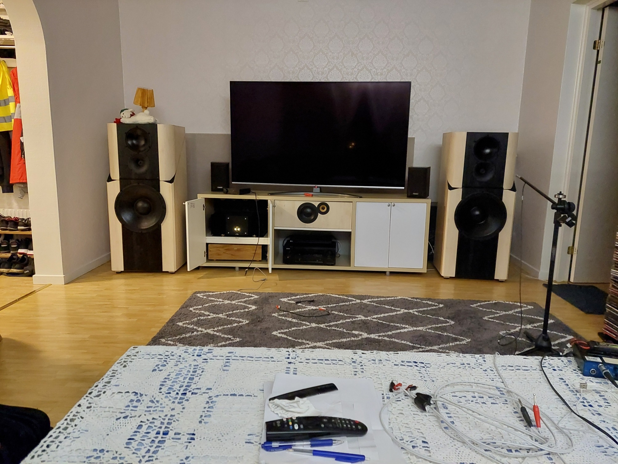

Now the speakers have moved in to the apartment, and the old ones have moved to the garage:
I use other amps now, a DIY high bias AB for tweeters, a Alpha Nirvana class A for mids, and a Yamaha P1700 PA amp for woofers.
However, I have hit a problem. I connected everything up at home using the same laptop etc, but now USB sound from the laptop cuts after maybe 1sec of playback in ARTA, so I'm not able to do any measurements The USB link is still working with the minidsp config tool, but no sound.. I'm using a 5m USB extension same as in the garage before, but I also tried without that, and had the same problem. No charger connected to laptop, so there can't be any ground loops via USB.
After unplugging the minidsp and restarting the laptop, I got 1sec of sound again, and after that nothing..
Bluetooth works, but the measurement laptop has no bluetooth.
Levels should be re-tuned to these amps, but I have no way of doing it now.. I contacted the minidsp support to see if they have some ideas.
