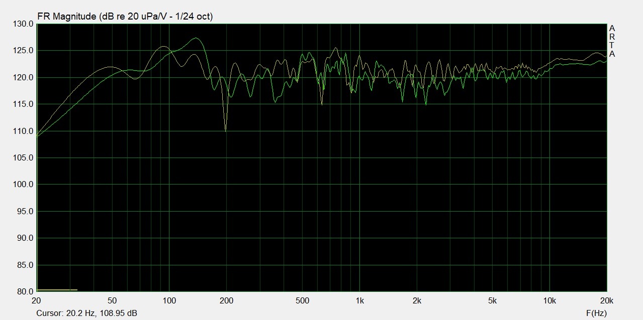

I disabled the 'sloping curve' and did a pair of 'long gated' FR measurements at close distance just to match the gains for the amps, and a pair of at listening position. Room improvements can (should/must) start soon.. I can't do much about positioning of speakers or listener due to room/space restrictions, so I just have to make the best of it.

A small update:
I have spent some time listening to these now. I think I prefer LR2 between mid/tweeter compared to LR4. Between mid/woofer I'm not sure. I tried LR2, LR4 and 'electrical 1st order' so the slopes are shallow at the XO point, but get steeper further away from XO. There is still some stuff to do on the integration between those I think, and also on the tuning of the woofer/bass with the room.
I think they sound better than my precious speakers in most ways. I especially like the sound of female voices on these. At the same time, I think something is happening in the lower midrange that 'enhances' the female voices, but sometimes time can sound a bit different/wrong with other stuff, or it could be my ears are just used to the sound of the previous speakers, and this is more correct.

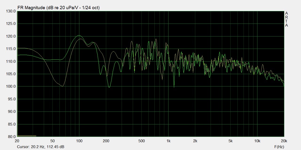

I also measured the L & R speakers separately at listening position, and made some channel specific room EQ. It seems they excite some different modes in the room, so I figured I should try to EQ that individually too. Not sure if this is the correct approach though, but it seemed logical at the moment.
