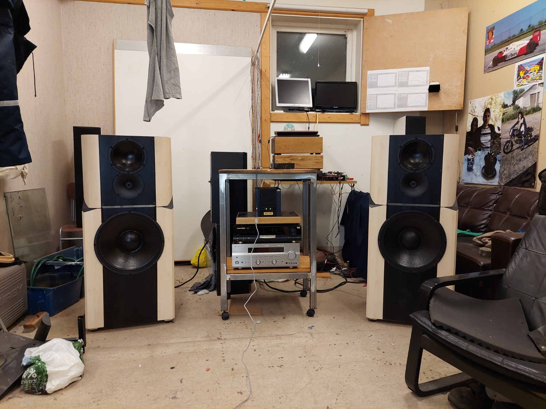

Not so much more I can do on the speakers before the second mid arrives, but I did 'glue' the magnets to the bracing today. I put masking tape on the magnets and a liberal amount of elastic (acrylic?) glue on the bracing, then mounted the drivers loosely and left it to dry. The intention is to tighten them down a bit on the gaskets after it has dried. The tape should come off the magnets if I want to remove the woofers. I guess I should check the impedance after for see what happens to the 250Hz basket resonance.

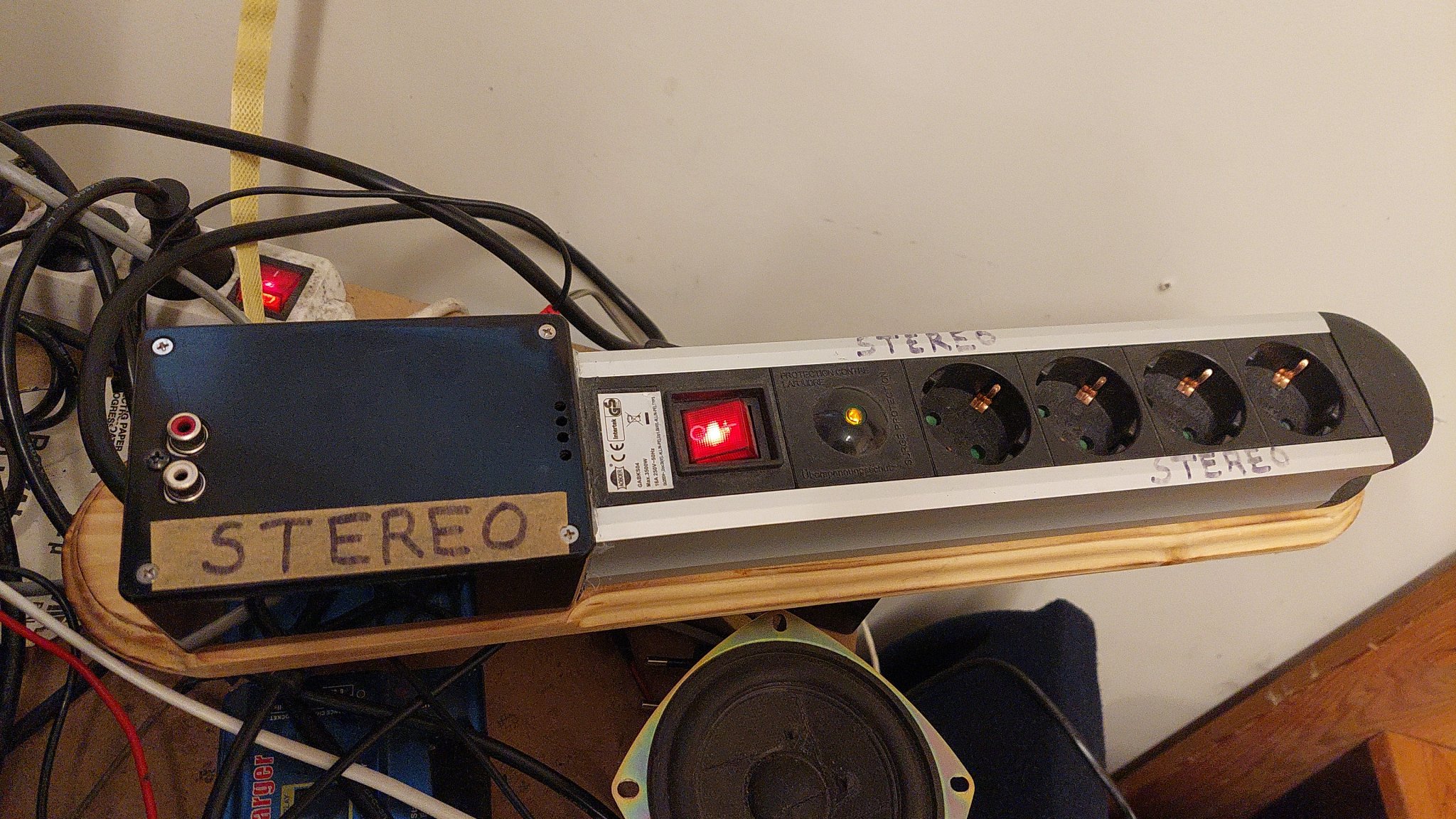

I have also done some side-project to prepare for running the active setup. I built the ESP signal detector https://sound-au.com/project38.htm to power up the amps when there is line level signal from the Flex Eight.

Pic below, clearly marked so the better half knows it's not for hair dryers or whatever 🙂 Has some DC-blocking and other small stuff inside too. Switch on 0=auto, and 1=manual override

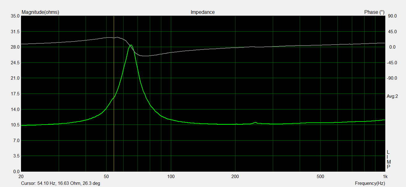

I measured the impedance with the supported magnets on both speakers today, and pulled up an old measurement (first graph) to compare. The scaling is wrong on the old measurement due to some problems with the 'measurement box' but I fixed that today. The 'blip' at 250Hz is basically gone, and I don't se any obvious ill effects higher up either. I realize now I have the marker on 54Hz in both graphs, there is something (minor) going on there too, but not sure what. I'm thinking the box is not long enough to have a standing wave at 54Hz..? Any ideas?
Regarding the 250 Hz blip that disappeared: my speculation is that it was a cabinet resonance, and by supporting and restraining the magnet, you changed the response of the cabinet. Changed it for the better.

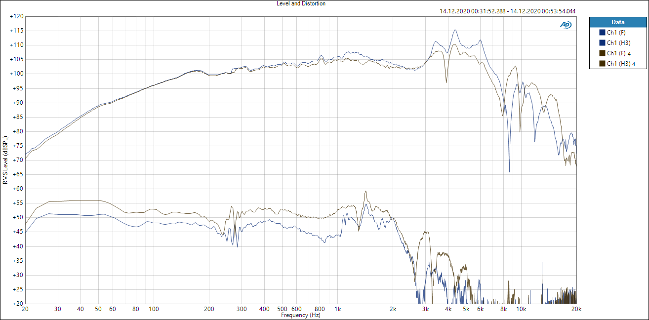

I think I have to disagree on that. If you look earlier in the thread, I had the woofer mounted with the magnet outside, and could feel the resonance in the magnet (but not in the box), and I compared impedance when I was pushing it with my hand, and it had a significant effect.

There is only one 200mm driver vom them, Wom200 something. It simply is better suited for getting down to 80Hz in a closed volume. And Qms is higher and it has a more "clear" midrange - but also a little more "sterile" midrange. My goal was to get as much resolution in the midrange as from an "high power" 8" driver as possible (and still be able to cross at 80Hz - so no pur PA midranges). Downside - it has an area of high H2 and I'm not sure about consistency of the brand. They change drivers and make them better, not all drivers are always available ... a risk I took for my private speakers but not sure if I would stick with them for a commercial project.
The PHL drivers are old, made the same way since years ... and still with the absolute best money can buy! Midrange in the (not perfect but as good as possible) listening comparison was more "warm" and pleasant, but with less details. Also lower Qms.

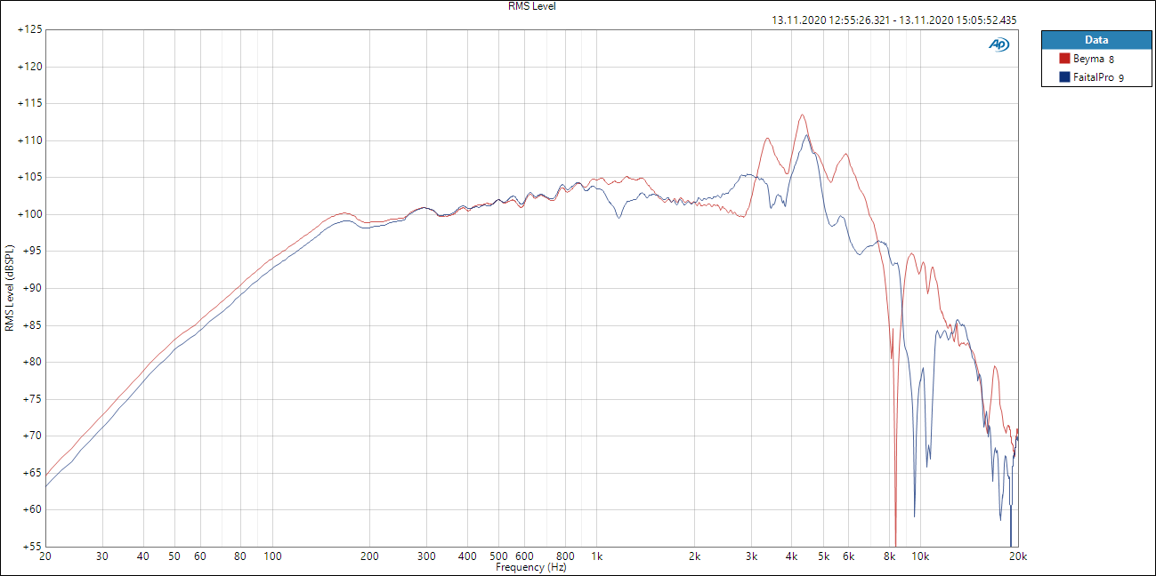

Here some of the many measurements. When there are topics related to these drivers I probably pick some and post them, but I'm not regularly reading here.
Kartesian Wom200:
Beyma old vs new:
Different drivers .... and so on.

Well, the midrange finally arrived, so now I made a basic setup in the minidsp flex eight just to be able to get them playing in the garage. Linearized the drivers with some basic parametric filters in vcad and copied biquads to minidsp, and then added std LR2 filters on top of that (300 & 2kHz atm). Amps are from 'stock' Tweeters run by a DIY JLH class A, Mids from a (modded) HK670, bass from a DIY class D in a AV receiver case. I have been tuning delays between drivers by ear (found this to work well in the past), same with amplitude balance between drivers etc, so very basic still, but the 'new speakers honeymoon' can begin 🙂
First thing I could noticed was some 'thickness' of male voices from the bass. Could be some resonance, or just the preliminary filters, sounded a bit resonant though. The 'listening room' is what it is, but I want to find/correct problems before I drag the speakers home. I rent the garage, and it's not next doors to my apartment, so there is some effort in moving them between locations.

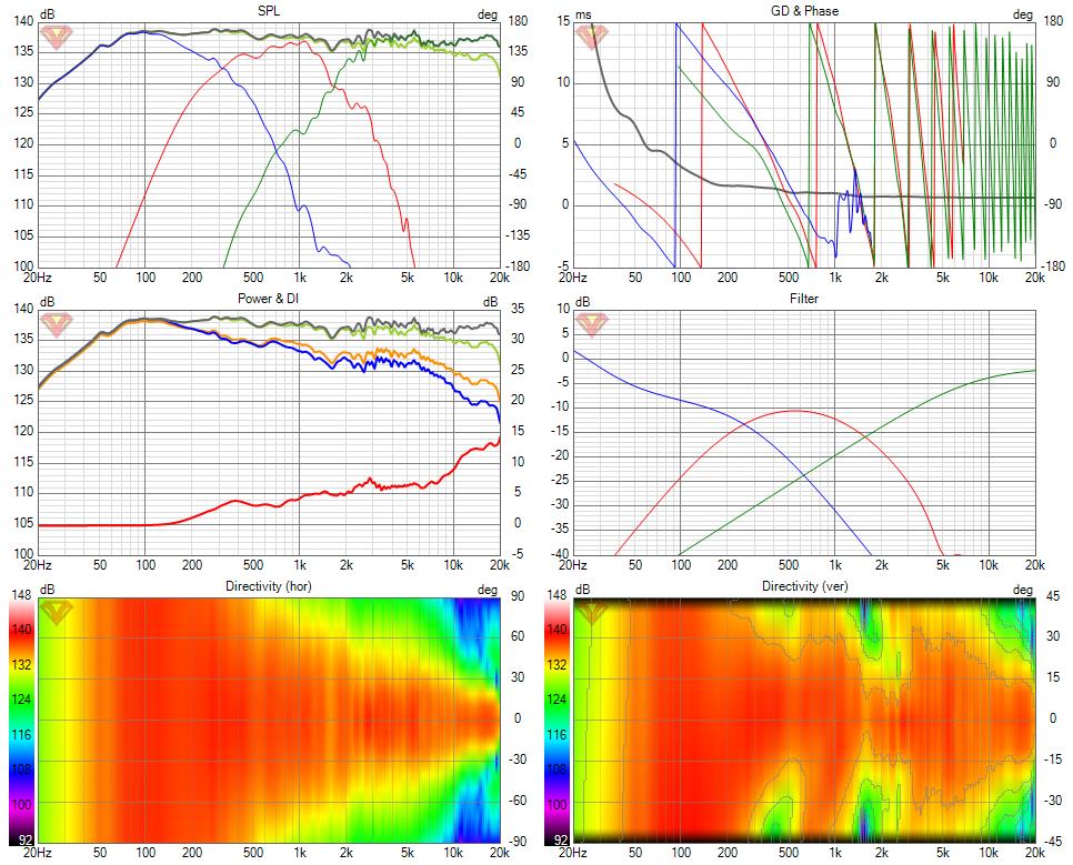

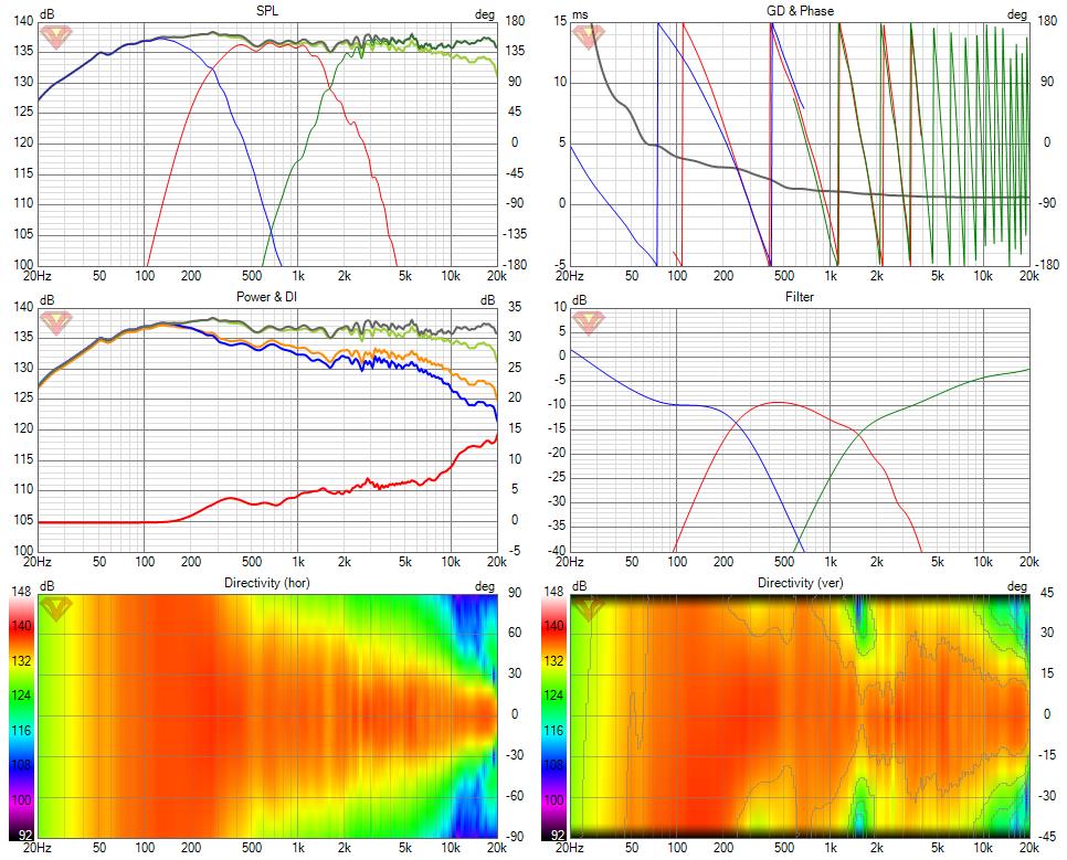

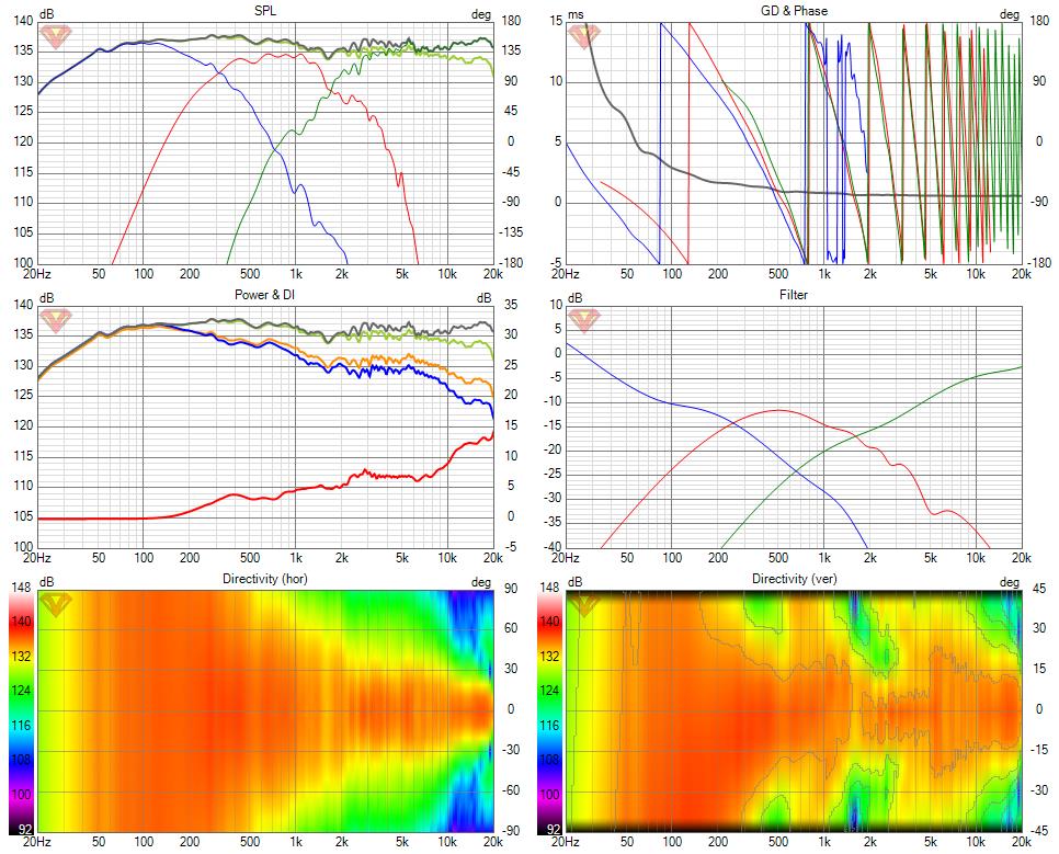

I made a few variants to try. These are a little bit based on what I would and would not do in a passive XO. Simple and complex LR2 is what I would probably try as a passive, probably not complex LR4. Anyway, here I can try whatever 🙂
Simple is using as little correction as possible, and just crossing over where it seems natural, and not worry so much about wiggles etc. Complex I'm trying to do more EQ to the response, that would require more components in a passive XO.
LF EQ is still a wild guess, something I ended up with yesterday that sounded reasonable in the garage.
'By tradition' I'm still focusing a lot on the on-axis, but I'm trying to do some compromises here.
Feel free to comment!

Yeah cool 🙂 While there is doubt in accuracy of the measurements there is no reason to go and tweak every detail as it might be wrong thing to do. If the measurements are good then there is no reason not to EQ! EQ your hearts content, especially if the response is nice for more than one direction so that you are not making one exact position sounding good while sacrificing every else position. When DI is smooth the EQ fixes both axial and power response. This is where the "good measurements, good construct" thing I mentioned comes from, if the acoustic behavior of the system is nice you can pretty much EQ the system to what ever target curve and its nice anywhere. You took some lengths to mitigate the edge diffraction for example so enjoy its benefits.
Few simple observations, the last octave beams hard so you might want to make the on-axis as main listening axis, its up to you though how you want it. If you check out normalized directivity chart (horizontal) you might be able to spot if there is any edge diffraction going on, if not then you could just EQ the on axis what ever you like, try the optimizer and preference rating at some point. Some edge diffraction might be hiding when the measurements are windowed and you might be able to tune the sound better by sliding the lower crossover point for example. If you have power available you could boost the mid driver if you want to, to get lower crossover point there, for example. Basically you can sacrifice some of the system sensitivity for smoother response as you can pour gobs of power in and still get plenty loud enough.
The complex LR4 looks smoothest of the three as there is no sudden kink in power / DI, but there is difference how everything sounds for each of these and you might just as well prefer some of the other settings. It is how ever possible to do complex LR2 xo which might sound the best 😉 and even then make it better, what ever that is. It is good excersise to do tweak the current measurement set for very smooth responses, although if it doesn't represent reality the sound might not be there but you'll get experience using the program so its not time wasted.
