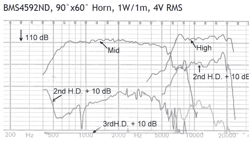

The crossover of the BMS 4592ND is the problem that must be EQed properly. My default approach is to use DSP crossovers (Xilica, EV, Yamaha) to solve that problem. Sibilance is in the 4-8 kHz region, and if you don't correct for the hump in response in the tweeter at 7.5 kHz, you're going to hear it a lot. I'm also not sure what the relative phase is between the midrange and tweeter diaphragms at the 2" driver exit--it may need to be time aligned (i.e., I don't have the data). It's pretty straightforward to do that using a DSP crossover.
If all of this is too much to digest for your uses, or you're trying to use passive networks only with no correcting PEQs upstream, then I'd not recommend the BMS 4592ND. I'd probably try the Radian Be or some other driver instead.

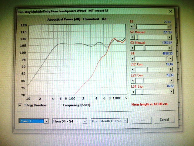

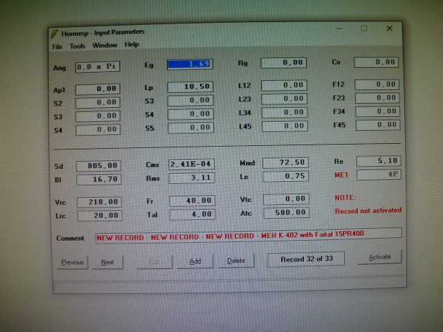

Hi Chris,
I got my hands on a pair of Klipsch K-402 horns:).
I have made a simulation with a pair of 15" Faital 15PR400 woofers which should be excellent, suits your description for candidate woofers fairly well, and are at the same time very reasonably priced here in Europe.
I simply copied your input parameters for the K-402 horn with the TAD 4002 and the Crites' woofers and only changed the T/S paramters for the woofers (i.e., from the Crites to the Faital woofers). Both the Input and the Power1 output is attached. If I am doing this right, the Faital seem to model well. Agree? (Note that since the Failtals are 8 Ohm, I intend to wire these in parallel - not in series as with the Crites)

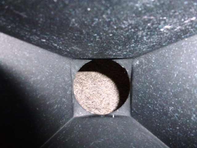

I have a few questions regarding your MEHs that I hope you will respond to:
1. The depth of the throat entries for the woofers are 10.5 cm in your model. Is that correct? (to me this number seems rather large)
2. Where do I see the size AND the location of you input holes for the woofers in the model? (two input holes for each woofer, right?)
3. The K-402s look really great! However, I was a bit surprised to see that the throat transition from round to rectangular was not as smooth as I had expected. It is not terrible, nut it is not perfect either (see pic). Have you done anything yourself or considered to improve on the transition?
Thanks a lot!
Best regards
Peter

1. I think that I was intending that parameter to mean the distance from the horn's throat to the off-axis ports. Correct me if I'm wrong.
Things in Hornresp (including the Multi-Entry Horn Wizard) might have changed since the fall of 2015 when I last used Hornresp.
2. I believe that 46. 2 cm^2 is the combined port size (the sum of two off-axis ports per woofer). If I got it wrong, please correct the value.
3. If you look at all the Klipsch HF horns, you'll see that same pattern around the throat. It's not a mistake and it doesn't need to be "corrected". If you do change it, the directivity vs. frequency will be strongly affected (negatively). I don't recommend messing with that area--no putty or thick paint coatings in that area. In other words--don't change it.
Chris

1. Just looking at Qts and Fs numbers, it looks good. MEH loudspeakers are actually tolerant of woofer parameters--woofers with bigger motors and lower relative moving mass. I've found that Hornresp doesn't really tell you the real frequency/phase response of the K-402-MEH woofers. Their real SPL response was wildly different than extrapolating the SPL response from the predicted power response from Hornresp. (I think that I've posted the raw response in the K-402-MEH thread on the K-forum.) The bottom line is that you're going to be EQing the woofers with one big attenuating PEQ centered at ~230 Hz (-15 or greater dB, bandwidth of ~0.6). The K-402-MEH woofer response is actually flatter than the Danley SH-50 woofers--quite a bit flatter in fact.
2. The off-axis ports in my prototype are actually 2.5 cm deep (1"), but I'd recommend they be much shallower. You can taper the woofer mounting pads in the off-axis port areas to thin them down to the horn's ABS material thickness, starting about 2.5 cm or more away from the through hole. This has advantages in terms of performance. The ports don't have to be any thinner than the horn's present thickness at the entrance to the horn itself, so you do need to maintain some structural integrity and stiffness around the woofer off-axis ports.
3. The ports are chamfered on the opposite side, and I'd chamfer them even more than the prototype used, as mentioned above.
4. The off-axis ports are elongated by about half their diameter, toward the mouth of the horn. I sized them for a 10:1 compression ratio of the woofer cone to port area. That's about as high as you want use in my experience (and is a little higher than the compression ratio in the SH-50 woofer off-axis ports). You want to maintain efficiency of the woofers on the horn, and there is a direct trade off of efficiency with compression ratio.
5. The beginning of the off-axis port radius is 6.5" (16.5 cm) from the edge of the throat radius. Make sure that there is sufficient wall remaining between the two spaced ports next to the top and bottom walls of the horn. The wider the wall thickness, the better the off-axis polars around 400-500 Hz. The trade-off is the chamfer on the reverse side of the horn for the off-axis ports to make the effective depth of the ports as small as practical. I used elongated circular ports of about 2.4-2.6 inches (6-6.6 cm) diameter, and that seems to be a good compromise, but it's certainly not the only compromise that will work.
Since K-402 horns tend to be a little expensive, I'd not take too many liberties making the ports into long, thin slits--like that German MEH loudspeaker (DynamiKKs Ultima!...the very expensive ones). I think that efficiency still matters, and the slits really don't support efficiency. (Danley also doesn't do that either with their Synergy horns.) I'd also orient the elongation axis radially away from the throat, not across the horn wall as the Ultima! has them.
Chris
