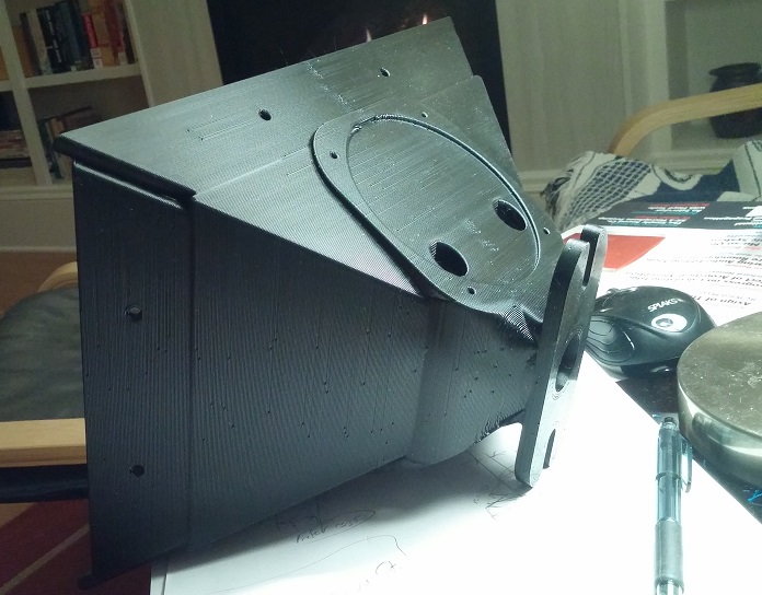

About the specific kit Chris is making: what kind of moulding technique will be used? You mentioned that you wanted to already put in the woofer holes because it would save on material. Note that this will very likely make the mould more complex, and therefore much more expensive. I don't know how many pieces you would like to make, but in the end it might be more beneficial to not pre-hole the horn.

That portion of the task is far behind. Perhaps you didn't catch the post in this thread where I explained my rationale...and constraints. And the complexity of the mold is really controlled by the geometries of the woofer mounting pads. The woofer ports are really quite simple to capture once you find the right approach for the back mold construction/materials. Leaving the ports out actually leads to a more complex solution in the chosen approach.
In that case, leave them in
Regarding weight: are you employing any techniques to get the weight down without sacrificing (to much) strength? If not, it might be interesting to take a look at that kind of stuff. For instance honeycombing the out of view structures of the horn. Look at for instance wat B&O does:
This will obviously make the mold much more complex and might increase initial cost.
Also, to keep the dimensions down you could even make the thing out of multiple identical parts. This will increase tolerances significantly and will not at all benefit your personal goal to make your horn, but will help with shipping since it will significantly decrease the volume needed.

Right now I'm all in on doing the single-piece horn. When you have one in your hands playing music at 100+ dB with woofers and compression drivers in its box, perhaps you'll understand my rationale. The idea of multiple piece horns are definitely "down the road a bit", but it's an interesting challenge to think about, nevertheless.

* which could be as little as a set of cut sheets + instructions, and a bag of custom built (3D printed?) parts, such as angle brackets to brace & hold the throat together while the glue dries.
Bill Waslo proposed something like that, basically a waveguide that can be 'scaled' to just about any size. Basically the first 15-20cm are 3D printed, and then the rest of the waveguide is a simple conical horn.
This is pretty clever, because arguably the throat is where you REALLY want precision. If you're off by a millimeter or two at the throat, it can make a real difference. But at the mouth? Or the center of the horn? It's no big deal.
I've made the plastic pieces for that, have them sitting around (got some for PB too). Haven't put them into a full horn yet, though, my table saw is out in the cold shed. Plan to make a set of humongo Synergy horns, but not sure I really will. Don't need or have room for them, and don't know what I'd do with them after they're made...
Something like this...
I did do a test fit with an early version, but managed to cut the panel corners wrong.... Really easy to assemble, though.
http://libinst.com/SynergyDIY/Assy%20Pics.pdf
