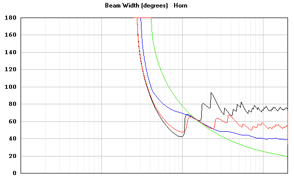

Le Cléac'h horns have issues with non-constant polars (as do all non-straight-sided horns). They work well as midrange horns only if placed far away from room boundaries and the room is fairly dead acoustically, but IMO fall apart when in boundary effect due to non-constant polars.
...If the K-402 is closer to conical (before tending tractrix) at the throat then its wavefront will tend that way over some range, making it appear to me to be a waveguide with a good conventional termination.
The K-402 isn't conical, but has about 2/3s of its axial length dominated by straight-sided sections. Polar coverage control is spectacular...shown anechoically here with vertical scales in degrees (not dB as shown). Handover to room boundary polars and corner gain occurs at the same frequency band as the Khorn bass bin (~110-170 Hz). Its large mouth controls polars below 170 Hz better than the Khorn bass bin:

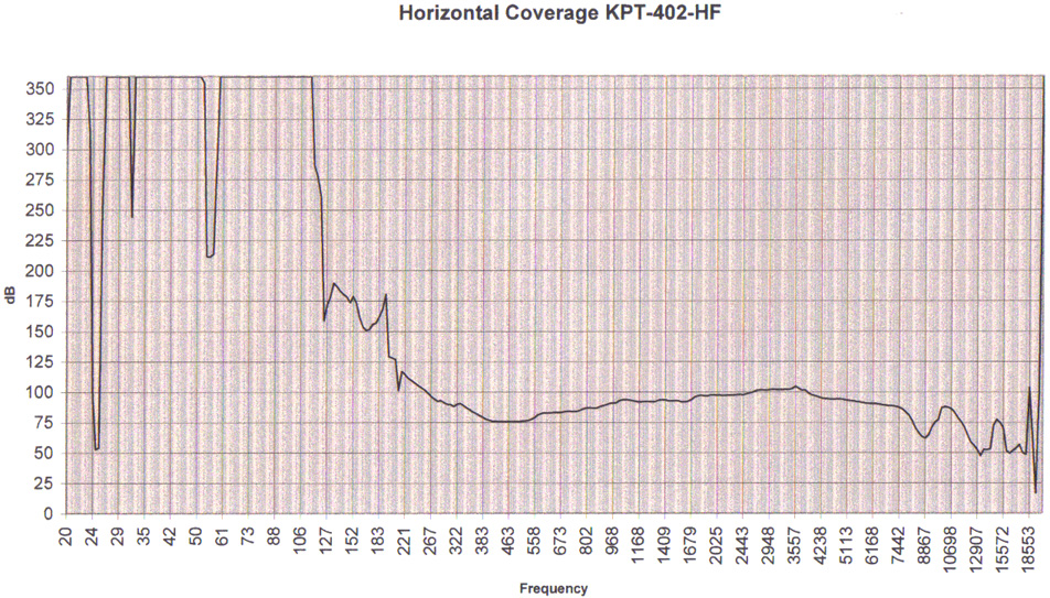

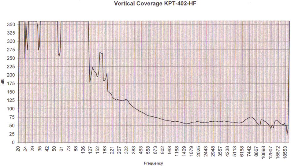

those are nice polars without a hint of beaming in them but I'm not sure exactly what I'm looking at. What is plotted on the ordinate - the angle at which the SPL is 6 db down relative to on axis?
Is this measurement data from your own MEH? How else would you get full range data? At the HF end, which CD was used and would that affect the apparent coverage ?
The horn begins to lose pattern control about where Keele's formula predicts but its interesting to see where it goes full omni, i.e. where it hands off to the boundaries. Its that transition region between omni and controlled where its so difficult to predict how the room and its boundaries will affect the sound and the measurements.
Yes.What is plotted on the ordinate - the angle at which the SPL is 6 db down relative to on axis?

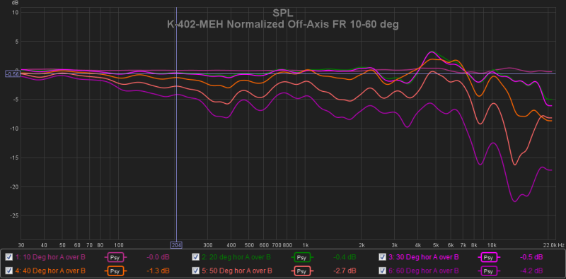

Here is a set of horizontal REW measurements on the K-402-MEH (normalized to zero degrees on-axis response) that I ran in my back yard on an elevated rotating base. Note that the designed coverage angle is 45 degrees (90 degrees included angle) - halfway between the two orange traces:Is this measurement data from your own MEH? How else would you get full range data? At the HF end, which CD was used and would that affect the apparent coverage ?
Put them into full corners and the transition is seamless (both measured and while listening to an upsweep). Put one along a wall elevated off the floor and the response is little changed except a loss of frequency response from 31-40 Hz and the widening of polars at 110 Hz--which is fairly graceful in that it occurs at a low enough frequency where localization of early reflections isn't an issue (i.e., all well below 170 Hz).The horn begins to lose pattern control about where Keele's formula predicts but its interesting to see where it goes full omni, i.e. where it hands off to the boundaries. It's that transition region between omni and controlled where its so difficult to predict how the room and its boundaries will affect the sound and the measurements.
I find that it behaves in a much more user friendly way in terms of freedom of room placement than the Klipsch horn-loaded bass designs. Perhaps this is due to the K-402-MEH having enough woofer radiating area to compensate for mid-wall placement.
This is why I like foam mouth extensions to diffuse this BW. Definitely not WAF, etc., though.
I find that there's quite a bit of latitude in how to handle the room boundary handover with this MEH design.

The compression driver used in the anechoic plots was a B&C DE75, I believe.
The full range data was apparently collected from the lower output of the driver in this range - because it was in an anechoic chamber. The Klipsch anechoic chamber in Hope is only good down to about 100-125 Hz due to its internal dimensions. It would take a very large chamber to get good anechoic data at lower frequencies.

Perhaps a bit more discussion of the vertical coverage angle: there have been comments about 40 degrees vertically, but that implies that the vertical dimension of the listening room is perhaps less than 8 feet (2.4 m). How many here have or know of listening rooms with low ceilings less than 8 feet?
How many would be able or willing to accommodate 60 degrees vertically--as in a 60 x 60 degree horn vs. a 60 x 40 degree horn?
