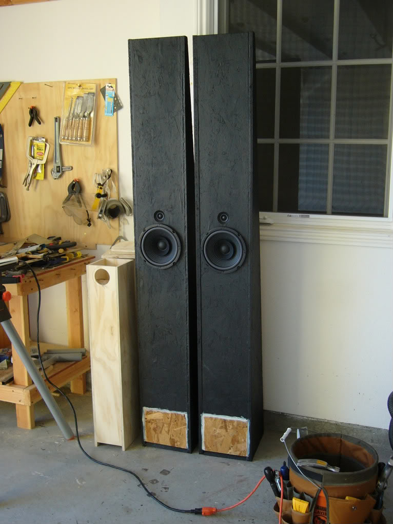

I actually tried sometime ago, but apparently it didn't turn out well in the "standard" size, especially vent was really off and I used OSB (not ideal as the cabinet. Even with tweeter (which work well with B20). I ended up tearing up the cabinet.
I think it would work well in proper dimension, but I am not the scientific guy to figure it out.

probably just need 50% more internal cabinet volume for BOFU. it seems that BOFU needs about 2-4 ft3 volume.
how did it sound with vent sealed?
