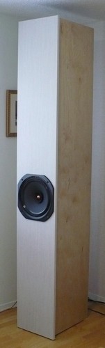

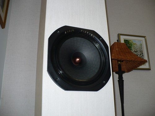

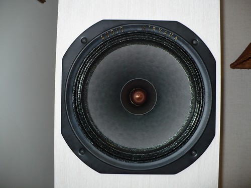

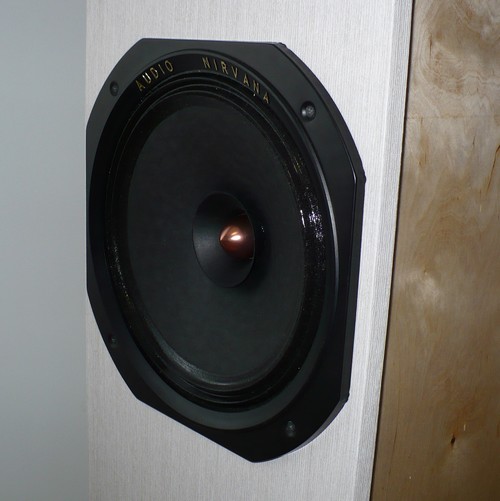

No BSC as of yet. And they deviate quite a bit from GM's design - the cross sectional area is 25 in^2 instead of the specified 30 in^2. I have them right up against the wall, so I think that is removing the need for BSC right now - though when I pull them out into the room, they definitely thin out. However, I have a 5 year old and a 3 year old running around, so they will remain at the wall for the near future.
Di-pole front horns
Design originated here: http://timeandtubes.blogspot.com/
I built them this past weekend.
I used a Fostex 126E and run them without a crossover. Subs come in around 150hz and are connected to pre-outs. They are a di-pole design, so nothing is behind the driver. They sound very good.

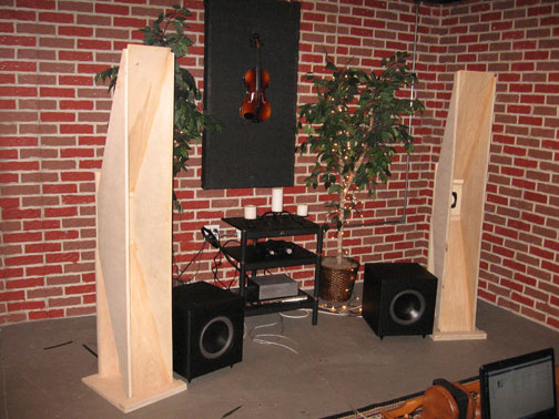

Hello all!
I just started on this site so... forgive me my clumsyness.
I drew up the Conical Open Dipole Horns a long time ago...
I'll try to get a PDF attached so you can see the dimensions.
The re-design I did for cervelorider allows any full range speaker up to 170mm.
That would be a FE166E for example.
I use them with a FE103.
The need a little support at the bottom, I use a Clipsch Eckhorn at a very low level...
All run of a 1.5W amp..
