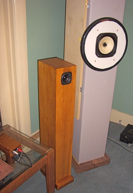

Here's what I've built since I found this forum a few months ago.
The Spotted Gum box hides a Sureelectronics 2*15w amp.
The FRS8 Needles are chipboard with 2mm Aroco veneers French Polished.
FE166E BIBS are 18mm Hoop Pine exterior ply painted with water based house paint (big mistake).
Currently building TABQAs for TB W3-871S.
A modified Trends and Fubar II USB DAC make up the rest of my low-fi set up.
I appreciate the help of those who took the time to answer my noob questions... usually by pointing out the obvious.

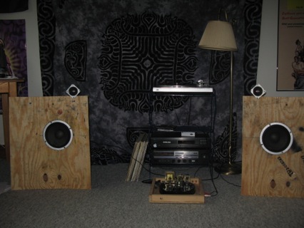

These are some OB's I whipped up last night. I was just browsing the photo gallery and got inspired. The drivers are from some old pannasonic BR's. The sound was very much improved and much more spacious. I need to make them look nice though, because they are made of the plywood that I used to solder over!

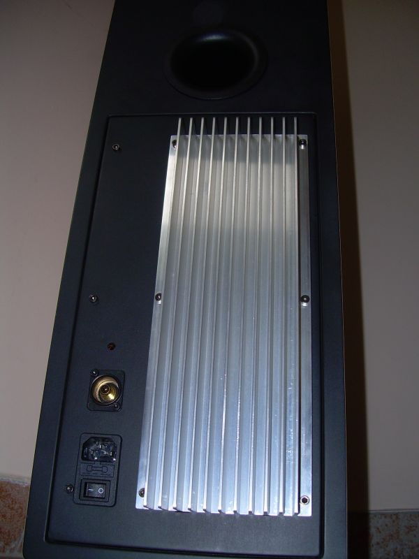

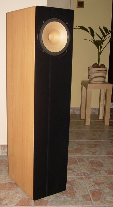

Here is my last project. SONIDO 8" fullrange speaker in a 40 litre vented box. This is an amplified (active) speaker box. The amp is a JLH 10 watts A class type.
The speaker model: SONIDO SWR-200.
The SONIDO is a small hungarian manufacturer and make very good fullrange drivers.
