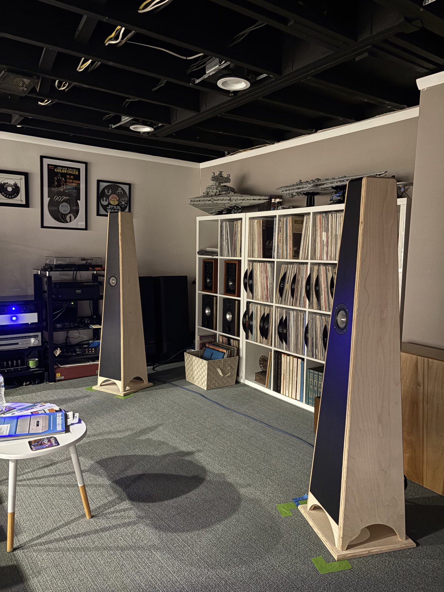

I've used plastic and lead prior in experiments. My FH3s are pretty dead with 15mm Baltic birch but do still shimmy a skosh more than my other horns. Such mods are over on these cabinets at this point though ~ they are sealed up and while I'll mod some stuffing, I can't lay in much more lining. I might try thicker material (that's accessible) behind the driver. Work for when I do the bass trap/room placement experiment you recommend. Your curve is tight... maybe I'm just less discriminating (ref: "wild"). 🙂

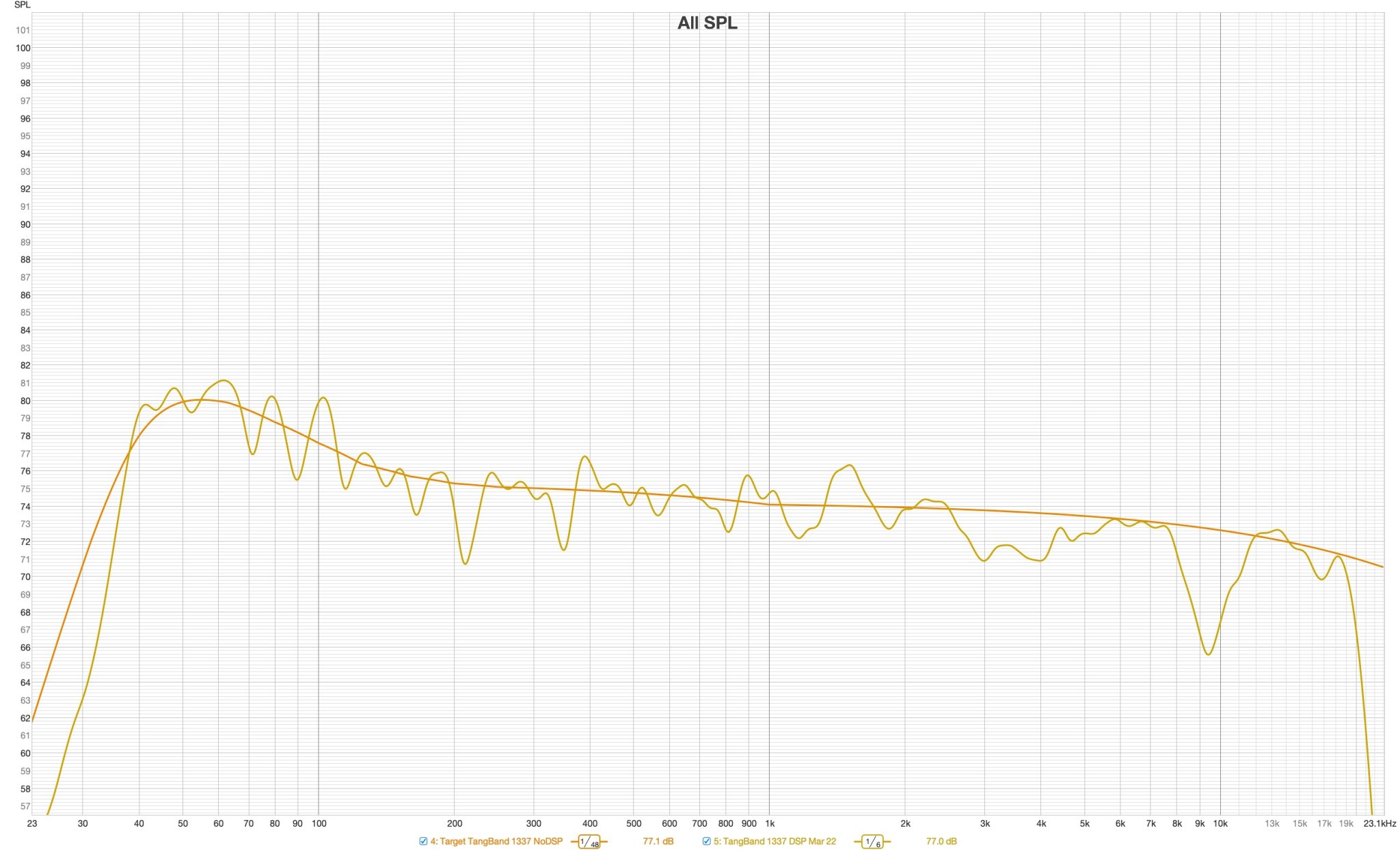

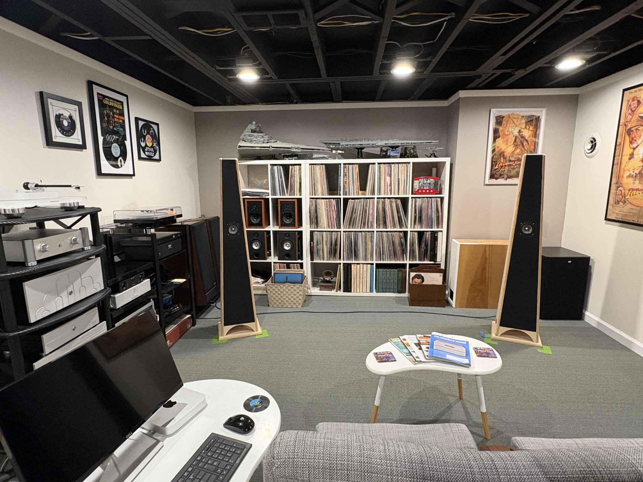

the horn cabinet technology is delivering. 200 Hz area fluctuations are probably the wall reflections, could you pull them from the wall and throw some pillows in the corners, just for sake of measurement? I think you can dramatically improve everything under 500 Hz just with hand waving.
But the rest of the curve above 500 Hz looks too wild
Yeah... horns are the shizzle. I EQed the walls out with DSP before moving the boxes... but will so do. Too, for the "wild" curve, the MAP7s are smoother, but even here with the TB1337s (except for the weird 9.5K drop) they're cool IMO. I can smooth them further with DSP but was bored with that ~ I lost dynamics; I leave further acoustic variations to a swap back to Mark Audio and addition of damping material behind the driver. Are you baiting me? "Wild" ~ seems decent for 5m from $100 horns driven by a 4w amp unadulterated... this kit rocks.

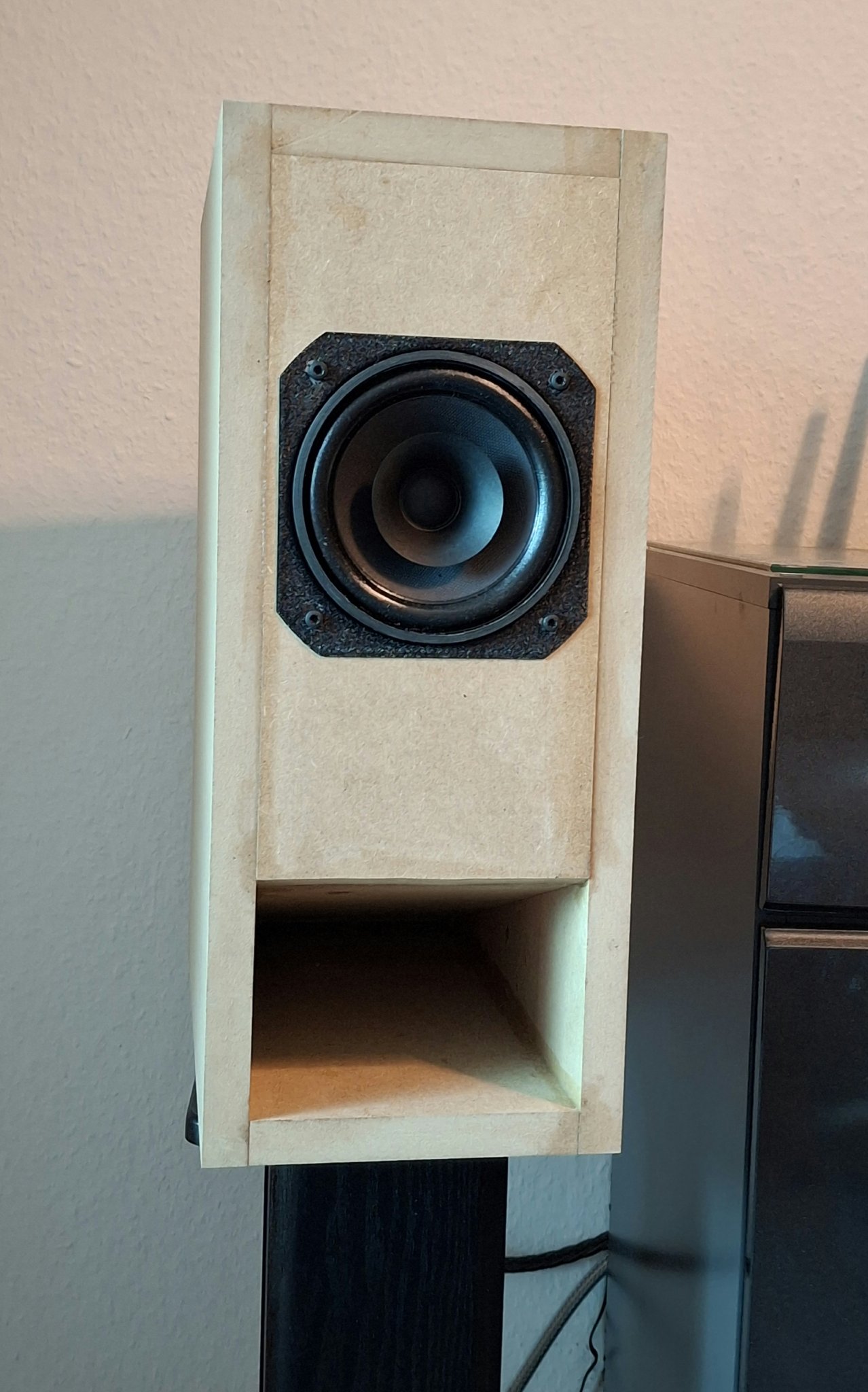

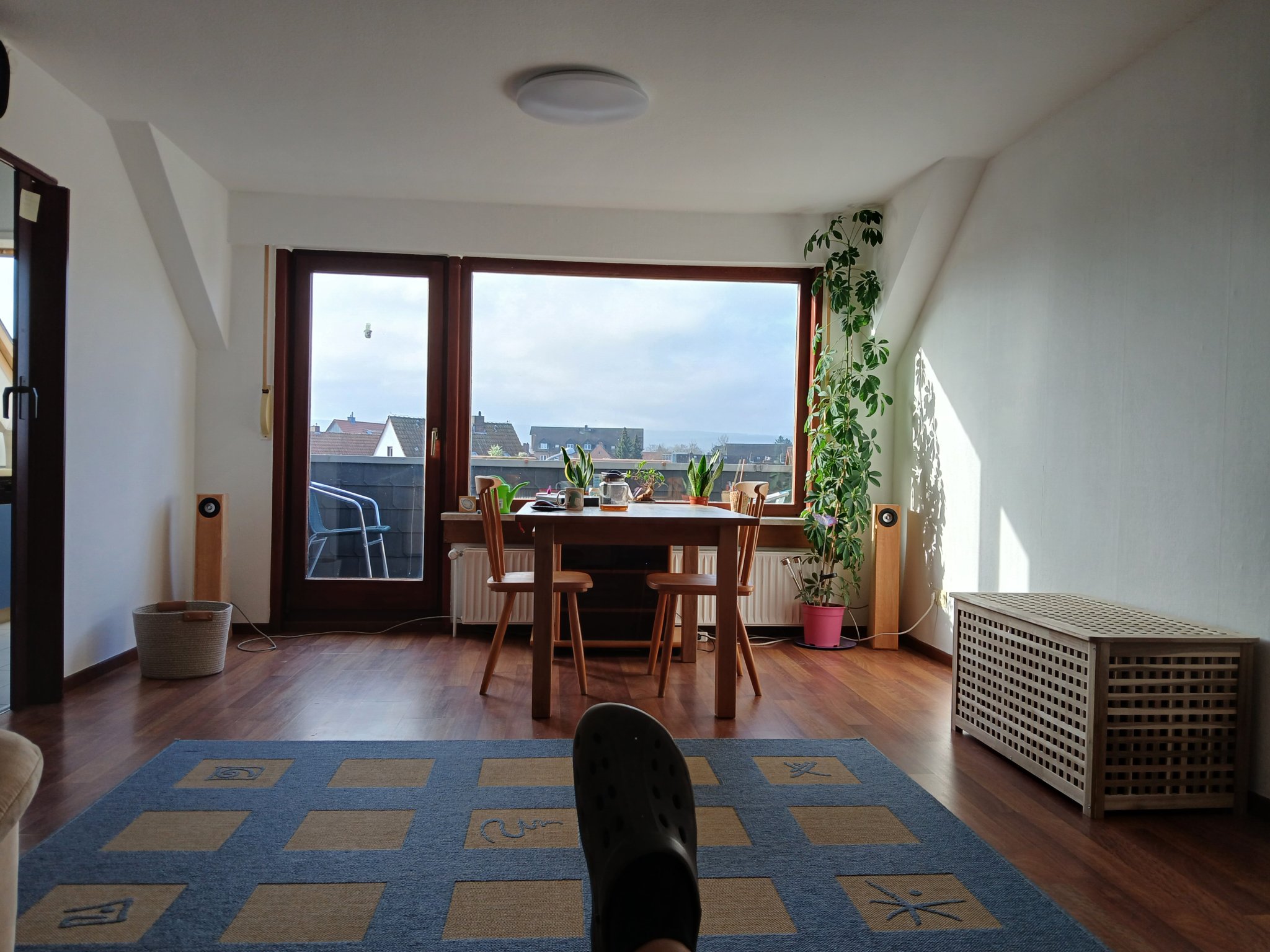

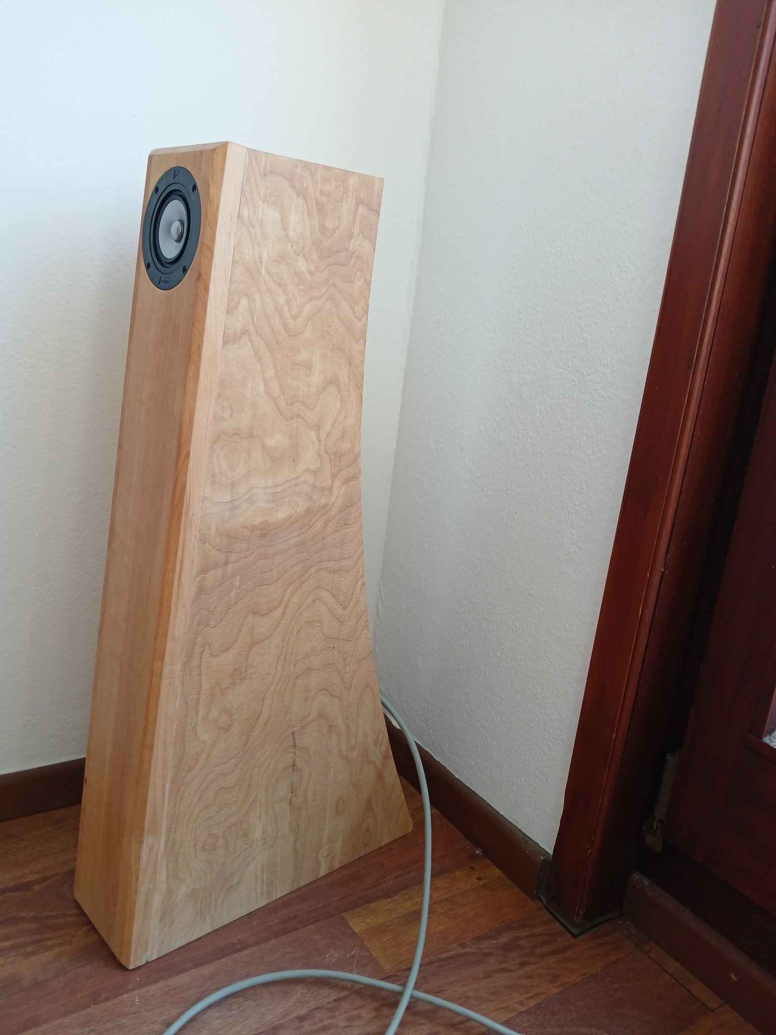

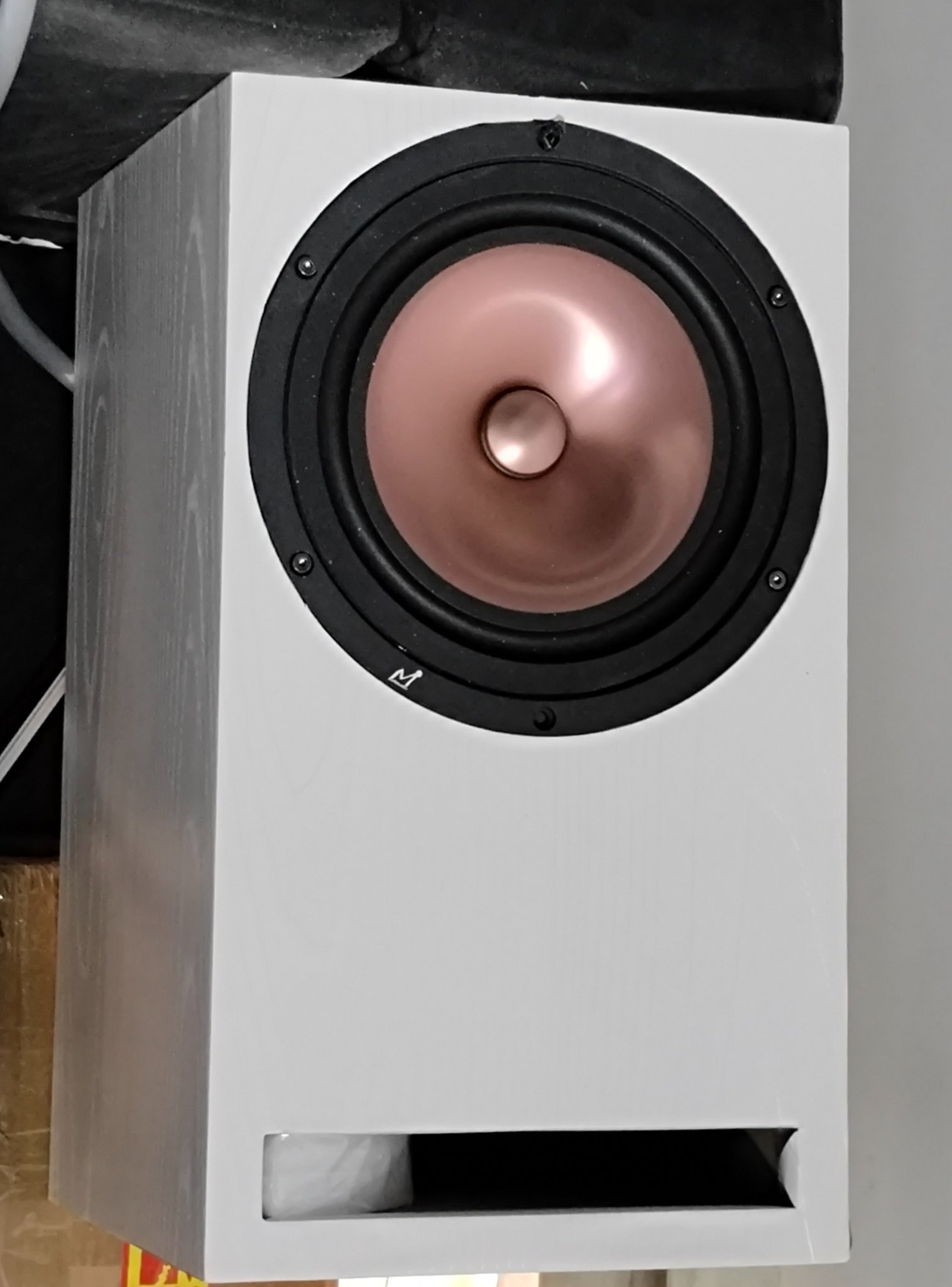

Mark Audio MA-200 in 17L 1.5m TLonken with "strait" port following Elac and AIRS (a Chinese brand) whereby a circular-curved strait constricts then expands the slot port. Toed-in near the corners of a 3.5m-wide room, at the rather small sweet-spot, clean even response ~40hz to 12khz with both ends modestly rolled-off but still playing the right notes nicely (i.e. acoustic instruments covered full-range). Exceptional for a whizzer-less 8" run straight-through without filter/EQ. AlMg cone not as dynamic/articulate as paper cone especially playing low-volume at night (then loudness compensation a must). Not fully run-in yet, marginal A/A/A -3 demerit score.
The TLonken cab used is very close to my Supravox, with a 3cm slot constricted by 1/3 vs 2cm. Quarterwave resonance ~45hz useable to ~40hz (as heard). OCC interconnect & speakerwire.

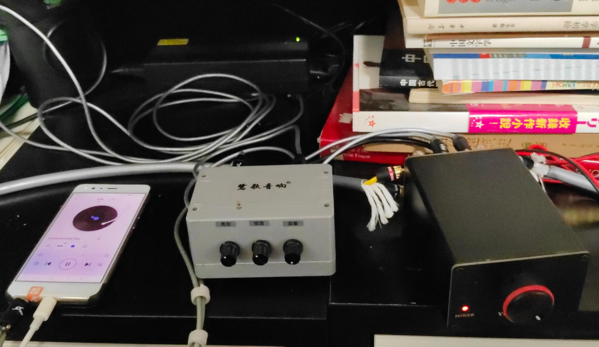

addenum: I hooked in a Sharp GF-777 (clone) passive loudness-tone-control which attenuated all but the frequency extremes, degree depending on attenuator volume setting. I have its low-end knob, high-end knob, integrated amp (TPA3221 BTL), and smartphone source (Huawei P10plus streaming WAV) initially all set to max; then lower the source a bit & raise the attenuator volume to find the best frequency response for the volume I desire. Overall a bit more natural and relaxed sounding, at a cost of (maybe) a little bit of coherence and immediacy. Perfect accessory for fullrange speakers.
Shown: heavy-duty power brick; amp; smartphone; loudness-compensator/frequency-extremes tone-control.
Circuit here:

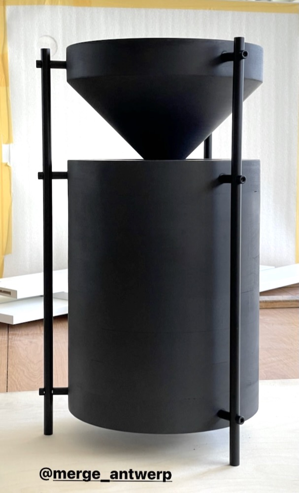

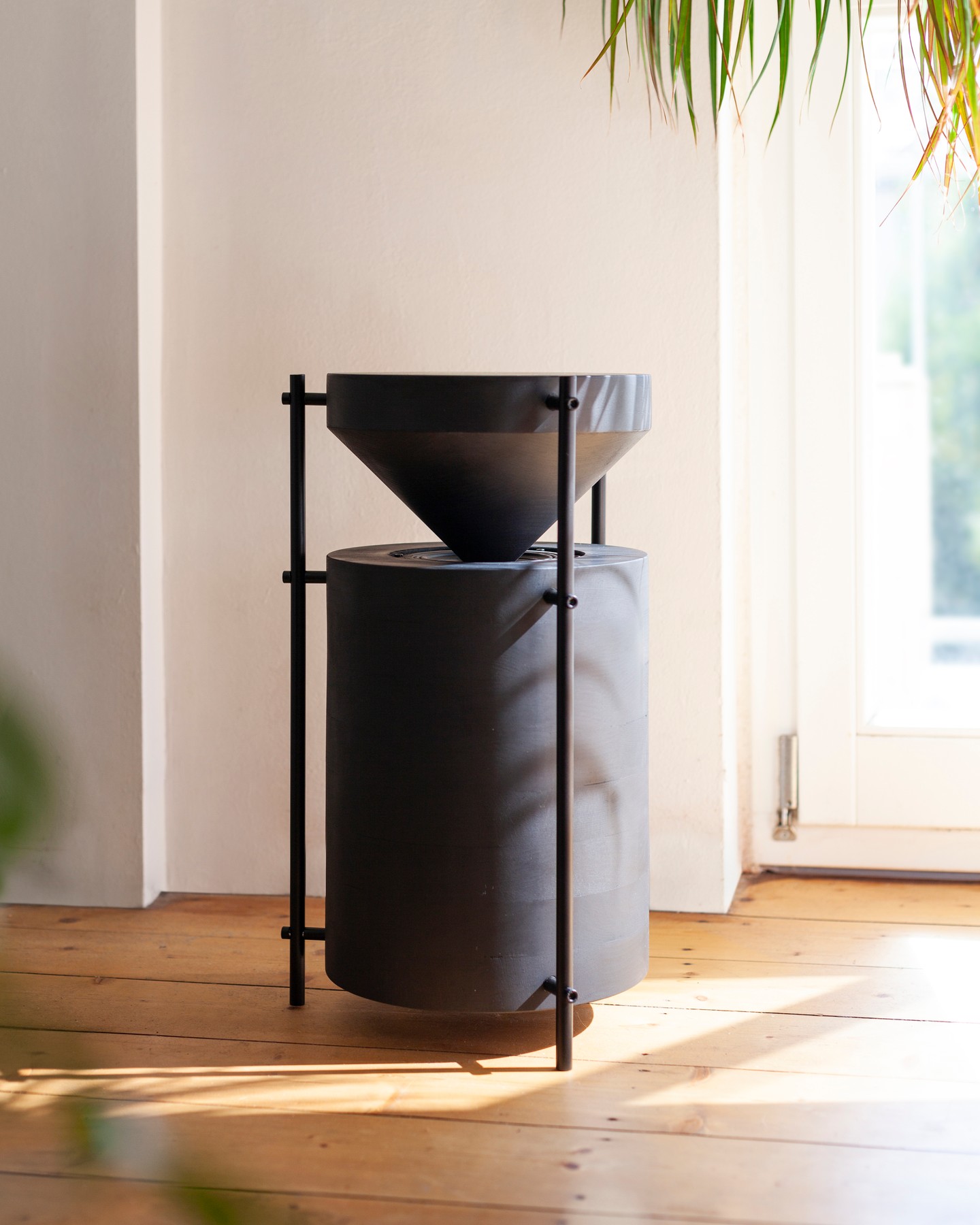

This is awesome @alsyd I was actually looking at a similar speaker from New Fidelity over the weekend thinking, maybe I could make something similar and you have already done it!
Interesting! I found another photo - it's bigger than I thought:
Of particular interest is the positioning and width of the cone (same diameter as the the enclosure, probably done for aesthetics though). I took a total guess for cone width and height above the driver for my design. I could print some variations to test having the cone closer to the driver or larger widths.
Perhaps a big version with an MA200 is in order!!!
Maybe in the region of 25L, being similar to the Pi-Align vented box standmount. Some quick calcs to get to 25L = internal measurements of 270mm for width, 435mm for height. Could use an 8" DS215-PR passive radiator. I used 6 1/2" DS175-PR which matched the P11 nicely.
My P11 design is ~7L from memory; the P11 doesn’t need much volume.

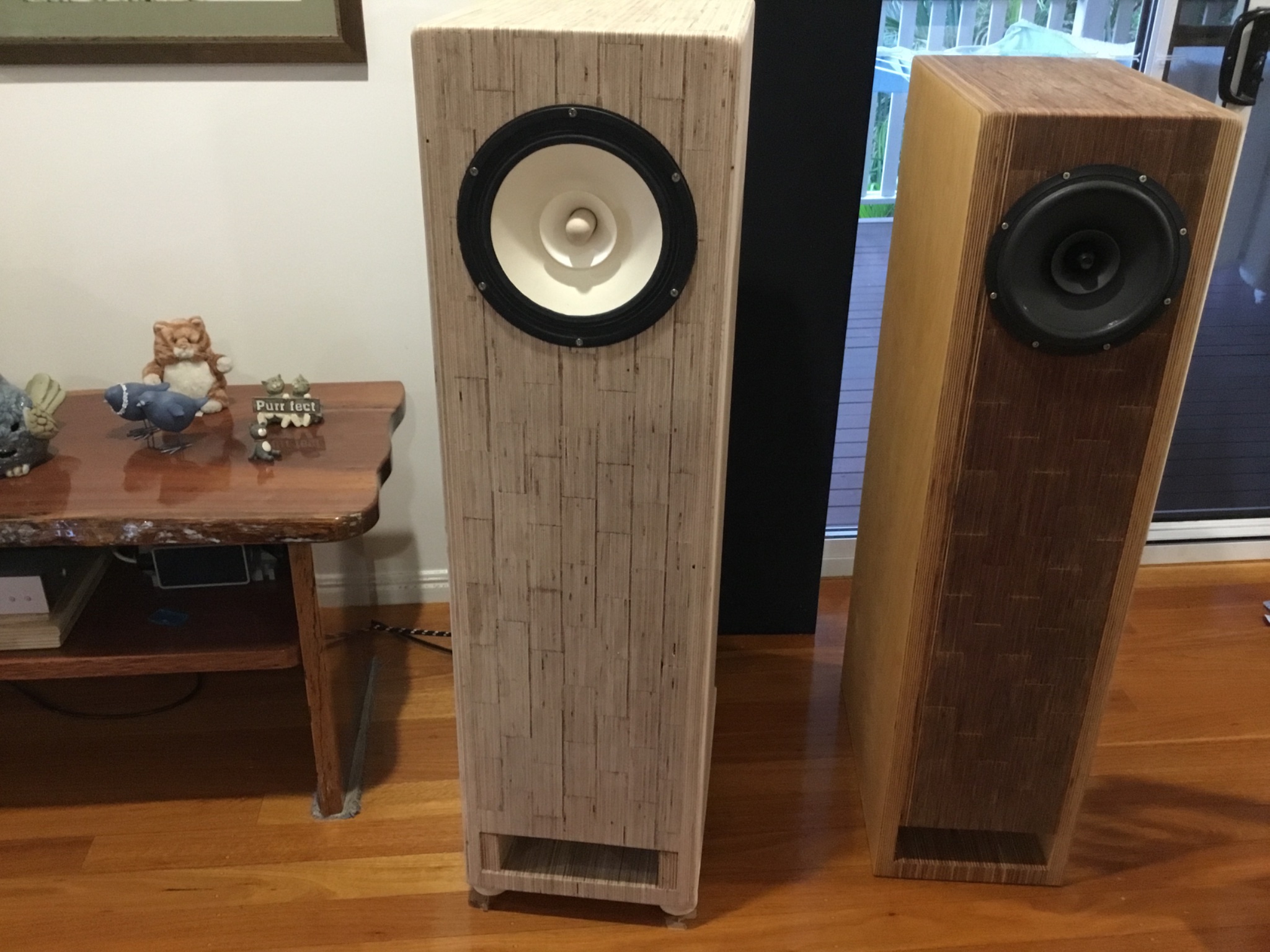

@ Soundwavesteve, I love ❤️ that purple colour in one of the photos… I have wanted to make a straight pipe, but I have Fear of the wife!!!

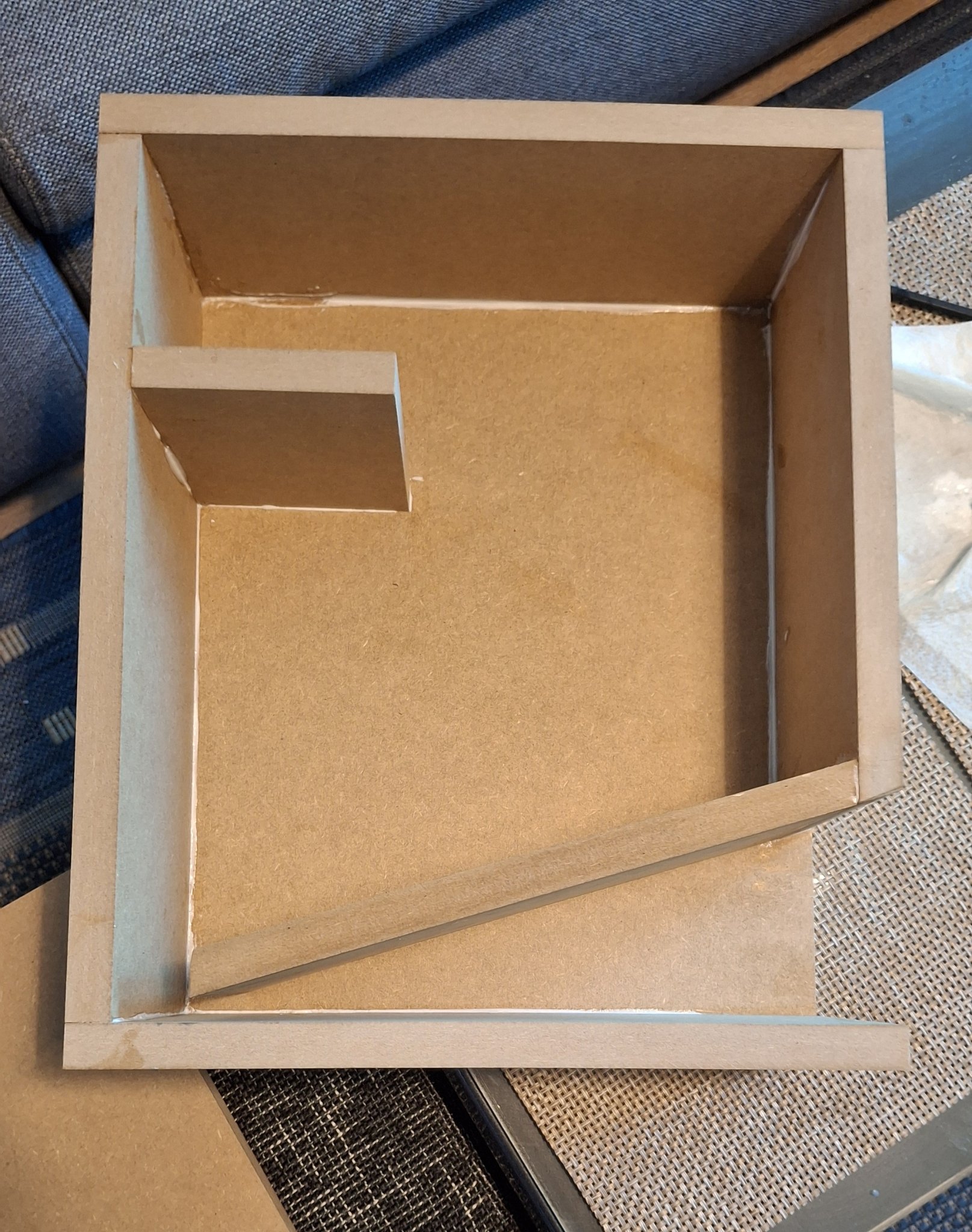

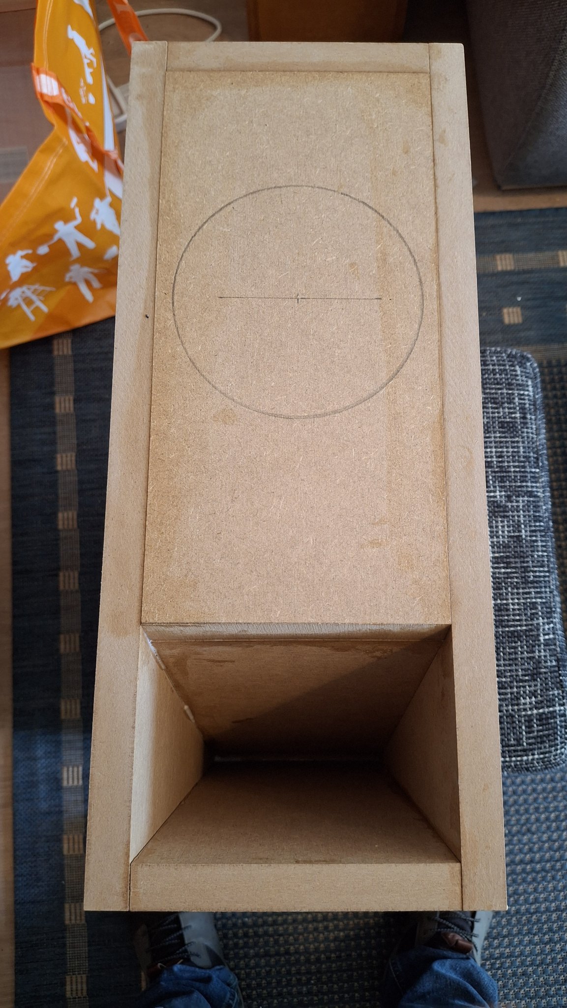

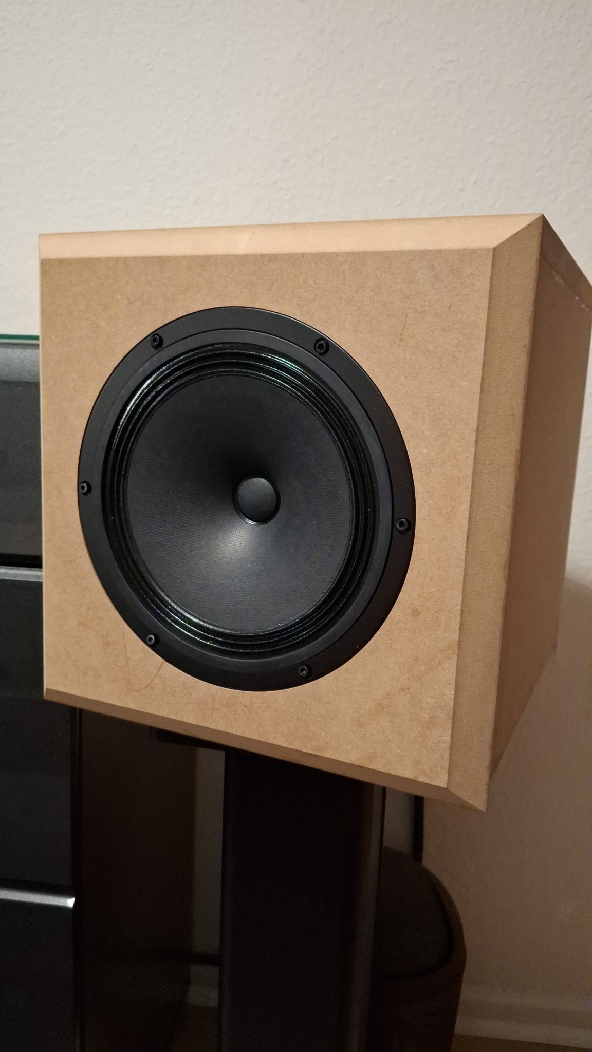

My latest 2 projects, The latest with the Sonido Field Coil driver ( white) is still in raw timber… still trying to decide on the right finish… my feeling is that oil sounds nicer than varnish….. The other one is finishing in Boiled Linseed Oil..

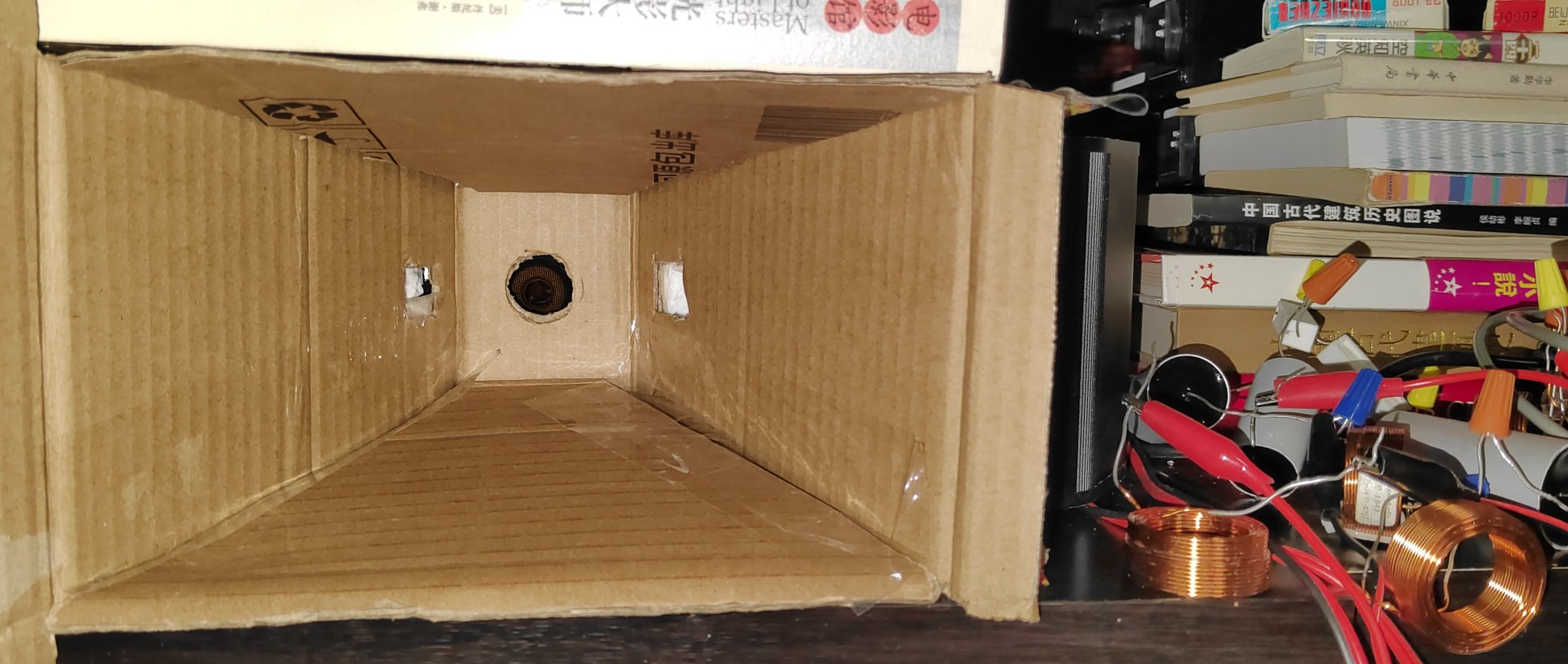

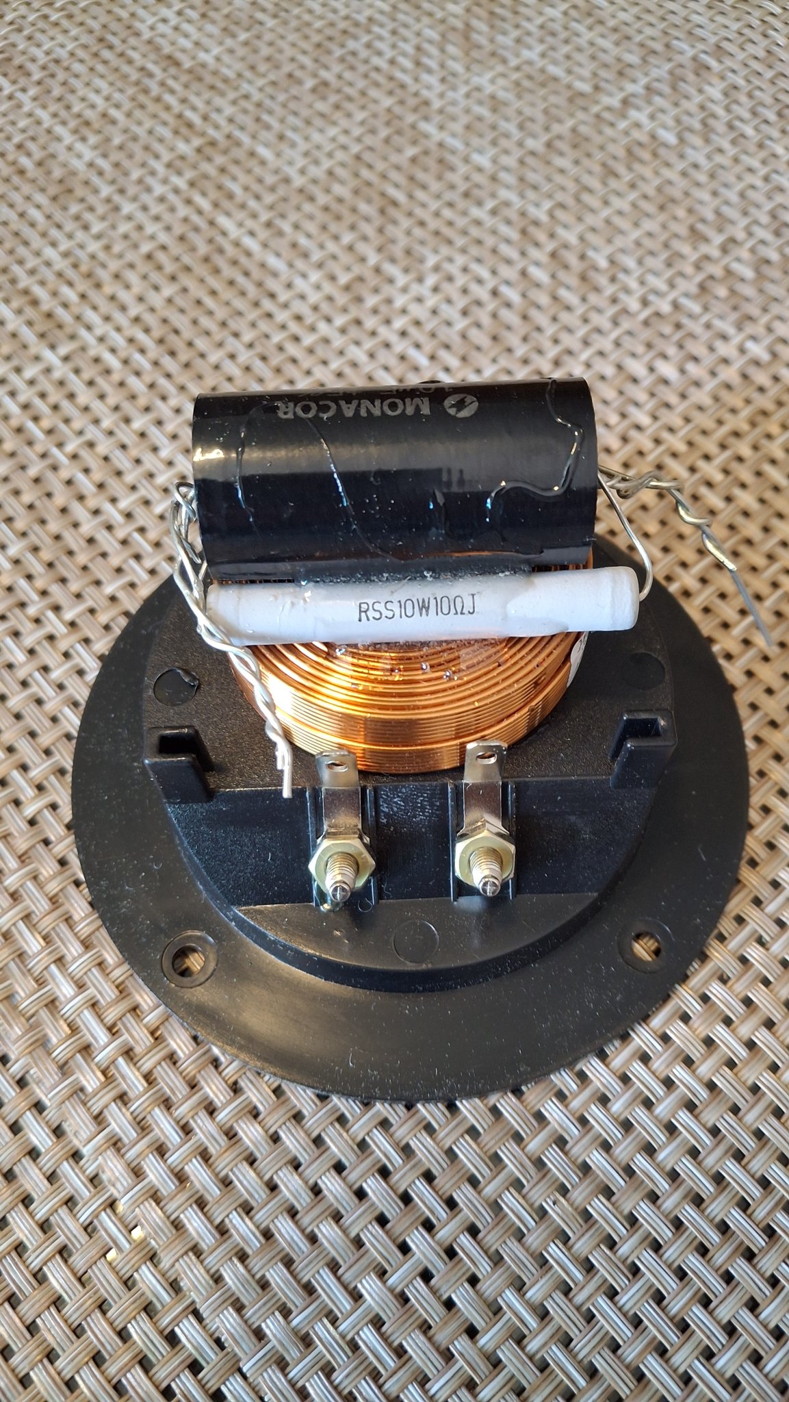

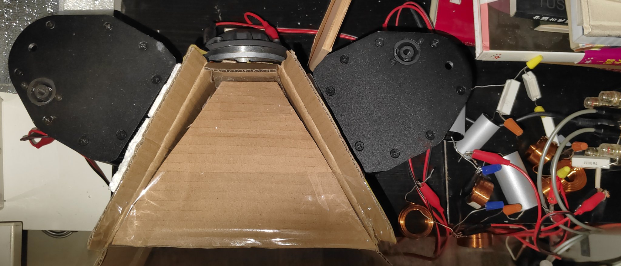

For some time now I've wanted to compare my reflector-coaxial PrimeRadiant against another quasi-coherent-point-source 2-way, the Multi-Entry-Horn. I can't really do the MEH justice, but here's a Minimalist MEH (Minmei) experiment done over three sessions, listening and tweaking the passive filters to tame back flat the horn-bloat FR -- a rather fool-hardy challenge. But it has been fun and the result extremely vivid, detailed, and dynamic -- if not "holographically deep" like my coherent speakers or a really good fullrange driver. I did more-or-less time-align the drivers but phase would have to wait (other than flattening FR by ear).
HornFaital: HF108; two Admark LDA-401 array units 4" Faital-inside (nominal 8ohm but closer to 12 around 1khz); horn mouth (cm) 22W 12H 15D, back ~6x7 with 2.5 round throat-hole, ~1.8 entry taps ~8.5 apart. Mids are separated from the horn cardboard by styrofoam so as to time-align with the CD (by ear, playing 3khz without XO) and to make them fit. The horn shape was tweaked in real-time; even 1° from optimal made an audible difference near-field 0.5m (by ear, anyway). Most of the effort was notching out horn-bloat in concert with XO, trying and chaining together insane number of L/C/R parts.
LP ~1khz 0.9mH->parallel 4" Faital/Admark (flat down to 160hz by ear, then confirmed online)
HP 12R->1.5uF/0.15mH->notch3.9uF||0.62mH->HF108
(Intended separate sub/woofer 9mH->12" Aura, this combo had been a candidate for LXmaxi)
Still a little bit of a hump 3-3.6khz, smoothly going down to meet the midrange. I tried to test/listen for the MEH 1/4WL traits (the point of this exercise); maybe I heard them... rather subtle.
edit: Inspired by @elmoodio question; first part here: https://www.diyaudio.com/community/...arts-of-a-multi-way-build.426819/post-7995014
