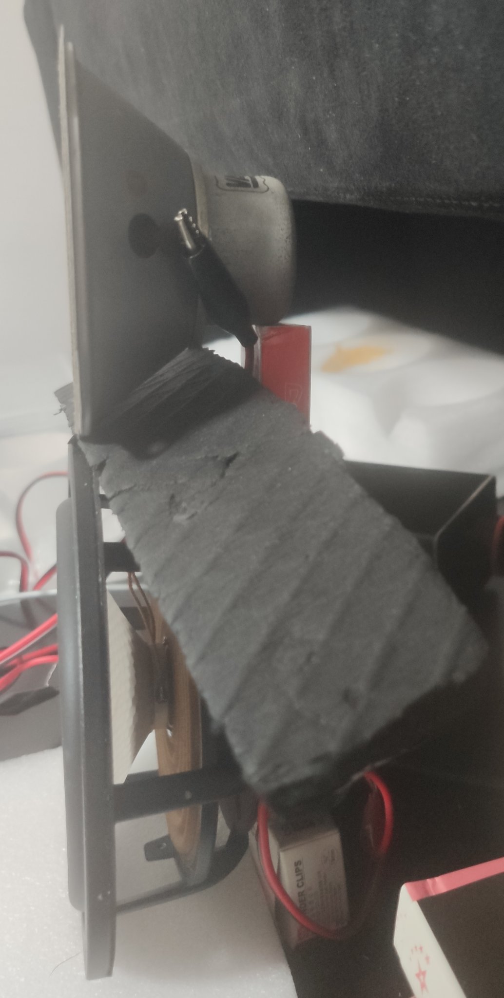

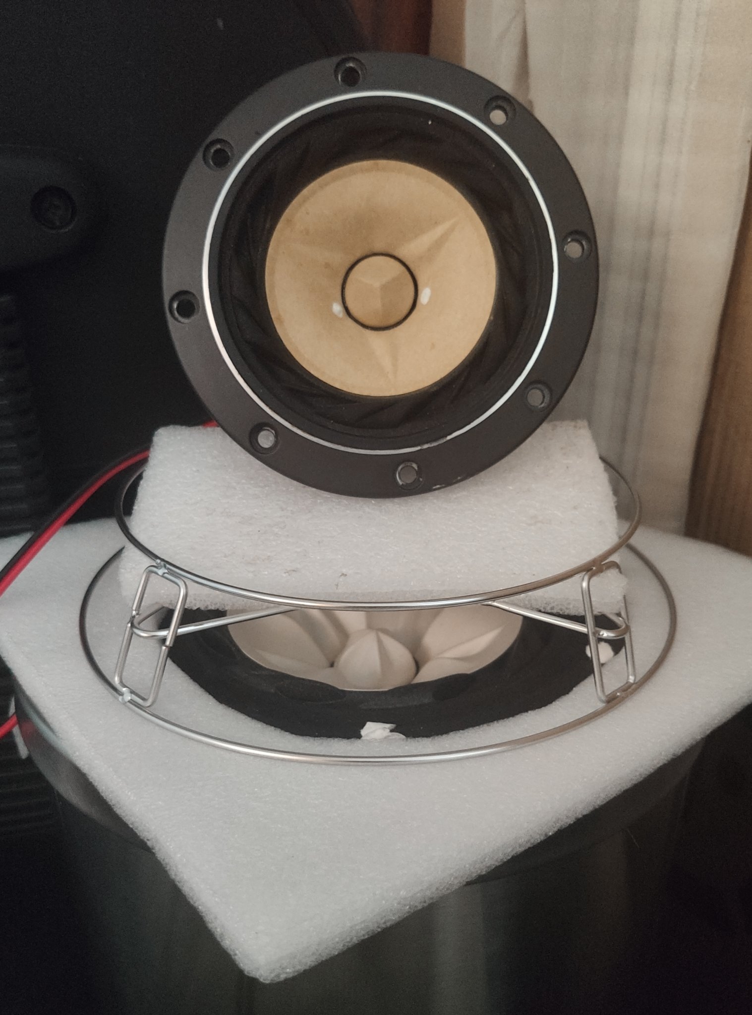

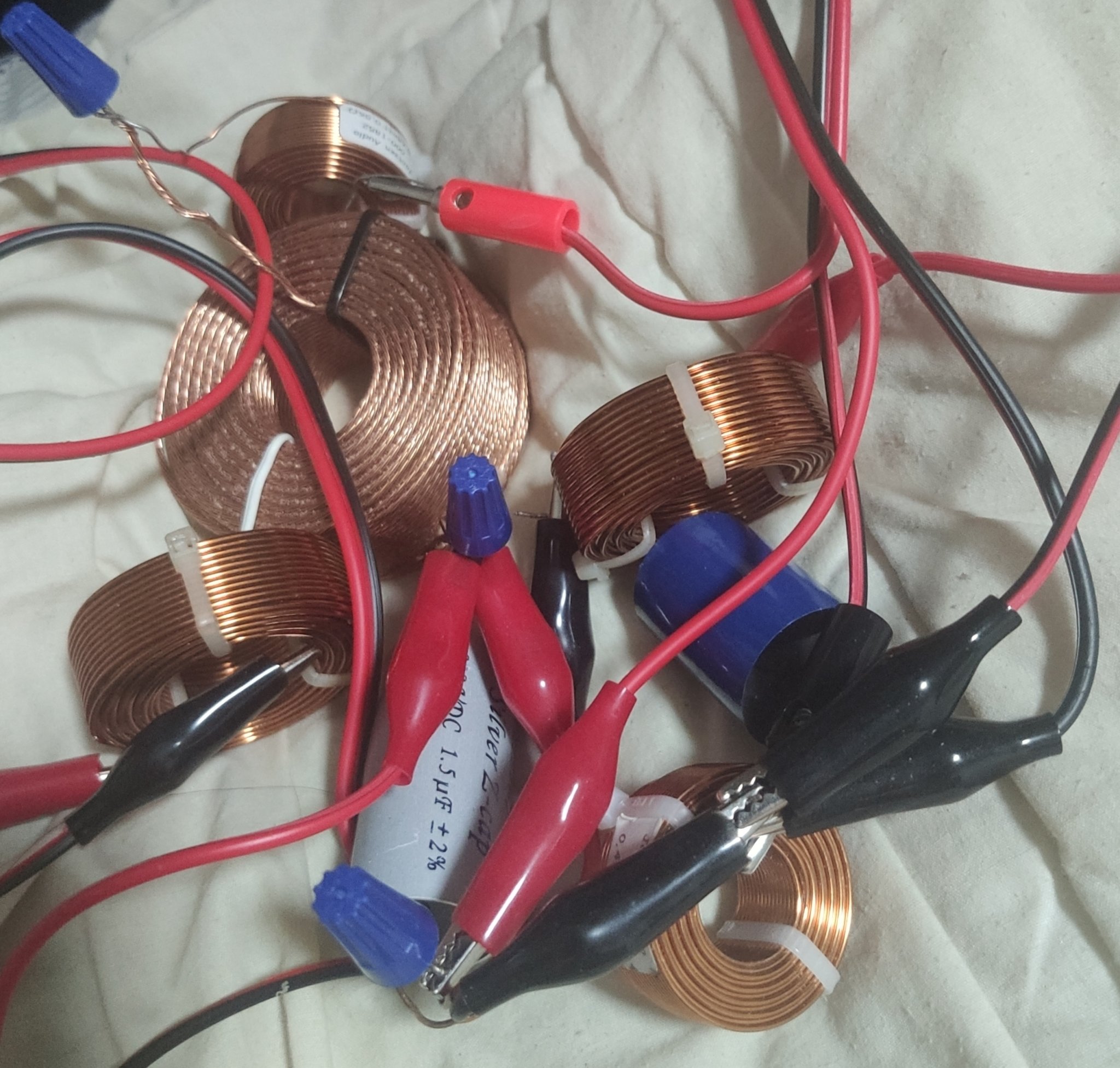

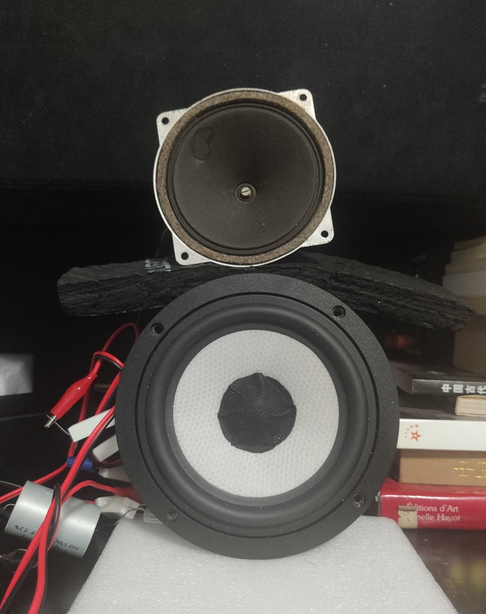

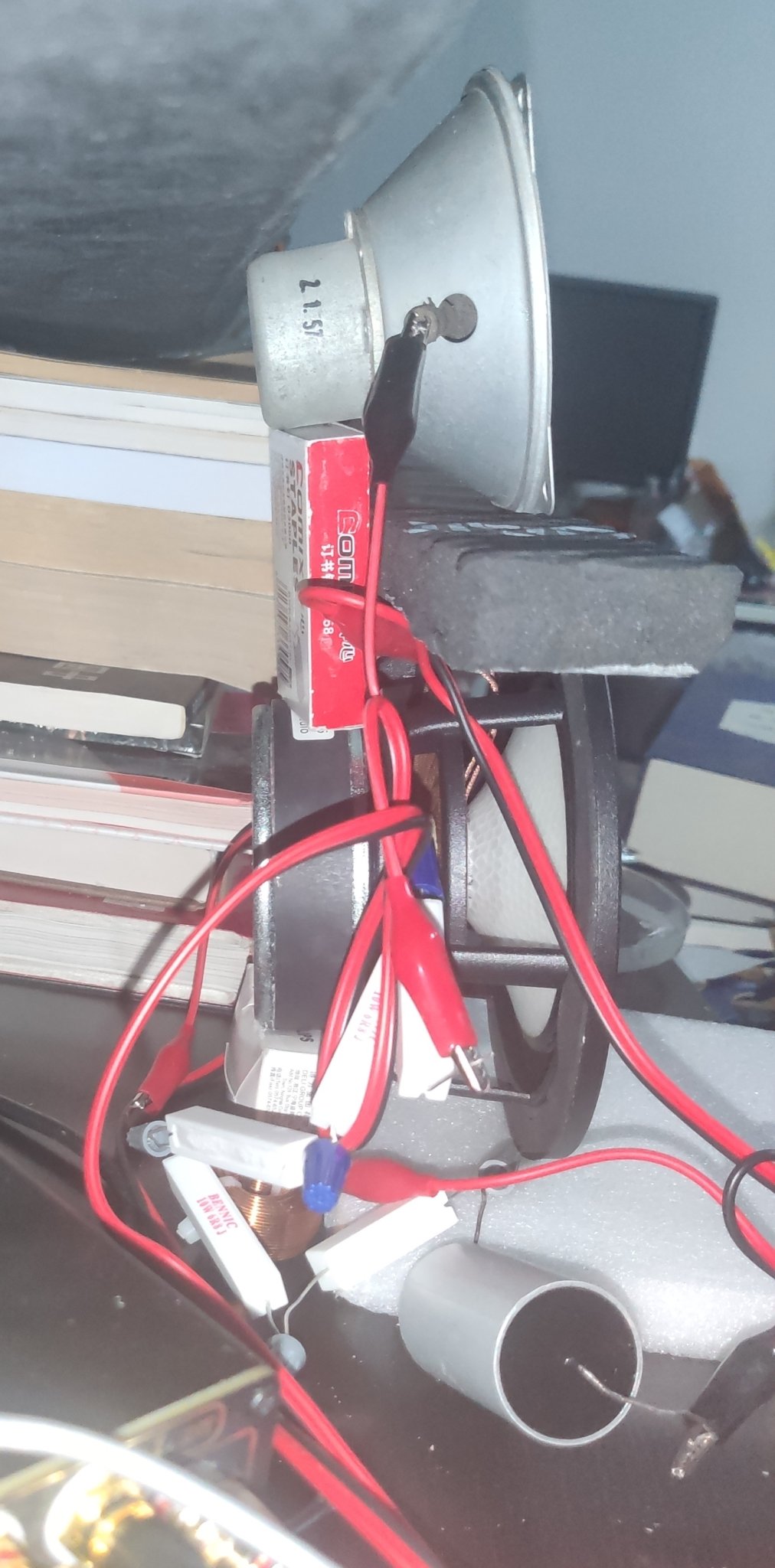

Couldn't leave well enough alone... I inserted the Eve 5.25" nude driver above the 6.5" forming a 3-way LX -- Naturelle perched precariously above; their acoustic centers all lined up. Simplified the first-order XO (0.15mH->6ohm 6.5" up-firing; 0.47mH->5.25" frontal; 23.4ohm->2.7uF->8ohm Naturelle) but only had a few spare minutes to tweak. Anyway tone-sweep sounded pretty flat. If I had any sense this ought to be the end of diy.... Quite shocking how much more of musicians' intent and performance nuance came through.
Update: added plast-tape to the 5.25" Eve Audio honeycomb's soft dustcap, somewhat taming its 5.5khz breakup resonance; after 0.47mH first-order LPF only a broad, very subdued hump was left. Also made a perch for the Naturelle and confirmed 23.4ohm->2.7uF gave a flat combined treble response. Then in place of the dipole Naturelle, I decided to try a 4" paper-cone closed-back alnico Siemens, one of the better tweeters of that type and vintage. Much easier to "sit" over the Eve and their acoustic centers matched exactly when the flanges' back faces were aligned (found by ear, even 1mm made a huge difference in naturalness and monophonic depth). More relaxed sounding than the Naturelle and just on the sweet side of neutral. Spec-wise the Siemens couldn't match the dipole or even modern dome tweeters, but it was extremely clear and smooth. Interesting combination of old and (relatively) new tech. Potentially A/A+/A 2-way, A/A+/A+ 3-way LX (which cost about $300 including Jantzen aircore and SilverZ).

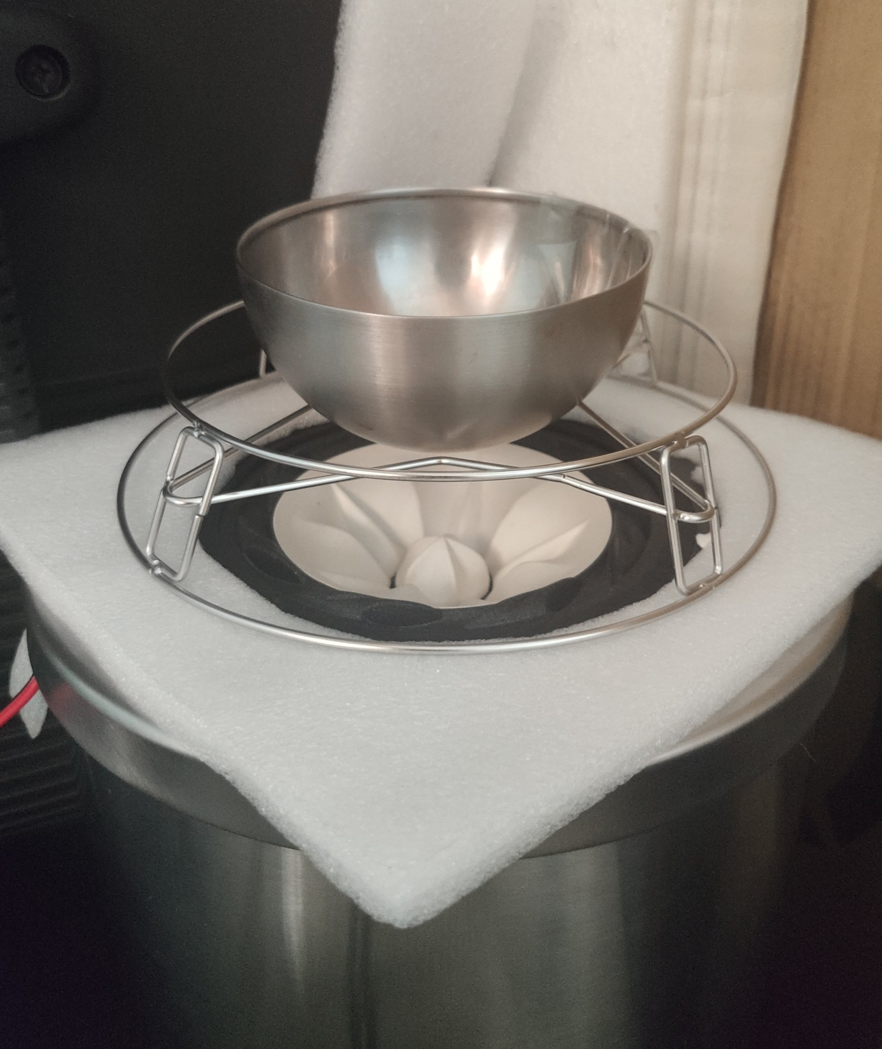

And another in the same league as micor55 and Naturelle (LX versions) -- The Eazies: Fostex FE108eΣ and alnico copy of 168eΣ (obviously original Fostex cone/surround) placed over 27L steel can. The 108 has a very steep rise 1.5-2khz that I used to shelf-filter boldly. But with the 168 up-firing and naturally attenuated approaching 2khz, this LX configuration only needed a resistor-chain (23.4ohm on-hand) to make a pretty flat response 55hz-11khz more or less. Crossover-less, seamlessly integrated, acoustic centers aligned, and very wide vertical and horizontal directivity/dispersion -- if not quite omni-directional.
Also tried without the 108 but a steel bowl deflector instead (in fact another 108's former home). Omni horizontal and pretty much vertical as well. Needs a half dome of up-tweeters I think. Then I put back the 108... musicians' favorite yeah goosebumps.

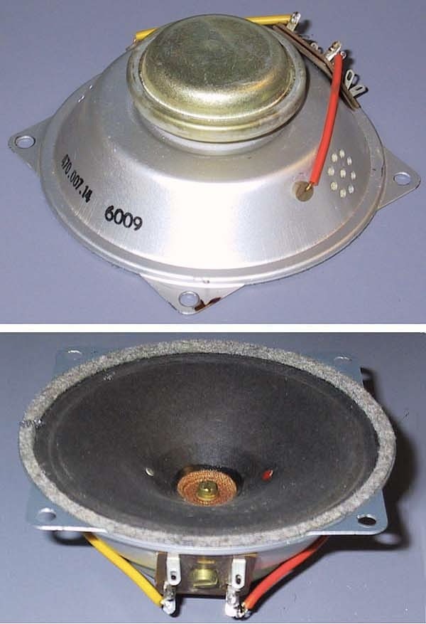

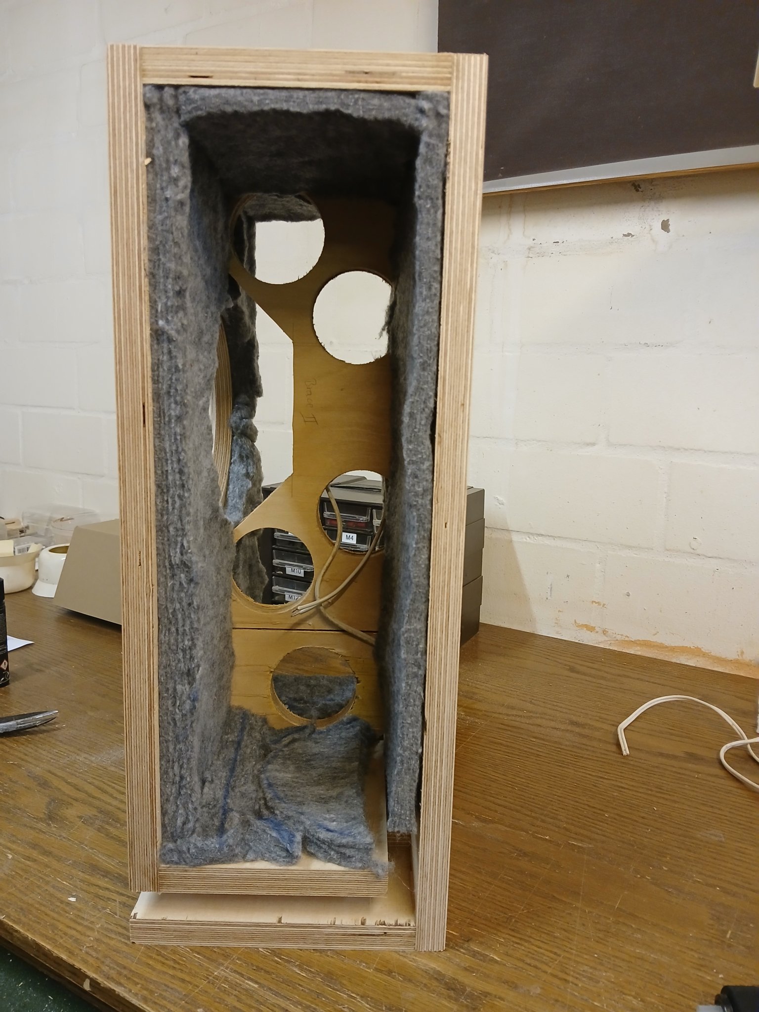

From the front i would have guessed Isophon, but the details are a bit different. Ihave run across 4 versions, larger & smaller volumes in both sealed and aperiodic varieties. These are teh small aperiodic.
dave
Cool aperiodic. Wonder if stuffing inside has powderized. I think this year there has been much less mass-import of vintage audio into China, as prices turned lower. Top English vintage audio are relatively rare and sell quickly. German and Japanese not so.

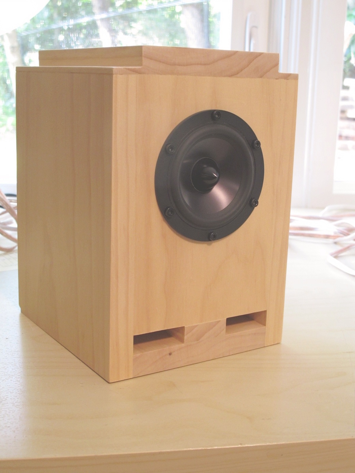

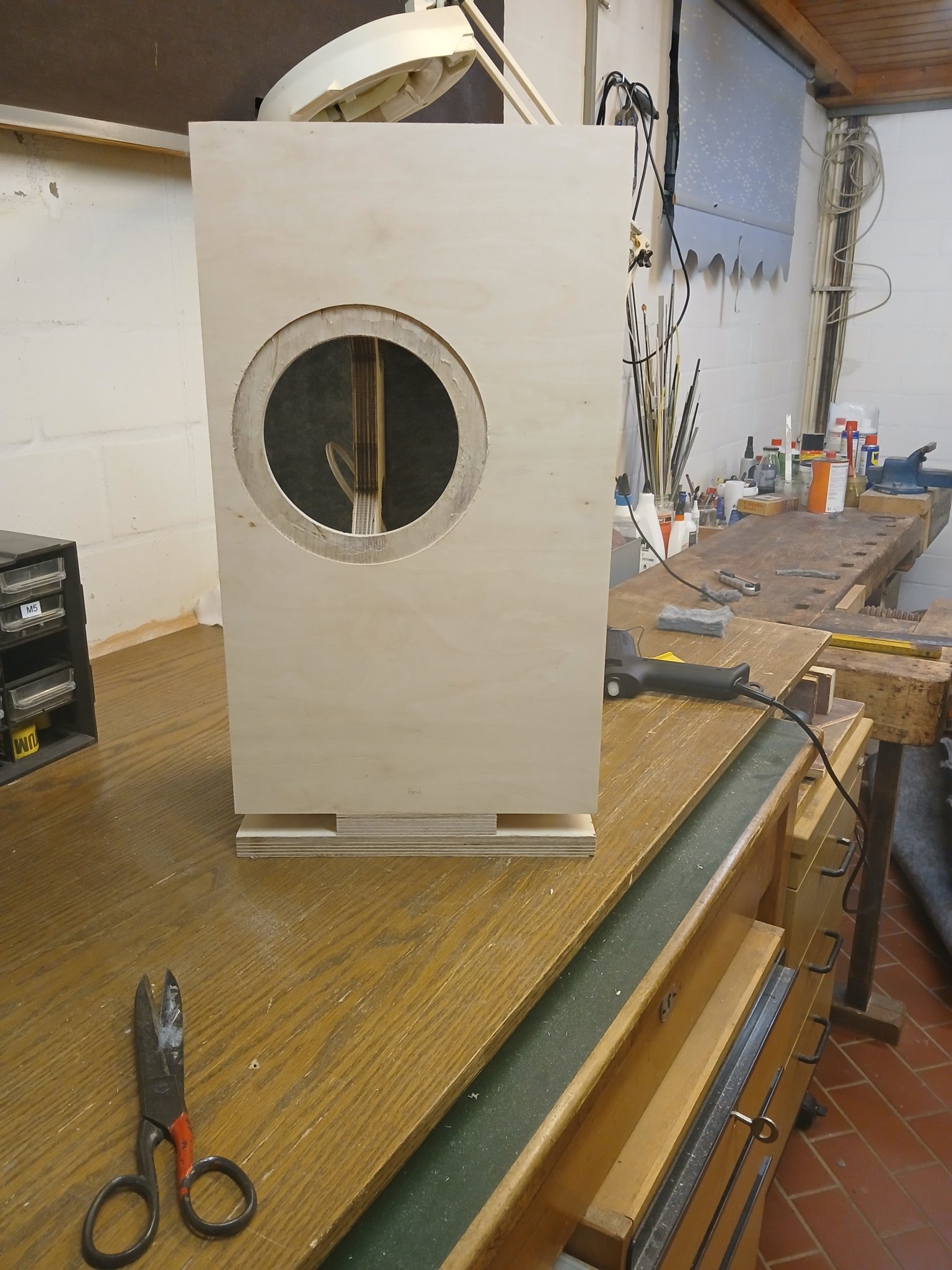

I finished my sealed egg-shaped enclosures. I'm using a pair of Tang Band W3-881SJF 3" Full Range speakers.
The high end is handled by Dayton Audio PTMini-6 Planar Tweeters, with custom cardboard waveguides.
I also have ports for the enclosures, which are designed for children's gifts at Easter, but I'm enjoying the sound of them sealed.
Is it always a good idea to port full-range enclosures?

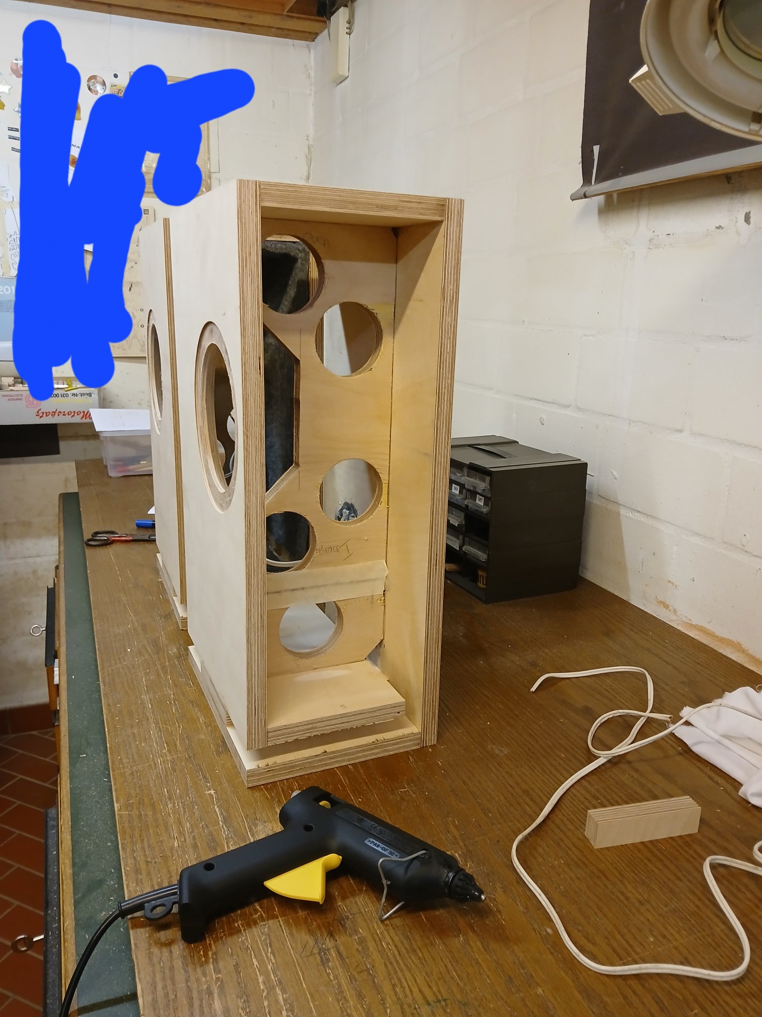

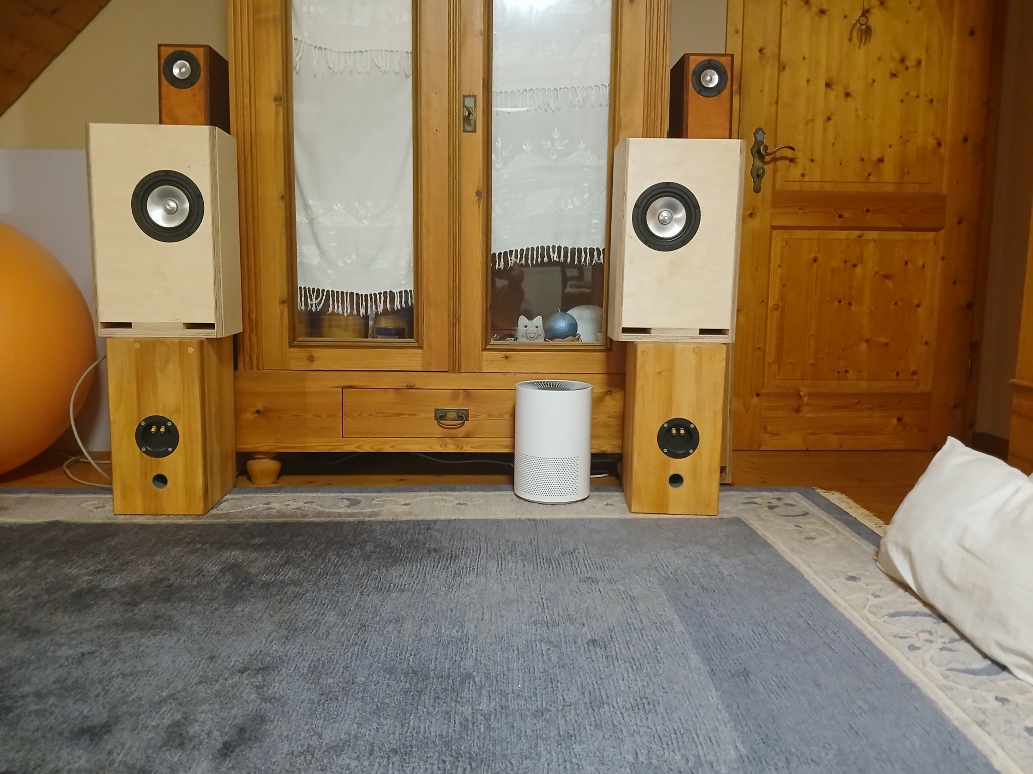

One of Daves new CGR for the CHN110. Ist the midsized one.
The boxes acting as stands are small reflexes for CHP90 from Scott. :^
Bass from the CGRs is full and refined. I have a problematic room and the CGRs with its resistive vent do fit good better then the small reflexes.
Iam still in the first 10hours of playing and starting low, but from the first go they sound unobstrusively to me. I like that a lot.

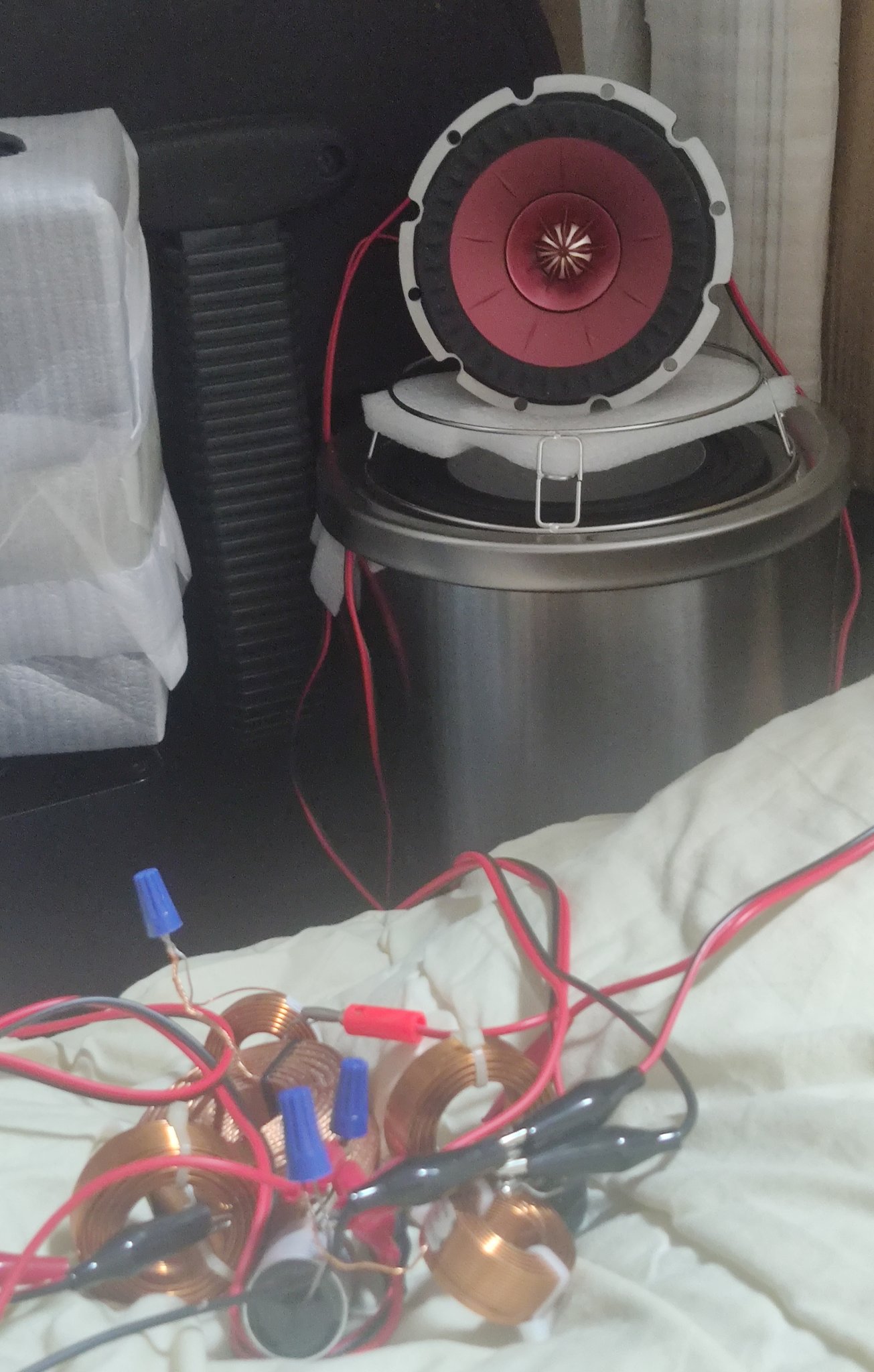

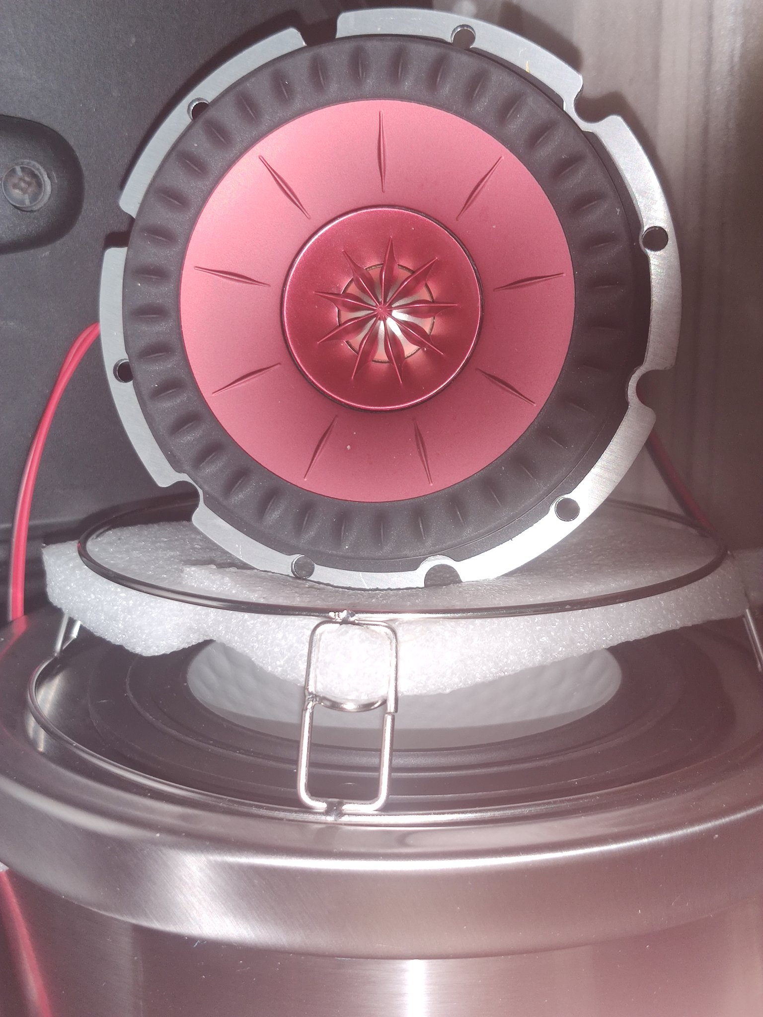

Continuing my LX series: "Metals" KEF LS50 Meta AlMg-cone/Al-tweeter coax over Monitor Audio 7" dimpled AlMg woofer over 27L closed steel can. Not fullrange driver obviously, in fact ~2.5-way (1st/3rd/~2nd-order XO ~450hz/2700hz), but still relatively simple due to "LX" (OB and off-axis natural fall-offs). Frequency response is flat enough. Coax part described earlier in multi-way forum:

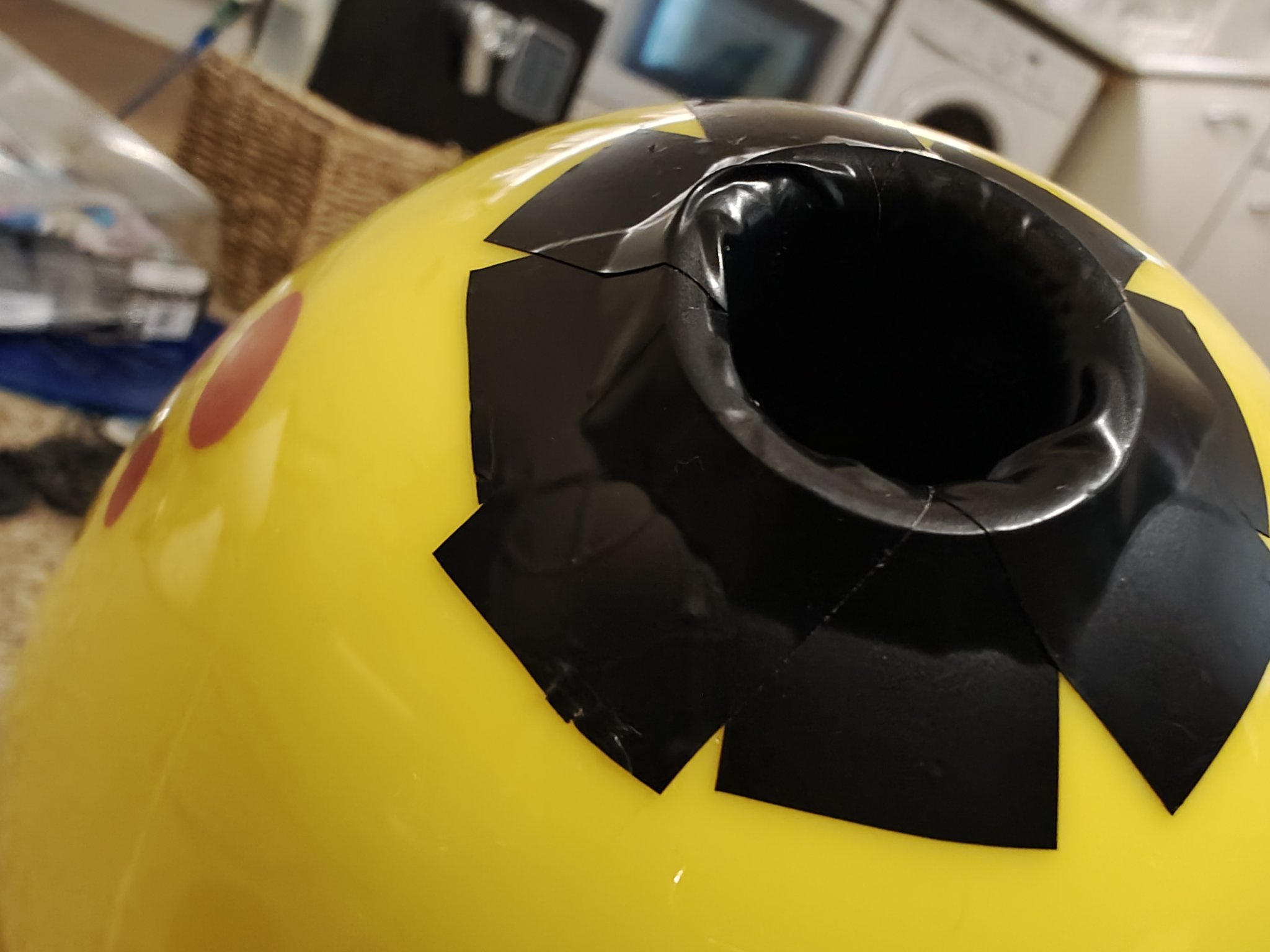

I noticed some standing waves in the voice range frequency. I didn't think that would happen in an egg-shaped enclosures, with no parallel walls, but my ears pick them up. So I installed ports. Seems to have solved the problem.
