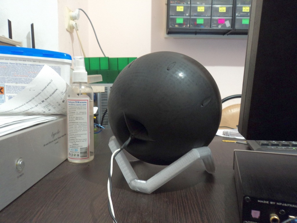

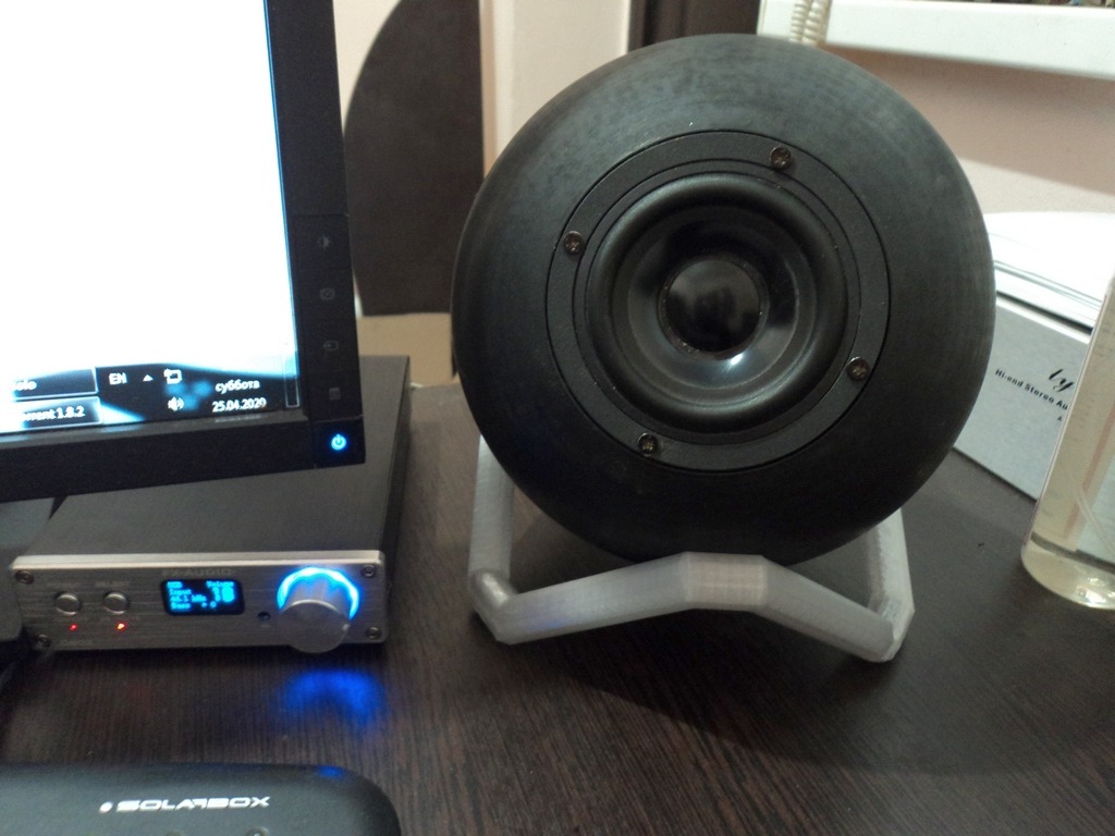

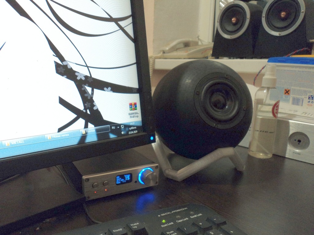

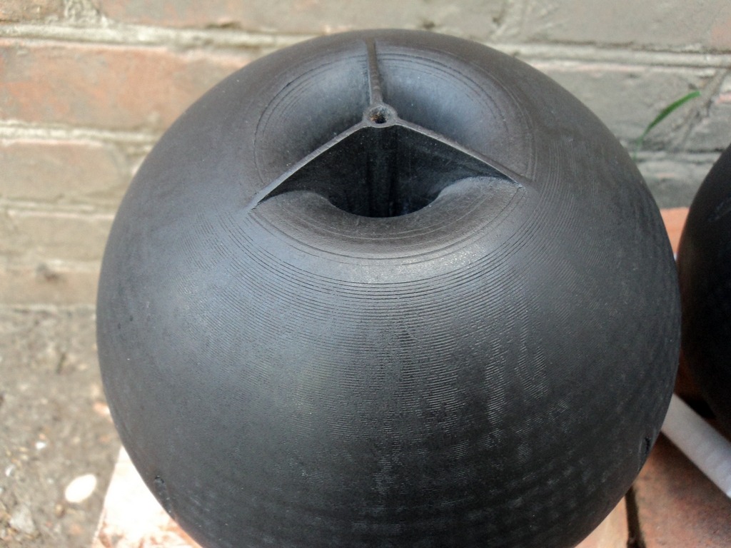

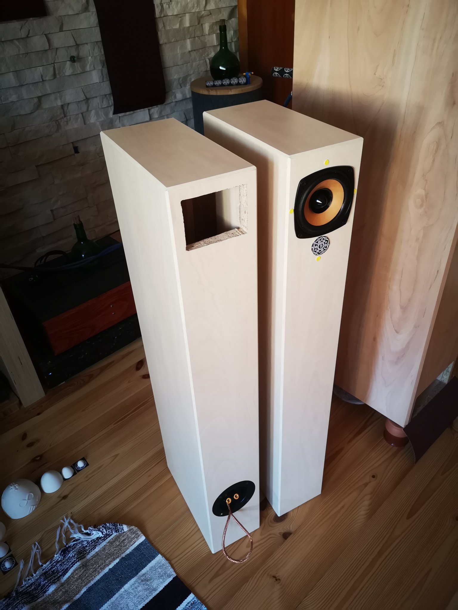

My 3D-printed loudspeaker, on Fountek FR89EX
Very nice, did you correct the frequency response with some EQ?
Or does it work from scratch?

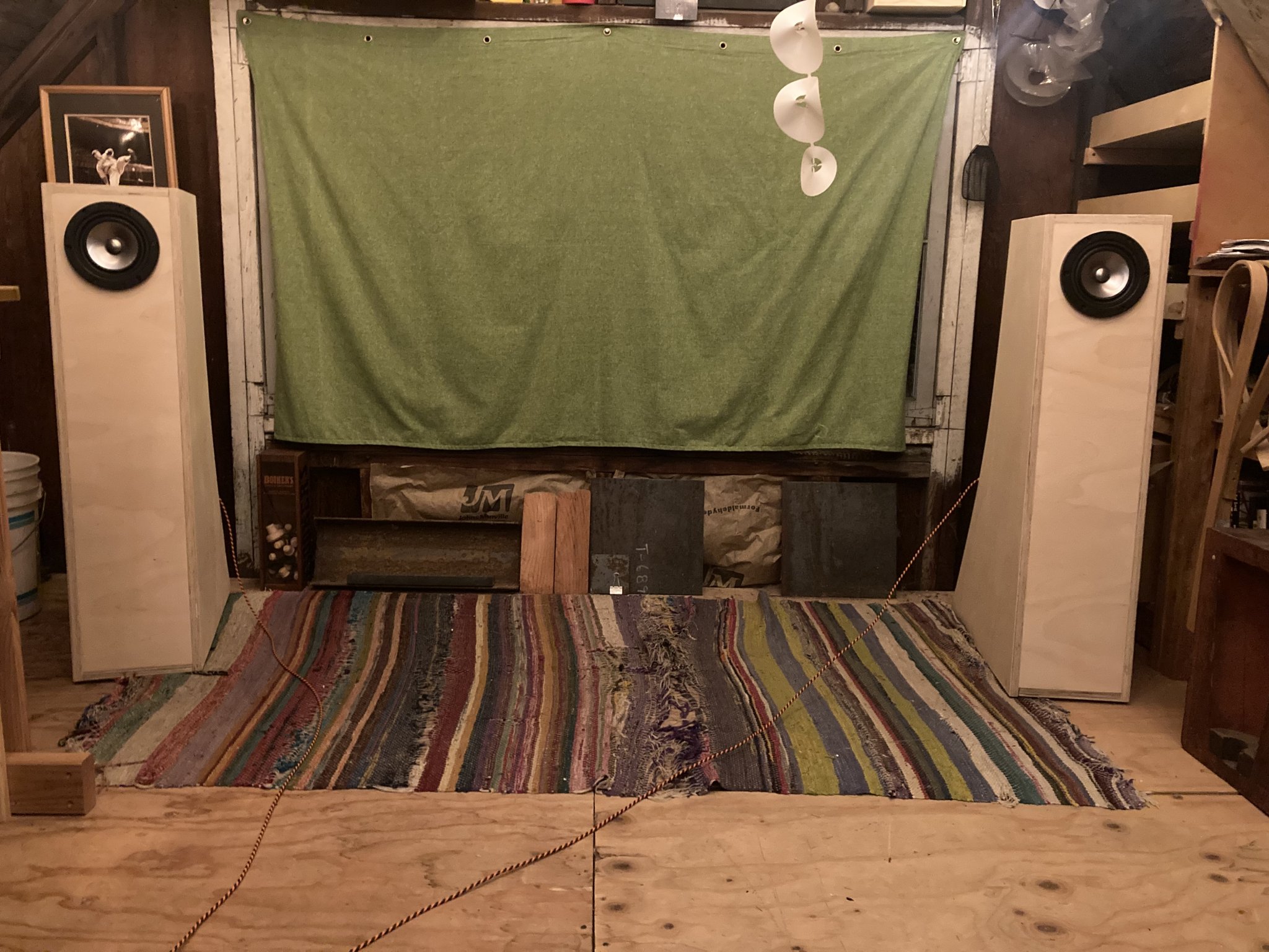

FH-XLs are awfully far from having any loading on the mouth. What happens when you move them backwards?
The joist seems to be there, so they could sit on a board.Yeah, wondering if there's enough loading to control the driver down low in essentially 4pi space.
Just wondering, what would be the expected result from being moved back with a narrow 'floor' to the wall, but having the floor gap (and then ledge) on the front?
Correct, consequences.
I may add floor, the wall behind them is 100 yr old 1/2” ply. Maybe turn the whole listening setup.
I’ll try them inside in the living room at some point.
Drivers have a solid 35mins.
Fun build! They already sound more balanced, full (or some other descriptive audio word) than the Fostex folded horn kit I had in the same spot.
>>>>>>>> You may not have to add a floor if the speakers can span the gap.<<<<<<<<![]()
Thanks!Huge? suck out below the baffle BW.
So the front boundary is more important than the rear horn loading, at least for that design meant to be floor standing (and not up on speaker stands)?

Alright, switched FHXL to the other side so they could be close to a wall. Convincing. I’ll have to rearrange a couple things so the space is more functional but first impressions are full sound, nice image and resolving (? - I understand lyrics & sounds more clearly).

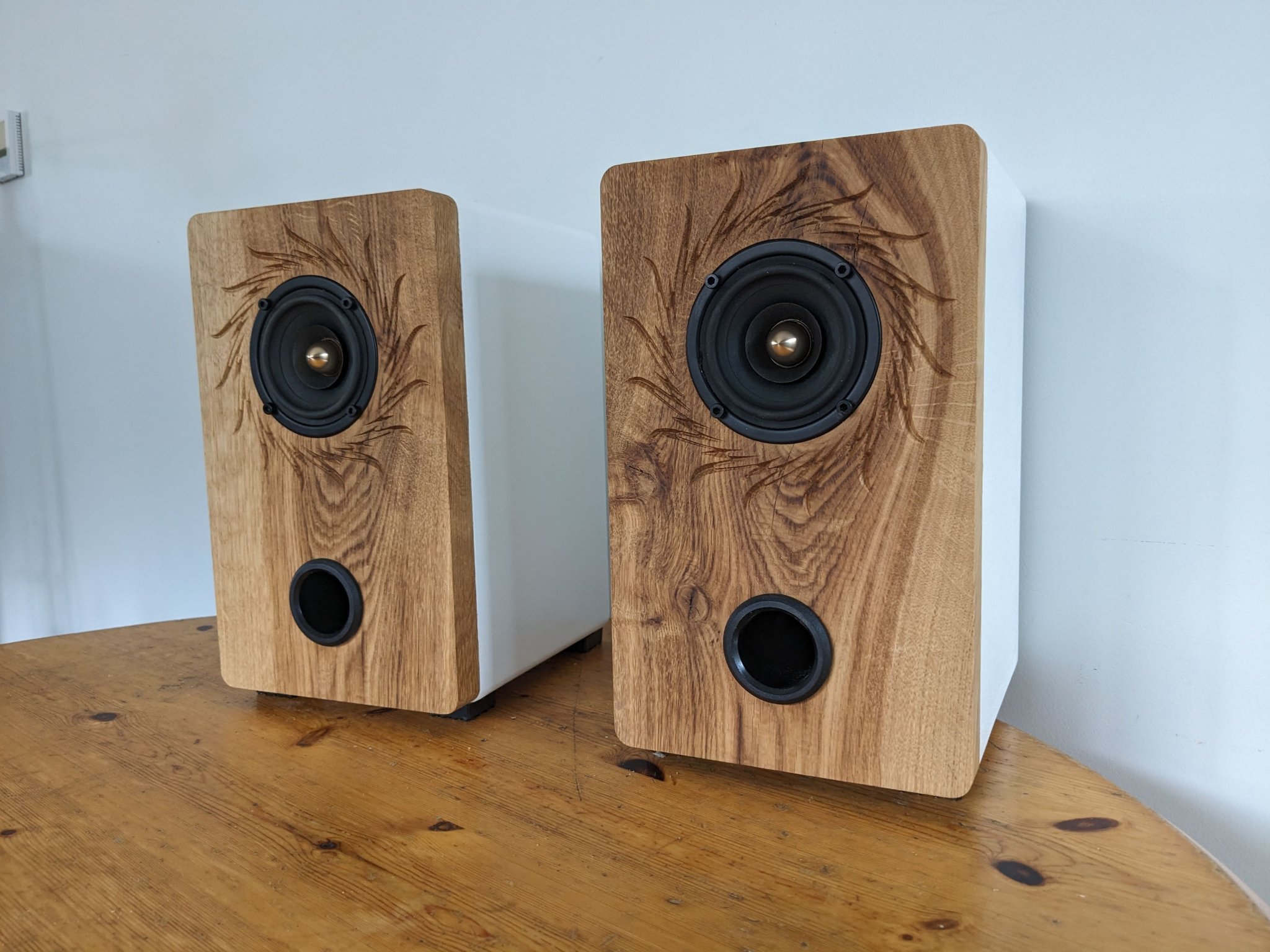

I made this one. Lyeco ly-401f in TL costruction.
a quick pair of bookshelf speakers for my lads birthday. drivers are nothing special but after the way my last attempt turned out im happy with the finish.
good practice for the ma chn110's i still have sat in a box .
