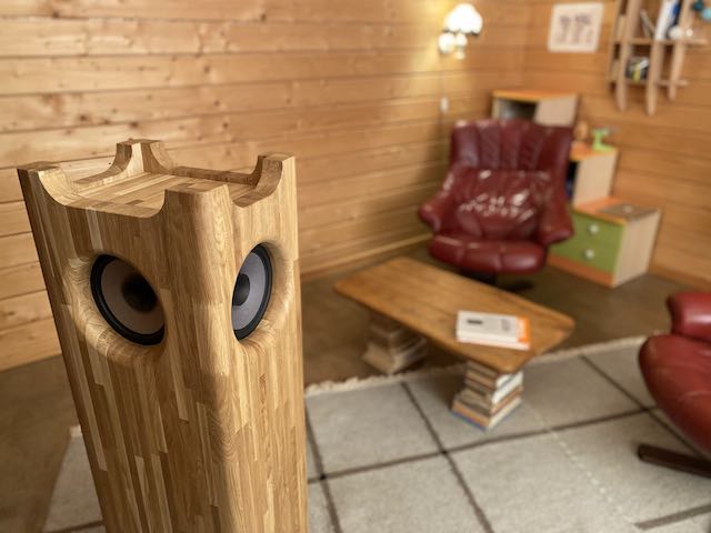

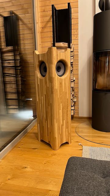

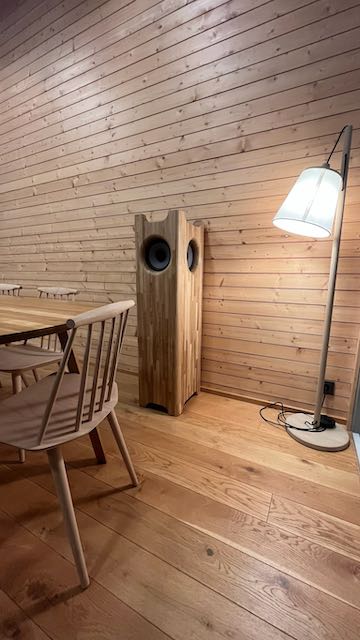

Vent is at the bottom. Yes i know the shape is not perfect.But it is as it is for other reasons.
Never studied phase plugs. So what benefits this driver gets from phase plug?
Smoother response. Gets rid of what is happening under the dustcap (oil can resonance), and the crap happening inside the dustcap (pushes anything way up in frequency).

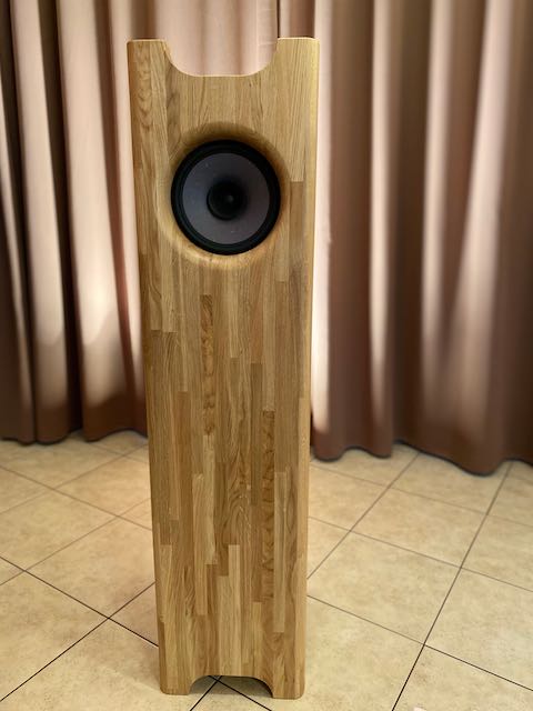

Nothing wrong with the box shape, it looks like a really big microTower, (original thread and one of the most recent)
microTower bipolar ML-TL for CHR-70 or EL70
https://www.diyaudio.com/community/threads/microtower-revisited.364581/
You just need to know that the vent (restricted terminus) will need to be longer than your BR modeler shows. Also being endloaded it should likely be largely filled with damping material.

Very nice. Do you like the sound?Recent build of Jim Griffin MLTL for Alpair 10p
Get it. But still phase plugs are not very common in drivers..Smoother response. Gets rid of what is happening under the dustcap (oil can resonance), and the crap happening inside the dustcap (pushes anything way up in frequency).

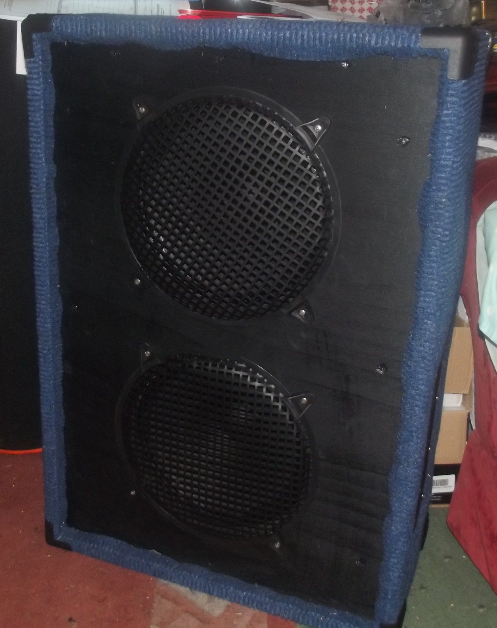

Volume 60l and yes quite a bit of damping material inside
Actually they are quite common. And i have not yet met a whizzer coned driver that does not benefit from their addiiton.But still phase plugs are not very common in drivers..
60 litres is good for a single driver in a sealed box. In a vented box with 3 drivers i would expect more like 200 litres would be appropriate. It would be interesting to see what heaviy stuffing the vent would do.
With BR loudspeakers damping is usually kept to a minimum, so with lots it has further distanced itself from a reflex.
