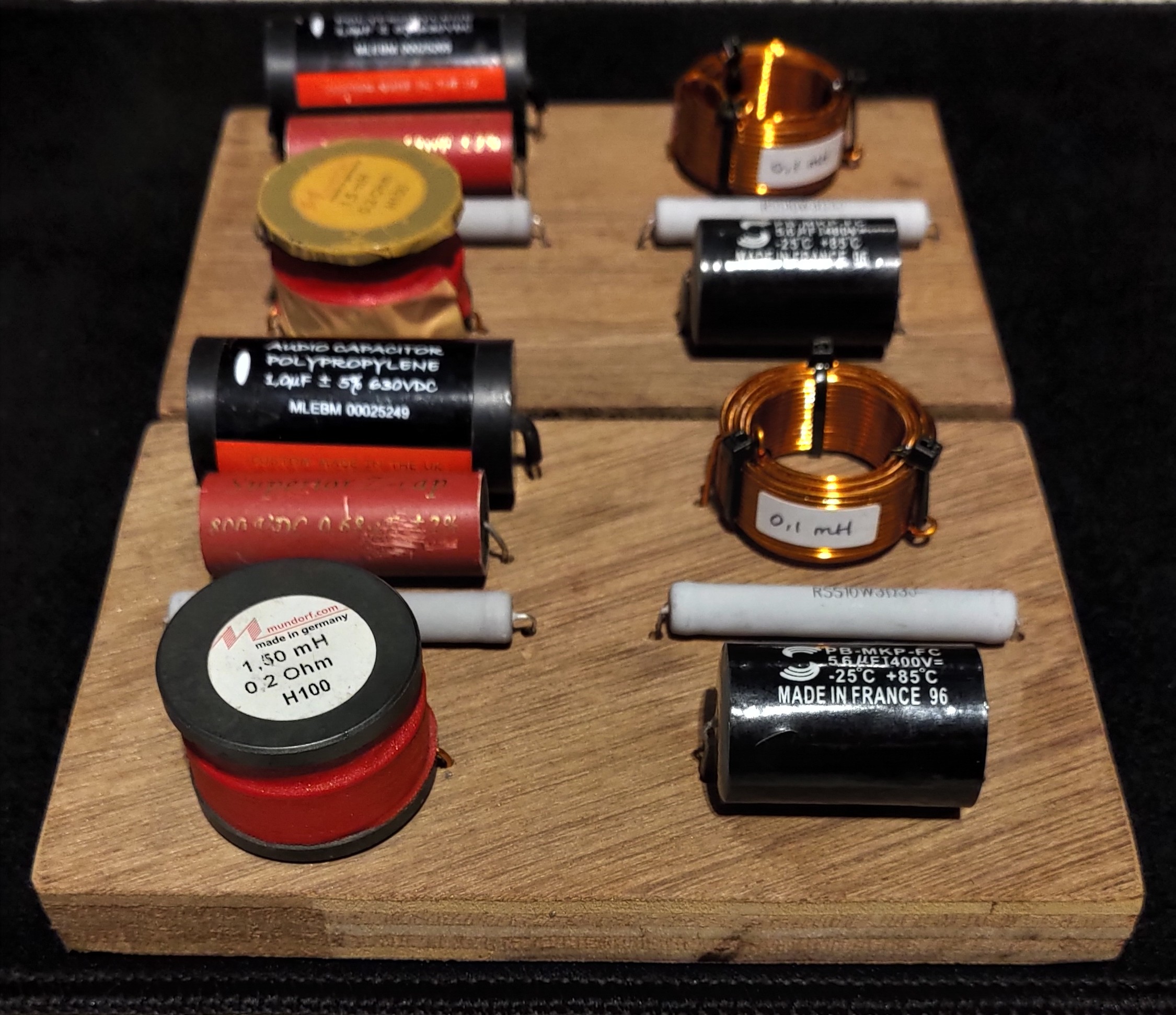

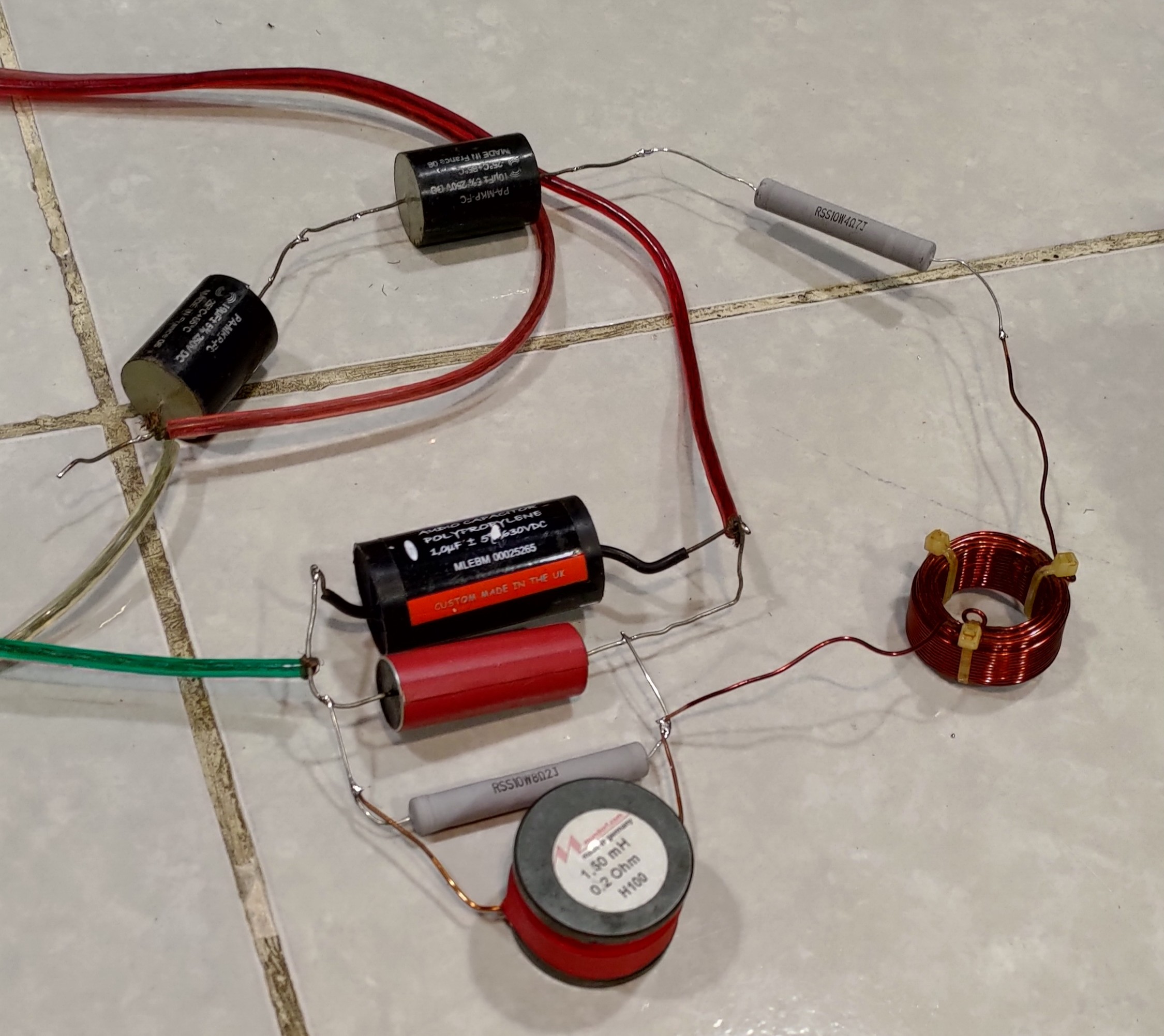

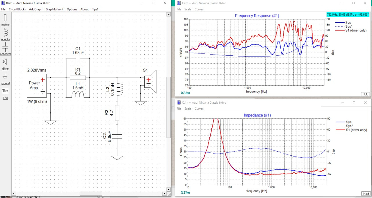

I almost give up on AudioNirvana Classic 8 in BR cabinet 2.8 style. listening to the album of "Avenged Sevenfold - Hail to the King" is so painful to my ear. while listening this album on my Open Baffle or Senn HD650 is very enjoyable
but last week i found a post which i did not save the link but the picture layout, trace AN response curve and implement it on XSim. and the result is very good, it increase bass and reduce mid high spl, more balance sound.
i tested the circuit on the floor and just finished solder it ptp and plywood. really enjoyable AN now

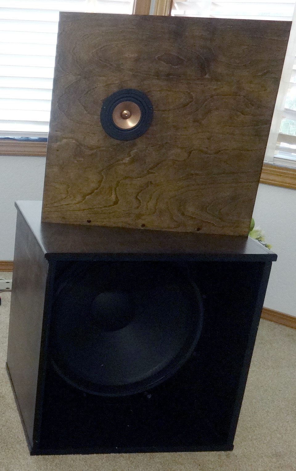

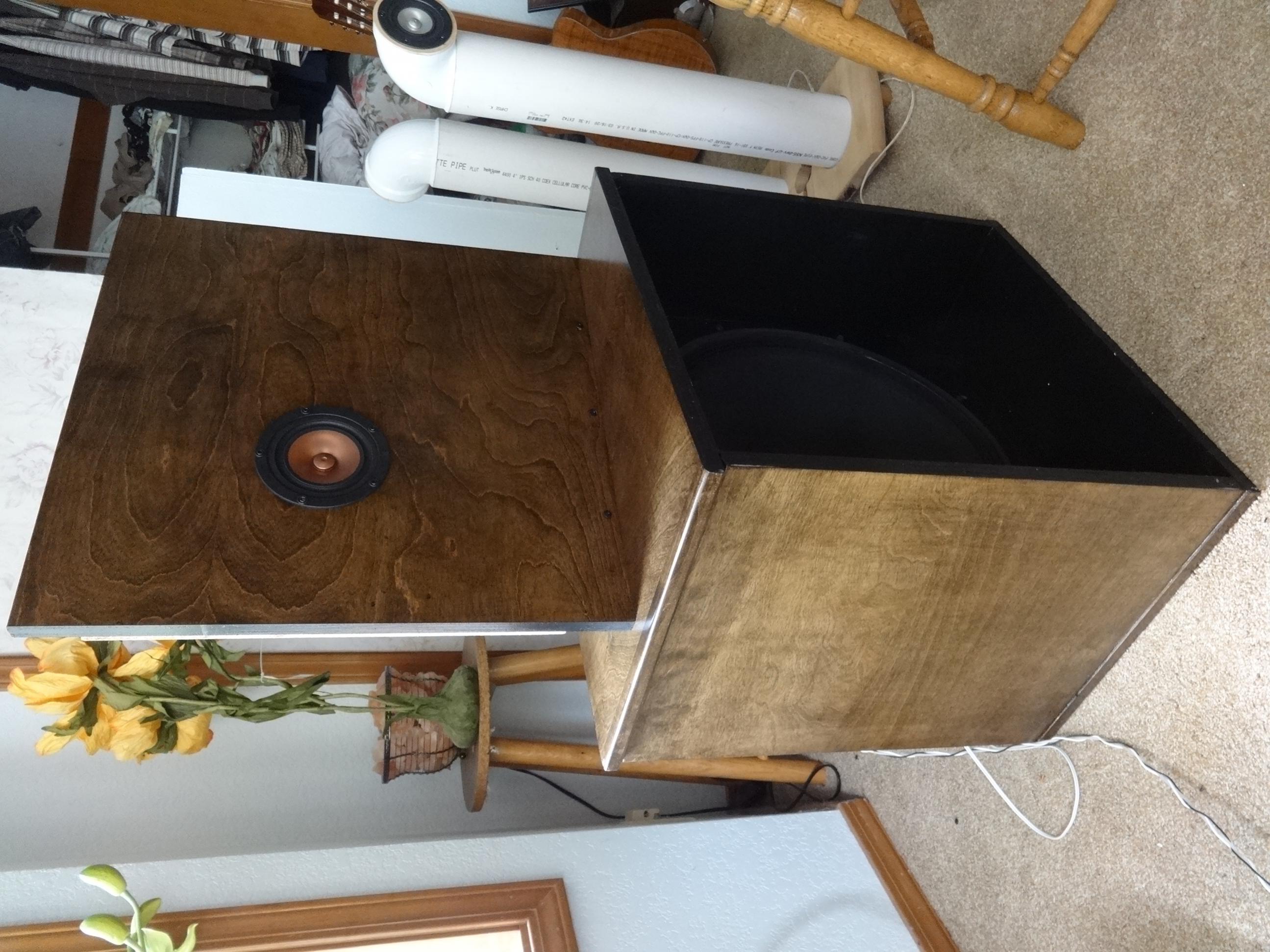

My MJK 18" H frame OBs
My MJK 18" H frame with Pluvia 7 on a reinforced 20 X 20" OB. (The other speaker is similar, only mirror image)
Since I listen at much lesser than concert levels, I run the Pluvia's FR and cross the H frame around 100 Hz. Standup bass sounds natural and those two 18"s motion are barely detectable to a finger touch on the cone. I imagine the VC is in a pretty linear portion of the magnet gap at a micrometer level displacement! Wanna talk effortless?
I just love the FR OB sound, with these built I'll probably never have an enclosed box type speaker again. I've a number of drivers to play with on the OB panel; should keep me busy for a while.
I know they're big for a bedroom; I sold them to my wife on the caveat that we could put a board atop the two H frames and use the assembly for a table to start her plants in front of the window. That positioning will wreck the bass, but I can live with it for a few months... The OBs will sit atop a couple of oak stools.
All in all quite pleased with the sound. BIB!

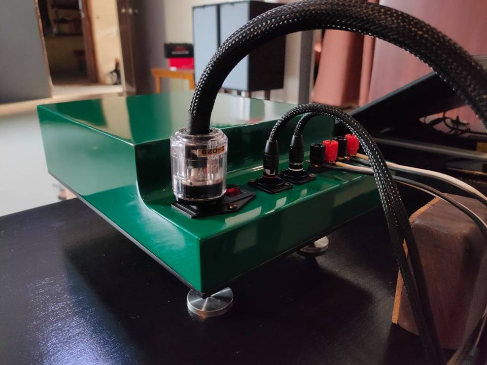

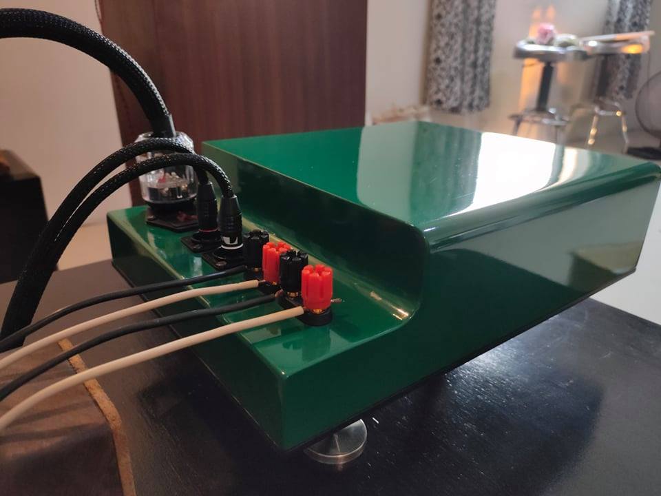

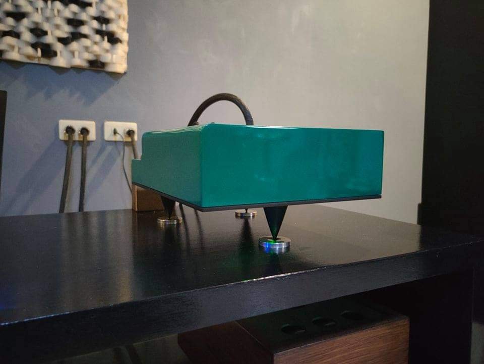

i do really like them =)they are my main speakers for now until i get my Sansui F-10 fixed =) anyway, im driving them with yuan jing black board tpa 3116 directly connected to SMSL SU 8 DAC which has volume control.
