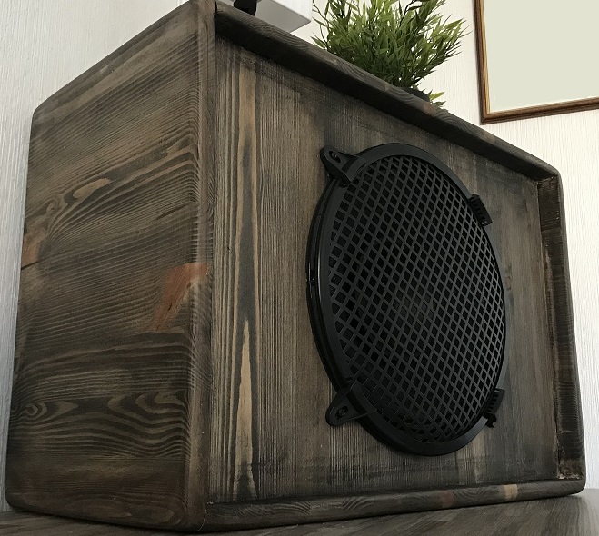

My latest project with Fane 12-250TC full range

Hi thanks they are a bit rough but first time doing a real paint job at all. Last project with Fane 15” was similar but with transparent oil only. Projects before that was never finished really, just black MDF which I don’t like the looks of at all. If I improve my carpentry skills I might invest more in DIY designs as well as I’m not happy with what the HiFi shops provide today, I’m somewhere between PA and vintage HiFi not skinny towers with weak dynamics. So the Fanes are cool in that way.
I don’t have a google account and I don’t plan to make one either so sorry no video, besides as mentioned you would only really be listening to the room and the badly location phone mic. This room is not optimal at all but I’ve learned that bigger bass drivers resonate less with the room probably because they have a lower resonance frequency. Small speakers sounds absolute terrible here so that’s why I wanted to make these monitor inspired speakers. Inspiration from Klipsch Heresy JBL 431x/L100 and Tannoy Little Red/Gold I’m gonna build a few more of same size but two way coax and three way horn. I find full range fun but the compromises are too big really. These will probably end up in the cabin.

The look good. I like that rustic look.
Thank you. Total bliss. I can wait for my ZRock and my DAC. In a year or so I’ll upgrade to a Crystal 10

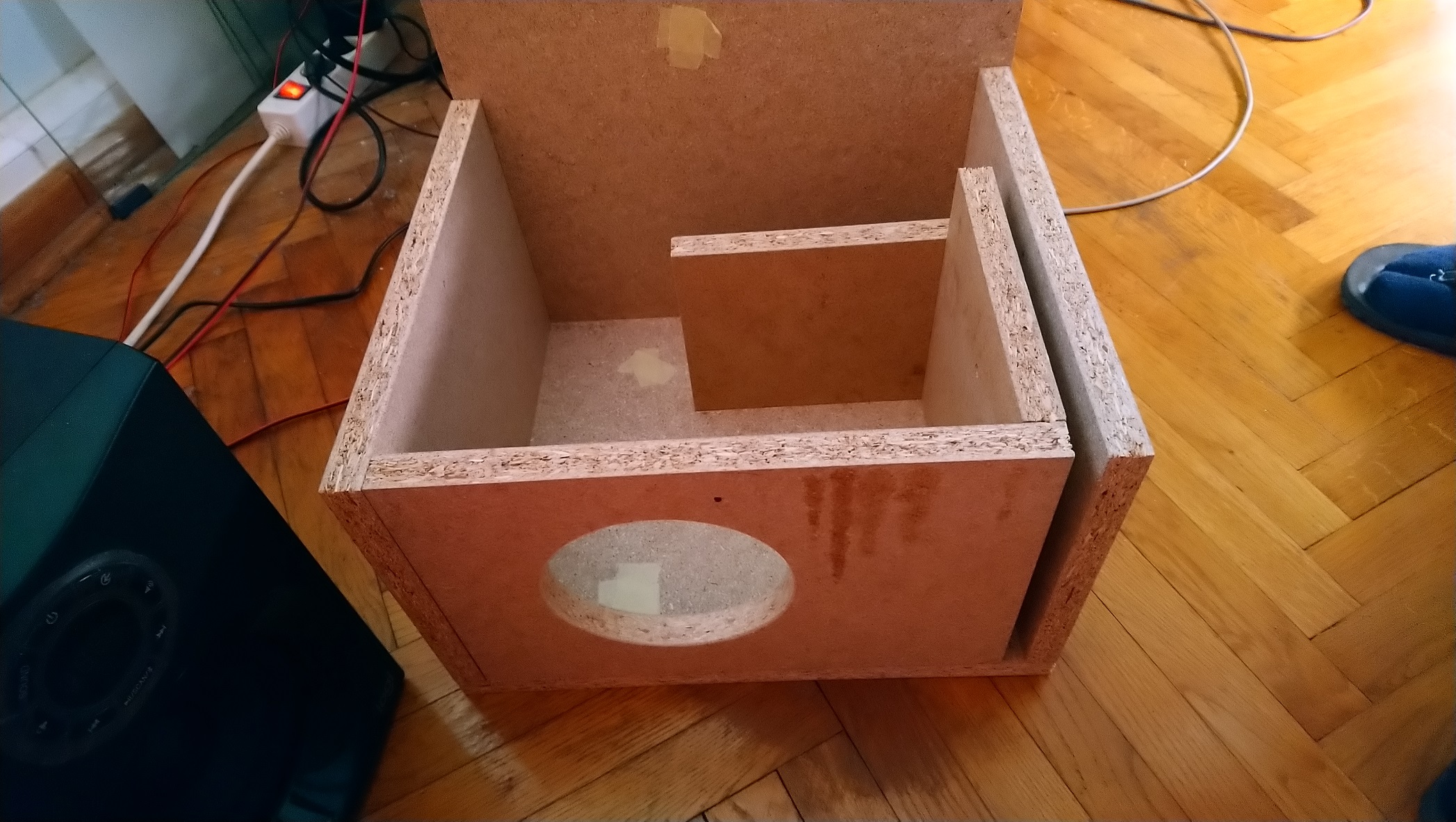

finally i finish this subwoofer box.it was made by plywood 19mm,wood glue and wood screws,corners i filled with some glue and put cotton only on top and back side,has you can see the port out is not to big.I am sure that this box is strong. i replace 25w 8 ohm woofer from some home theater to this box and i am satisfied.home theater absorbe boomie bass which i didnt like and now i got little sealed bass.i know 25w are not big speaker but i am satisfied with my work. betwen i can make bigger hole for bigger woofer😀

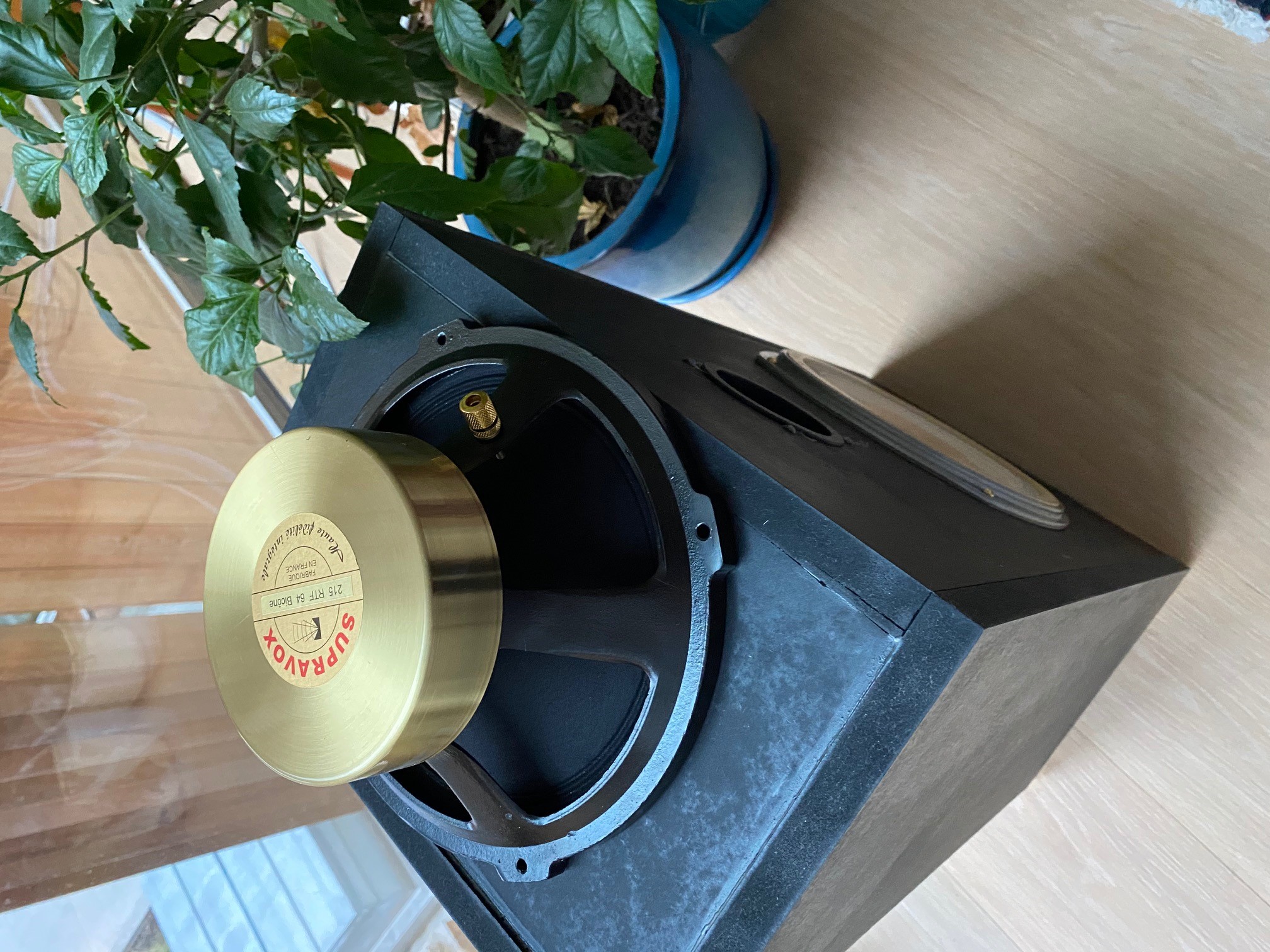

Just got myself a pair of Supravox 215RTF64 double cone 🙂
Estetics is super high and sound is good too.
Hi there !
I have the same driver . What s your other driver(s) if any ? I want 2 ( or 2.5 way if you like )way with 2 Beyma SM 115/N per side , no TW .
Hi there !
at the moment there playing in an open baffle with Coral Beta II in basreflex-boxes. the Corals are playing up to 140 Hz and Supravox are playing from 140 Hz and beyond. Second order filter for the Corals and first order (electrical) + baffle step for the Supravox. Sounds really good 🙂
