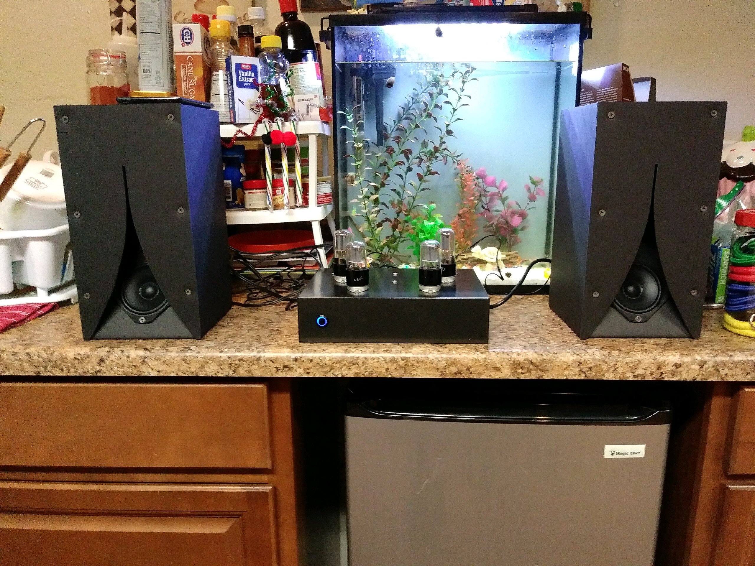

These are my full range speakers. They are now resident in the bedroom. Lovely sound, they realy exceeded my expectations.
Regards
What type of horn is this?
