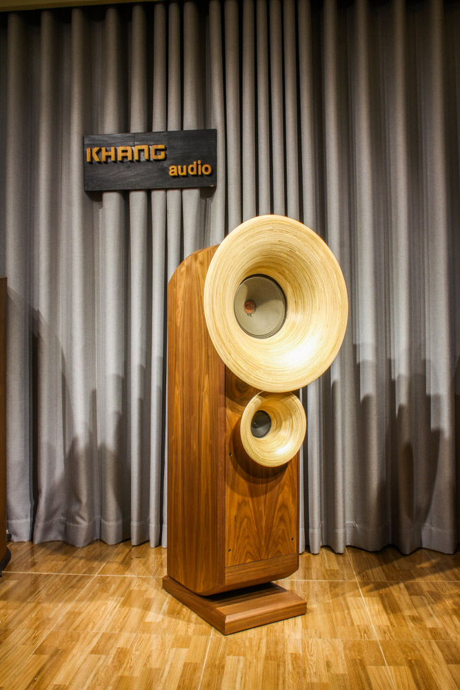

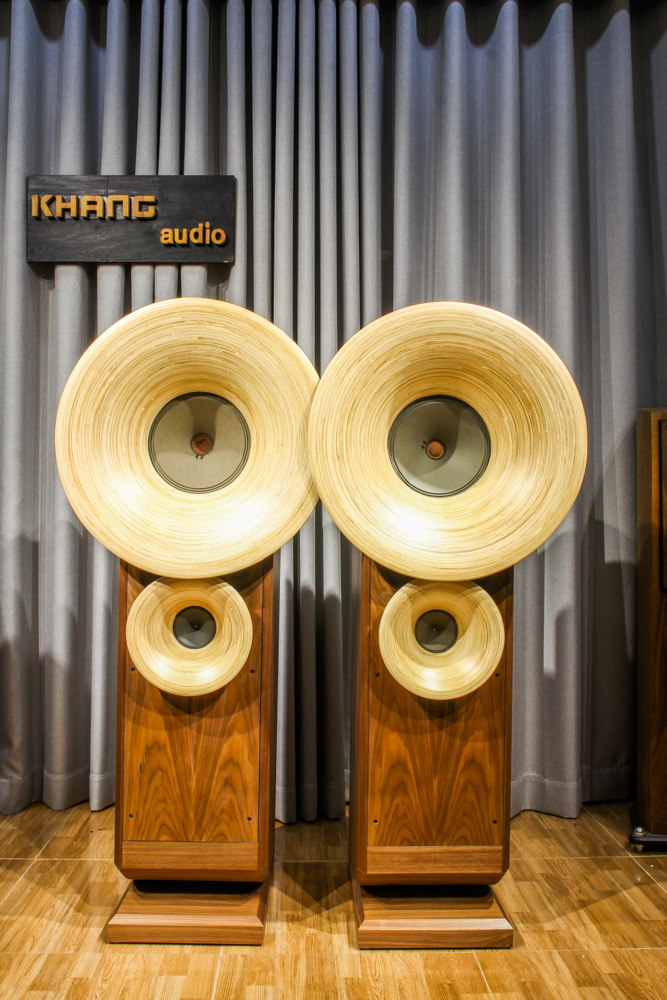

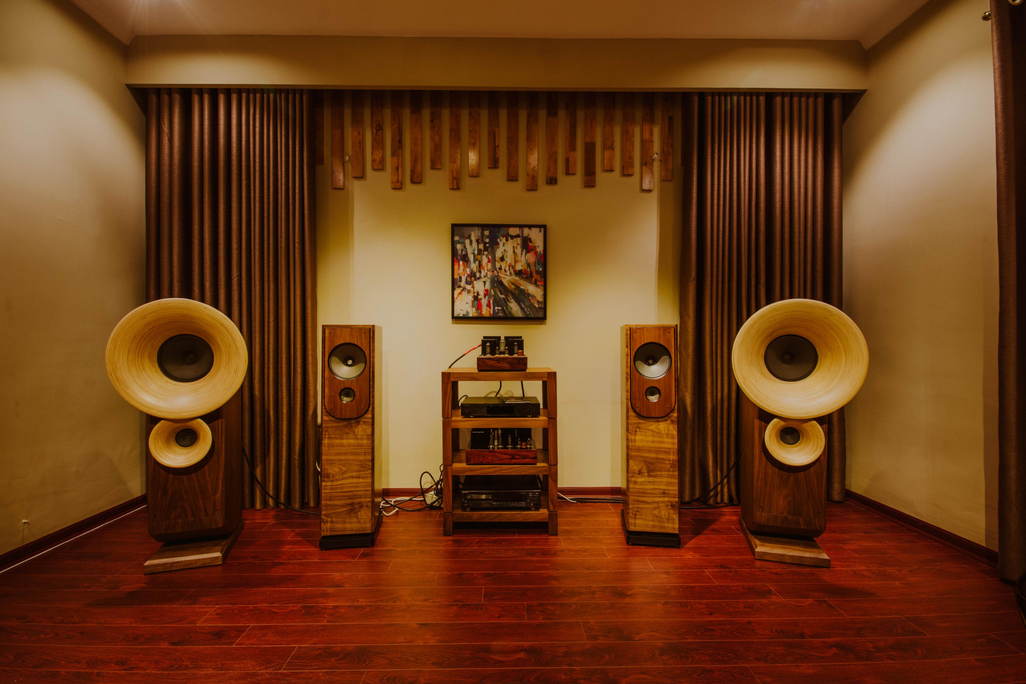

Khangaudio you do exquisite work. Those speakers and your workmanship look as good as the speakers produced by many name brands IMNSHO! I bet if you were living in North America you'd have more work than you'd know what to do with and I'd be your very first customer requesting you build me a pair of speakers just like the pair shown in your post. All my best to you and to your continued work my friend.
I'm listening to: Navigator by Paul McCandless
Thetubeguy1954 (Tom Scata)
Thanks for your motivation... I still keep learning and trying to produce more and more beautiful and great sound speakers. If you really want to have one, I will find a way to ship to you!
DIY Bamboo Horn Speaker
Here some photos of another Horn Speaker DIY project. The horns is made of Vietnamese bamboo. Driver Siemens Isophon Klangfilm 307.
Video for it's sound:

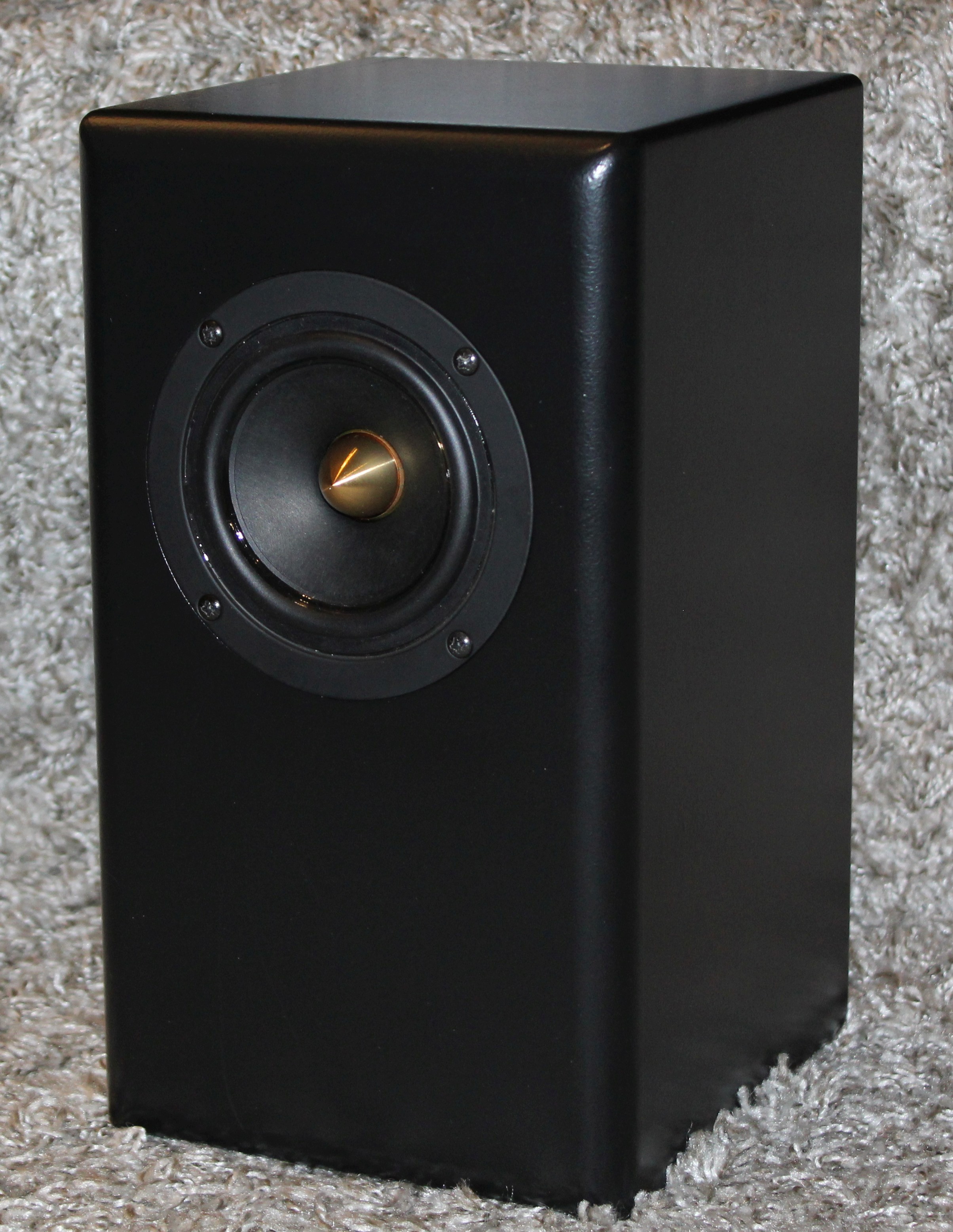

DSP-controlled Desktop-Speaker with Tangband W4-655
W4-655EA
W4-655EA

Nice!
I'm not a fan of horns myself, but they do look very nice.

Cool!
Wow, those W4-655 really breakup after 10kHz.

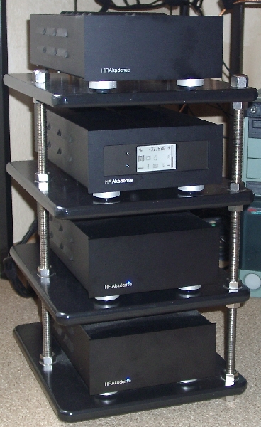

Your DSP is computer based or with a miniDSP?
I'm using a hifiakademie-Amp with integrated DSP: ....::: HIFIAkademie.de :::....
... but Equalizer APO will do the job also.
That is some... ahem... rack!

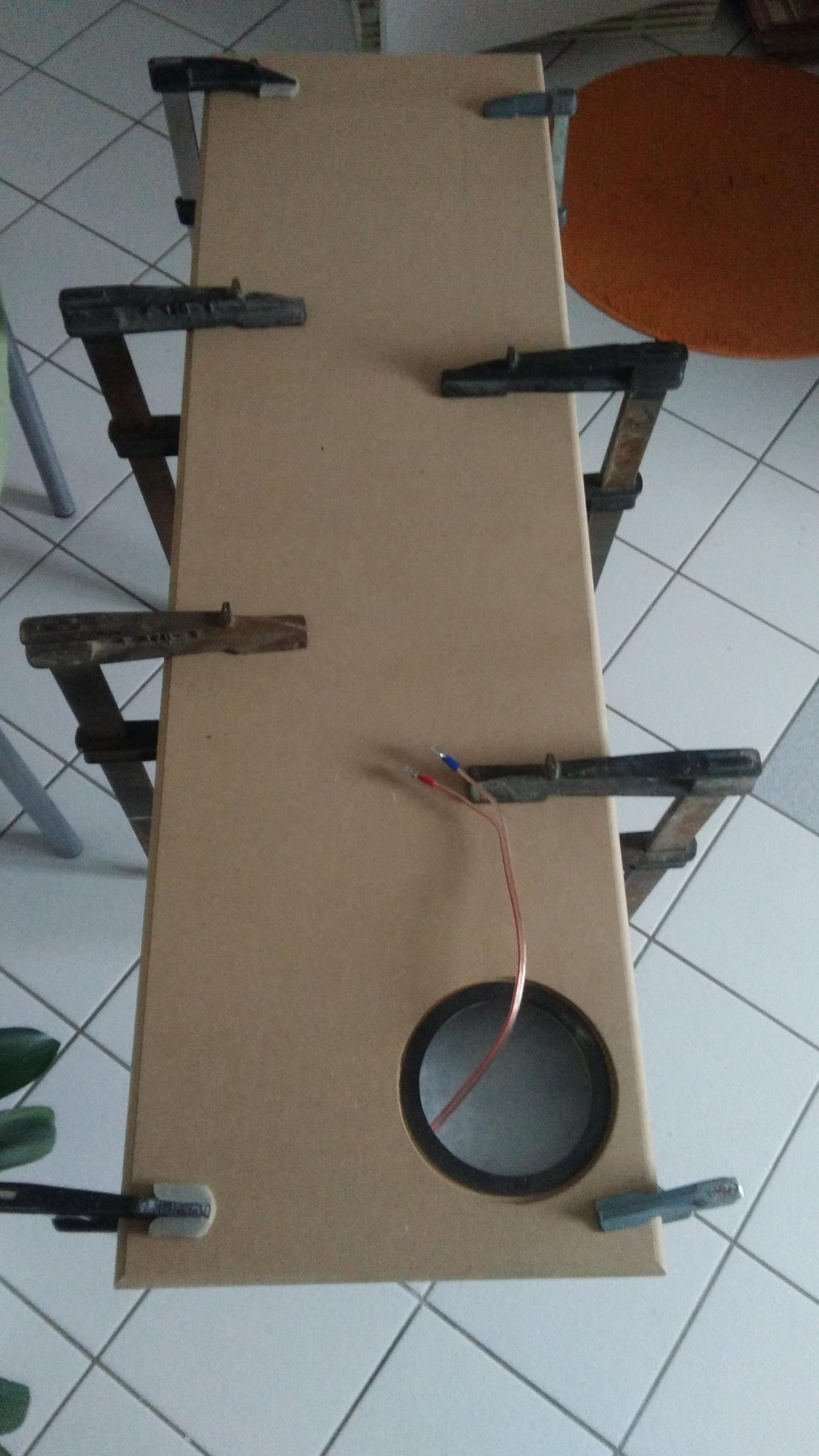

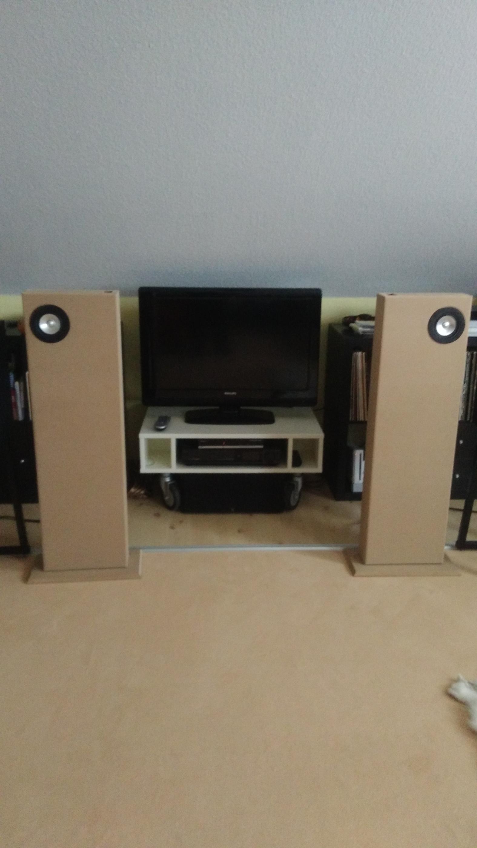

Hello
Here my second homemade boxes after 40 years.
The first boxes were 3-way-Perless speakers.
Now i love fullrange speakers and i build the
Mark 7 with Markaudio CHR-70 Gen.3.
All a happy and healthy new year.

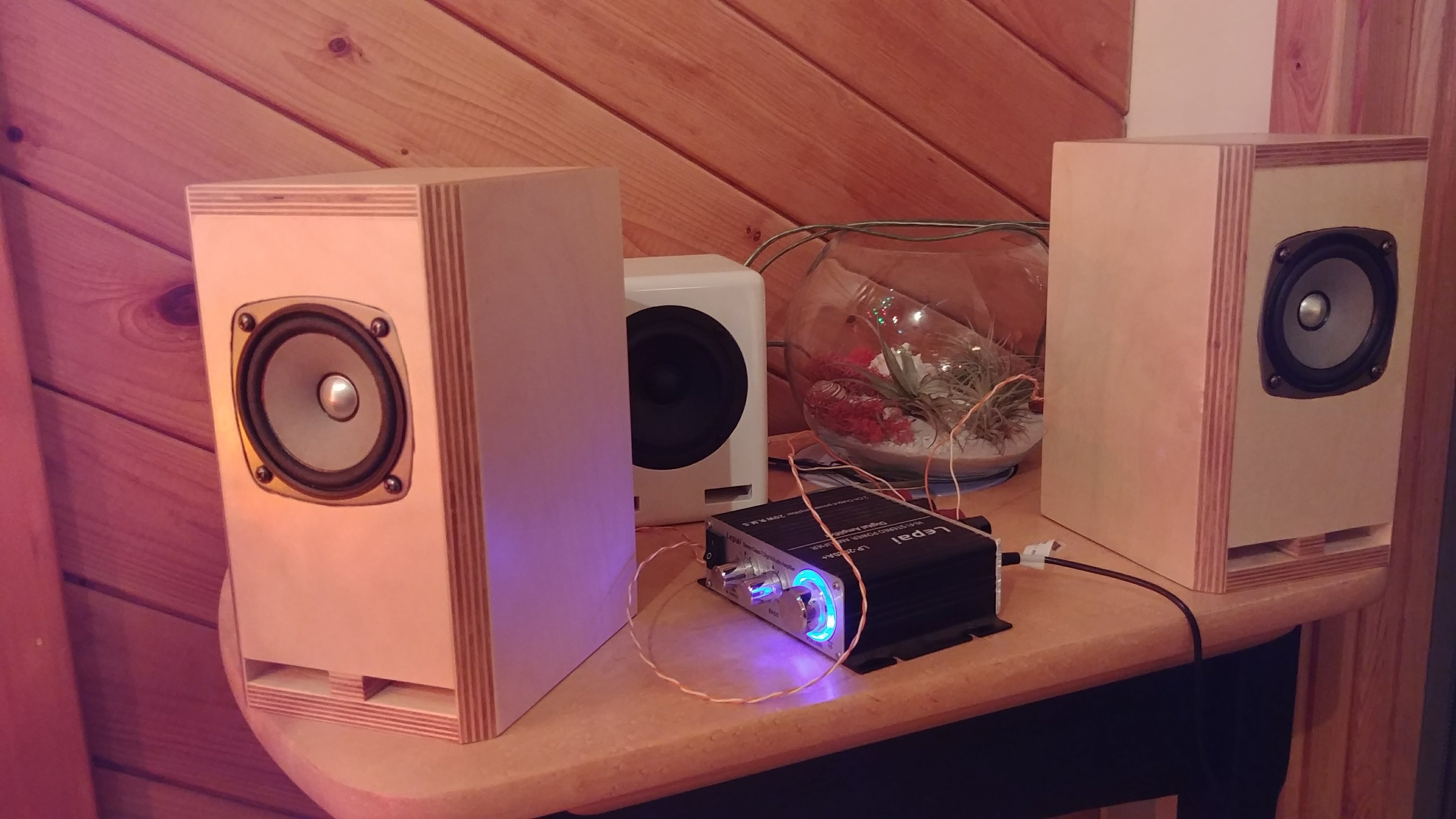

Built these for my older brother for xmas. Think I converted him... payback you know. 1/2" bb, wool damping, conversion varnish. I've found that a pin nailer is great for putting together these little guys. No joints, just spread glue, nail, clamp and wait a little bit.
The ff85wk sounded a little harsh at first with no break-in, but then I was comparing to the scanspeak which have paid their dues.
Overall, I've enjoyed the response from non-audio centric people who seem bewildered at the great sound coming out of little speakers.
O.k., back to the FHXLs.
