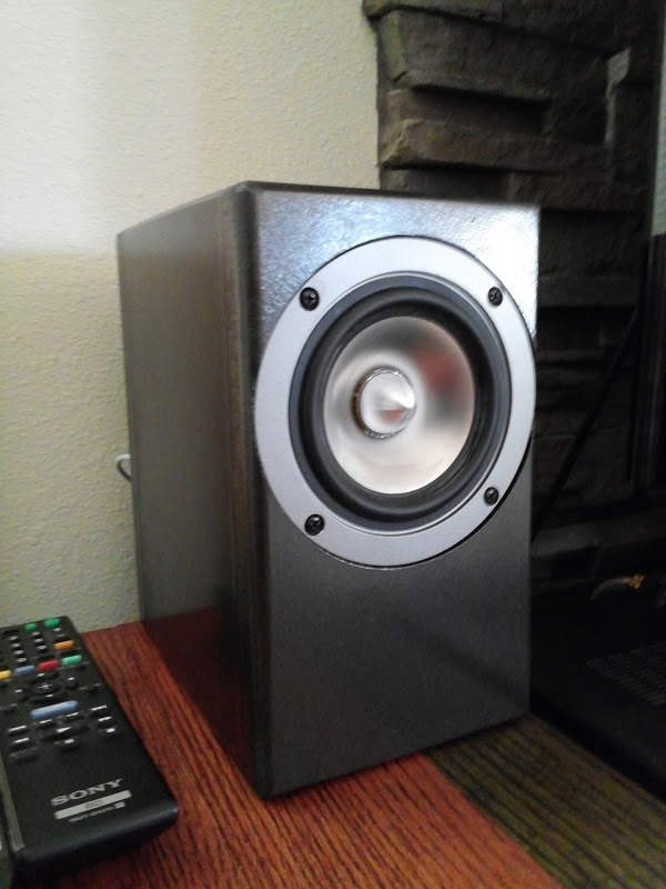

They started out as computer speakers...
Here is my full range or wide range speakers. Drivers are Tang Band W4-1337SD 4" Titanium. There were my computer speakers, but then I needed a temporary center channel and they filled in and have stayed since. :)
Recently I hooked them up to my main 2 channel setup. I was truly surprised how nice they sounded. Crossed over at 100hz with dual 12" subs filling in the bottom end. Probably a bit too low of a crossover point, but I didnt feel like adjusting for the test. Main speakers are usually Magnepan 3.6R.

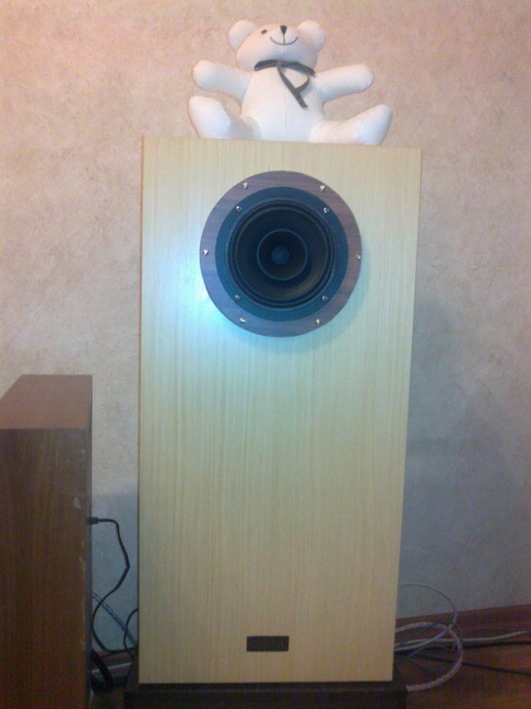

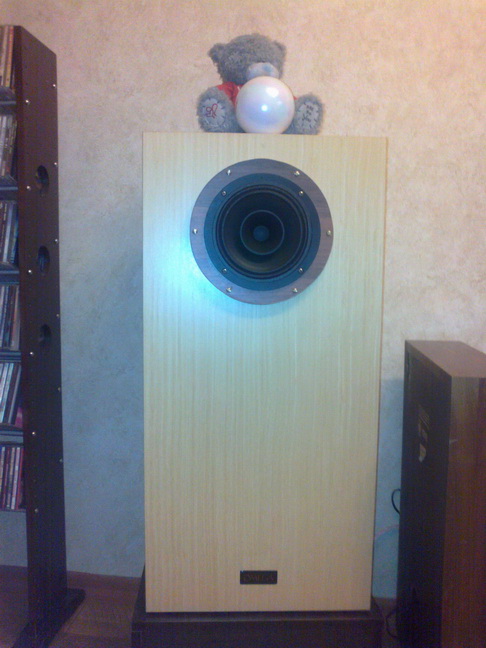

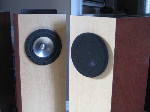

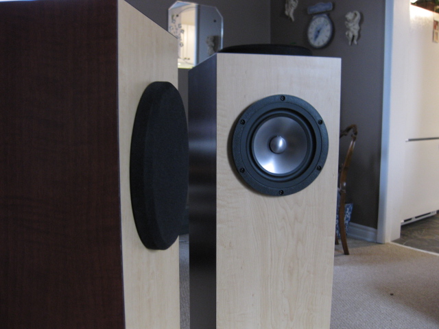

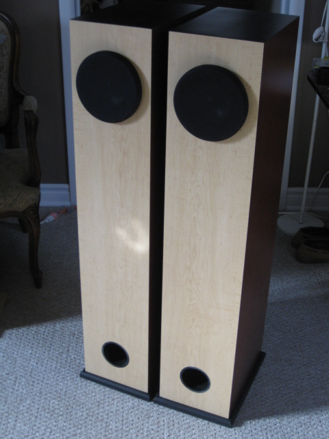

My second pair of Bob Brines MTLT for FE165WK. Built from scrap 18mm MDF (I know, I know).
I believe they sound better than the FE166EN BIBs, they are less directional anyway.
Next project is a base for the SET EL34 a friend built for me.
Cheers, Mack

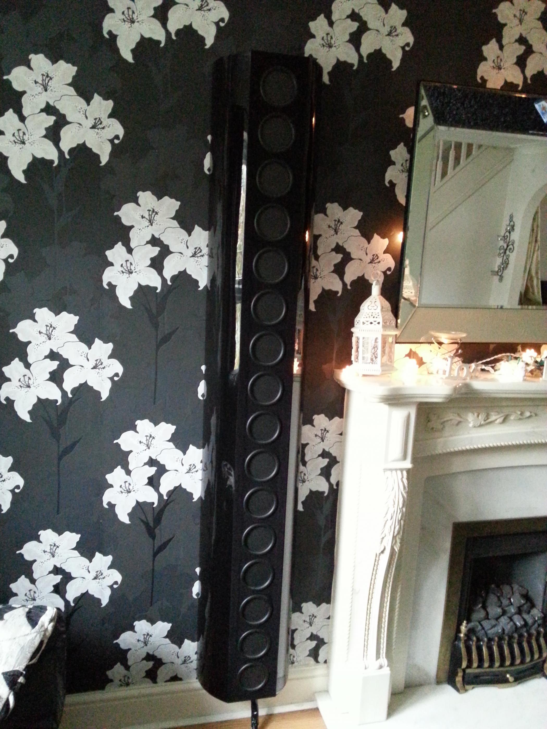

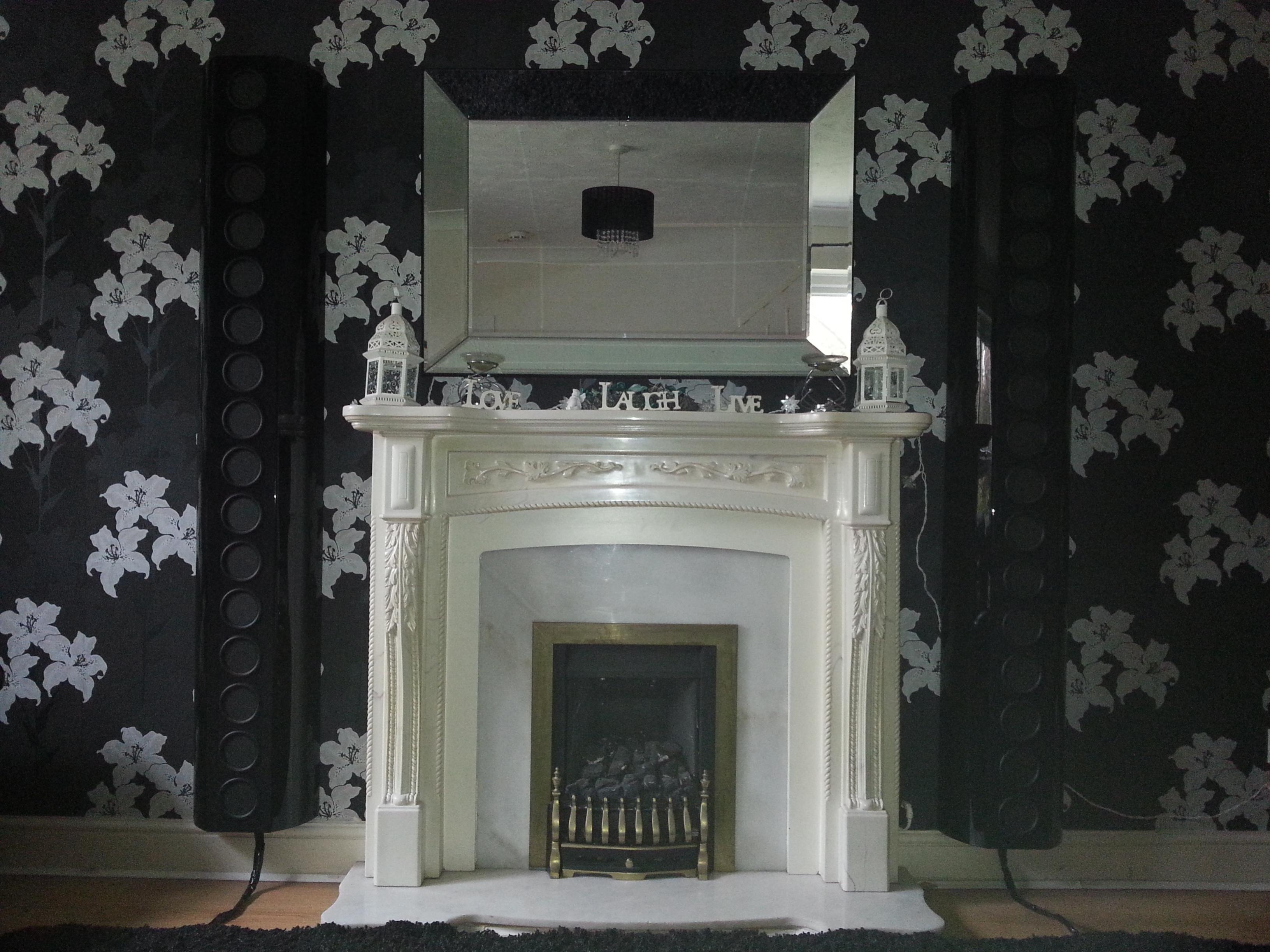

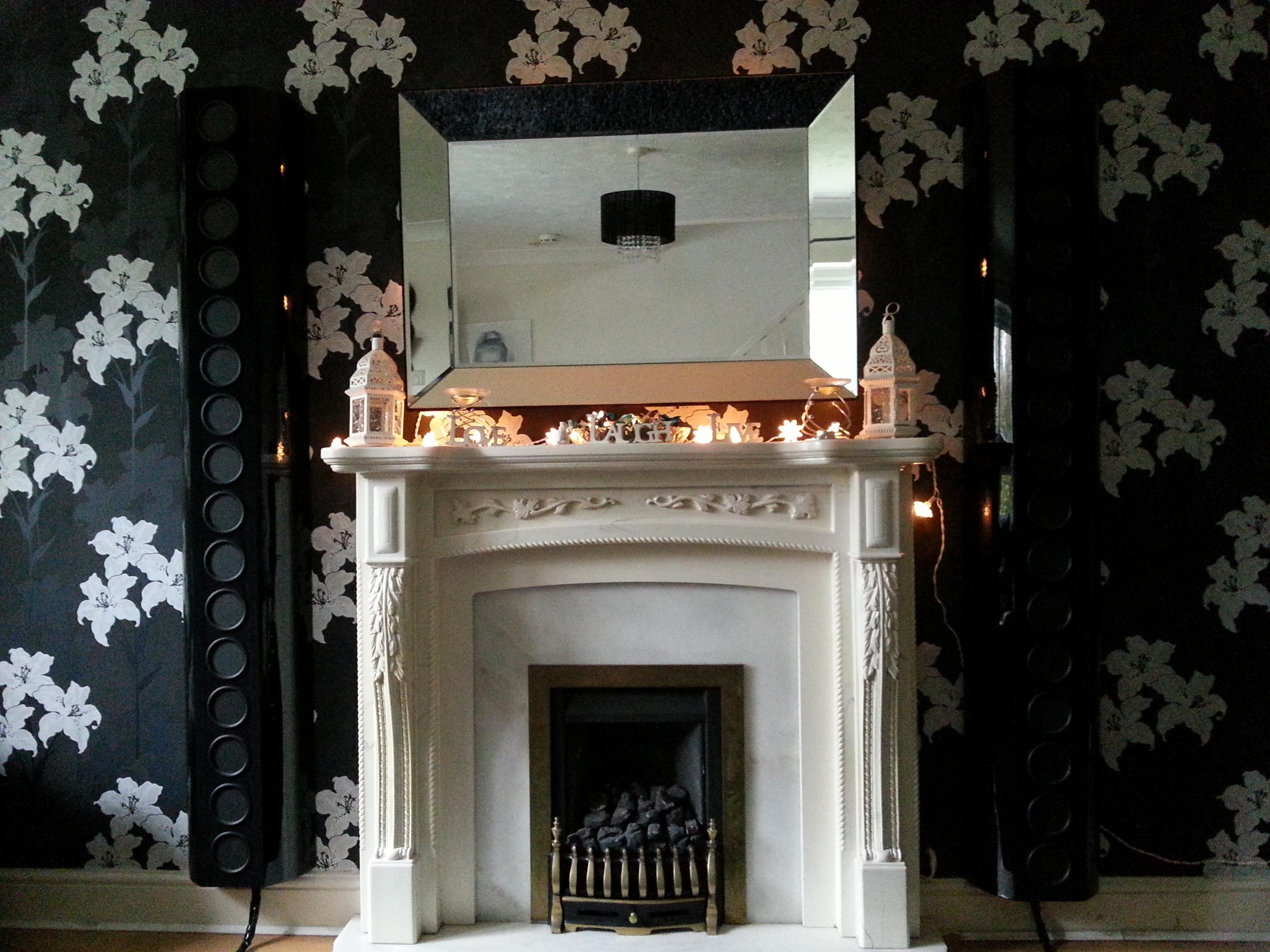

BMR Line Array...Suspended monoliths!
Decided on Piano Black gloss as the finish.
Its hard to photograph as its a real mirror black, but I can assure you these things have presence in the room, now they are mounted on the wall...
The sound is everything I need.
Working some other versions for home cinema set up.
At the moment got 32 drivers for stereo... going to have close to 60 drivers in the home cinema rig!
Cheers
D.

"No replacement for displacement" !
HiZman,
At the moment I am pushing the limits of driver Sd Vs wall space!
Building a few on wall or in wall panels with three vertical lines of 12 BMR's mounted edge to edge with non parallel internal walls and angled outside edges ...= 36 BMR's per panel.
The " wall of sound" idea does not come close, this is more like a tidal wave that never stops....So completely immersive it just fills your mind with the music or film score...Fab!
Its also weird when the music is well above 100 dB peaks at the listening position ( 4.4 meters) yet when you examine the drivers close up cant see any cone movement at all...!!
All the best
Derek.
Mack,
Nice MLTL you got there - the corners are done with real wood? What about the supra-baffle? How do they sound? The base for the SET amp also looks to be coming along nicely.
Yes, the front corners are done with solid Tasmanian Oak quarter round. Supra-baffle is Meranti, round-over or crown done with a 4" angle grinder with 60 grit. 12 coats of regular varnish top coated with Cabot's satin poly varnish from a spray can. I don't like shinny.
MDF has many coats of interior water based paint, sanded flat with 320 and waxed with floor wax.
It seems that I can play them louder without them sounding loud. Less bass than the BIBs. The "Sweet spot" is larger. Drivers had about 200 hours of break-in before install.
Cheers, Mack
Cheers, Mack
What efficiencies are the drivers? Any Xover?
Cheers
D.
Hi O.A.
First might I ask if you're the guy who built those awesome speakers with the Manger driver on top and I believe an 18" JBL below?
Your speakers sort of remind me of my friend Roger Russell's IDS-25 speakers which used 25 3.5" drivers per channel! But I digress, I hope you'll be telling us a little bit more about your speakers, hummm? While I find the idea of having 32 drivers for stereo ---{I'm assuming you mean 16 drivers per channel}--- the type of driver itself would be quite critical in how the end product sounds, no? So how about sharing which drivers you're using? Inquiring minds want to know!
