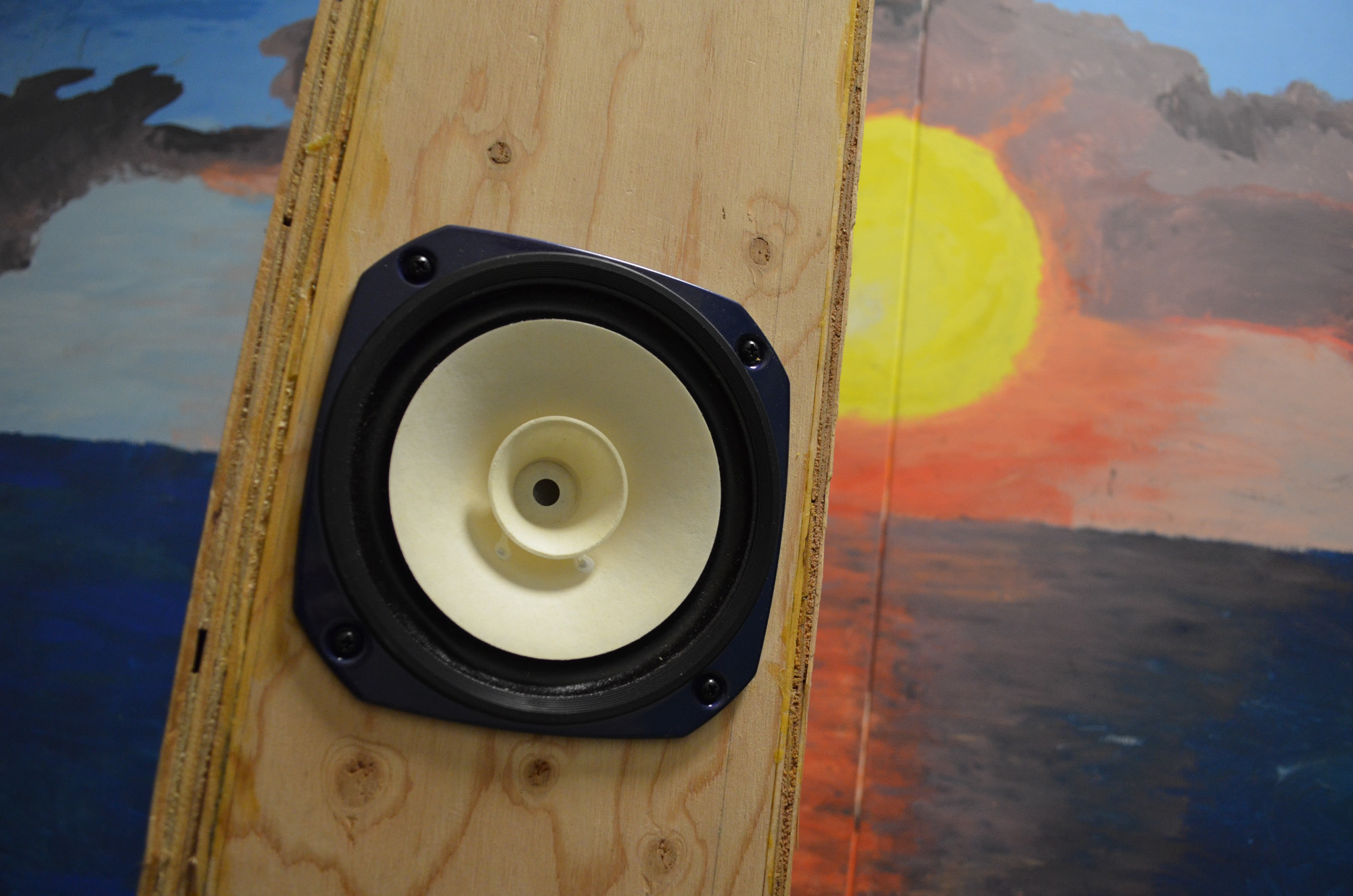

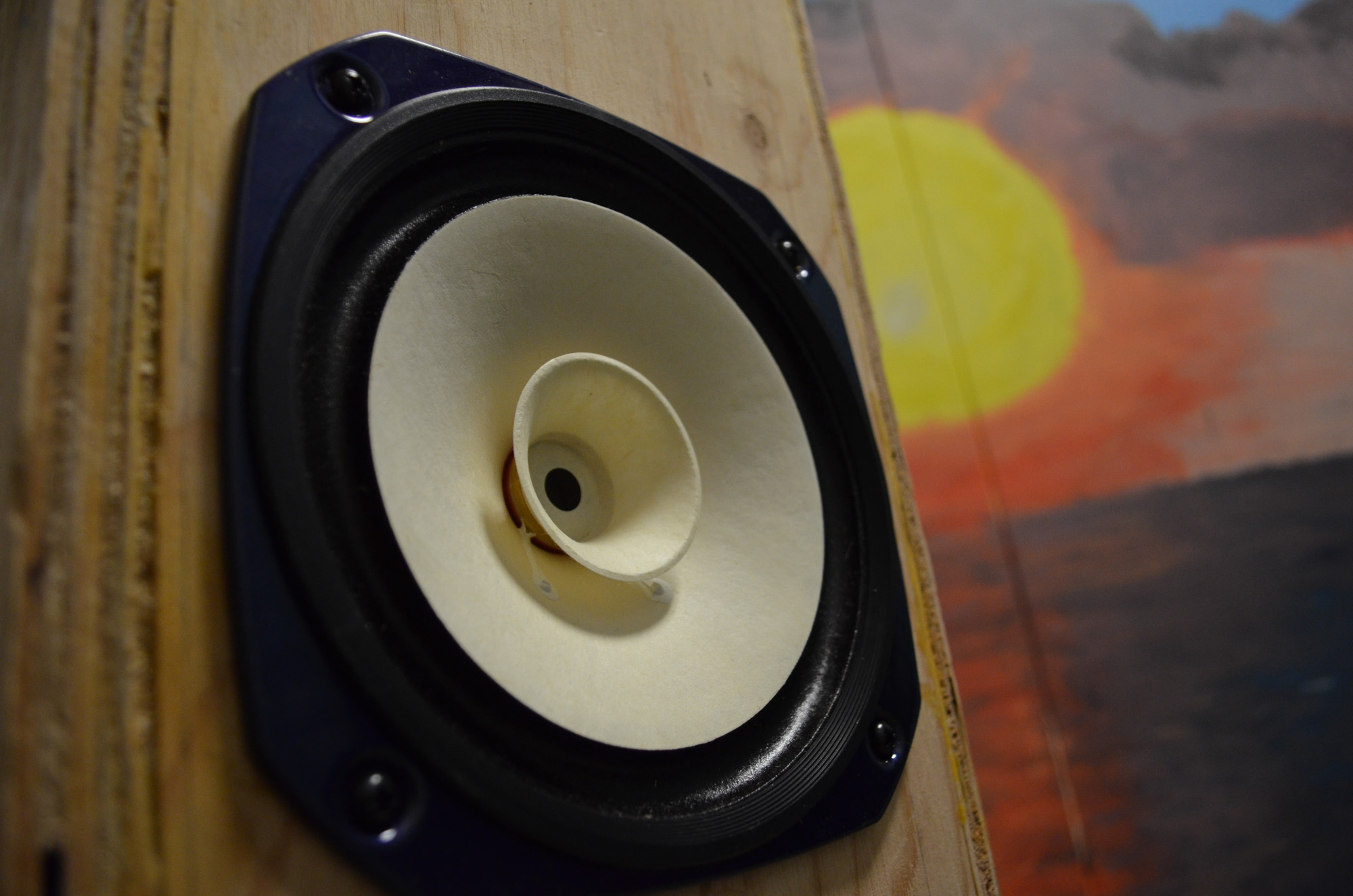

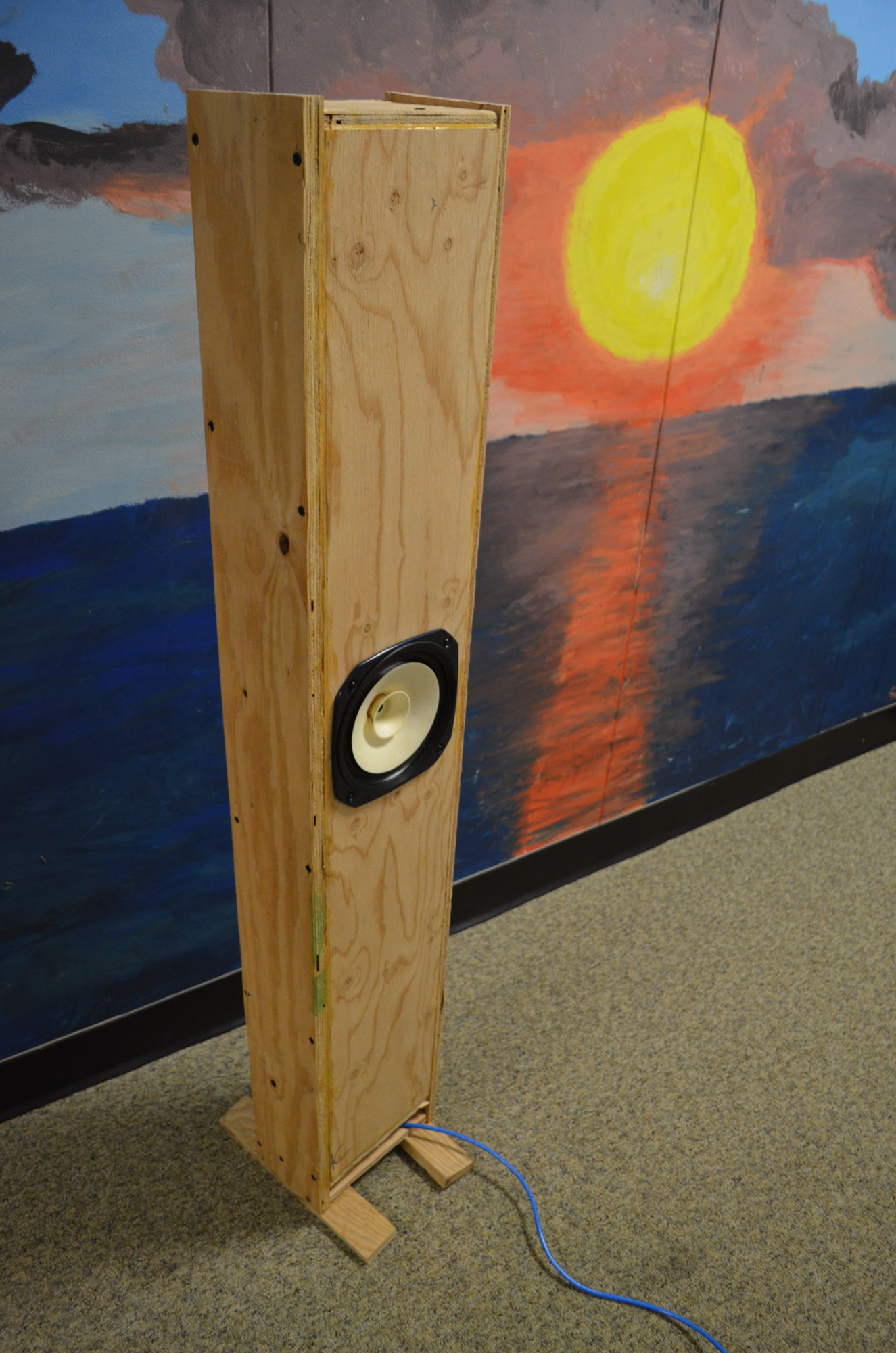

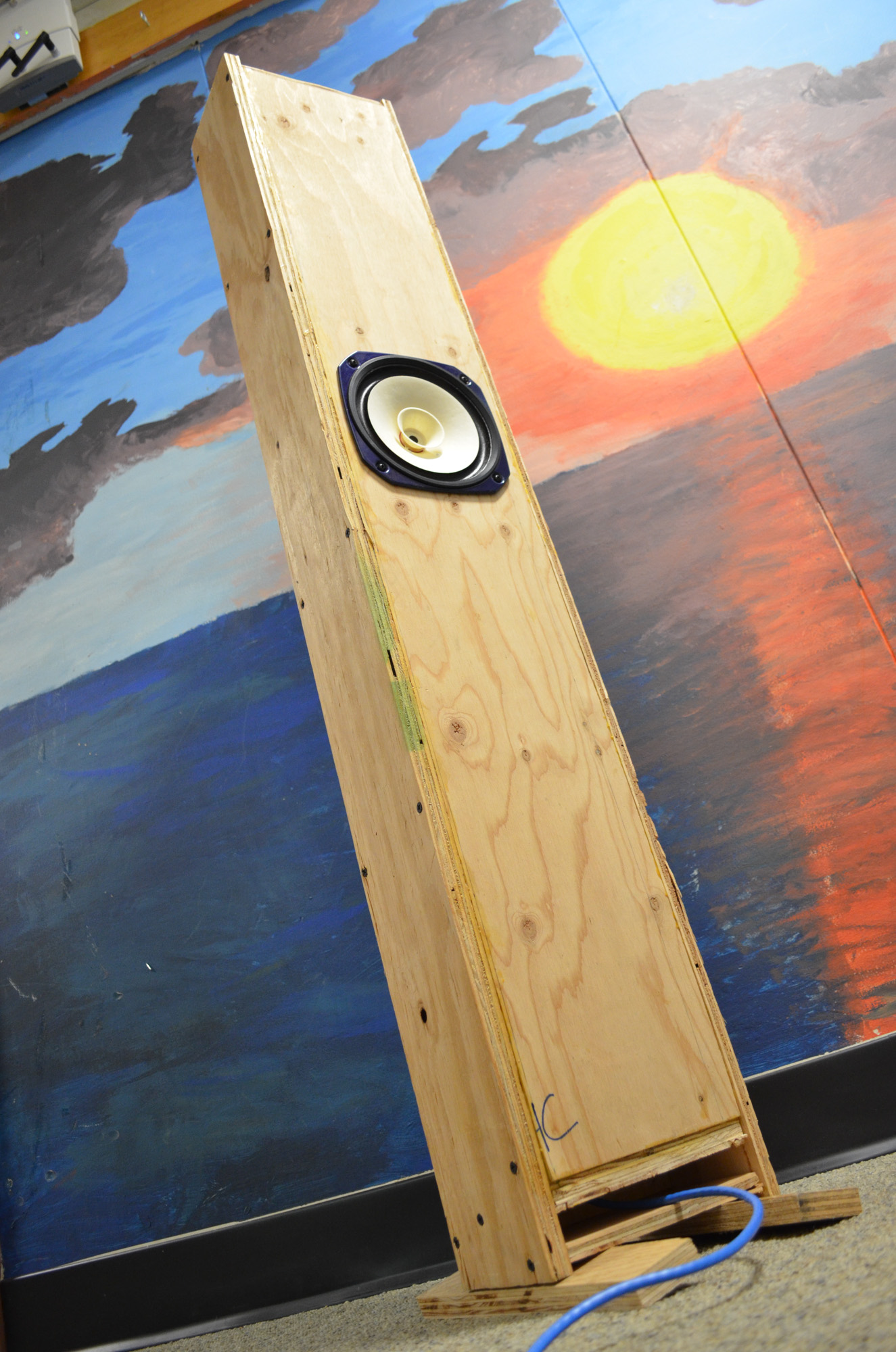

Meet the DGAFs:
As the name might imply, these speakers were the result of a late night at MIT. I designed them in HornResp in about an hour. They are OD-MLTLs, tuned to bottom out around 50hz.
The drivers are Fostex FE166ES-Rs that I have had laying around for a while. They have VERY limited xmax, so the enclosure was designed to be a compromise between depth extension and excursion, keeping in mind that the listening volume is not going to be very high.
The material is cheap plywood (with voids lol) left over from the fort that was built for orientation. I didn't have access to a table saw, and didn't want to wait to use the waterjet, so I just freehanded everything on a circular saw. A good amount of glue was used to seal up various gaps.
These are basically studies in what happens when you take a pretty good design and excellent speakers and then throw all other 'good build principles' to the wind.
The result is surprisingly good. There is obviously some coloration in the 200-500hz range, but the high end and bass is really quite nice. There is a definite soundstage, and they are very listenable.
I plan to build a 2ft^3 sealed subwoofer to hang on the wall behind these things, and I will waterjet that enclosure so it will be an interesting juxtaposition of high precision vs VERY low precision. It will be nice to have the low end support, though they are very listenable without a sub.
FUN FACT: these are the only speakers I have ever made that are partially painted with my blood 😀 splinters...

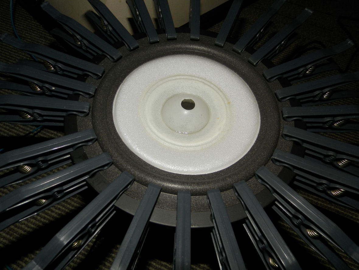

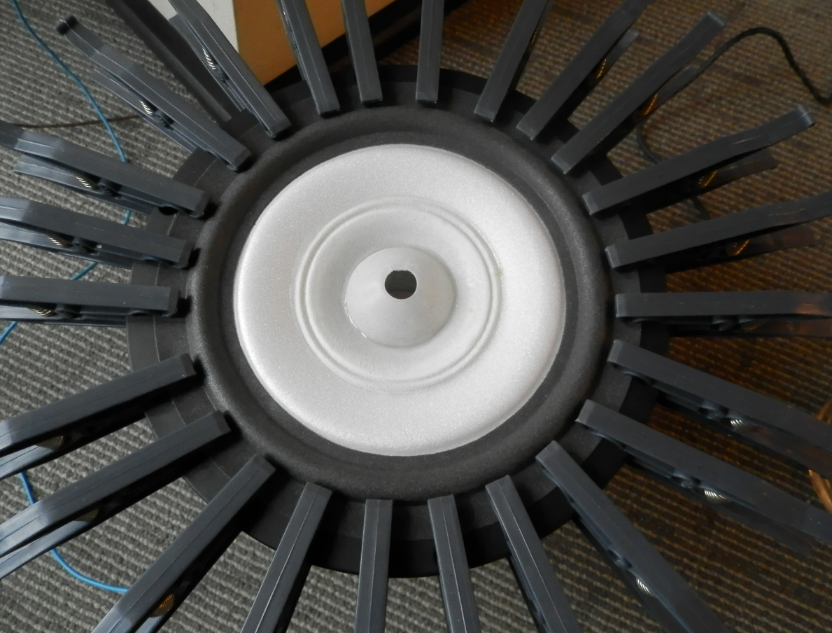

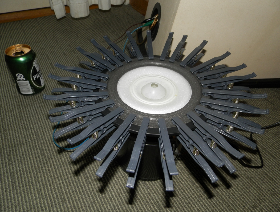

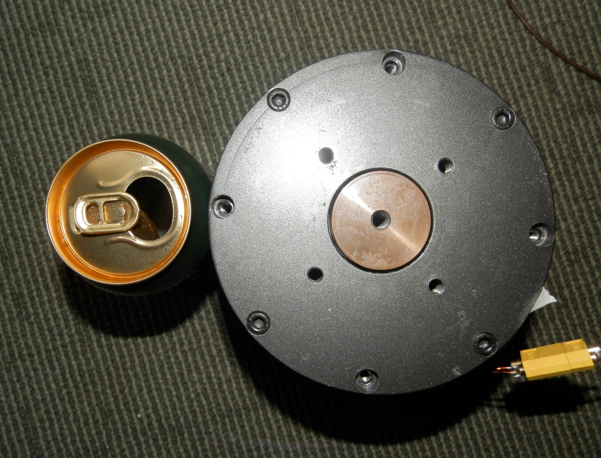

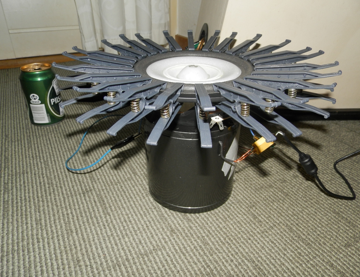

Just something I have been playing with for the last year. It's a DIY full range 6” unit, the plan is that it shall bee used fro 80Hz and op. This has been the best project that I have been working with in years, and the most challenged by far. Here is some pictures.
Take care
Take care
Take care
¿Is it a field-coil speaker? I have always wished to do something like that, but as you say it is extremely challenging. Looks promising...

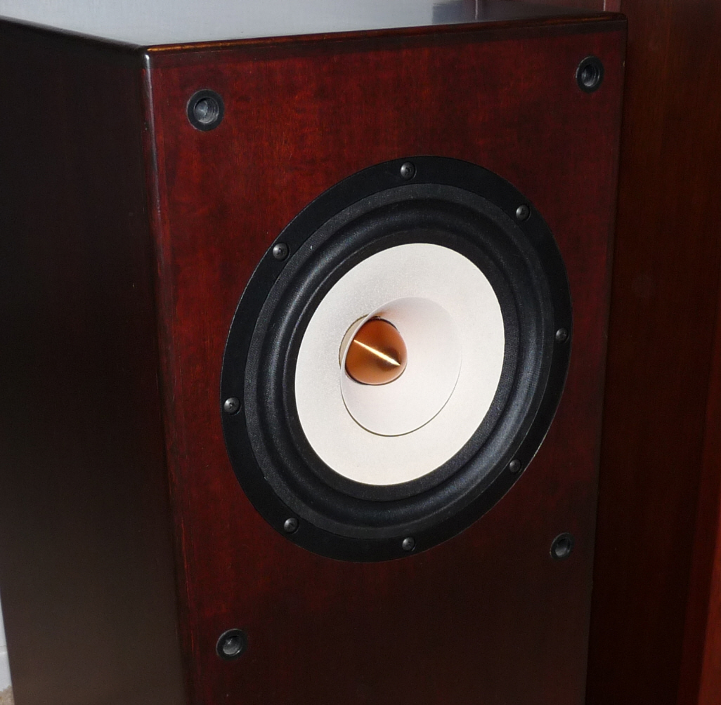

Tang Band W8-1808 8" Neodymium Full Range
I finished these about 1 month ago.
It was a lot of work to get the finish right on the boxes.
I find voices to be sibilant in this 1.4 cu ft sealed box with a 200W solid state ATI amplifier.🙁
They would probably sound better with a tube amp.
They would probably sound better open baffle, or at least ported.
But I am not going to experiment.
I am selling the drivers because I don't like them in a 1.4 cu ft sealed boxes that I built. I just listed them on Craigslist (Los Angeles and Ventura county).
I am going to move on and build a 2-way with these boxes.
