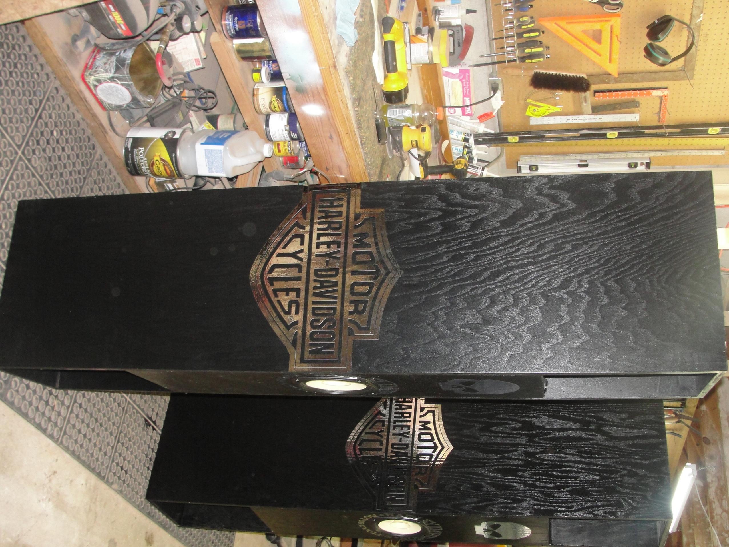

Harley speakers
A pair that my stepson built.

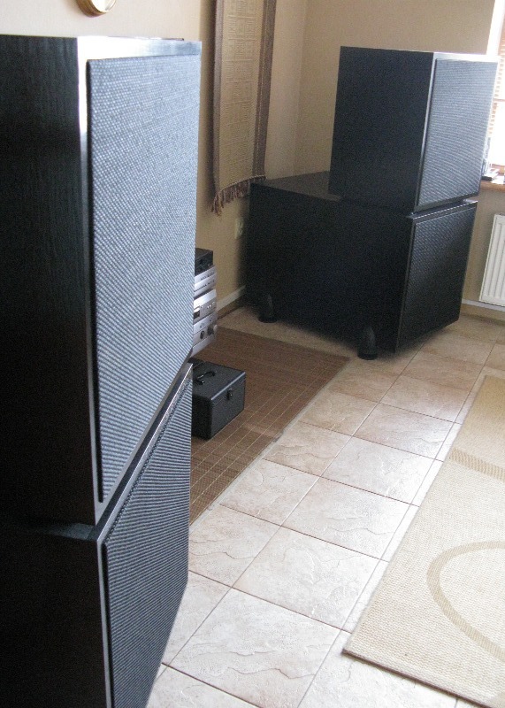

Continuation of the line Karlson Dipol loudspeaker Pilot-II.
The speakers are a modest 21cm in diameter and stand 129cm(+) tall. Sure, they weigh 21,5Kg a piece, in addition they are easy to move and reposition.
Slots provide for sound, deep bass is very simply one of the driest, fastest and cleanest we've ever heard.
Charcoal as all we see are 2 boxes, please tell us which drivers are used, XO frequencies and their sensitivity, ok?
Thetubeguy1954 (Tom Scata)
sonido sfr 175AT + 2 x 300scw sonido, 95-96 db / watt, first order, fullranger from 200 Hz and up. Constant directivity horn.
Low section - labyrynth designed more or less like in the article at my blogspot (see signature).
Front horn - is symmetrical dipole. Mean that the same horn on the back of driver and on its face.
Picture without grills - at previous pages.

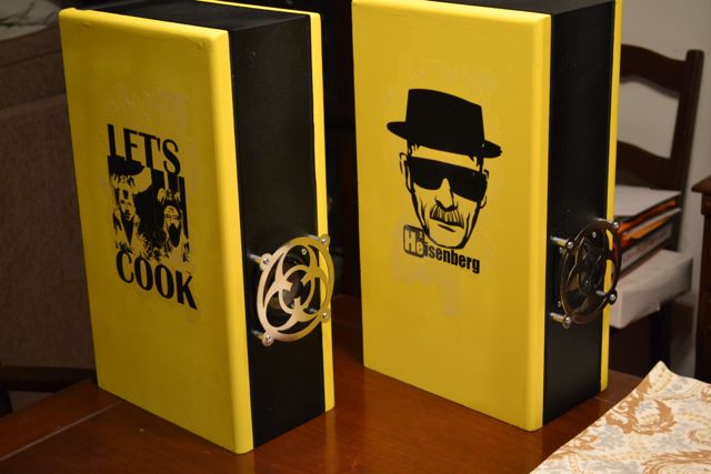

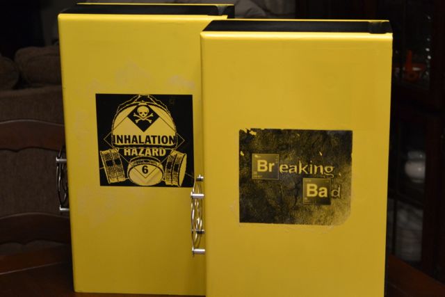

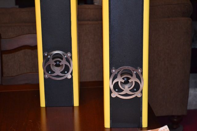

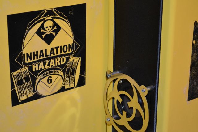

For "Breaking Bad" Fans - Can't get enough of TABAQs!
Folded TABAQ design from Bjorn Johannesen.
Driver - Tang Band - W3-881SI
Cabinet - 1/2" MDF
Finishes:
Yellow - Oil Based (4 coats) Primer (3 coats)
Black - Truck Bed Liner Paint
Decals - Acrylic Gel Medium transfer technique off of laser prints
Speaker Grills - Bio Hazard computer fan grills - 92mm.
