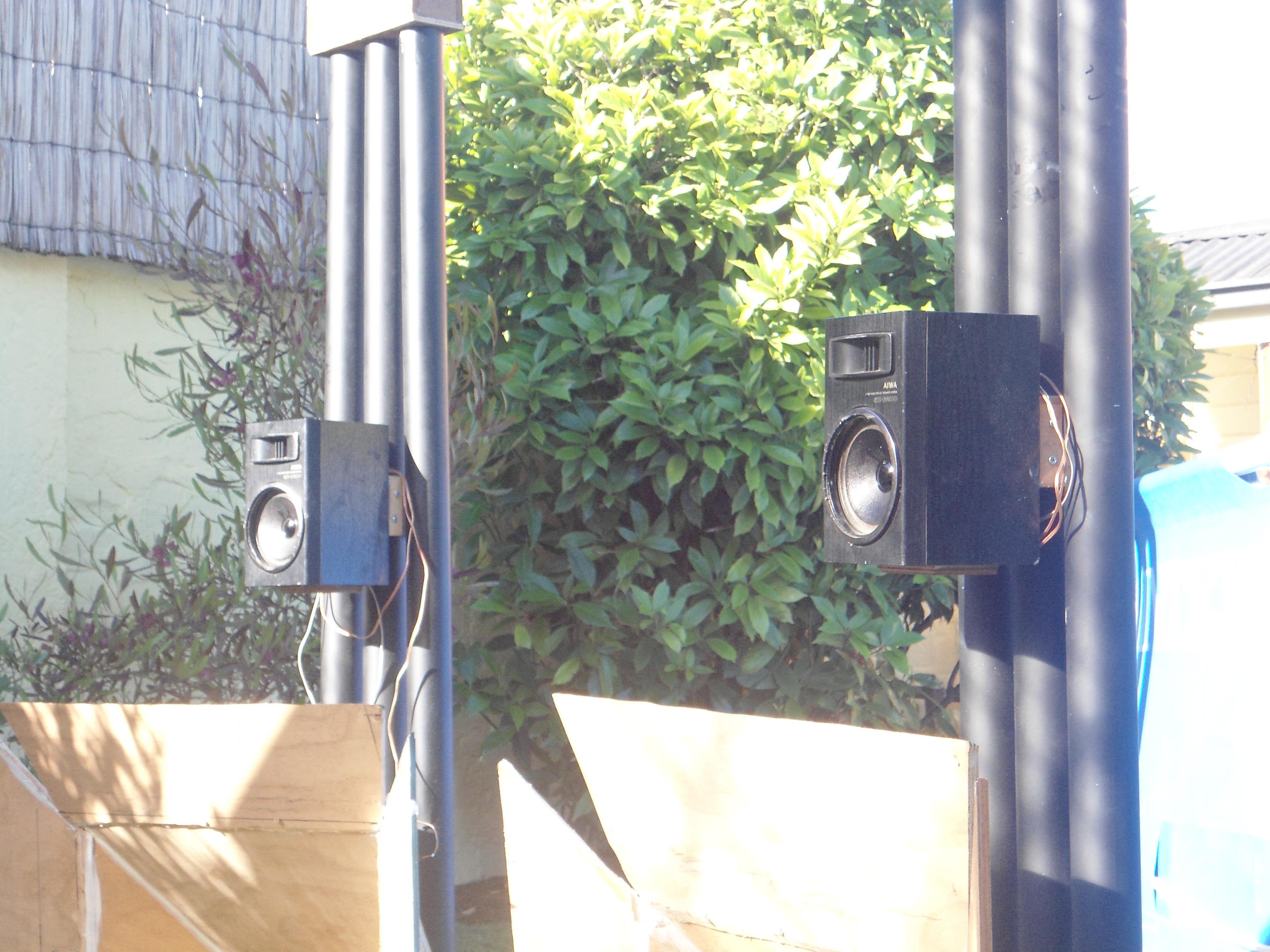

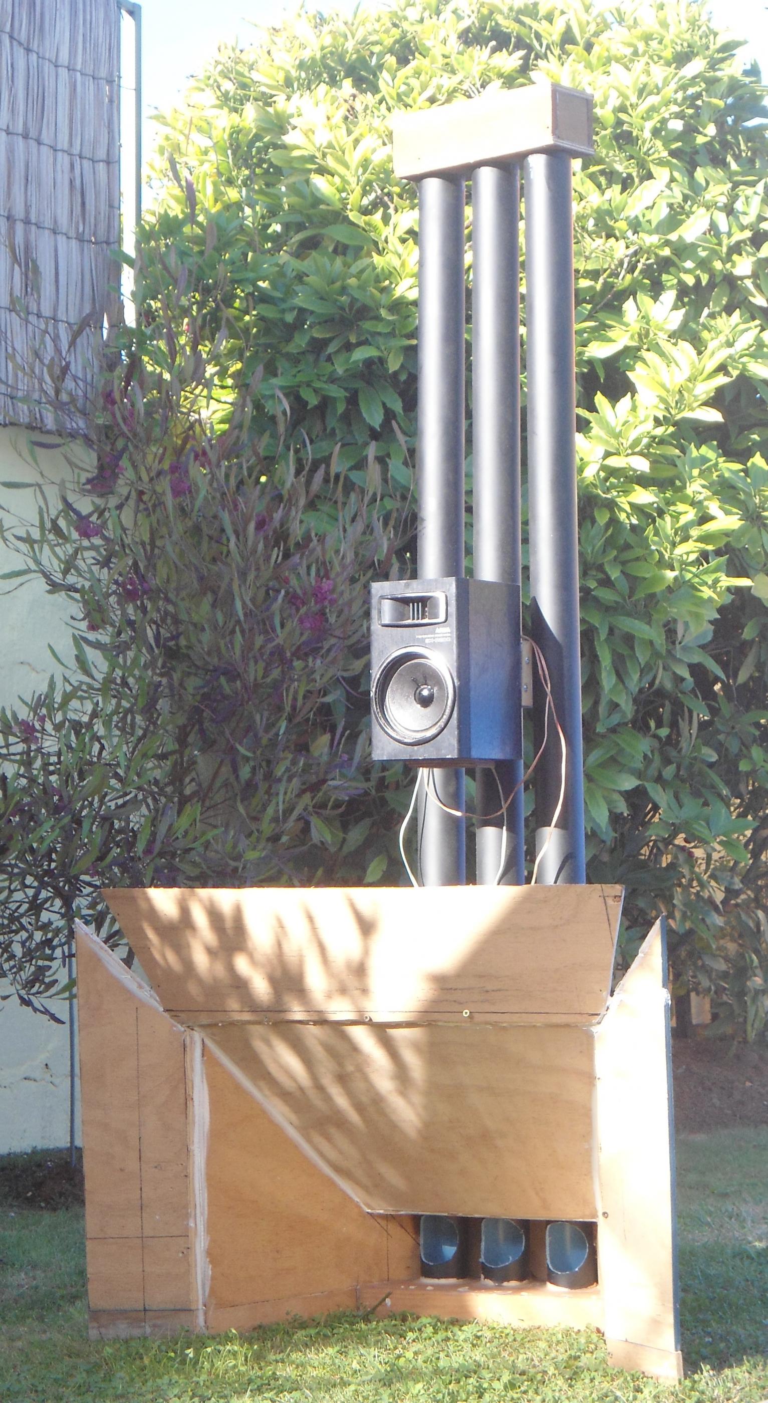

I invented these for my child, with left-overs...turned out to be too big so I kept them for myself.
I am lazy to finish them: increase the bass horn. The idea is to make a nice cabinet for a 6" or 8" Audio Nirvana. Sound really good and image very, very well for a USD30 surround speaker...
I hate square boxes, really.

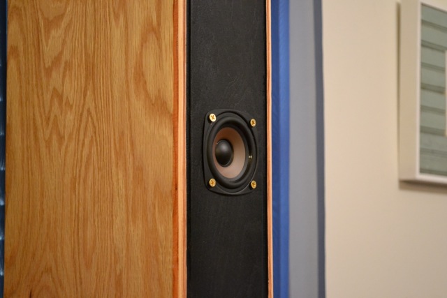

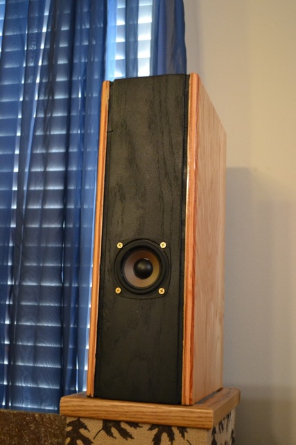

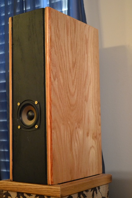

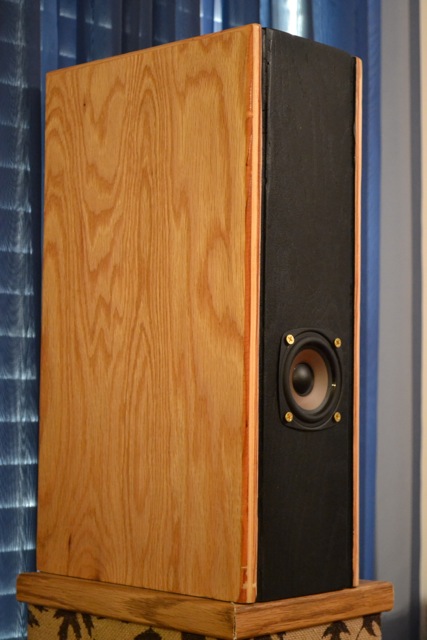

Folded TABAQs with TangBand W3-881SI
Oak plywood
Polyurethane only on side panels
Truck Bed Liner Paint on the black parts. (thanks Bob B.!)
Oak plywood
Nice folded TABAQs, Jhutka! I built a pair sometime ago with a different TB, but I have another pair the same as yours.....I'll have to build another.....
Hi Max,
Could you comment on the particulars of this design? Very interesting!
Best Regards,
TerryO
Hi Max,
Best Regards,
TerryO
Thnak you dear, for your interest.
This idea was inspired by my snobish little brother who loves expensive bookshelf speakers which image well, have a lot of midrange and HF information but lack true bass. I commented him that a real man would make a hole at the back of the enclosure a add a very big folded horn to profit from some LF 😎
I had these AIWA surrounds doing nothing (5"?) and on a previous life I had build that 3 column pedestal with heavy duty PVC: it is supposed to be a HF diffractor plus bass trap but I cannot remember the name of the original...well I made a hole and the back of the enclosure, as I am a real man 😀 and adapted a connection to the central tube, through which the sound wave ascends. The central tube is connected with both lateral tubes at the upper end, which doubles diameter, and then the sound wave descends and is transmited to the wood horn. I decided to use the floor as the "floor" of the horn to win time but now I have to complete and expand the mouth. I would say that the lowest usable LF (Fo?) is around 80Hz now. The advantage I predicted is present. For example, Bach's cello suites sound wonderfully articulated with rich bass harmonics.
As a bet, the central tube has also a hole at the horn end (which can be blocked at will).
I use them with bass reinforced with woofers at present, with active CX at 100Hz.
I can draw a diagram if you so wish, of the present speaker and of the following logical step in design I plan...a tip: a too big bass horn does not exist...always build big.
I hope you like it.
M.
