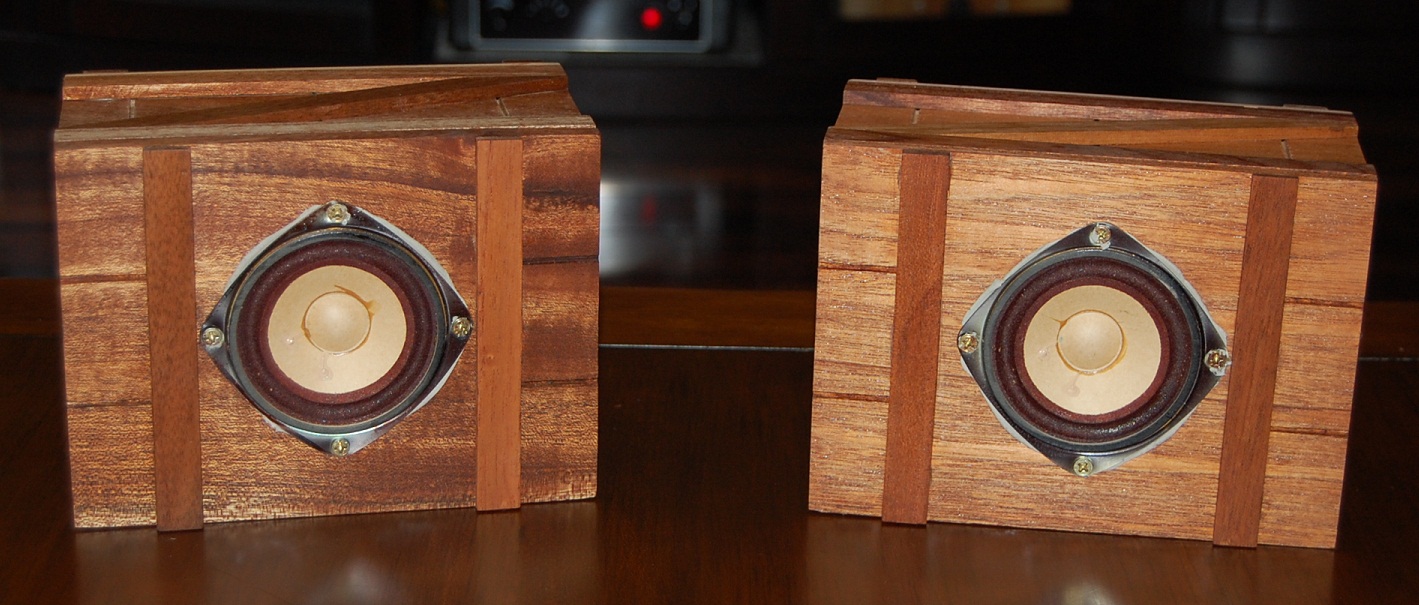

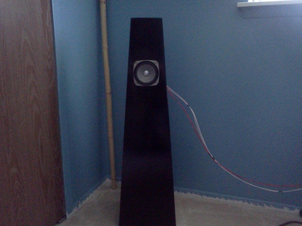

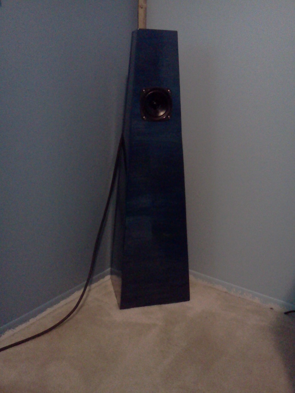

Here's my trapezoid boxes for the FE-126en drivers ( Blue boxes) and the FF-125wk drivers in the (Black boxes). This box design is still a work in progress after a year and will be in-till I get it right 😕. Jeff

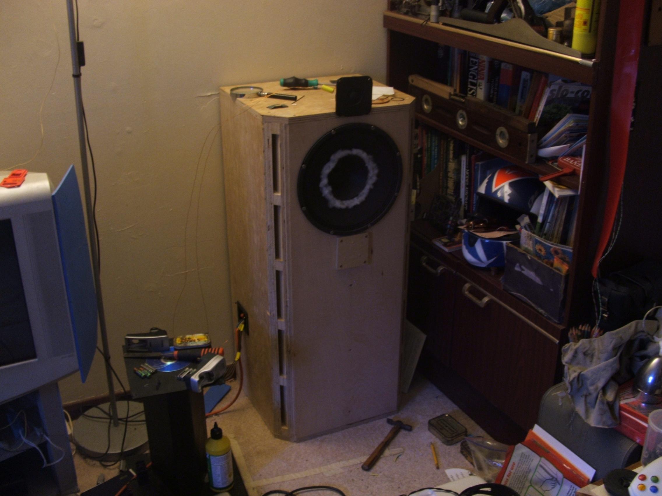

Here's one of my P10 EmKen beta build 'speakers - none too purdy but mightily mind blowing🙂
A second far nicer pair are on the way at my GF's insistence after they got thrashed at our house warming party (pic taken in my man cave flat)

A few details:
Planet10 EmKen - Only 3 pairs made (so far?), each pair being unique.
Size: 40 inches tall.... the rest you can guess.
P10 'Fonken' enclosure made from 18mm WBP ply with removable back and adjustable resistive vent length, currently set at maximum, damping is currently a mixture of thick upholsterers felt and...... no less than 7 oldish towels.
Mid to High 90's efficiancy.
Frequency response: They go as high as the 12Lta can and I dont know how low, but low enough to get the job done.
Drive unit: Eminence Beta 12 Lta - Caulk damped magnet/basket, felt on inside of basket legs, basket grounding, dust cap removed, custom phase plugs and pluffed whizzers----12Lta's need A LOT of run in time, mine had near 100hrs in free air and a few thrashings in cabinet (parties - every time they return home they sound better and Hotblack Desiato was made proud 😀), day in day out music playing / being gamed through and till they are run in, I am postponing EnAble.
For me, the single wide range driver per channel concept works, the losses are totally out weighed by the gains. Some times there is a feeling of a lack of solidity in the lower end of the cabinets tuning and I am looking into a remedy for this.......... no doubt (read 'I hope') it / they will be large and equally as scary :devily:
Thanks to Dave / P10, JKRO (phase plug sorter outer), Matt the carpenter and a numpty who managed to put himself out of busyness unaided.
