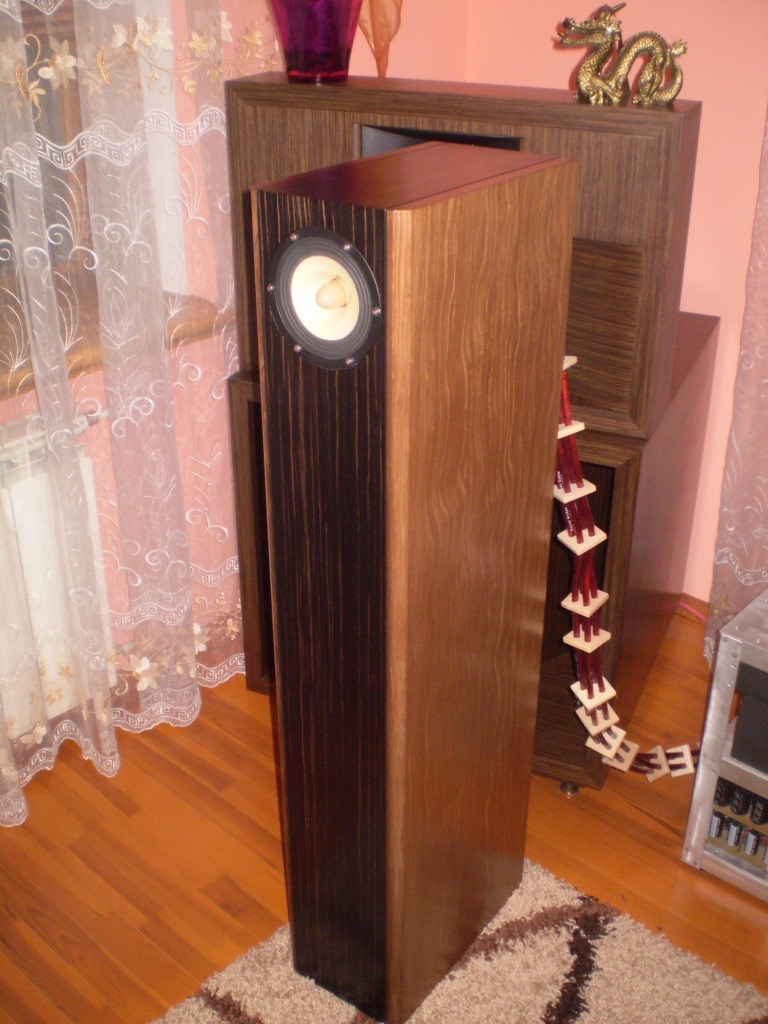

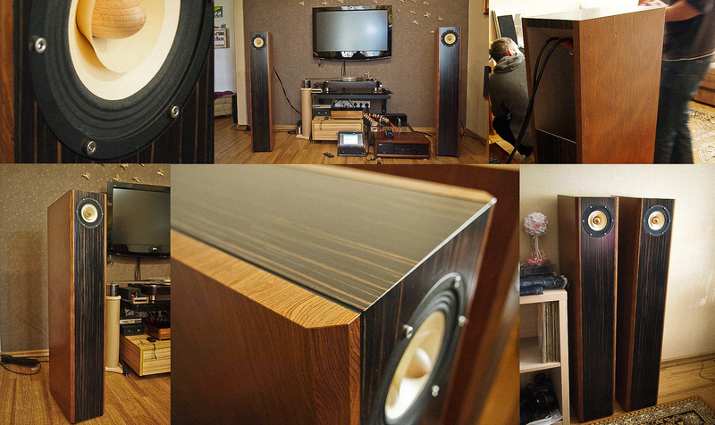

BLH on sonido 145SFR alnico. For 5inch fullranger awsome bass and scale.
Drawing is availble at sonido.hu for DIYers.

Thanks) It is so called (in Russia and Ukraine) "anti phase line" cable. I did not go into details how and why it really works, but it works.
Principle like this:
1) if you have figure of square in cross section, each of four cables is in its corners.
2) left down corner ant top righ corner are both + for example, than others are -.
3) distance between cables should be minimum 3-4 diameters of one cable itself
Works like more clean and transperant sound. than the same wires in normal way.

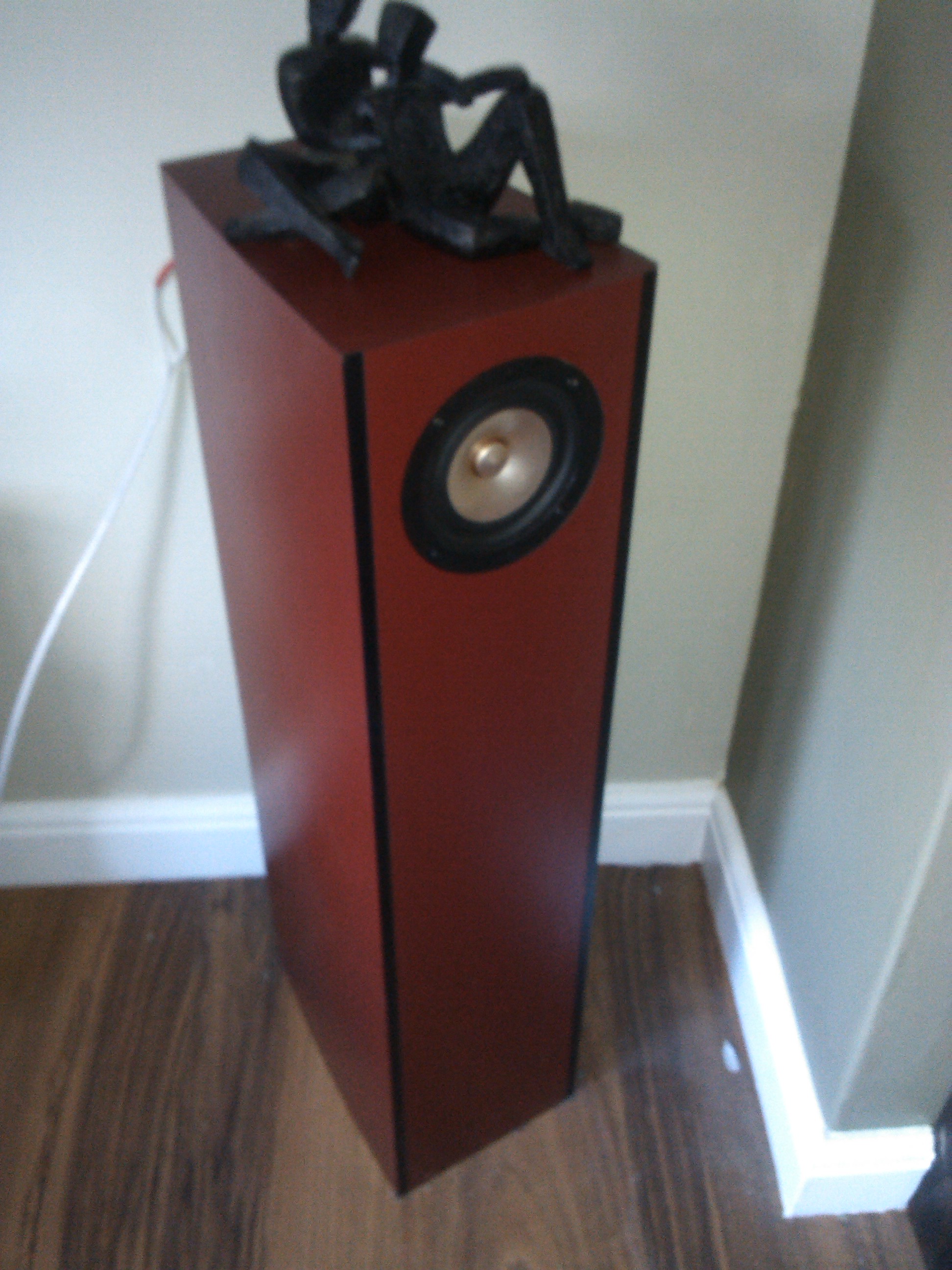

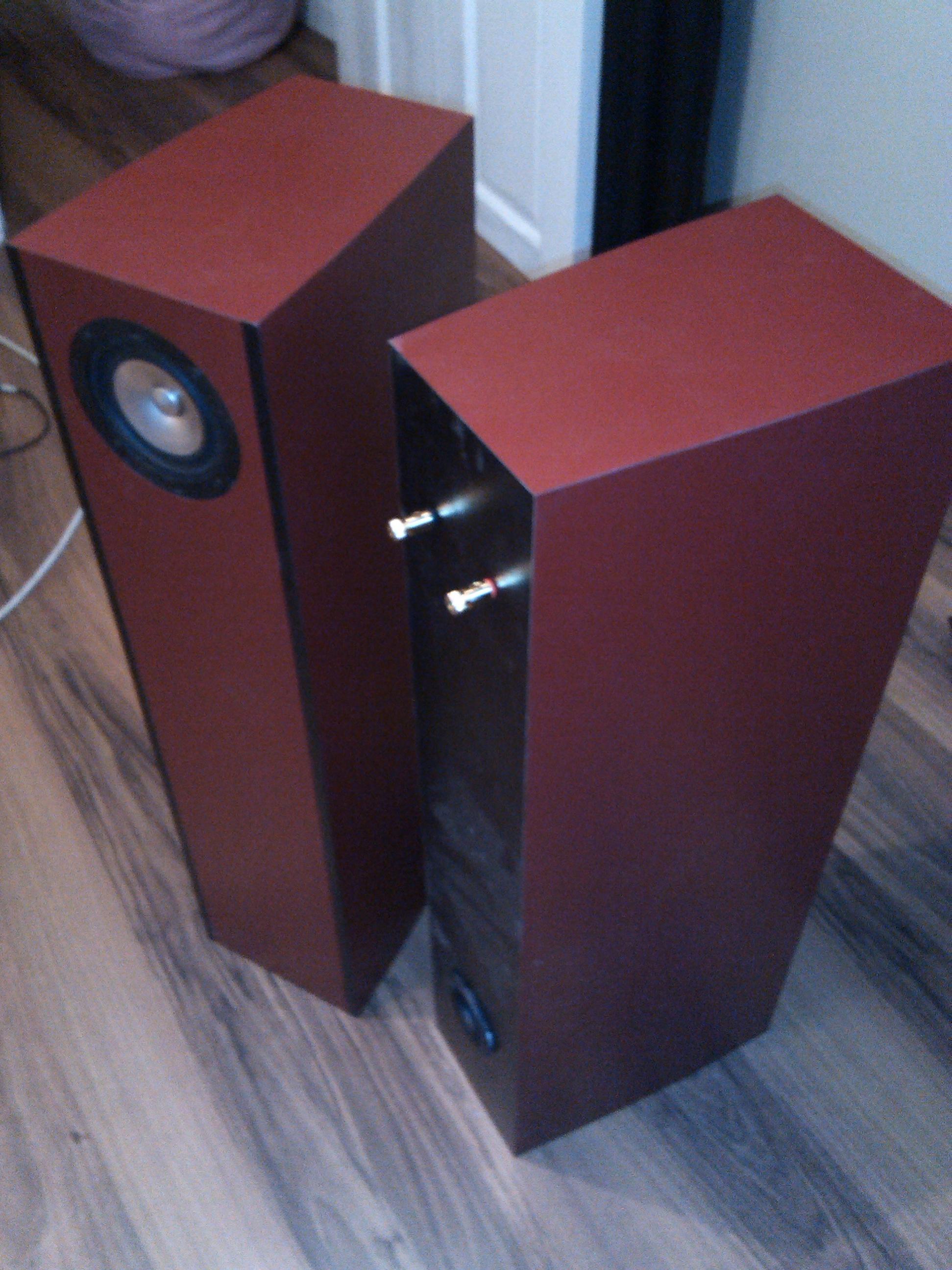

Hi all,
May I present my speakers I built two years ago with birch plywood..
Driver are Audax (french brand) AM21LB, 8 pouces fullrange.
It's MLTL, port firing at bottom, and adding a variable BSC.
