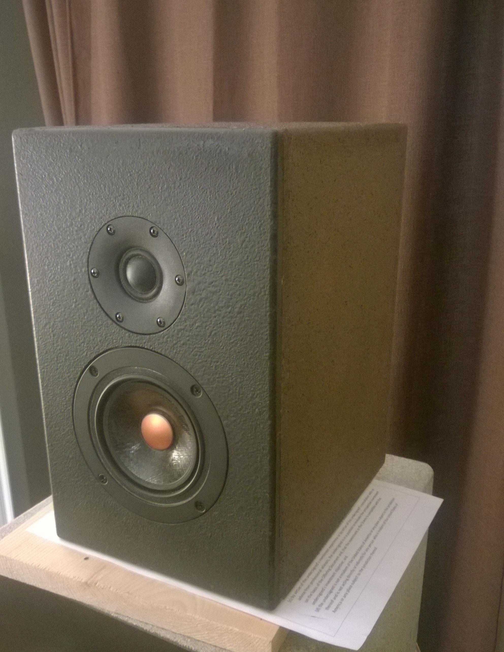

I'm just getting my feet wet with full range drivers but based on my recent experience, the Pluvia 7 at $45 USD each would fit your requirement.
In comparison to a 2-way speaker I built for somewhat more money, a Creative Sound V1 ported). I do not feel any major lacking in the Pluvia 7 build. The V1 hits a bit harder in the bass (with more X-max) with better dynamics and the highs have more air but I feel like the coherance and "wholeness" of the Pluvia 7 is a bit better. For harder hitting purposes (home theater, more aggressive music) I would lean towards a 2-way system but for more laid back, simple music I prefer the Pluvia 7 build.
It had the advantage of being cheaper (V1 was about $220 CAD to build, Pluvia 7 build about $140). If you really made me choose between the two I'd take the V1 but it's not an easy choice, and if your application and budget are more inclined towards the Pluvia 7 I'd imagine you'd be quite happy.
