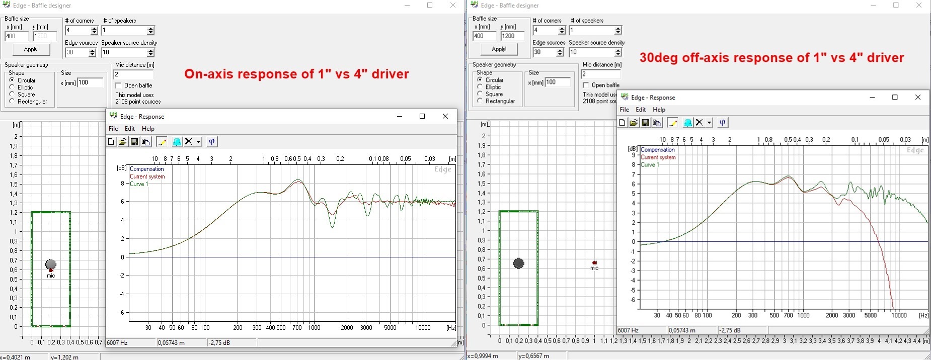

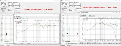

That surprises me.
I expect a dome tweeter to light up the cabinet edges, but not a 4" full range driver.
But, I may be wrong.
I’m no expert and as I mentioned earlier… I’m understanding enough of this to be dangerous, but this calculator helps illustrate wavelengths at different frequencies. At a certain baffle size (really large) it would seem it becomes less of an issue, but I do think it’s important. I assume that’s why a lot of speakers are designed the way they are. The baffle is either really wide or really narrow. There aren’t many cabinets with 6” drivers and 12” baffles because it appears that area becomes problematic. The baffle is either slightly wider than the biggest driver or a lot wider than the biggest driver.

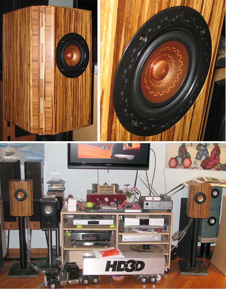

Dave wasn’t your choice for wood bamboo plywood for your boxes? They were so Beautiful to look at. Here’s a picture I hijacked from audio circle. (I hope it’s okay Dave).
P.S. To much Eye Candy. 😵‍💫.

Seeing radiation angles for driver size, say an 8" being 90 degrees at 2khz, I don't see how past 2khz (on an 8") that rounding would do squat.
I can see a 4" doing more than an 8", but I'd like to see some charts.
Even rounding for a dome tweet, you need a bunch, like 3/4"

People are shipping hemp based building materials, but the potential is just strating to be tapped. I haven’t seen any hemp-ply yet.
The stranded bamboo outer plys are bamboo strands in a matrix. These are 3mm thick. One should be able to take 5 and make their own 15mm plywood. It should be exceptional.
The idea is the same with hemp. But the fibres are longer in hemp (and maybe stronger), if one could harvest that, orient it, and press it together with a similar matrix (which you might be able to make from the soft parts removed), then make plywood it would be very interesting.
Hemp grows almost anywhere, and improves the soil… i imagine sections of 20 foot high hemp growing in Saskatchewan…
And it is useful to make a zillion things. We just need to figure them out again.

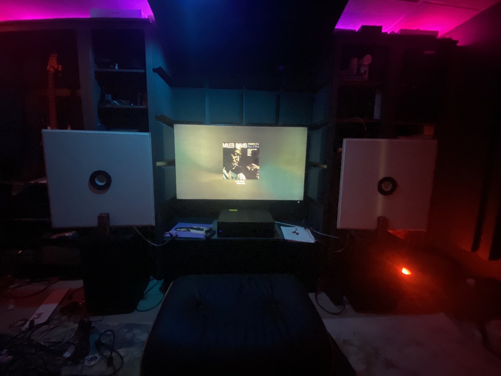

Hit my 100 hours laying on the magnets and decided to cobble together an open baffle out of wood clamps and ceiling tile. And they’re perched directly on top of subwoofers. For lots of reasons this isn’t ideal not the least of which is that this room doesn’t lend itself to an OB configuration, but I must say that they’re already doing a lot of things better than the ls50 metas. Plywood is being delivered tomorrow and then I’ll get to work on the 16L sealed enclosures.
