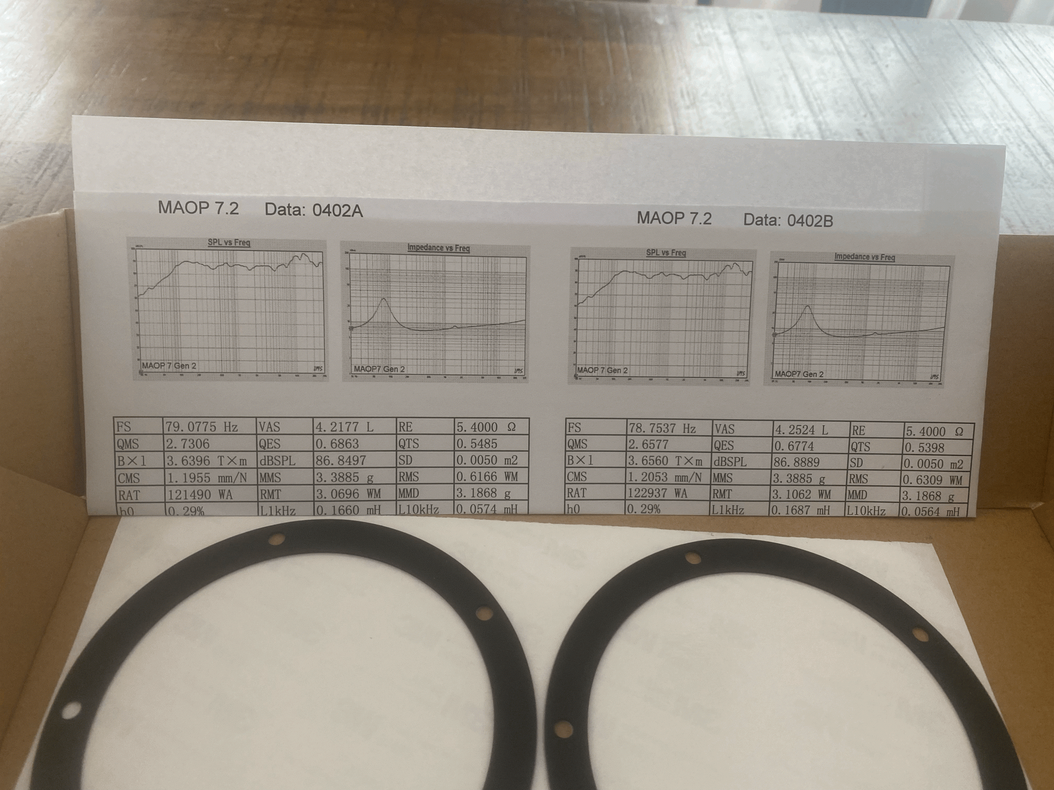

https://www.markaudio.com/wp-content/uploads/2021/11/Alpair12P.pdf
please note on their graph, that those lines are 4db apart.
So you are +8db 2.5-3khz, then down, then up 6-7khz also.
And a bit of zing also maybe at 12k.

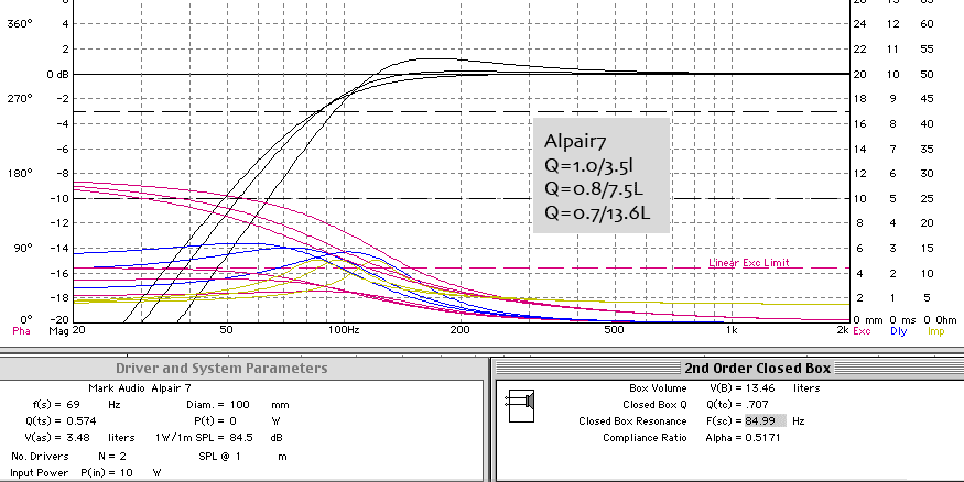

- Full Range
- Full range sealed box design
