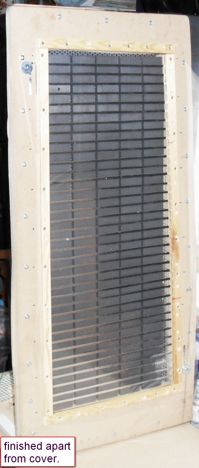

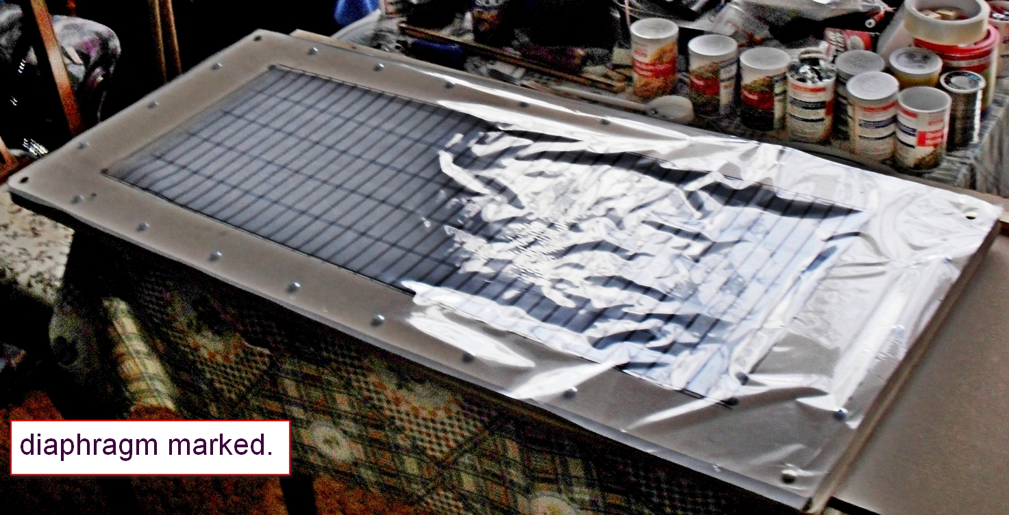

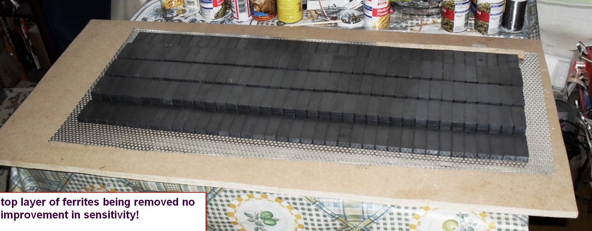

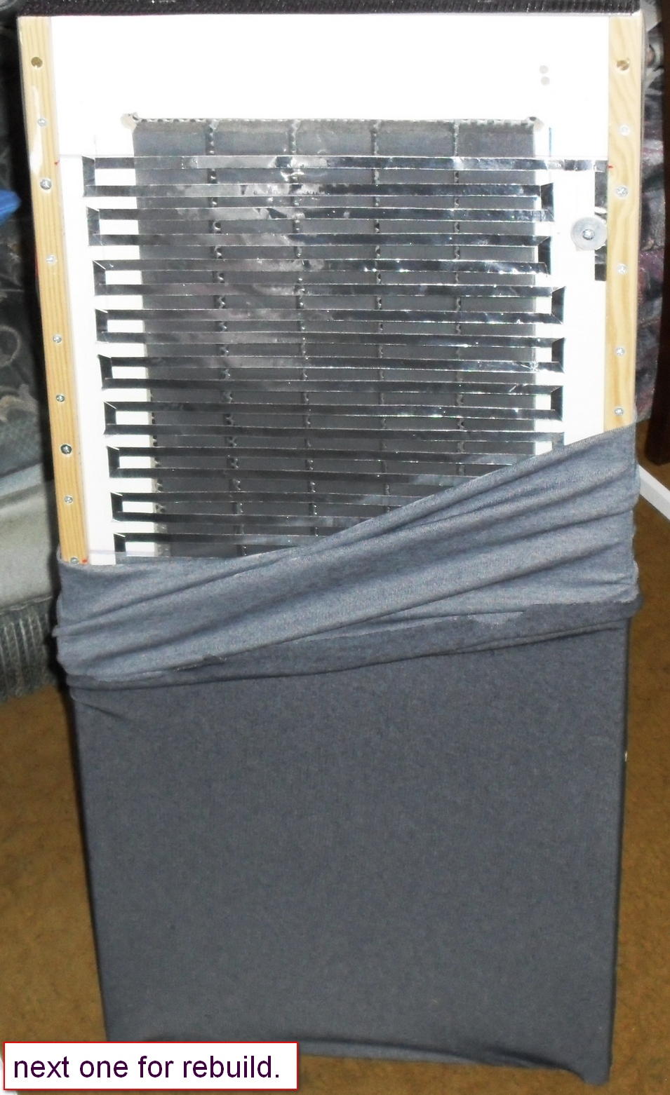

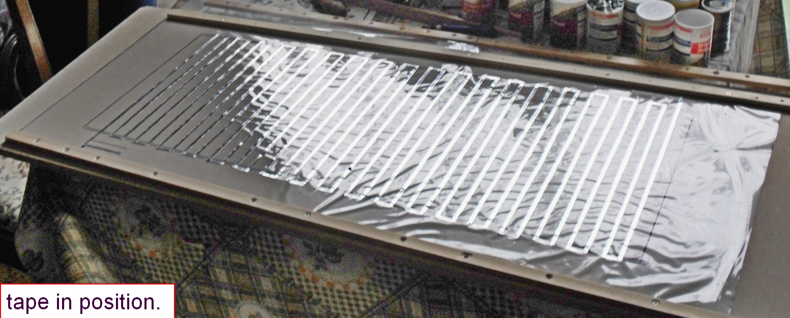

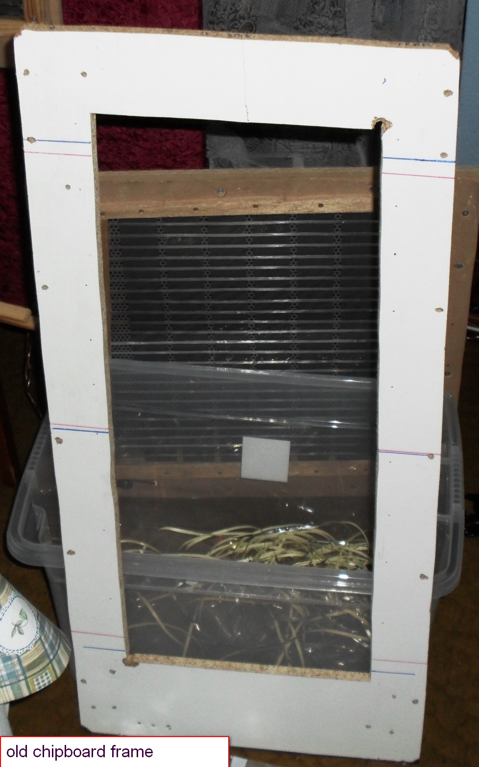

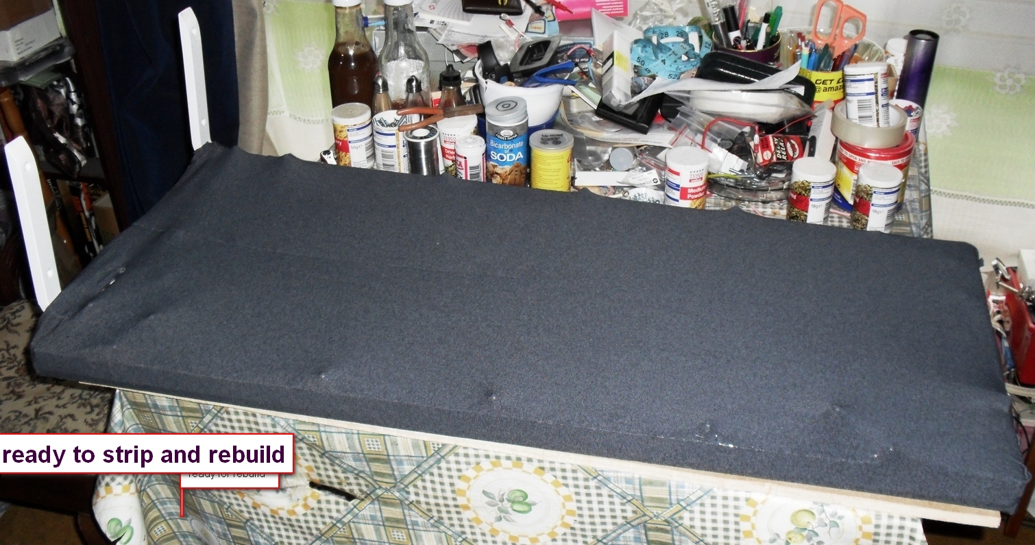

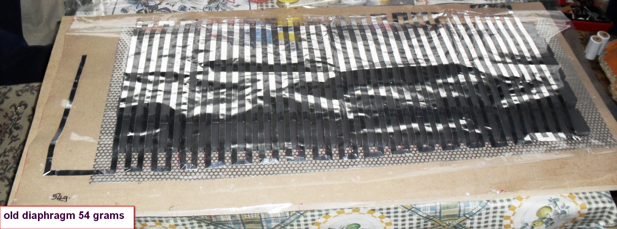

A few more pictures of my latest rebuilds and redesigns.

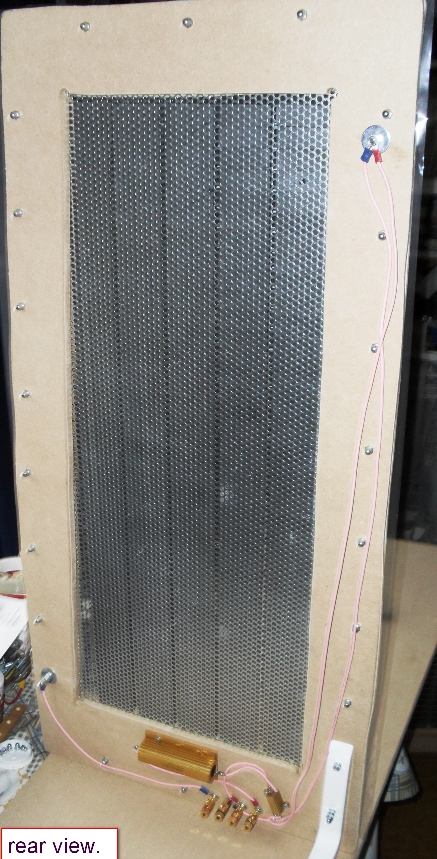

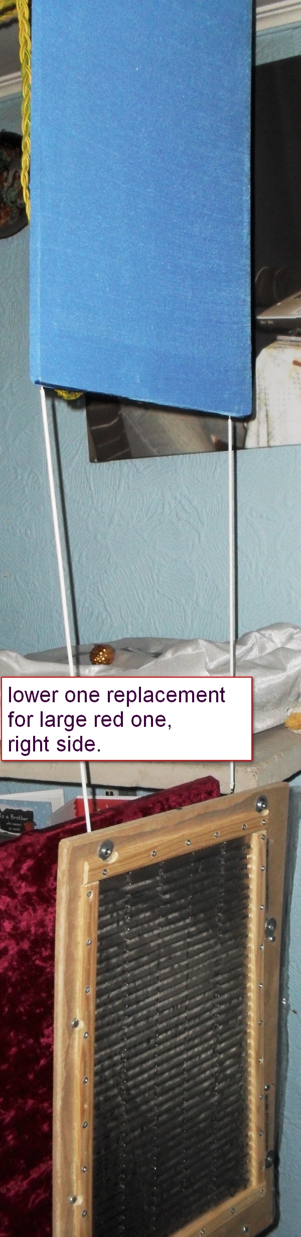

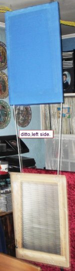

Continuation of the rebuilds redesigns etc. The ones hanging under the blue ones sound much better than the red ones the suspension in the air helps!

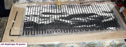

Thank you Rembrant, for those kind words. I have never thought of making full range planar headphones.All my magnets are too large, although I have some 25 x 5 x1.5 mm neos about 42 of them. I think these were the first neos I bought many years ago.i suppose I could have a go! Although when you have 11 60 x 40 full range planars all round the room, it is almost like wearing headphones anyway.

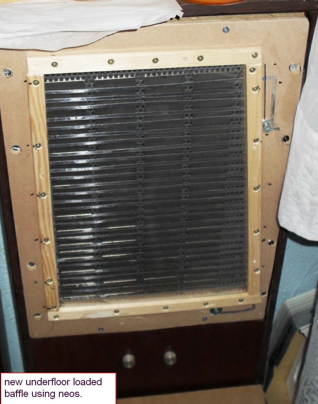

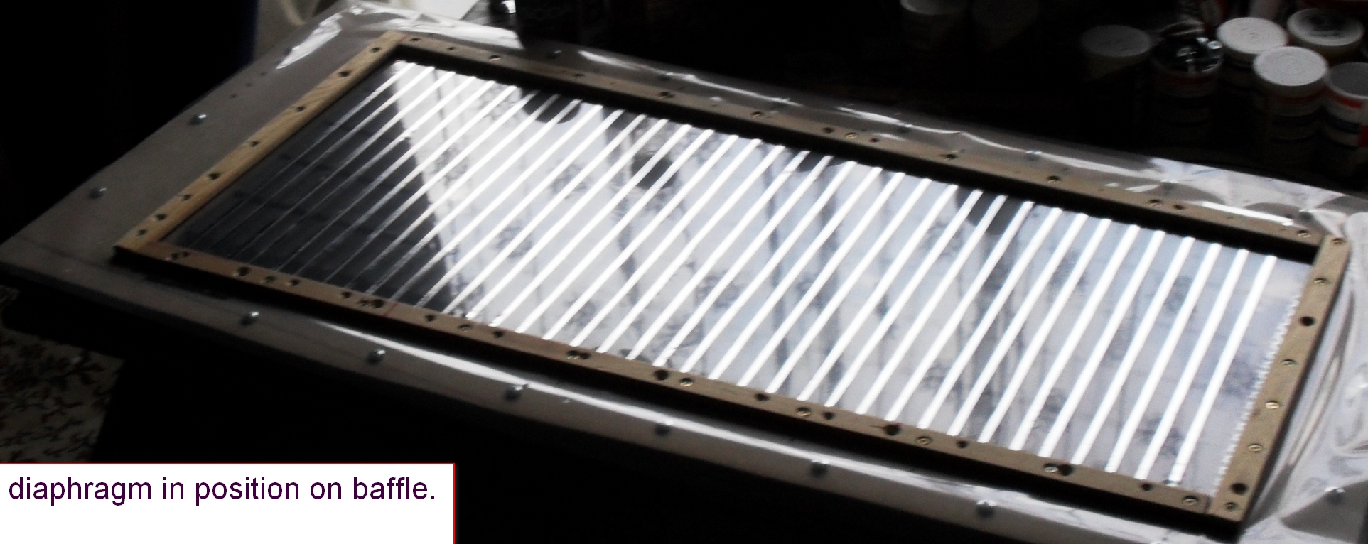

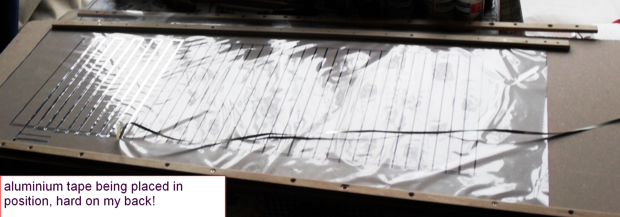

I don't think neos were available when the Apogees first came out! You can build a small 60 X 40 cm speaker using neos. This size is my latest design, as bigger ones were not really any louder than the small ones. A 4' x 2' was not really worth the extra magnets. I would recommend you use 50 x 6 x 3 mm magnets and use 3 mm wide aluminium foil. This would give you the highest sensitivity and would fit in with the size of the speaker.If you can't find any foil this size use scissors and cut it to this size, that is what I do. I must have cut about 450 meters up to now!!! I'm afraid magnets have increased considerably in price in the last few years.I got mine from China as this was the cheapest I could find, although the postage is quite high they still worked out cheaper in the long run. Although I don't know if this is still the case, as I have not bought any for quite a while!

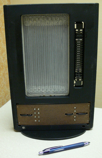

What about building something this size..
Anybody has tried this size?
I spent more time at the computer than at the "listening room", as many of you are..
Magnepan Mini Maggie Desktop Speaker System (Playback 48) | AVguide

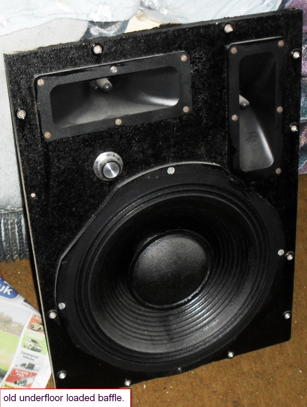

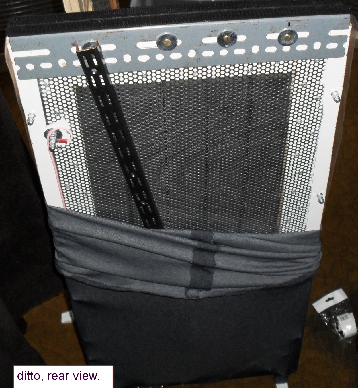

The smallest FRP that I have built up to now is 14.5 x 20 inches, using 116 50 x 12.7 x 3 mm neo magnets in each one. I built these to fit a underfloor loaded speaker which used 1 18" cone and 2 piezo speakers.I built the planar to try out the small size,in comparison to my 60 x 40 mm size of which I have 11 hanging up in my living room with my new 9.1 amp. I'm glad they didn't cost me 1500 a pair or a trio.
