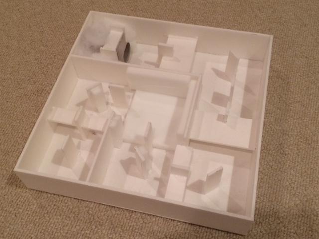

I had an hour to spare and here is where I am so far with the wall mounted MLTL for the A7.3. In order to make it fit on a standard 20x30in sheet of 3/16in $1 store foam core, the size was reduced a tiny bit to allow both front and rear baffle panels to be cut from a single sheet of foam core. Internal widths for channels ended up at 4.8in instead of 5.0in. I got bracing in place, foam behind driver, and paper towel tube port installed. Note shown is the spring-loaded terminal cup mounted on same side as port. I am now waiting for glue to dry on capping operation. When I return from travel in a few days it should be set - I used Liquid Nails (low VoC) to cap the front baffle on this time. The adhesive is nice in that it is a great gap filler like caulking but is very strong and a light putty color that blends well with white foam core.

Very clever and quick! So if I've got this right, because you've narrowed the channels you will have to build the box a little deeper to maintain the cross-sectional area? For my build I'm assuming that if I keep to a cross-sectional area of 13.75 sq inches for a vent 45" long with the driver around a third from the closed end then I can make the vent more or less any shape I like. Is this correct?

Yes. Just keep vent CSA and length the same. For my box, I will raise tuning to about 60Hz to increase bass SPL to compensate for any baffle step losses. So I will keep box depth at 2.75in.

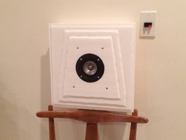

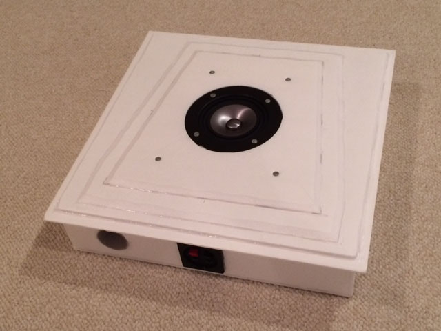

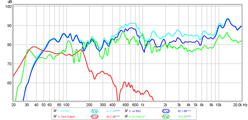

Flat A7.3 MLTL Completed
I added a second layer of foam core on the baffle with liquid nails for CLD, then added two more layers to rebate the bezel flush to reduce diffraction. The last two layers are a trapezoid with beveled edges to reduce diffraction to the maximum extent.
Completed speaker:

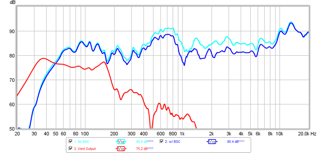

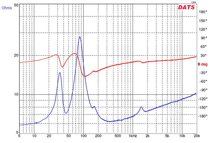

Impedance Measurement shows port is tuned at 44Hz (too low) - the min between the two peaks should be around 55Hz to 62Hz. I will have to surgically go inside and shorten the tube. Something is off with the tuning - maybe because I took off the secondary magnet cup to allow more breathing room behind driver and the higher Qts drove mass tuning lower?
Here are measurements with speaker flat on floor with mic 0.5m away. I added 1mH + 5R + 3.3uF BSC circuit I had lying around to flatten the mids some more. I think the excessively low tuning made the bass very low in SPL. Vent measurement is relative only (mic 1in away from vent with very low drive level). Th 700Hz hump is probably the baffle diffraction from a 16in square baffle. Maybe make the speaker a trapezoid the next time, or at least a rectangle to reduce diffraction bumps like this.
How does it sound: a bit bass challenged for now - so some tweaking will be in order. The overall sound is still very good for casual listening but a bit too much treble for me. Might need to remove that 3.3uF high pass cap.

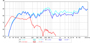

Once mounted on the wall (40in high) and at listening position 1.5m away, the sound is a lot more balanced and the room gain boosted the bass somewhat - it sounds much better on the wall (green) than on the floor pointing up.

Cool little project. Thanks for posting. Have you tried a shorter vent tube yet? IME ML-TL are very tune-able enclosures.
Based on the FR, perhaps losing the 3.3uF entirely would be a good idea. Maybe try a bigger choke and/or smaller R. Looks like about 6 ohm impedance at the start of that bump from 500-900, which would indicate ~2mH, but this might be too dull. Perhaps it'd be better to straight wire them and use digital EQ instead.

Yes, I cut down the vent to 1.0 inch and it is tuned to 50Hz now - much better. About 2.5dB more SPL at 60Hz which makes a difference. It's strange but I normally predict the vent lengths much more accurately than this. Not sure what is going on. I will lose the 3.3uF - just snip it off with wire cutters.
Like the trapezoidal baffle - adds something to the looks, a bit Art Deco:). I'm not sure about CLD using liquid nails, doesn't it dry hard? I was going to do a double skinned baffle and use green glue for the job which doesn't set.
I don't have the means to measure mine but in general I'm happy with the balance so I'll be sticking with original port size during rebuild.
