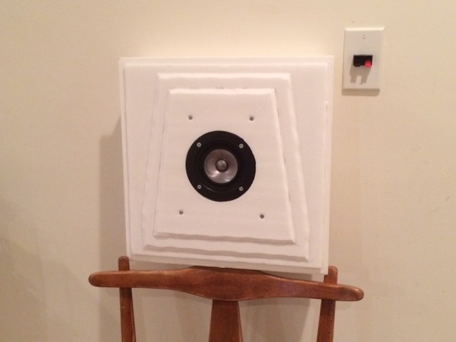

The pic a couple of posts up is mine, based on XRK's design. It works very well and has a delightful synergy with the little SMSL 36A Pro amp making an excellent study system for not much money. Thanks again XRK.
Ian, have done any measurements? It looks like you are using suggested 4inch / 10cm tube. I will probably make that adjustable for my first prototype, but some starting point is still needed 🙂
I can't remember the exact measurements but basically I kept the same lengths above and below the driver as XRK's plans and simply folded it slightly differently. I did put some sound absorbing felt behind the drivers which I think helps. Good luck!

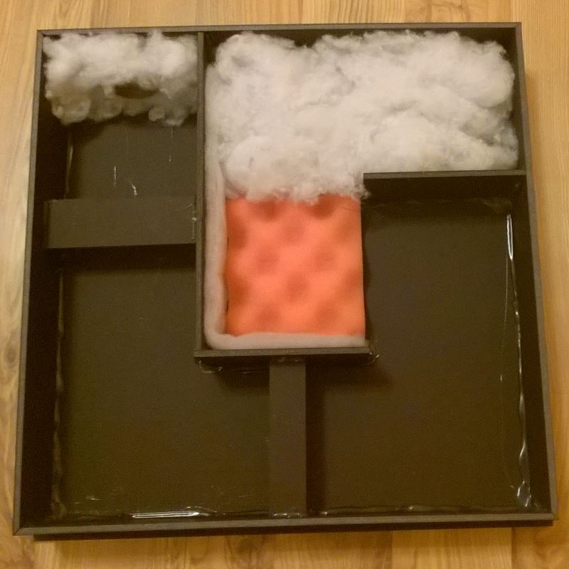

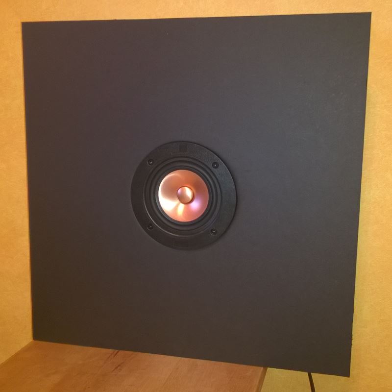

Finished my first prototype. Aesthetically it looks quite good, sound quality is worse than the BR enclosure of the same volume 🙁
I'll try to add some more bracing and will try a longer tube sometime soon.
Nice build - what I noticed was that the SQ was better with a shorter vent vs longer. About 1.5in long brought the bass volume higher. What don't you like about the sound vs an equivalent BR? It should have less baffle step than a smaller prismatic box of same volume.
BR has way more bass, but maybe it has something to do with how I attached the top (front) layer. I've used black silicone, which I've also smeared between side walls and front/back panels. Inner parts are glued with hot melt. The good thing about silicone is that I was able to remove the top easilty by cutting and peeling it off. Next time I'll probably add a paper layer beneath the top and glue it with PVA. I'll do some proper measuruments as well.

Sounds like you may have had a pinhole leak on the inner channel - that will collapse the 1/4-wave and reduce bass.
