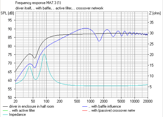

Yes, as soon as I have some time. I only have one driver so just one unit. We will see if it hits the 45Hz mark and how much distortion that is. I think it might be fine for lower SPL. Being wall mounted eliminates baffle step losses.
One thing puzzles me: the driver is placed exactly in the center, how comes the simulation does not show any comb filter effect?
The sim was mostly to predict the bass performance. The diffraction due to baffle edges was probably not turned on. Besides, a 15in wide baffle is pretty large to minimize that effect which is normally minimized with an offset placement. You have to remember that the response of the driver is not flat (not pistonic) and in fact, with A7.3 is not anything close to flat as far as full range drivers go. I show the higher frequencies mainly to see that the bass is level matched.
I see. I made a simple simulation in Boxsim in 10 ltrs vented enclosure tuned to 55 Hz, and it shows some pretty nasty comb filtering due to the baffle. Boxsim however can not simulate wall mounting (or a MLTL, for that matter).The sim was mostly to predict the bass performance. The diffraction due to baffle edges was probably not turned on.
If ultimate flat response is what you want, an offset driver location will be better. It won't look as good though. I might as well make it rectangular folded rather than square. Simply refold turns to have same length. If one makes it deeper the. Width of channels are narrower and it becomes a rectangle. Put driver at about 1/3rd from end - near top and offset by 3/4in or so should get rid of a lot of baffle edge diffraction. I will probably make foam core square as first case in any event.
