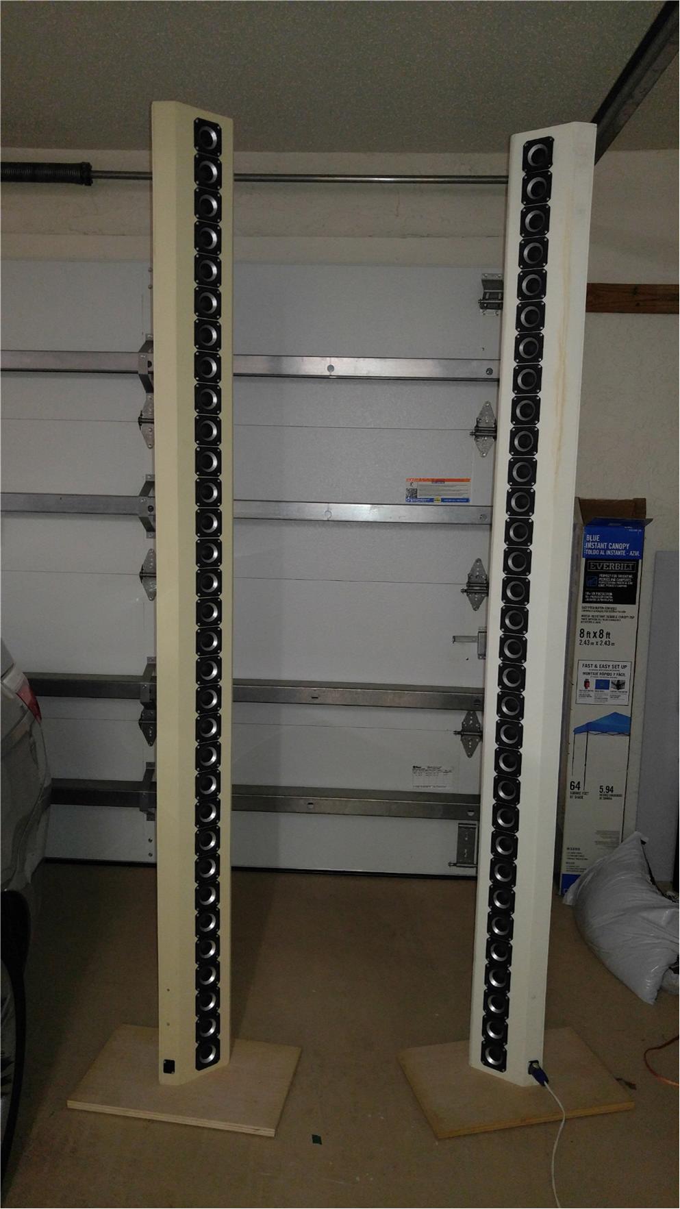

Congrats... Looks very cool.
You are in for some surprises once you get them fired up, I am sure,and pleasant ones at that.... ;-)

Yeah, I've stretched out this build about as long as I can🙂
In the meantime I've built all new cables and run them along the ceiling for a more permanent installation and had to rewire my rack a little to support the 2nd woofer and array while making provision to use my synergies as side surrounds. So I'm almost afraid to turn it back on and have something not work.

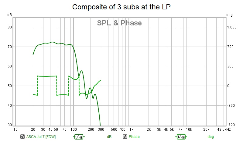

First a really nice subwoofer frequency response after equalization albeit at a single position:

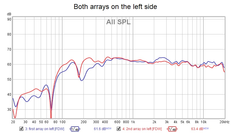

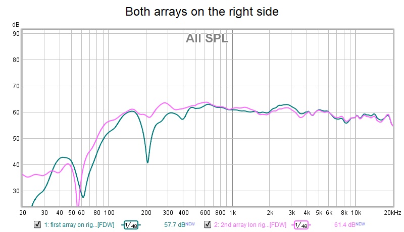

Unfortunately, when I moved on to the arrays, I found their low end responses were substantially different, even when measured at the same positions:
The pink trace is the new array with the 1/16" pilot holes. I didn't realize the first array had 1/8" pilot holes until I did the 2nd array.
I suspect this means the drivers in the first array aren't sealed tightly enough against the baffle so I will have to dismount them and then fill and redrill the mounting holes.
Why not just use screws with a larger shank? It would save all of that time filling, sanding, and redrilling.
Interesting the differences in #1 and #2. I hope it just pans out to the screw holes and sealing differences.
I've always been amazed how much better my vented sub and mid designs measure when fully tightened, up vs looser initial prototyping measurements.

We shall see about the holes. Could also be I need more screws on the removable back. Both are really pretty easy to do, albeit time consuming, but at least I have the other array to listen to while I do it.

well it appears I don't or might not have to dismount my drivers and fill and redrill their mounting holes. That weakness remains but I see another potentially worse problem.
The joint where the short wall meets the baffle, with a 22.5 degree bevel on each failed. I guess I didn't have enough clamping pressure on it when I glued it originally. I had multiple clamps from driver holes out to the edge of the box but apparently not enough of them or not enough glue or .... I could tell I was in trouble when I implemented Mark's tape technique on the 2nd box which put pressure uniformly along the entire joint. Knocking the array over when I was repositioning absorber panels around it didn't help either.
This might not be a serious air leak but its a serious weakness that allows the panels to move.
So my plan is to get 1"x piece of trim, cut a bevel on it and glue it in place over the joint. And to shoot brads in where the glue didn't take. and then see how it works
