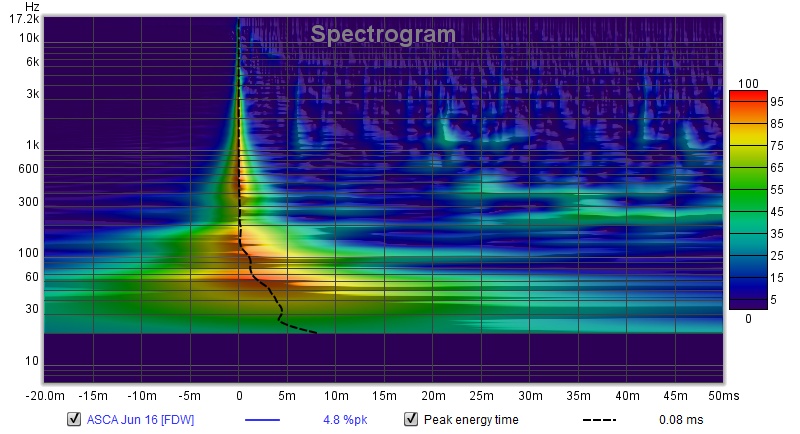

Oh, so you want to know if I'm a bass head🙂 Yes I am. Haven't listened much though due to time and family constraints
...wondering why the treble drooping so severely

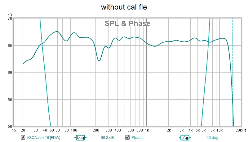

I see I'm really missing the cal file but I'm also confused because I see that same 4 khz undulation in my own measurement that uses the cal file
No hurry, the zips are firmly attached 😀.
I am curious though, which one of these files you'd like best.
You really need the cal file in the DRC processing. Each measurement should need the Cal file to look pretty.
The graph should look best gated at 25 ms with Var smoothing. That should represent the tonal balance you get.
does multiplying cal file with your filter in REW correct or screw it up?
whoops won't let me export as wav anyway because its not an IR

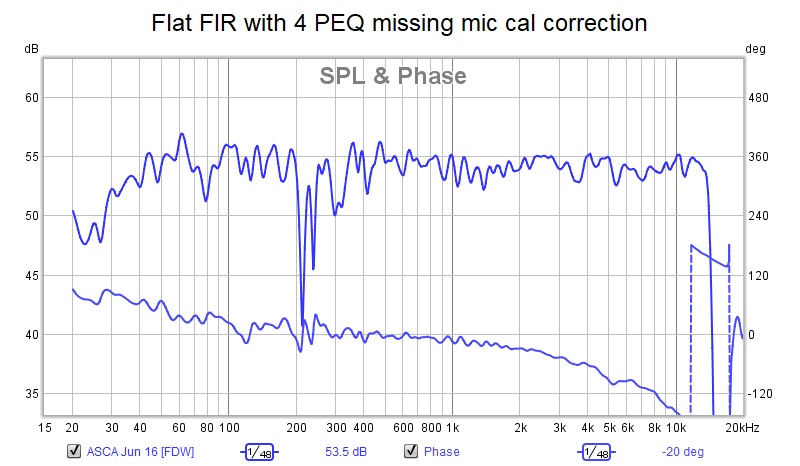

Now I understand. Since DRC corrected it smooth without mic cal file. I will only measure it smooth w/o cal file but I hear it unsmooth.
What i need to do is to make a measurement with cal file enabled and then create a filter that just smooths out the cal file wrinkles and then REW* that with the DRC filter
Import a Dirac pulse, apply the Cal file and EQ it back to flat 🙂. Then you have the inverse of the Cal file.
my attempts to replace the missing mic cal file by convolution came to nought. Neither my DRC templates nor REW auto EQ would follow the undulations. So I added 4 PEQs in JR and got within +/- 1db of the original FIR-file without the cal file enabled which, via a double negative, was my target.

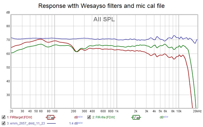

My measurements are all with the flat FIR tile but I'm listening to the FIR-target because it had too much treble and I like the bass boost. Don't want to pause the listening for another measurement (and these FRs are FDW15)
Wesayso's process seems like magic to me. I can't come close to duplicating these results on my own. Thanks, Ron, for all the help!
It's black magic 😀. I had to undergo several rituals to get this far 😱.

It's that command line together with the template file that's responsible for results like these. Pretty hard to believe I'm using relatively short windows and get that kind of a result, right? It's even shorter than the soft template except in the top end.
I don't have filters setup for 96000 (I just converted your file to 44100 and back again) which you would need, but that would influence all the window sizes within DRC. They would need to be 96000/44100 times longer than they are in my template and batch file.
I've made a few changes very recently, that's what I used in these last samples. The double DRC treatment I've mentioned in my thread, but also some minor tweaks to the template.
The origin for those command line options actually comes from my previous use of DRCDesigner. It just stuck and nowadays I find it easier to adjust these .bat files.
I've automated a big part of the process, but can run them solo too.

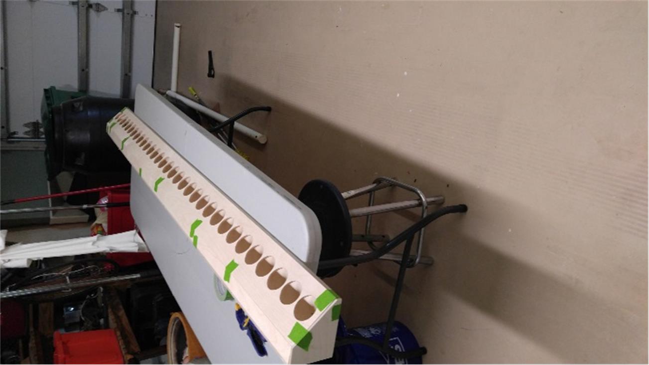

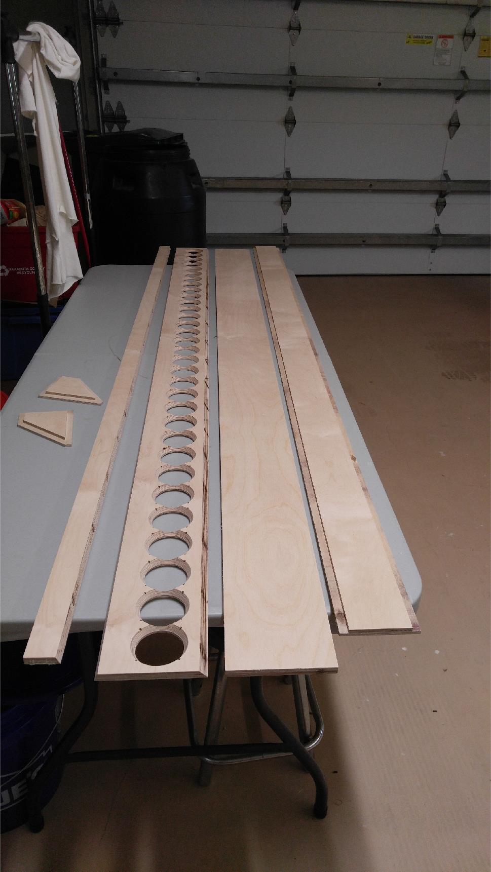

I'm finally ready to build the 2nd array. Here are the pieces all lined and ready to go. This design is simplicity itself. Just 6 pieces CNC cut so everything fits perfectly. Most of the time and work will be in mounting and wiring the drivers.
Were I to do it again, I would use 15mm instead of 12 mm plywood as individually each piece seems flimsy. Rigidity is achieved when they are glued together but I do need to beef up the end plates as they aren't thick enough to hold hurricane nuts for attachment of a baseplate.
See - they really do fit but I see I have to be really careful to keep the beveled edges aligned as I glue it. Had I had the opportunity to revise drawings before the 2nd build, I would have cut plates to fit inside the end plates and used them as temporary braces at the 1/3 and 2/3 marks as I glued.
Uhoh! Driver mounting pilot holes are too large. Thought the screws for the first array went in way too easy.
Wanted 1/16", got 1/8". I drew at 1/8" but created CNC tool path that specified 1/16" but this didn't transfer to the CNC shop which created their own tool paths.
Heading to Home Depot for some wood filler....
