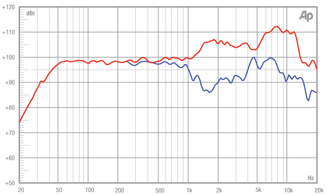

Never heard this driver, but the published FR isn't that scary IMO. The on and off-axis plots mirror themselves to some extent, which should make for a good power response in-room, with the caveat that I'm not sure what angle the blue trace was taken at. Perhaps the ~5kHz-8kHz area will be a bit hotter.
Blue trace is 45 degrees off axis. Very good for a 15" FR methinks. It sounds great.
Quite common for big FR's to have a rising top end.
