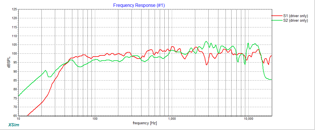

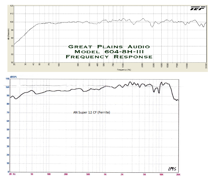

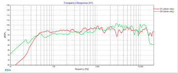

Attached plots from the respective data sheets of the 604 and Super 12CF, showing the on-axis outputs, plus that data in an overlay (red = 604, green AN12). The former doesn't look clearly lower to me. :scratch1: It's a bit down at 3KHz but that's not necessarily a bad thing as 3KHz is the last place you want gain peaking. Some variability for both units (as you'd expect) but as far as average SPLs are concerned they appear to be much of a muchess; different in detail but these average out as roughly equal over the frequency range. YMMV.

Back down on planet Earth that is of course seen as the bollocks it is. ;) No great talent required, I simply took the manufacturer curves and displayed them in Xsim (other software can do the same) as independent driver responses. Easy.
Note that the conditions are not the same; both are anechoic but the AN was (presumably) taken on an IEC baffle, the GPA in a 9ft^3 box, so I'd ignore everything < 300Hz.
I was thinking that the AN 12" would have to be EQ'd down to flat so the sensitivity was levelled to where it s at around 200Hz. But toe-in may be enough.
