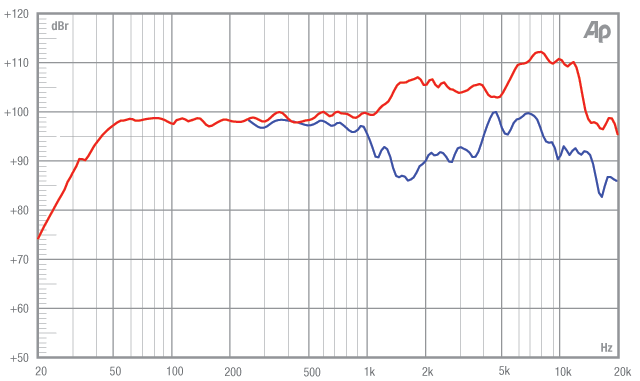

Why is the Radian 5215B not an alternative? It's 600$ each, has nearly completely flat response, and I'd guess that the actual spl/w is very equal to the GPA 604-8H.
I find it very hard to accept GPA's claim of 100db/w, and only down to 98db's at 100hz. They do admittedly mention that the measurements are "Measured using GPA N604-8A Crossover in 9 cubic foot tuned enclosure", but say nothing else about the measurement conditions. It is probably a really good driver, and should perform very well. Just having a hard time accepting the numbers in play here.
Looking at the curves on Scott's overlay, I'd personally come out and say that they are vastly different. The AN has a clearly rising HF response, and is almost consistently 2-5db lower in output under 1khz, while at the same time having higher output/heavier peaks and dips over 2khz.
One is a well implemented coaxial, and be certain that there is eq in them filters. The other is a classic relatively large FR unit with the response that often caracterize such units.

No doubt the Radian will be very good.
I would expect GPA's published data to be reasonably representative. The 604-16X was about 97dB, the 604-8K about 98, the 604-8E about 99dB - 100dB depending on how you prefer to average it and traditionally all these big Altec units were measured in large vented boxes, so GPA are essentially following in the same vein.
