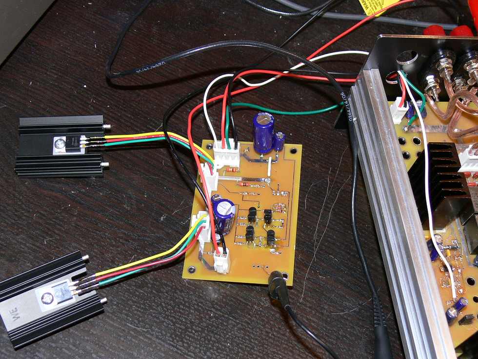

So I'm thinking to add attached power supply. I added some circuits I used vely long time ago (for analog power amplifier).
LTSpice says it's ripple rejection ratio = -86dB/1kHz.
Now I'm hearing this discrete power supply, simply very nice.
Controllable from AVR, Rock Solid DC voltage, < mV noise, sound is warm and silky, but puncy.
I feel a little bit better than TacT S2150.🙂

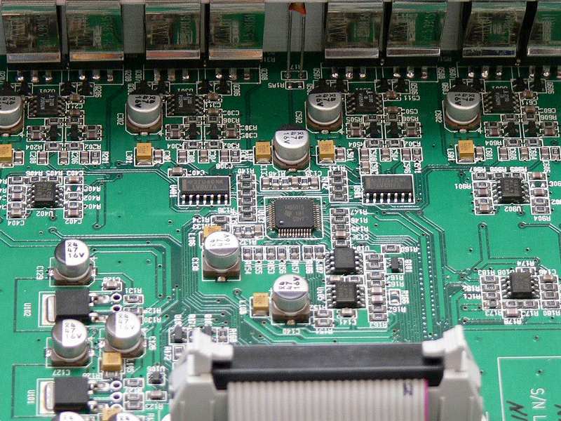

I'm really interested in this project. I'm a TacT/Lyndorf Audio fan and have owned an M2150 in the past.
However, I don't need the multi channel feature, and I'm certain that there will be improvements to this project down the line, so I'm wondering, would it be possible to split up the PCB a bit? My request would be to put the SMD components (TAS5518) on a daughter board, so that one could do the SMD soldering only once, and put the power output components on secondary PCB, so that one can configure 2, 4 or 6 as needed? I'm mostly concerned about not having to purchase multiple chips and resoldering for each upgrade, the extra channels is not that important as I assume I can just leave out those components.
Also, do you have a few more high resolution pictures of the PCB and internals of your amplifier?
Are you certain that this amp already sounds better than a M/S2150?

TAS5518 requires power stage TAS5142 etc, and also they are SMD components. I can not recommend separated board for them, they requires short path for power and signal.
wouldn't it be possible to separate out the parts on the lower right part of the PDB, and connect to each amplifier block using ribbon cables? Would that impair sound quality? It would make it a bit easier to swap out the power supply and amplifier blocks independently of the chip section.
One of the nice things about the DIY class-D projects is that they are mostly small and modular, allowing independent upgrades of the different parts of the project.
Hi For myself separating board is..
(1) Expensive for board building fee. each board will take setup fee.
(2) not easy to design effective board separation.
(3) hard to store in enclosure, and messy cables.
(4) "module" re-design is not so often. I re-design whole of board, or just add small board.
(5) take more board space and connectors, often expensive than TAS5518 etc. (like Chip $10, connectors and cables also $10).
so not a option.
