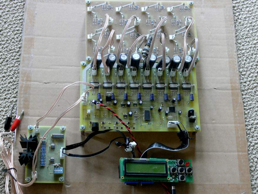

Does anyone want to play with TAS5518 full digital amplifier?
This is my prototype board, and now I'm working with ver.0.2 so it can be passed to you. I think many person have interests in TAS5508/5518 but it's hard to take off. and I need brother in arms.
Board construction:
(1) main digital board, CS8416 - TAS5518 - TAS5121 x 8. accepts I2C control, and generates raw PWM signal.
(2) filter board, large 10uH coils, film capacitors, etc
(3) AVR ATmega128 and LCD, button board. http://microcontrollershop.com/product_info.php?products_id=588
(4) Simple variable voltage power supply, using LM317
What you get:
(1) boards, source code, schematics, board layout file (made by www.expresspcb.com software), connector and pins for speaker output.
functions are, volume control with variable voltage, 8 digital input selection, LPF/HPF/EQs/level offsets/mutes. can create 4 way 24dB/oct integrated full-digital channel crossover and amplifier with volume control. Output power is about 20W total.
(2) 10 question support incident 🙂
What you need:
You have to be diyaudio member, to send e-mail to me.
AVR programmer / debugger, and of course knowledge of AVR GCC language.
of course you should used to be digital amplifier, diy, wiring, soldering.
Power supply, I was using 18V/3A Lab DC power supply.
diy and at-your-own-risk mind. I used this board to play $4,000 speaker for months, but AT YOUR OWN RISK.
Price:
I spent thousands$ until this board works but adequate price will be around $150 including shipping in USA (just to block non-serious person). I hope you already have knowledge about TI full digitals, and interests, also to be serious. Please contact me if you interested in.
(If this post is not appropriate for this thread, please remove > moderators )
