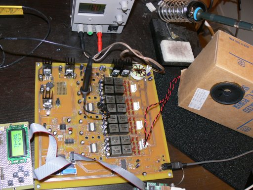

I was updating Code for these couple of days.
Now lines are almost half, but total ROM size are not so different.
This code controlls..
(1) CS8416 Rx Channel
(2) TAS5518 Volume
(3) External Parallel PSVC (16dB / 4bit)
(4) TAS5518 BiQuad 0,1 (LPF) 2,3 (HPF), Channel Offset, Mute
(5) TAS5518 BiQuad 5,6,7 (Peaking, Low Shelf, High Shelf)
1/3OCt point, Gain, Q
by JackRabbit and CrystalFontz Serial LCD.

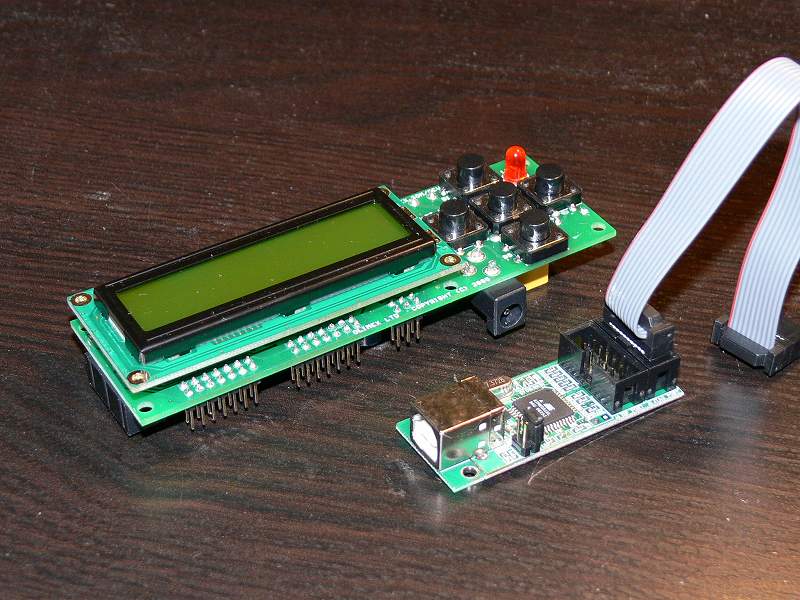

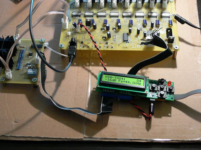

Ported to AVR.
(1)hardware
http://microcontrollershop.com/product_info.php?products_id=588
(2)Connection
I2C: PortE, pin6 and 7
Volume Control : Port B, 7,6,5,4
Power: 12V supply from board
Peter Fleury's library are so fine, but using GCC was suffering..
It using 24KB of memory, so at least ATMega64 will be required.
(for extensibility, ATMega128 will be better)
You've better to use RadioShack & paper box speaker for initial amplifier testing🙂
