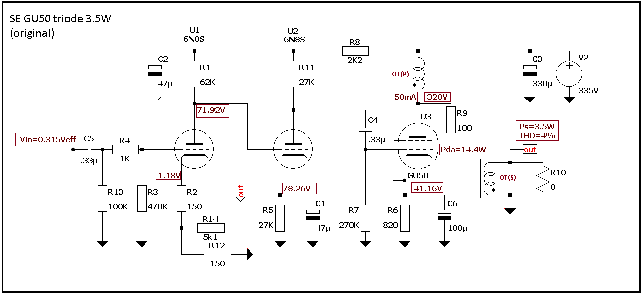

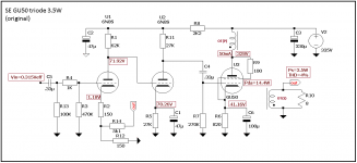

FU50 tube amp mods and schematic
Hi Wavebourn, as the resident GU50 expert, I was hoping you would join the party

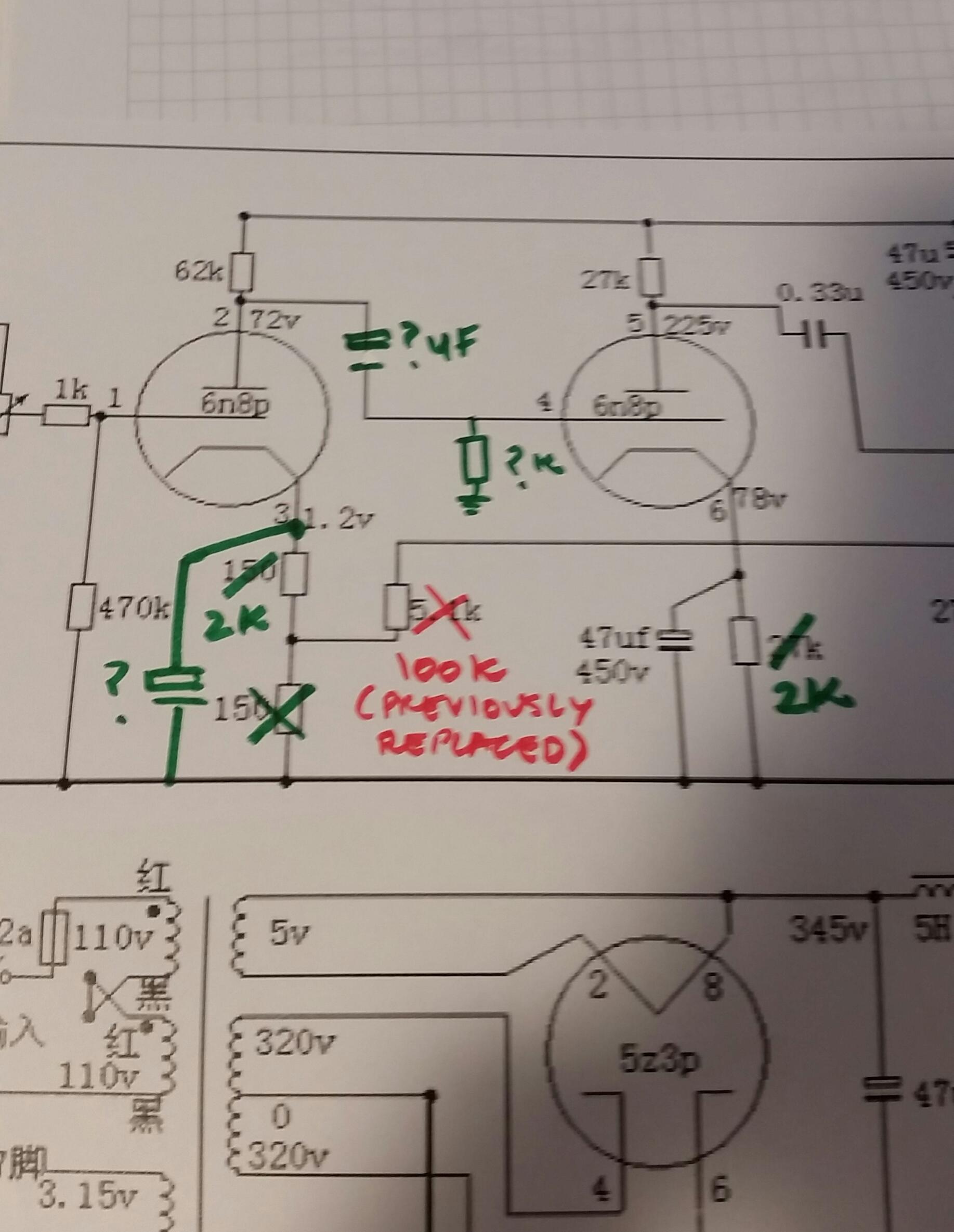

Do you mind indicating on the schematic the modifications? Thanks
It is not about GU-50, it is about 6SN7 tube
Put 2K resistors in cathodes of both triodes, and shunt them by caps.
Disconnect the grid of the 2'Nd triode from the anode of the 1'St one, and connect through a cap. And add a grid leak resistor there. Google for schematics with 6SN7 tube, as an example. Since you have a feedback, just replace the upper 150 Ohm by a 2K resistor with a cap in parallel.

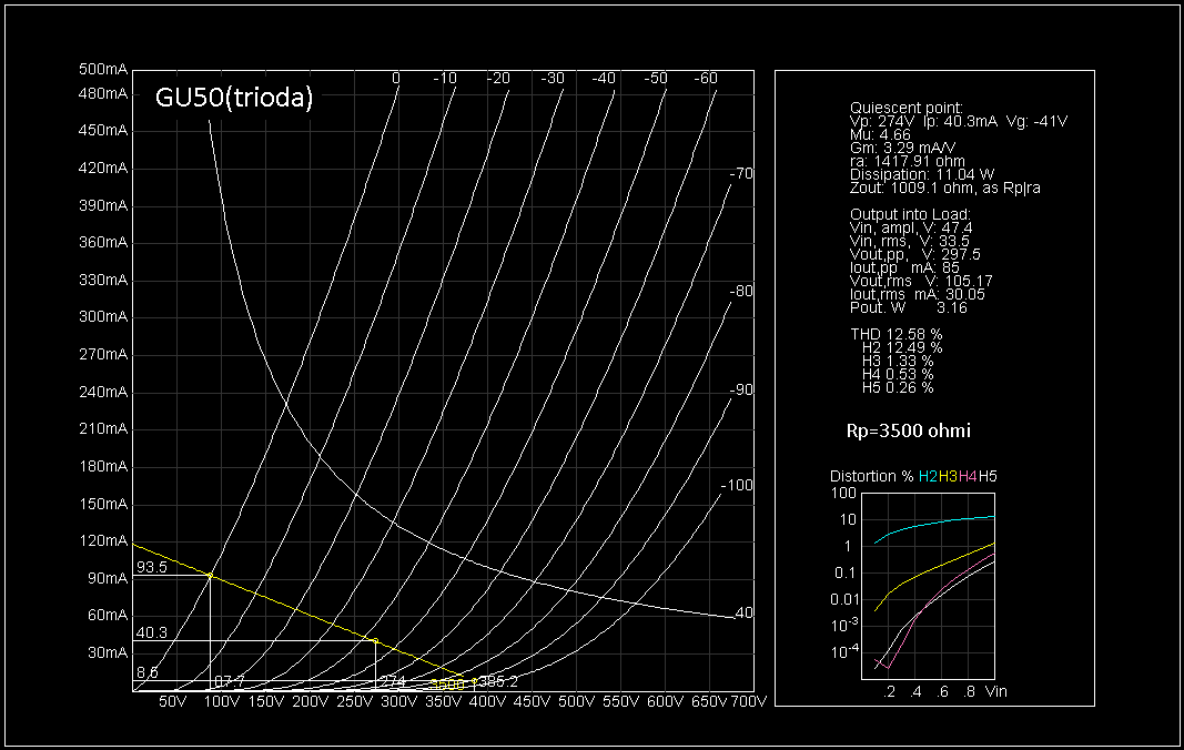

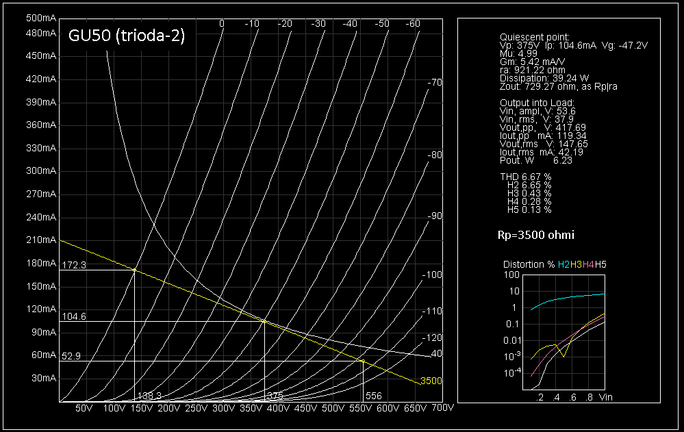

First, I think this configuration for your chosen PSF is not too good with FU50 tube (GU50) with another PSF can achieve much better performance without the presence NFB circuit electric. Images one can see the difference PSF between the two, especially on THD, harmonic distribution is the same in both cases, so the sound will not be altered but we gain in dynamics with a power output greater than, in my opinion!
In the images below you can see the shape and amplitude of the signal must have procedures for grid G1 final FU50 tube (GU50) .Input signal G1 (FU50) must be asymmetrical.
PSF = point static operation.
Uanod, Ianod, Ug1.
Sorry, I use abbreviations in Romanian language, sorry!
GU50 model was generated uTracer V3.0 and graphs were made with JavaScript Spice model generated uTracer on several real tubes.
Accuracy is very good, considering the rather large dispersion tubes actual parameters compared to the data catalog.

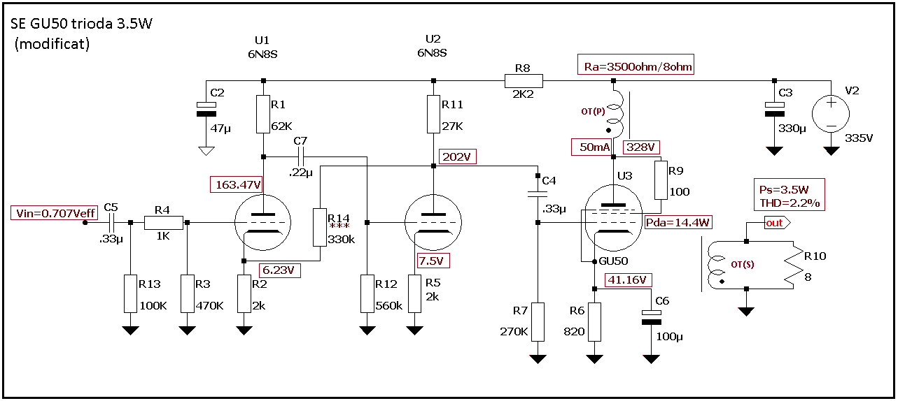

In the images below and see the original project but changed the project to which we applied a negative reaction Schade local type.
Try this out and maybe it will sound like.
My opinions and apologize for the inconvenience!

Thanks Lazaroiu, I will give that a try
I have heard of Schade feedback but I need to read up on it to get a better understanding

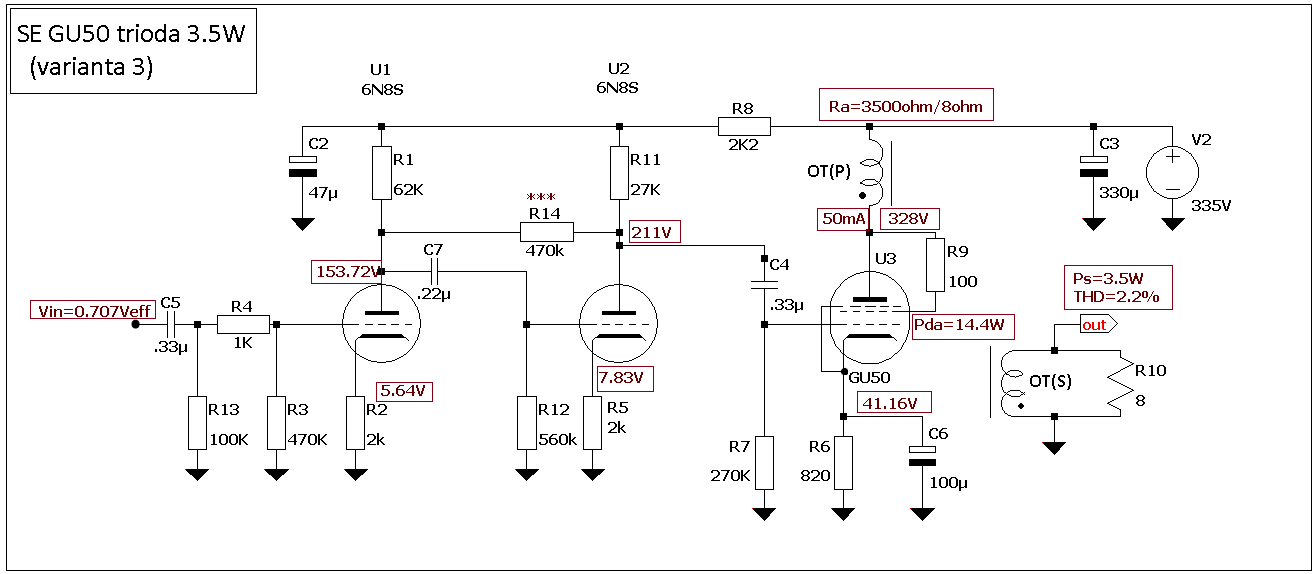

Schade more accurately we can consider the configuration of the photo project:
Why should we apply Shade's name to any feedback? Would not it bee too much? ;-)
Agree with you, say local NFB, in this case, would be more correct it?
Schade name to assign only one floor and NFB pentagrid final anode (tube end), anode tube pentagrid floor of attack (prefinal) would be more correct it?
You take into account so in future posts, thanks for the suggestion and to participate in discussions, it was an honor for me.
