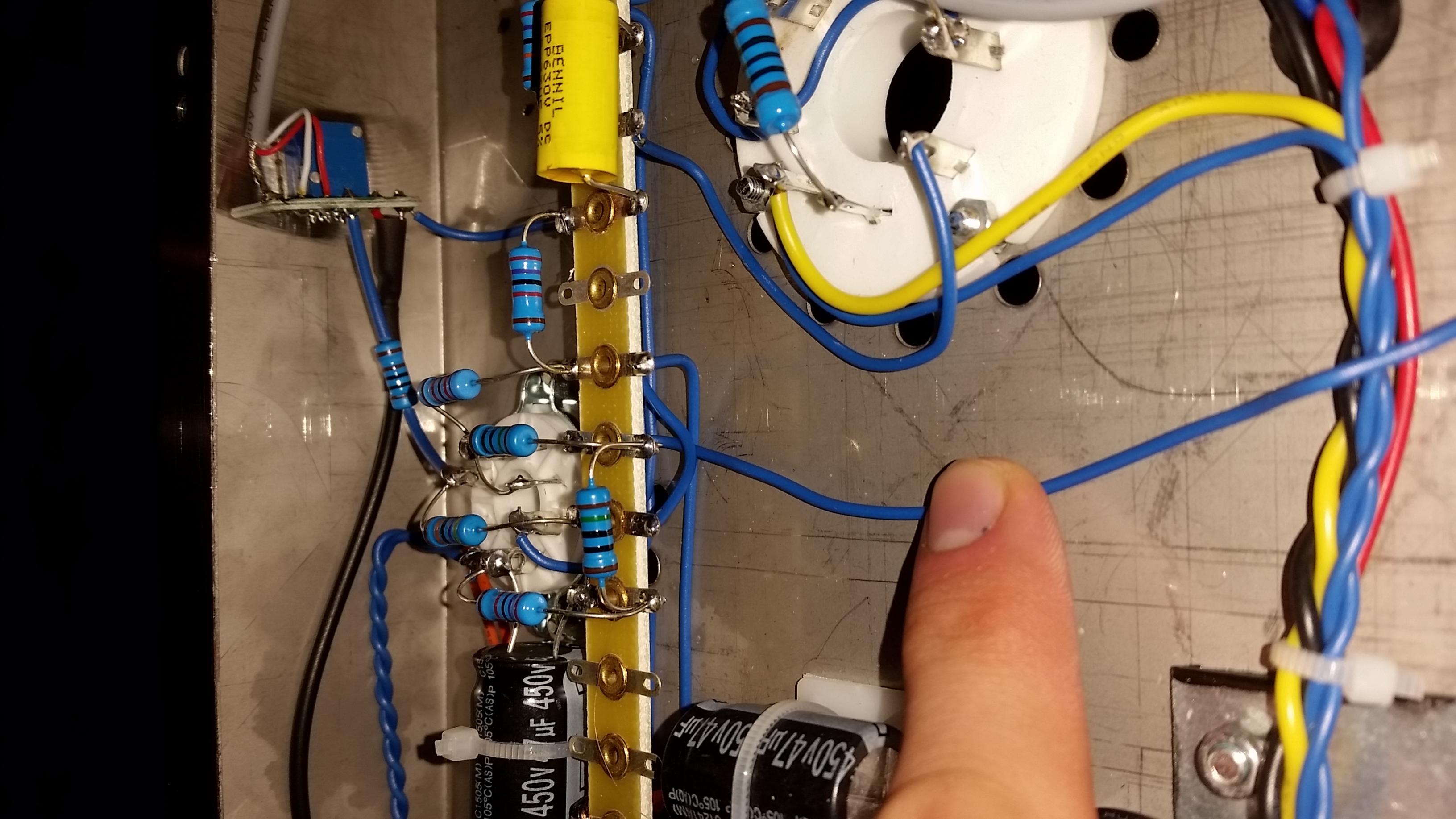

When you put a stereo(L+R) 100k potmeter in serie with the 5.1k feedback resistor. You can adjust feedback, this has a lot of influence on the soundsignature of the amp.

Well i have searched and searched but I cant find the 5.1k feedback resistor. Its supposed to be in series with the 8 ohm tap but i cant see anything there.
Edit: photo attached . My finger is on the wire leading to the 8 ohm tap
If that feedback resistor is "missing" then you do not appear to have the correct circuit diagram.
I would suggest drawing out exactly what you do have before trying to alter anything.
Safe to say it has no NFB?
It has max feedback. Place potmeter in the wire you are pointing in the picture.
I got lazy and implanted some resistors in the wire rather than a pot (will insert the pot next week)
Anyway I am using 2 x 47K resistors in series on each side, so very little NFB now.
I actually prefer the sound this way. Noticable changes:
