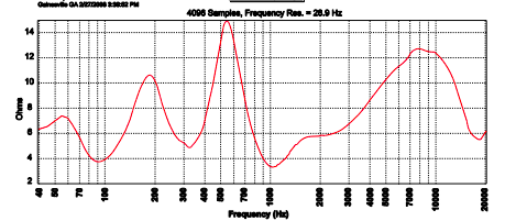

How could I not be desirous of what AnthonyA described? I have speakers that dip below 3 ohms at 1K, and this amp might be just the ticket, so please consider this a commitment for one pair of boards. Thanks - Pat
3? That's for sissy amp.. Try 2.3 like nht
