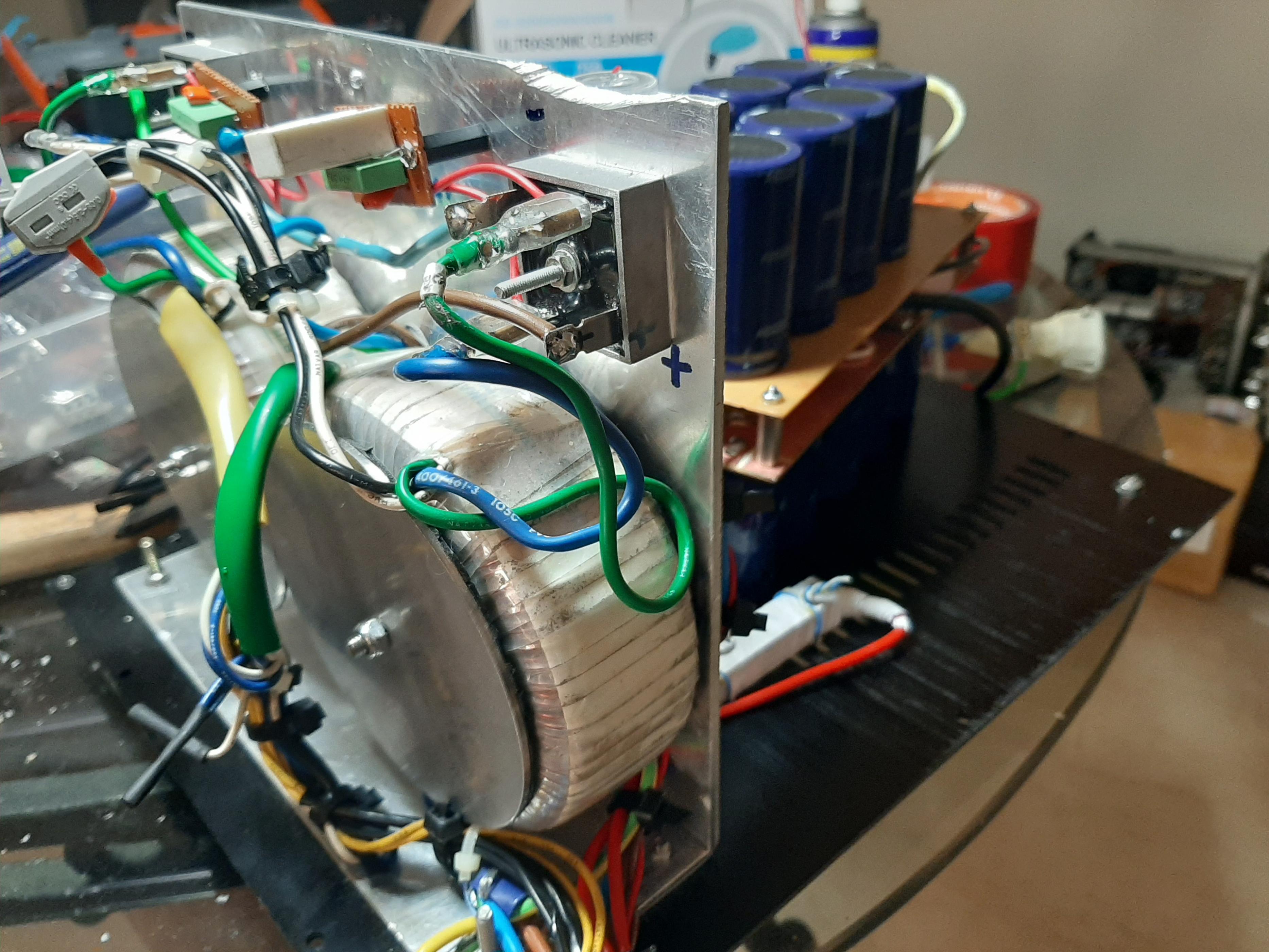

Anyway.. Should be up and running next week. Just tidying up the power supply and cabling

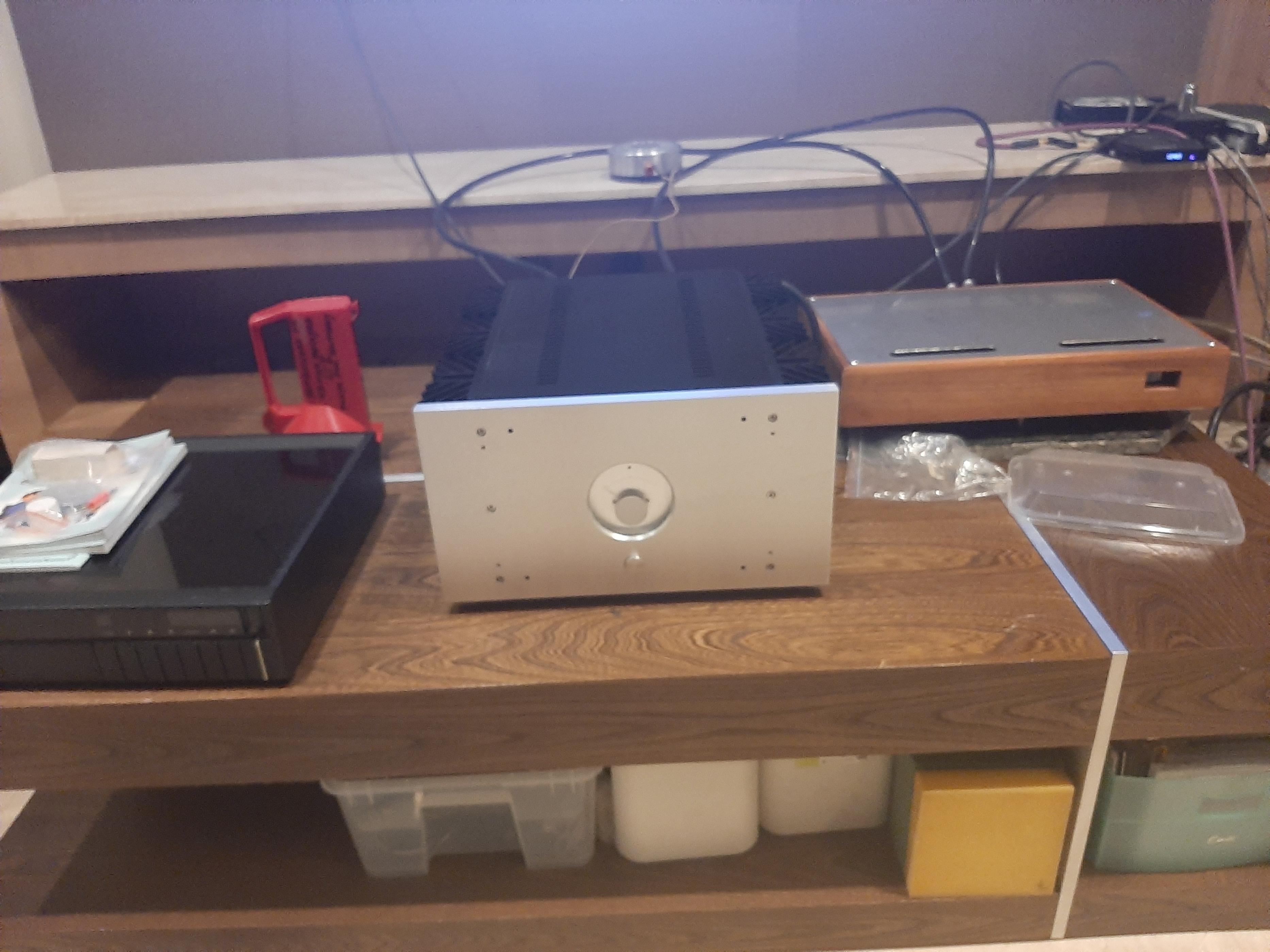

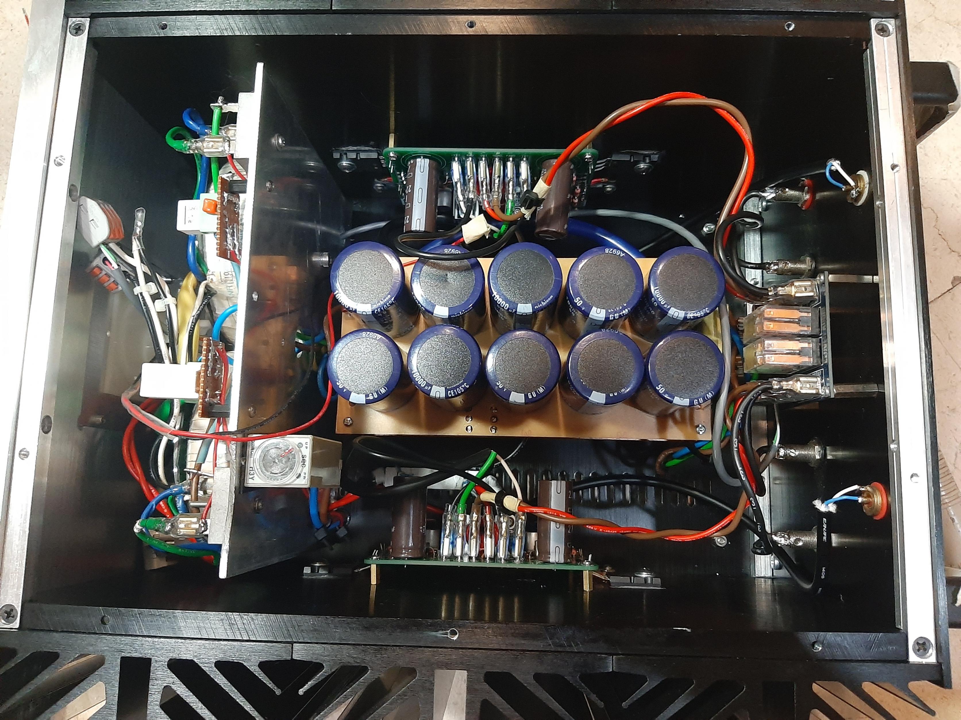

Up and running smoothly.. Thank you papa godzilla
600ma

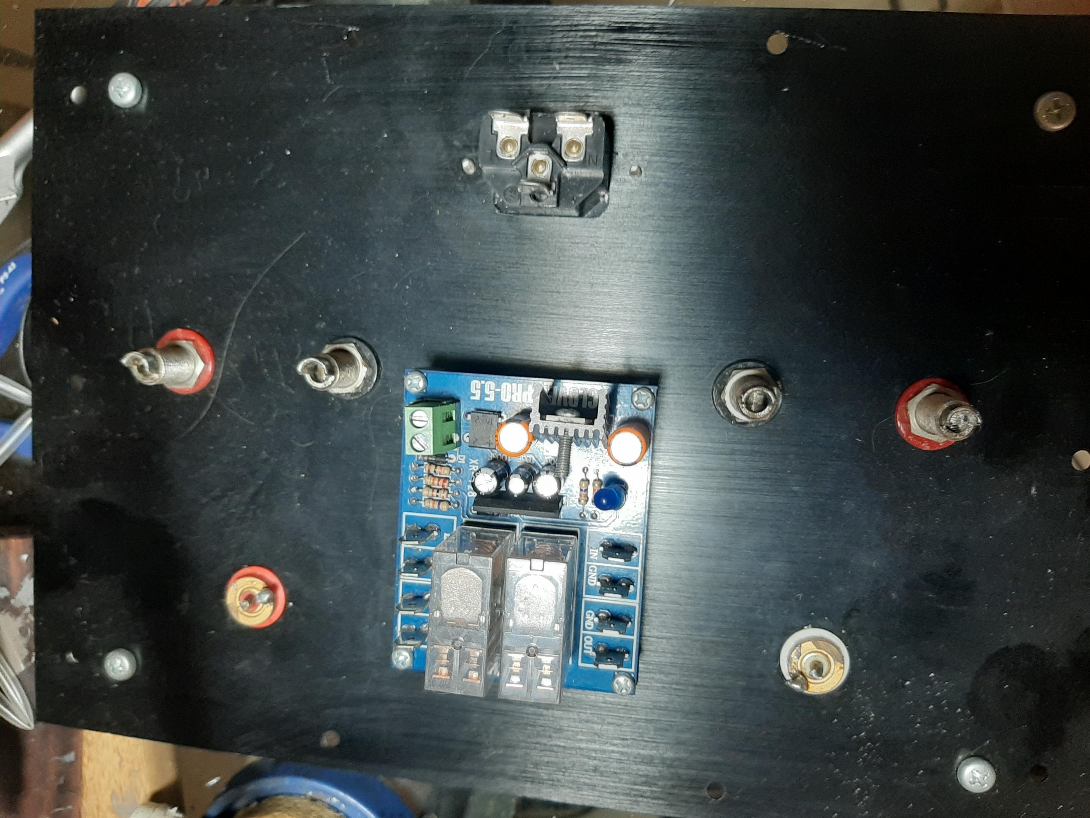

Speaker protection
CLC. 180000uf of nichicon
Slow start
Full takman carbon. Mox
Just standard canare rca cable
Normal industrial cabling, Belden. Gotham dll.
Cmc rca. Rhodium speaker post local brand
Sound?
Pretty gud! 😎
Nothing weird. That's a good sign
YouTube
It's just mirand dac to amp - you tube clip.. Only 2nd hours
Seem my pre burn in while waiting for parts paid off lol.
It's not customary for Fab to do any review in the first hours but what the heck.
Seem it tick all the boxes of my wishlist VS my diy goldmund a lower biased class AB.
More bloom.
More timbre.
More musical
Creamy and Airy vocal..
More class A but still good bass and slam
Sneaky good staging
Audio bliss... I'm waiting..
I think I will be a happy camper.
I think I spent less than 800 usd in this build. Cherry on top.
