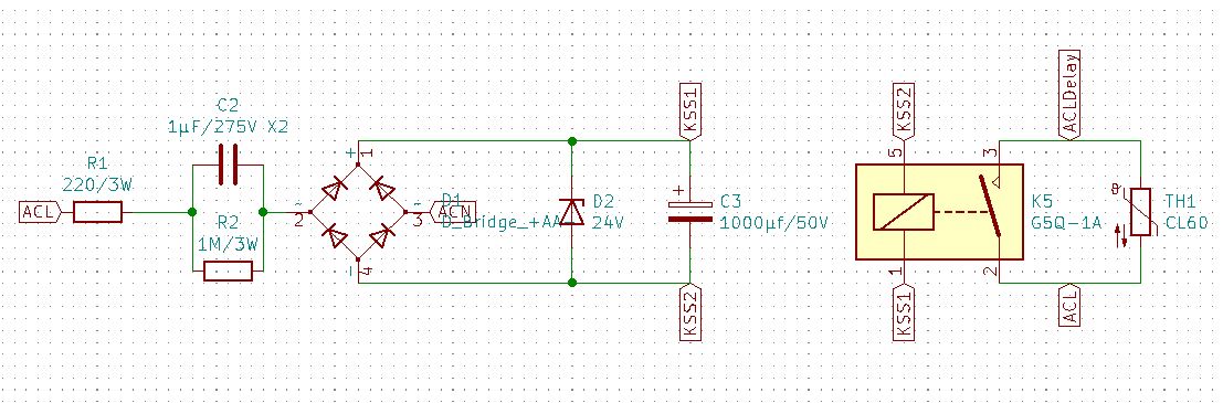

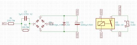

It is all probably good and well but quite expensive if you add it up... Ok, by far not as expensive as my speakers but I have seen other options for far less, inclusive ready built by audiophonics etc.... any reason for such price differences?
Any affordable option?
I would rather spend the money in the PS - all I want is a good protection, high reliability and low output resistance, the rest is fine for my engineer side but not really needed in my case, basic working tech would do the job...
I too find that the PCB's for softstart and DC protection, that are being offered, are expensive. Add exchange rate and freight and the boards end up being US$50 - $100 each😱 If you're building multiply amps this is a large cost.
For years I have used the softstart kits with thermistors from Ebay, without any problem. They now come with remote control and a temperature control switch.
For DC SSR protection you might want to look at this link:
SSR for speaker protection?
You could also adopt the circuit of the diyaudiostore solution. In this case it's shorting out an CL60 for security reasons after a short time... But use it only if you know what you're doing. There are lethal voltages in the game.
